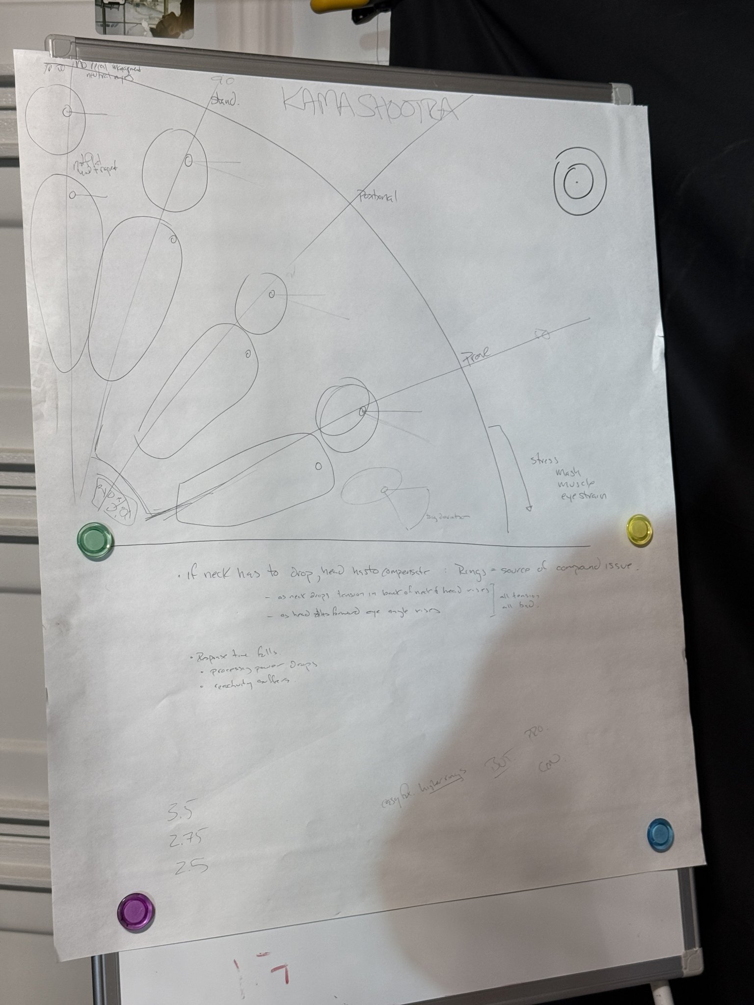

    Okay we did a live on this topic as this is something we are looking at more and more. We already know we are going to higher rings. The AR15 world has going to higher Risers and now the bolt action world should follow. For a while now I have been taking about 1.375" to 1.55" as the rings I look for today. I don't go low, I stay high to keep my head up. Well saying this repeatedly has lead to Chris getting a 1" AR Riser for his bolt gun.
    So this week I jumped in to look at this and felt it was better. My biggest concern was prone, and prone even for me was very comfortable.
    I wanted to talk about this, today Chris and I jumped on a LIVE and recorded our thoughts.
    The graphic Chris drew is a touch light on the screen, so here is the image.
    For reference:
    Measurement for Chris was 7"
    Measurement for Me was 5"
    The Rifles averaged 3.75" with the Knights being the lowest at 2.75" scope over bore height.
    This is a thought, an experiment, so we want to your opinions ... we know the immediate negatives what are some we might have missed ?

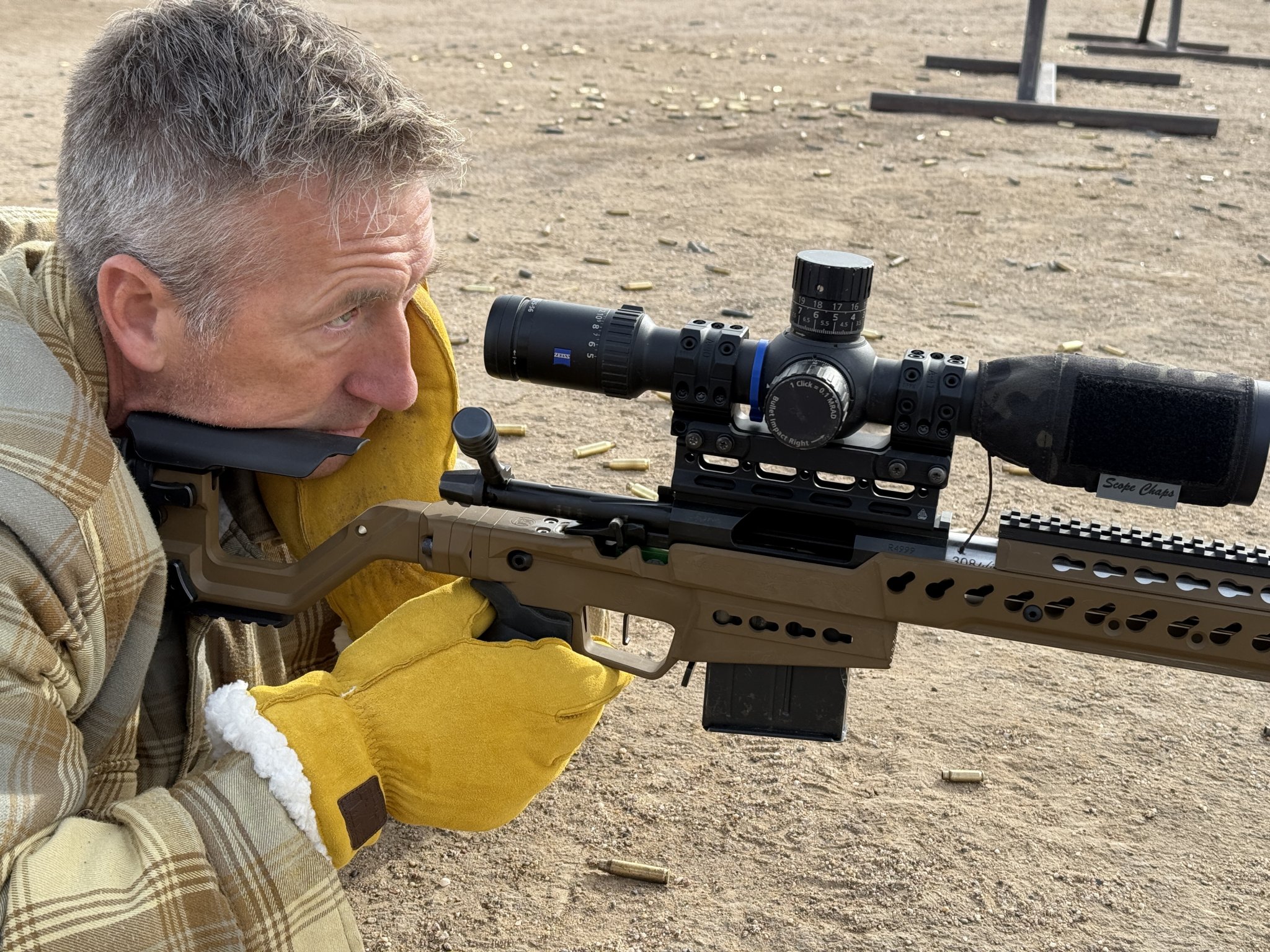

    We know high is better everything lately is 1.5” and it’s better, but this idea of adding an 1” to 1.5” is the part that changes it to the next level.
    Sure lots of 1.5” guys, but now, add the inch. 1.45” is where they are for clip ons too 1.45 to 1.54 usually so an increase over that
    The key is looking at Chris’ head and neck as he addresses the other heights , my rifle the green ATX chassis is the Area419 at 1.5”

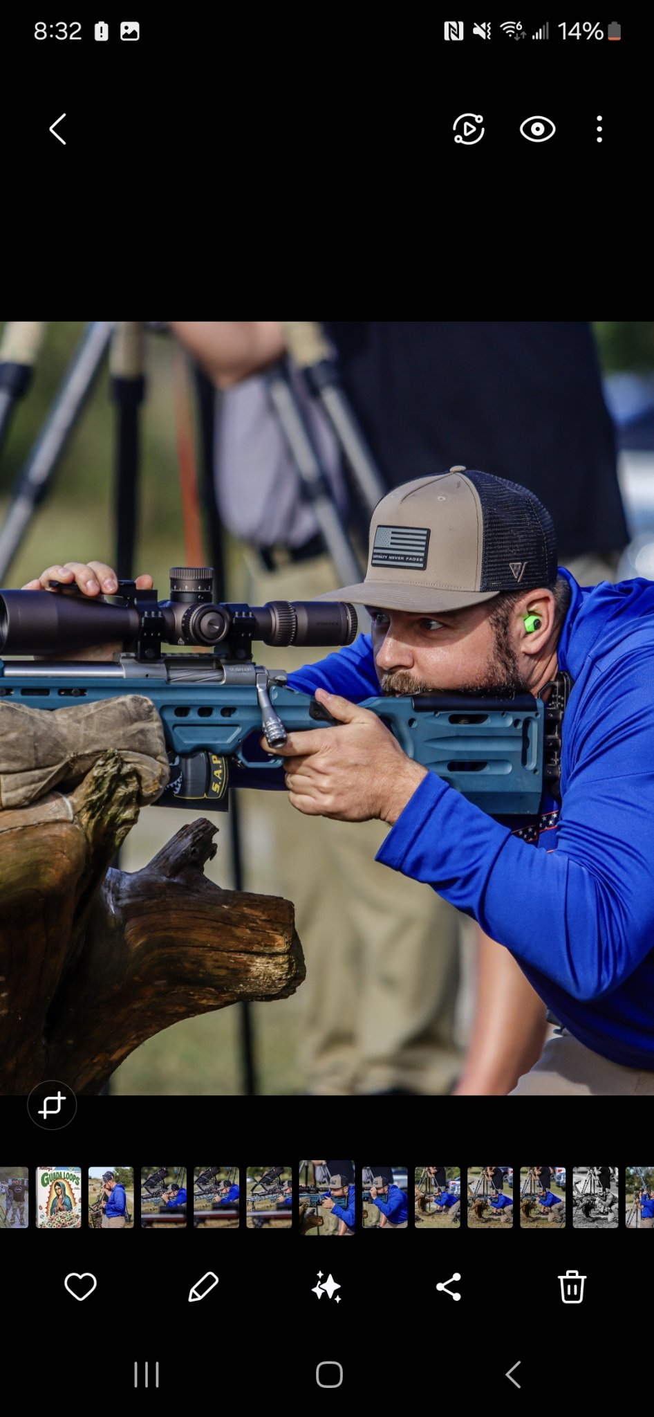

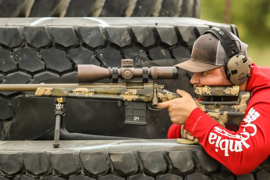

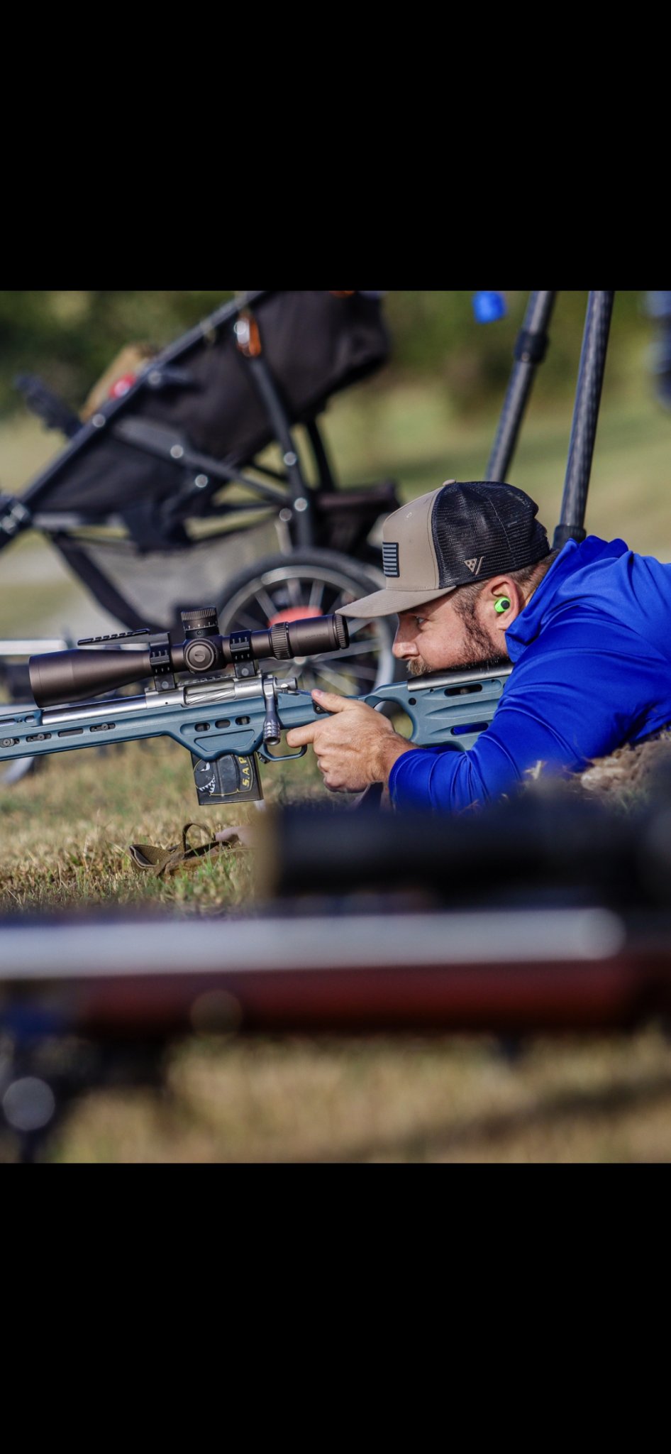

    Someone took a pic of me shooting modified prone off a stack of tires at K&M a while back, and when I saw it I was surprised to see that my head was kind of cocked over to the side more than I’d ever noticed. Especially since I already was running a fairly short LOP with a medium-high 1.26” mount, and had my cheek piece set only about halfway up in its range and lower than most.
    Since, I’ve dropped my cheek piece all the way down, and my gun almost looks more like a traditional hunting rig than a PRS rig from the side. Now I have a bunch more room to get my giant melon behind the scope and can naturally keep my head upright and square with my shoulders… It’s been a revelation, now I can spot my shots 100% better than before and every position has become easier.
    Now that I’ve noticed it, and from looking at the size of most guy’s melons, I’d say maybe ~90% of guys I see behind precision rifles are running their cheek pieces too high and don’t know it, and would probably benefit from lowering them just like I did.
    Also begs the question: cheek or jaw?
    In the first picture hes got it on his jaw, about an inch lower than where I go with my cheek.
    And I suspect the relationship is a threesome with the buttpad height in the mix as well as the cheek piece and ring height. Is it better to have everything higher up relative to the rifle with higher rings, or to have it all adjusted lower relative to the rifle with lower rings.
    If the relationship between them are the same and comfort is identical, the relative height above bore is sort of a wash as far as I can figure it.
    To add (and not trying to be snarky), Chris’s rig from the pic above looks like it’d handle like shit under recoil, off a bag, and be a PITA when running tripod-rear support with a flat-bag out front, and he probably wouldn’t be able to even see through his scope when trying to fit it into ~1/3 of the ports or some of the tight little windows we run into at matches... (JMHO/YMMV)

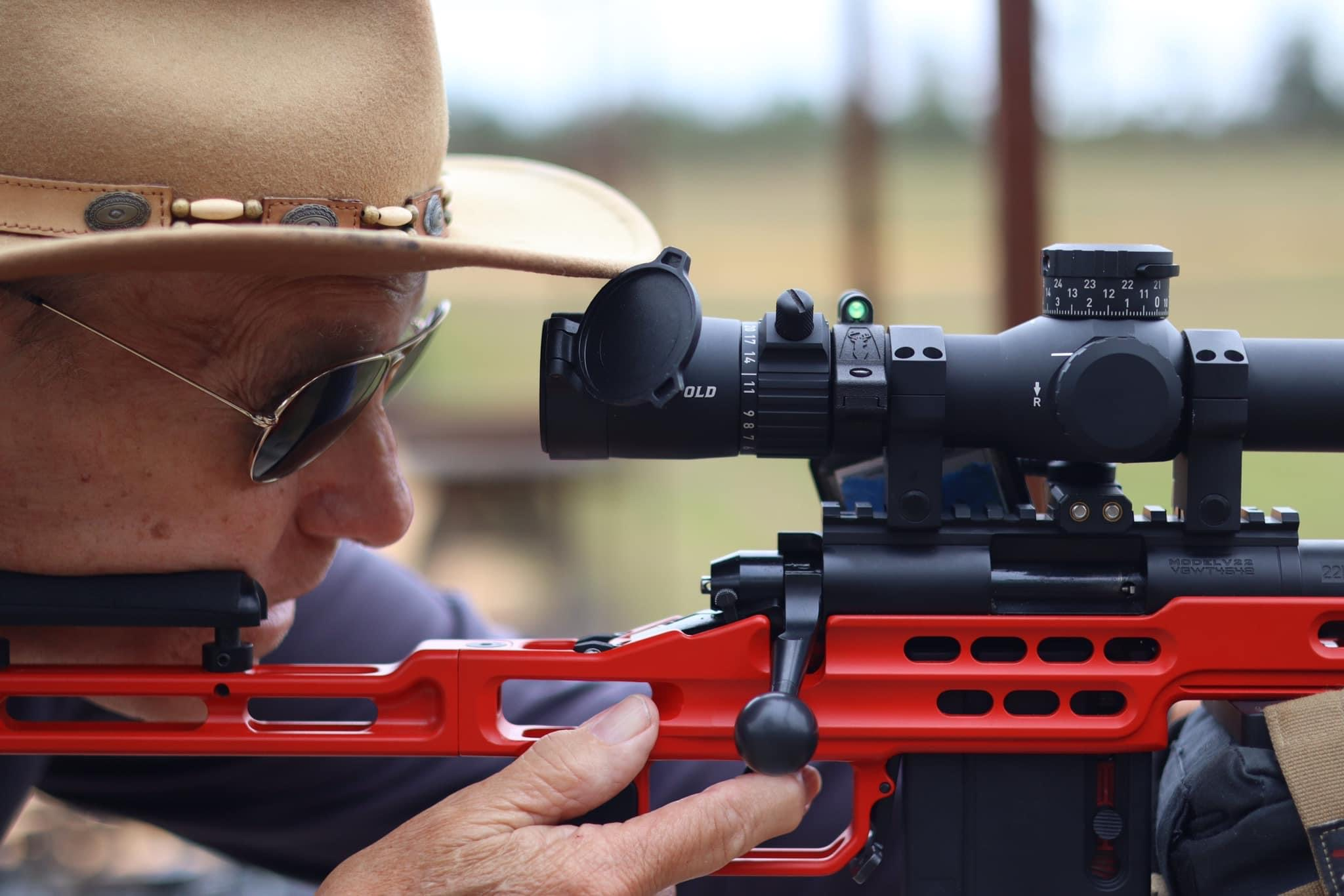

    I’m 2” different from head to shoulder with Chris the tall fits me in both prone and tripod on tripod it’s the best
    This as we are thinking is more universal, instead of .88, 1.1, 1.375, 1.5” what if all were just 2.0” and done … the fit better size be damned
    If you look back Chris has run this for months

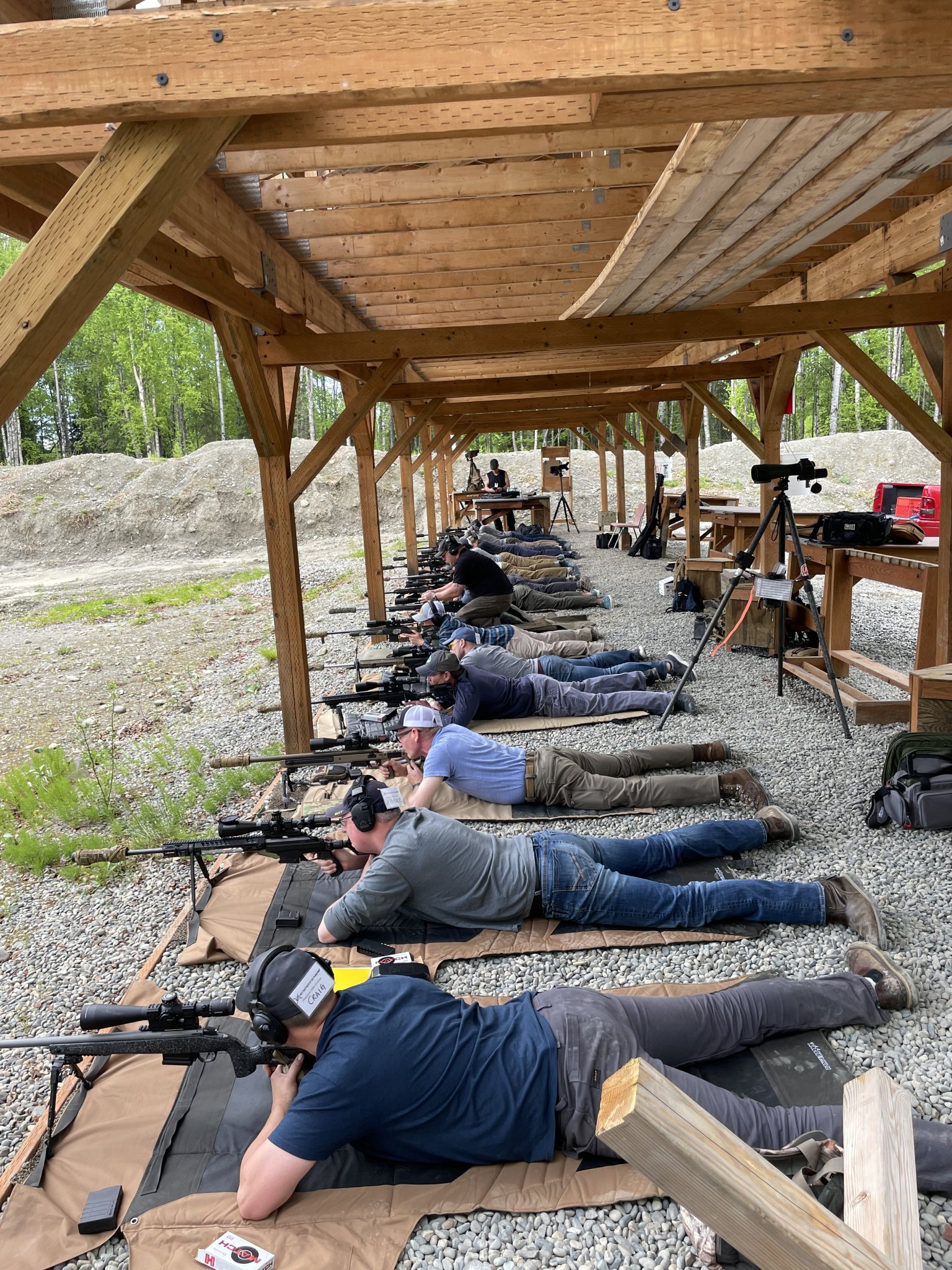

    If you look at the evolution of the Marc and Frank classes this ties right into our teachings and observations. We made an art form out of creating clones in a short amount of time. Alaska classes were only 2 day classes and we in short order performed miracles with a super wide variety of shooters.
    The two biggest keys our success was the bipod and scopes. We cannot dictate who brings what equipment, you try but the mix, especially in AK is crazy, with a majority of hunting rifles. We developed processes to clean people up as fast as possible.
    For example, if the scope was too low on the Hunting Rifles, which causes the shooter to roll their head over, we put them a standing bench. Raising the rifle to replicate standing as much as possible, helped center the head. As you can see in the image, we raise everyone's bipod. Low Rings, Low Bipods are shit. The mantra to get low is old and completely outdated.
    Getting low had context in hunting with iron sights, not with scopes anymore. We have learned over the years.
    Forget the individuals up there, look at the muzzles, they are all lined up. That is setting the baseline from which we can bring the individual bodies into line.
    But you can absolutely see it, the smash into the rifle and the change in recoil patterns

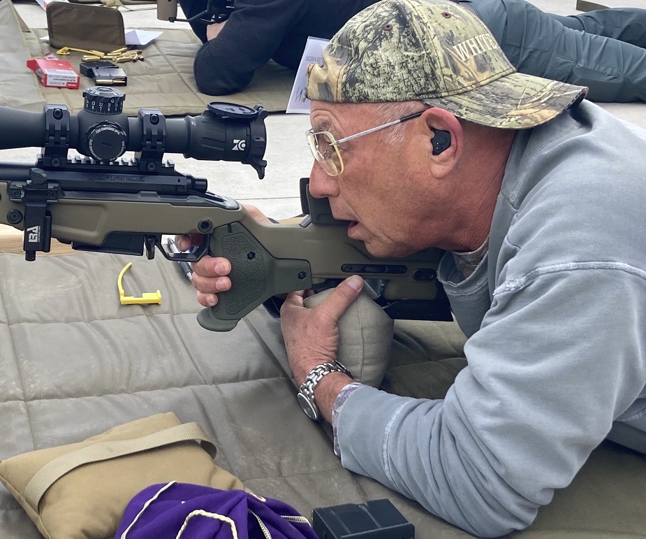

    I’m no expert but I have no interest in a “jowl weld” as o do find cheek bone on the comb to be the most consistently reproducible mount.
    Now it is a fact that people have very different cheek bone to eye relationships as well as different length of their neck and flexibility in their neck and lumbar.
    As a long time shotgunner, I have clearly established that my relatively high cheek bones (close eye to cheek bone distance) requires a very high comb position to see over the receiver compared to many others.
    Taking this to rifle and I need that high comb position to get into the eye box. I’m currently running ARC’s “extra high) rings that are 1.42” to center. Any higher rings and I’d have a concern about having enough adjustment in the chassis’ comb to get me behind the scope. My OG JAE is pretty much out of comb adjustment with these rings. My Vision could go higher if I had higher rings but I’m not at all sure my neck can bend back further.
    MDT ACC, you can use the longer LOP posts for the comb and go higher and Mr. Cross makes extra long posts for his Loggerhead hdwr for stock (which I needed on a Rem 700 deer rifle w low Leupold rings just to get me behind the scope which is just a 3-15 Vortex).
    I’m always willing to be proved wrong but I don’t see this as a “one size fits all” type of variable.

    The rear bag was in regards to help with a more comfortable body position in the prone position. I clearly stated that because you stated a concern with neck strain in the prone position if I'm not mistaken.
    Reactions: lash
    Point taken.
    Yes.
    Even with a tall rear bag...getting up on your elbows sort of defeats the purpose of prone, no?
    Do you hunt that OSU land? When I was in school there, there were some monster whitetails to be had.
    Point taken.
    Yes.
    Prone is the lowest position. No one says the perfect prone position is flat and low as you can possibly get. Frank points this out numerous times in this thread and other threads and videos regarding prone position. In prone you indeed want to be up on your forearms and elbows. It is more stable and more comfortable on the shooter wether your a sniper of some sort or competitive shooter.
