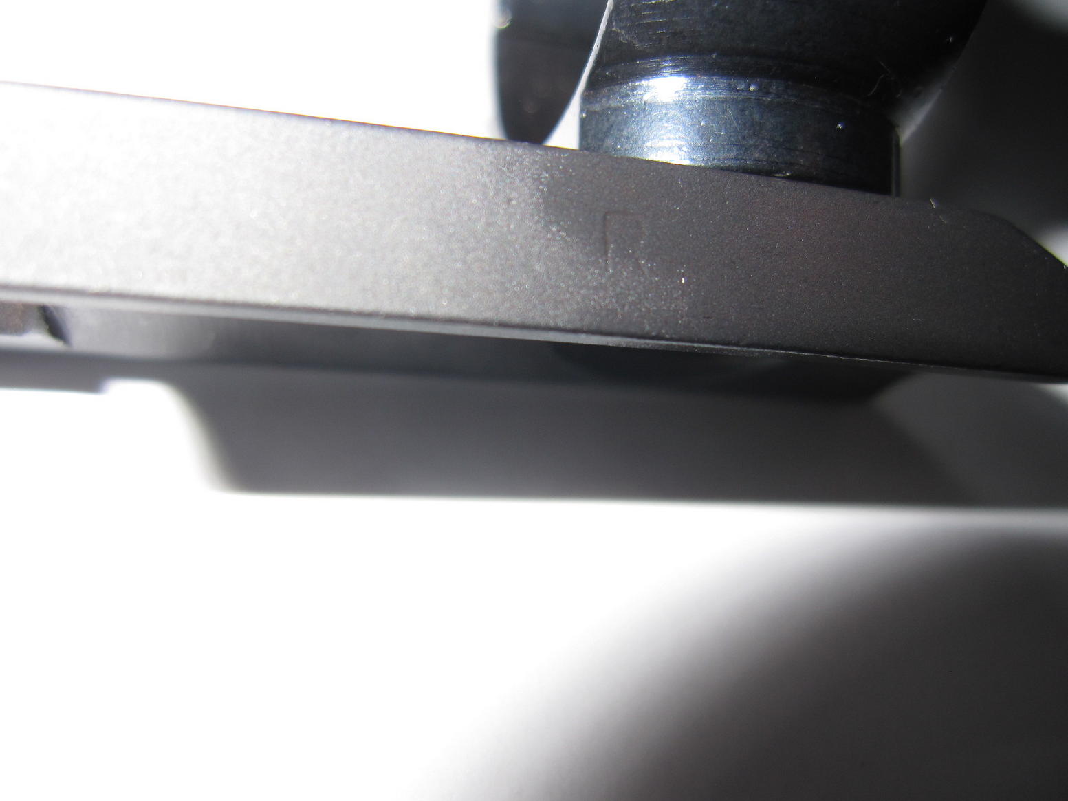

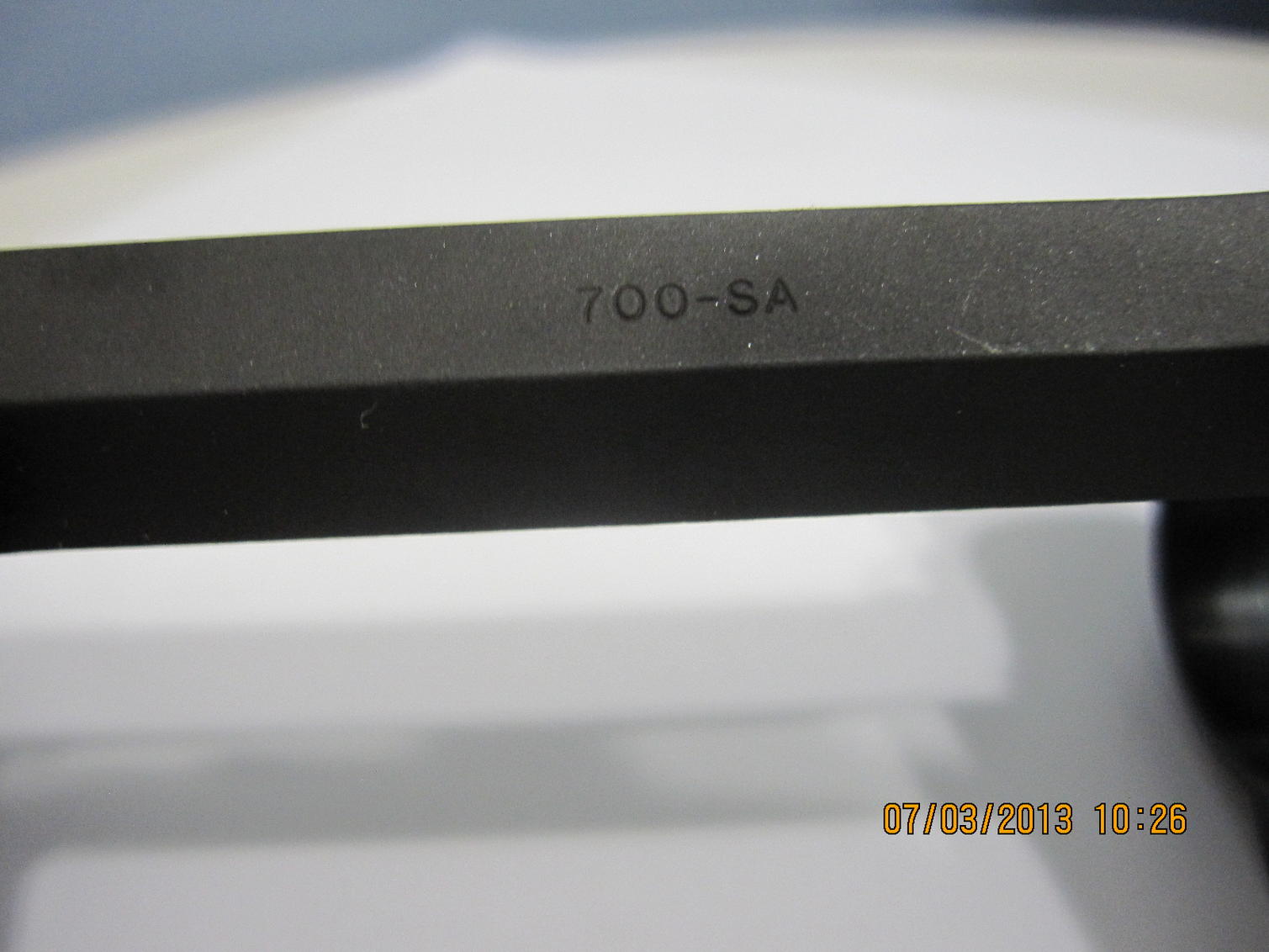

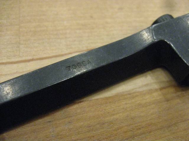

M40 Build Guide/ Redfield mount(s) for the Remington 700 SA ...
The "700SA" is mentioned in a few posts.
I have two (2) mounts, in-hand, one (1) with a matte finish, stamped "700-SA" and a single upper case "R," stamped on the right side-front of the mount (see photos)
and another with a polished finish, stamped 700SA (no dash) with a traditional Redfield logo/trademark, stamped on the right-side front of the mount (see photos)
Q. Are they both Redfield mounts?
Thanks, in advance, for your time and reply.
The one on top, not sure... Redfield maybe, but probably not a vintage piece. But the bottom is Redfield, period correct IMO.
The 700SA bases were used when the original square corners 40X bases were out of production. Or if the a 40X base was lost/broken or whatever. I dont see any reasons not to use a standard 700SA base on a M40 clone.
Be careful with the earlier Remington receivers though... The rear section was lower. I think the switch was made somewhere around 70's? I will have to go back in the thread... We know for sure that the 40X base wont fit the re-design receivers anyway. So unless you are cloning an early period correct M40 with the correct serialed receiver, I would use a 700SA base anytime.
