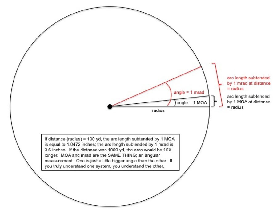

Rob01 and Lowlight will tell you, a mil is a mil. It doesn't matter if it's 100yds or 1000yds whereas with an moa, at 100yds it's 1" and at 1000yds it's 10".
HUH???
A MOA is a MOA is a MOA. Both MOA and mill are angular measurements. A MOA is a minute of angle. A MOA is 1/60 of a degree. A mil is 1/1000 of a radian.
But both of them equal a certain LINEAR measurement at each given range. And that linear measurement increases linearly with range.
A mil is 10 cm at 100 meters. It is 20 cm at 200 meters, and 100 cm at 1000 meters.
And BTW, a true MOA is 1.047" at 100 yards.
HUH???
I know what true MOA is, but thanks for your explanation for someone who may not understand. I also understand IPHY is 'inch per hundred yards', etc.
Perhaps this will explain it better, from Lowlight himself...
Sent from my iPad using Tapatalk

I think what Lowlight is getting at is that the MIL system is true to itself and much more basic in use. There is no over complication of IPHY, MOA, or I ranged it in mils lets convert that over to this and so on.
Animals are inches tall, not MOA or MILs, but constant inches. It's easer for me to instantly convert inches to MOA (if I have to come up 6 inches because the critter is beyond my PBR, its easer to think MOA to get there which (I know 1.047) but for all practical purposes I can click in MOA figuring 1" per hundred yards.
An animal is the same size regardless of the units used to measure it. You are confusing linear measurements with angular ones. It's as easy to 'come up' in Mils as it is in MOA, and maybe easier because there are fewer actual adjustments.
Of course the target is linear not angular, an antelope is X inches tall regardless whether its 100 yards or 200 yards. But that liner measurement is in inches there fore its easer for me to used MOA which for practical hunting ranges or under 600 yards is 1 inch per hundred yards.
What I've been saying throughout this post and some people can comprehend is there are different methods or venues of shooting, some work better with MILS some work better with MOA. So I believe unless one only shoots one venue, then it would be a good idea to learn both.

...an antelope is X inches tall regardless whether its 100 yards or 200 yards. But that liner measurement is in inches there fore its easer for me to used MOA which for practical hunting ranges or under 600 yards is 1 inch per hundred yards.
That linear measurement is not in inches: It's the same measurement; whether in inches, centimeters or binary parsecs. That's the falsity at the core of the myth that MOA is more applicable. Proper technique requires not using 'inches of holdover'.

There is no difference, with regard to using a Mil or MOA system, between using proper technique when locating, ranging and shooting a target while hunting and during a match like the modern version of the 'Cup. That's one reason why PGS does so well at that match (the other reason is that he can read wind in a desert).
...I never said one is better then the other, I said they are different and have different uses.
I agree with you that learning both systems is important. I disagree that Mils and MOA are different systems for different purposes. They are different systems derived for the same purpose.

Kraig please explain how the size of the target or the where the vital area is has anything do to with what system your dope is dialed in ?
If the vital area is 10 inches in size and is 300 yards away, why can't i simply dial 1.5 Mils for my 300 yard dope... how does dialing 5 MOA work any better ? In fact with a 1/4 Minute scope I have to make 20 clicks with a mil scope 15... so the mil scope is better because it is faster and easier, 1.5 mils = 15 easy. 400 yards is 2.2 so that means 22 clicks. 8 MOA on the other hand is 32. Now you have to multiply instead of just slide the decimal.
If you ranged the animal using mils and know your dope in MOA the size of the vital area is irrelevant that goes to your accuracy ? can you hit a 10 inch area with your 300 yard dope on ?
Hence the MYTH.., you are projecting your thought process on to the conversation perperutating the myth that because you look at the animal in Inches (target size) that is why it is "easier" to use MOA which the method to overcome the drop needed, and has nothing to do with hitting the target based on size.
You dope in MOA / 3.43 = your same dope in Mils which requires nothing more than knowing your dope in mils, not knowing the size of the target you are hitting.
I can laser the target in yards, know my dope in mils, understand the target is close enough for me to accurately hit what i am aiming at and fire... If I called the correction to hit a 6 inch target at 300 yards 1.5 Spinny Winnies, if that mean the bullet will go where I am aiming it doesn't matter the unit used. Spinny Winnies are as good as anything if I know what that means.
Your mental process doesn't make it right or wrong, but your explanation of the process is a myth.
