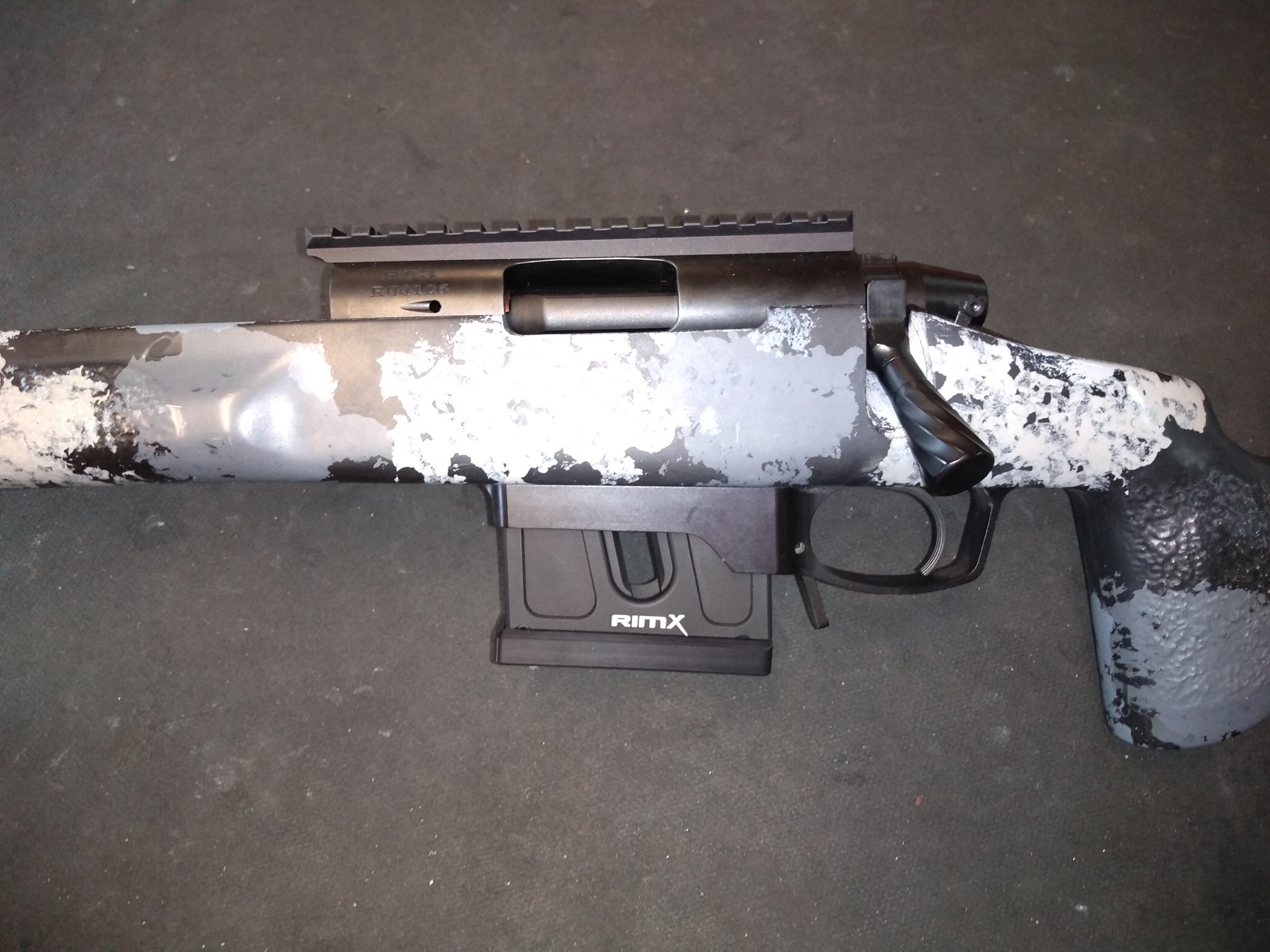

Just received my left hand Rim-X from Zermatt. Dropped it into my Manners T4A that was bedded for my TL3. I had to modify the bolt handle cut slightly for the swept handle, but it fits nicely now. The receiver and magazines are awesome. Machining, finish, and fit are perfect.

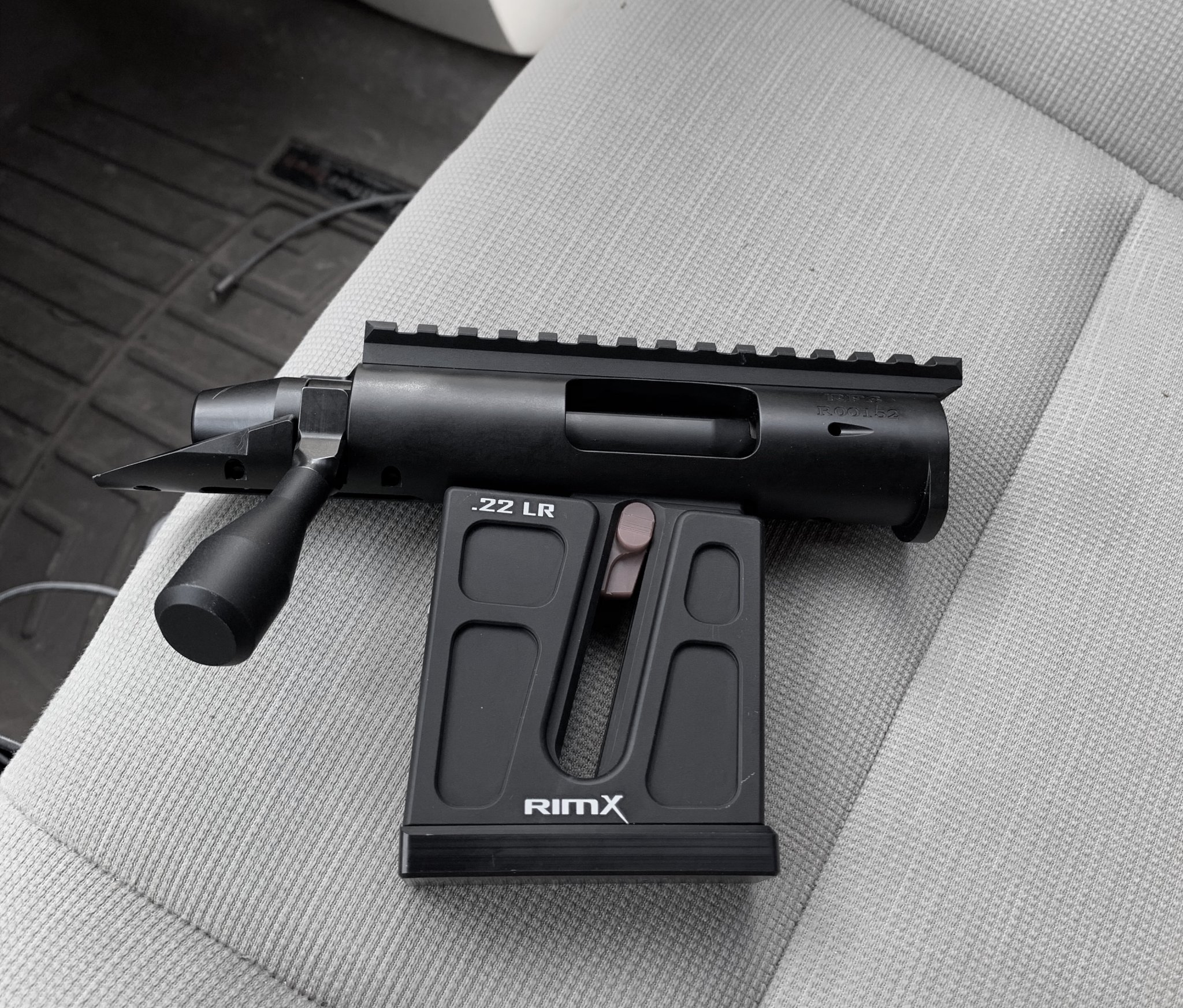

Put this quick 5rd magazine extension video together for you guys having issues with getting 15rd into the mag and lack of spring tension. This video will explain why and how to fix it.
@Redfisher60
Here's a photo of an improperly installed magazine extension/spring... You can see the spring curled at the bottom instead of being 100% straight... installed this way, you will only fit 14rd in the mag and have weaker spring tension
@Redfisher60
Thank you, works perfectly now.

Ray the video padom posted fixed both issues, but without that video, I would not have known how to solve the issue. Some installation instructions would help :) . Thanks.
