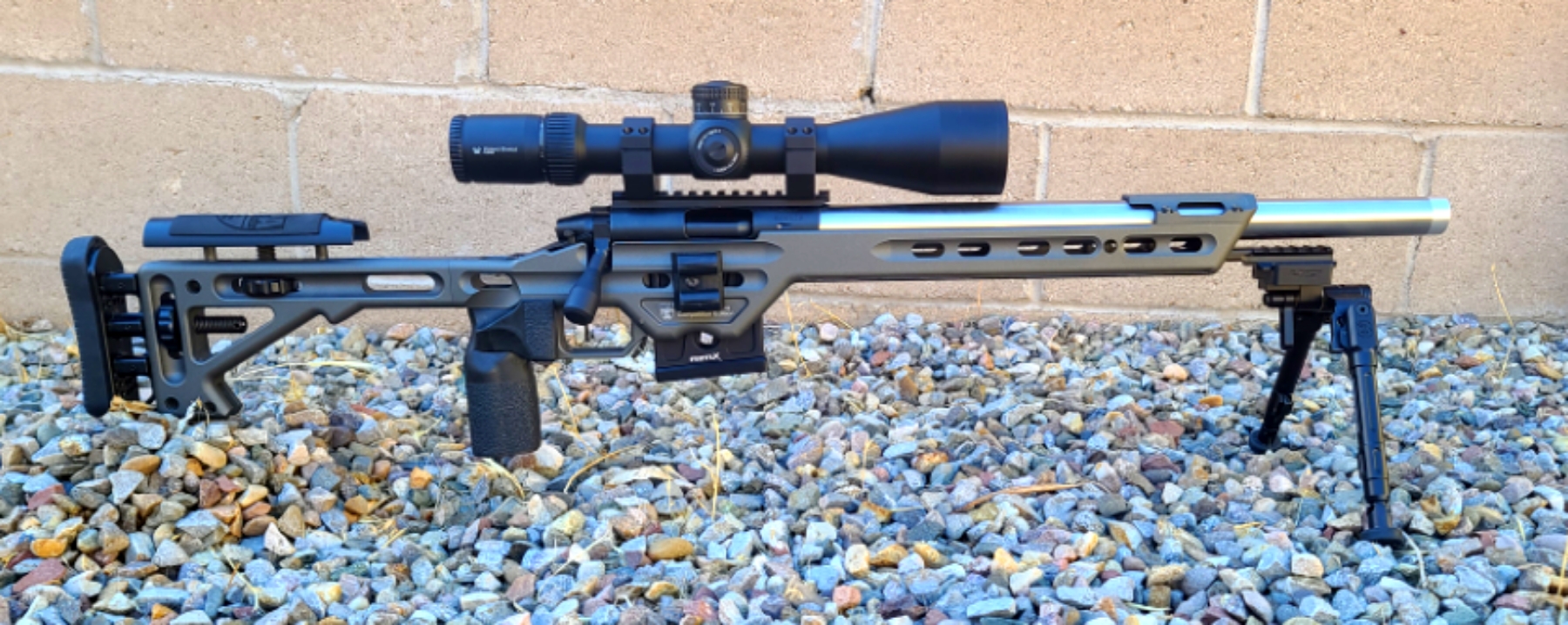

My RimX with an 18" Proof. It is accurate, but not where I would like. I've read through most of the thread multiple times. So what would be my best option for a replacement barrel, maybe a Bartlein, what chamber, who can supply it? Really like the action once I got the mags adjusted. Also have a Vudoo. Thanks guys.

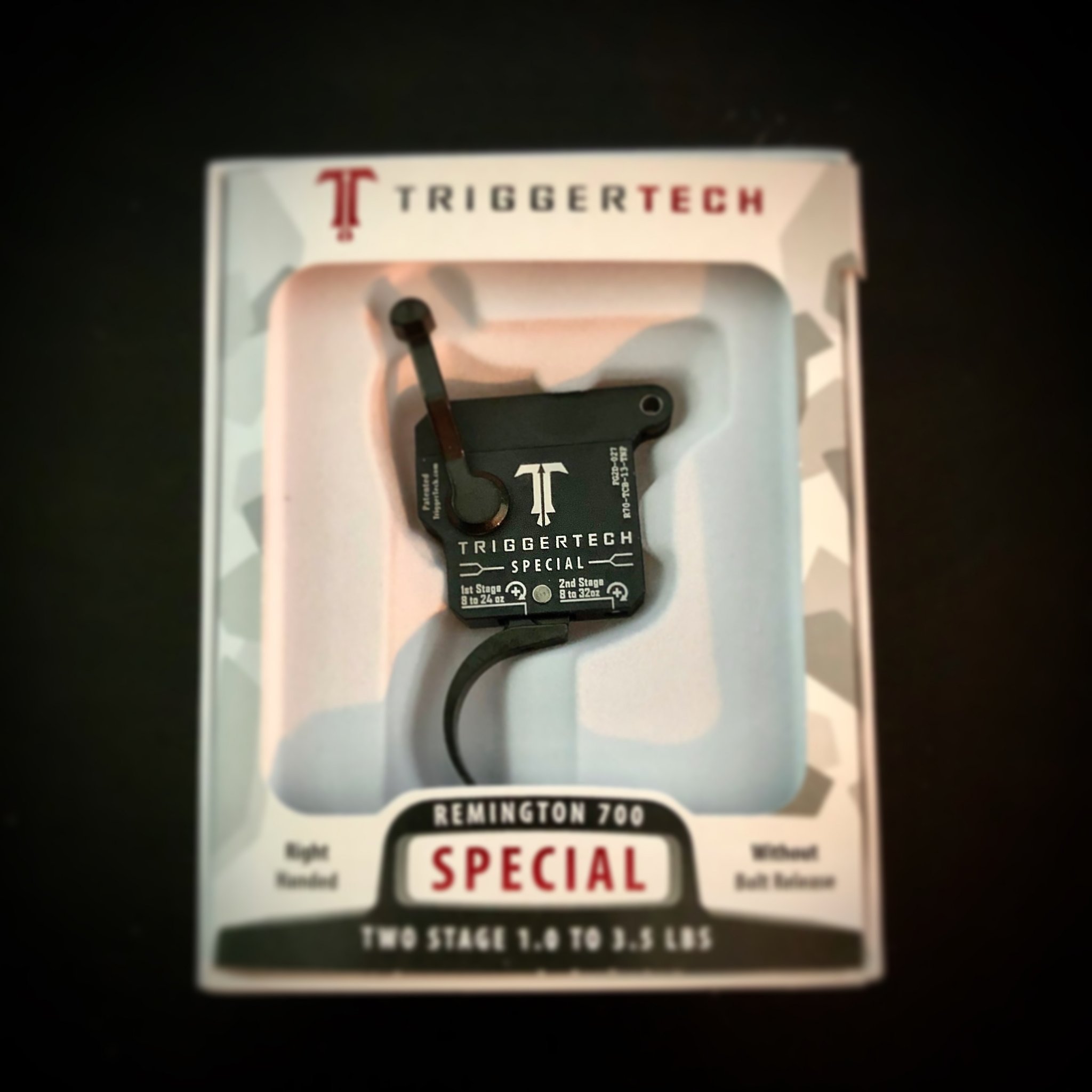

Finally showed up today. Customs had it held up for a little bit. Taking the RimX to the range Sunday to test ammo and the new trigger out. Have a match at the end of the month
