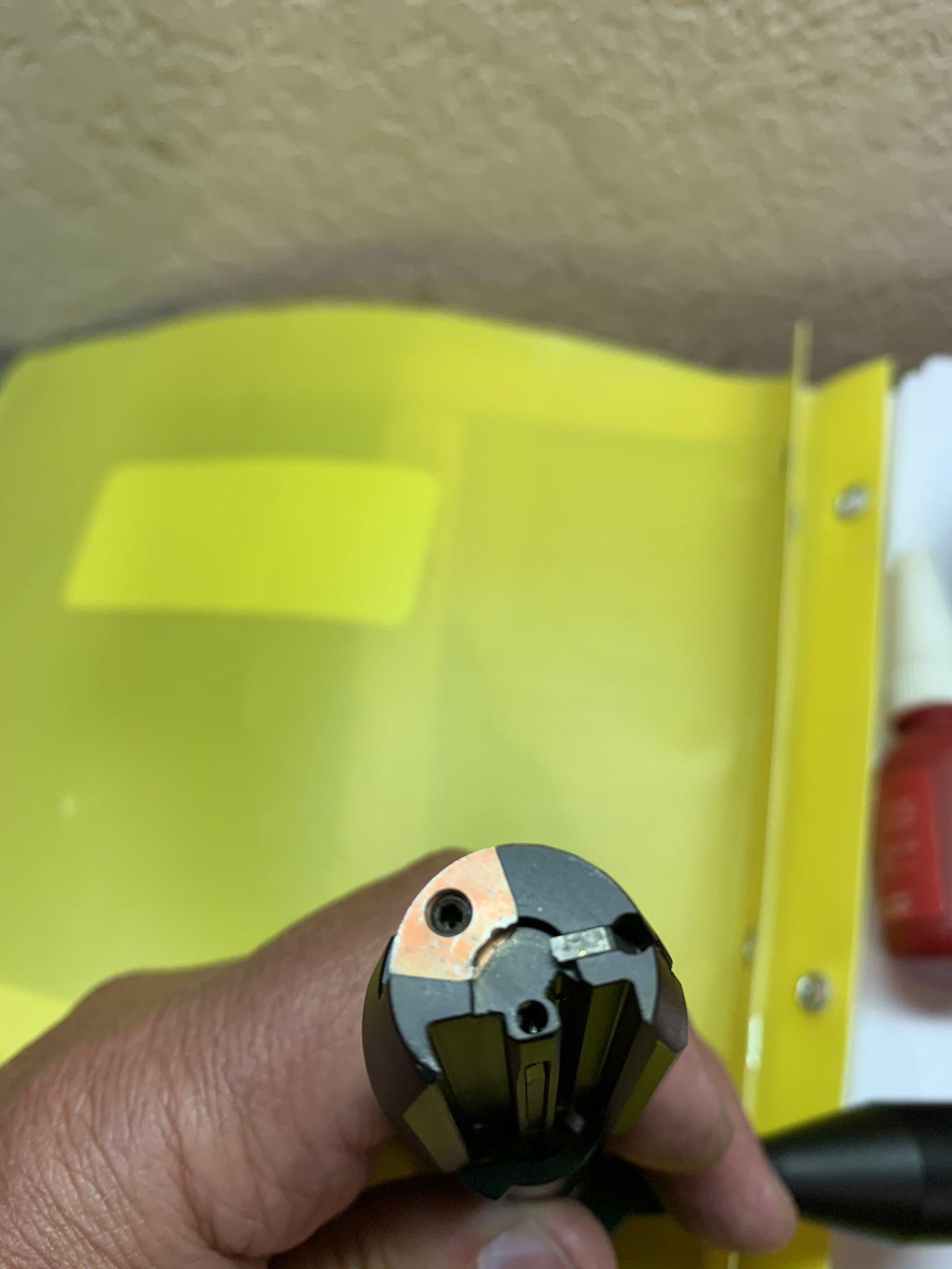

Can someone post or pm me a picture of their bolt face. Dropped my bolt on the concrete floor in my reloading room and it won’t eject rounds or catch the round while chambering a round most of the time now.
Ya, not the angle for bolt nose clearance. The radius around the rim of the chamber on the breech. If a person was to just run a reamer in, they'd have a sharp chamber edge. A Smith will radius that just slightly so a case or bullet isn't sliding over a sharp edge. The RimX requires a little more than normal based on the way the round enters the chamber and slides up the bolt face under the fixed extractor. The rear part of the bullet and case wall slides over the 6 o'clock chamber edge and forces the case head up the bolt face into a full horizontal attitude. Id recommend if someone is chambering a RimX for the first time they have an action present to test feeding. If you don't have enough chamfer it will feel like the round is binding as it enters the chamber. Because it is. Also, you have to be really diligent in setting your mag height correctly before you chamber a single round. Resist the urge to run a couple rounds right off the bat. Carefully watch the first couple rounds you chamber to ensure the rim is being captured under the extractor and not snapping over the rim. 3 out 4 guys I know locally and some of our shooting team guys have all buggered up their extractors and tensioners in the first 100rds. It doesn't take much to damage them. You tell them to ensure they have their mag height set properly and they're like, "...ya, ya,ya....right, right, Tlace the extractor and tensioner and Zermatt is obviously easy to work with, but it's also completely avoidable.

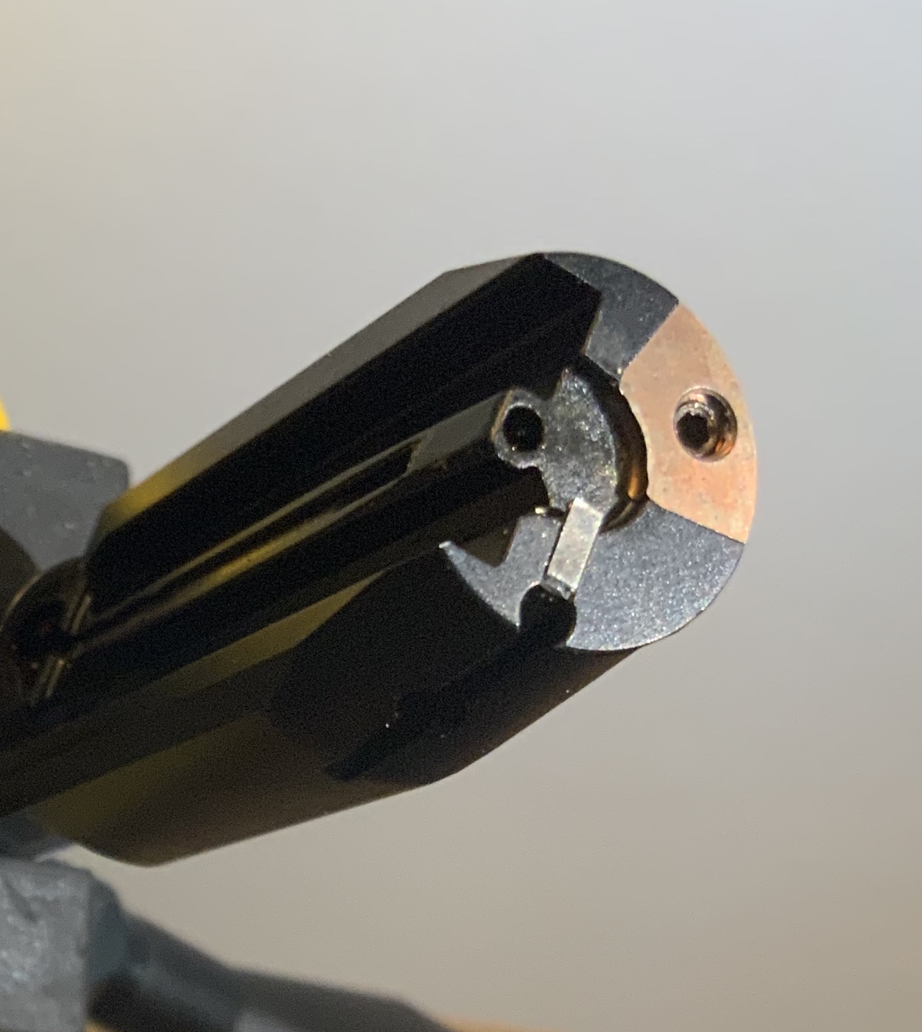

Can someone post pics, hard for me to figure out, will be getting my RimX soon and installing in a AI Chassis and I don't want to mess it up.
As far as the radius on the chamber edge it's hard to comparatively make out by eye. But here's some pics.
Here's a link to a short video of a RimX picking up a round properly. I'm running the bolt very slowly and lightly so it looks rough. Its not but if you know what you're looking for it depicts all the minute points where the round is exiting the feed lips, entering the chamber, shifting horizontal in between the chamber and bolt face...

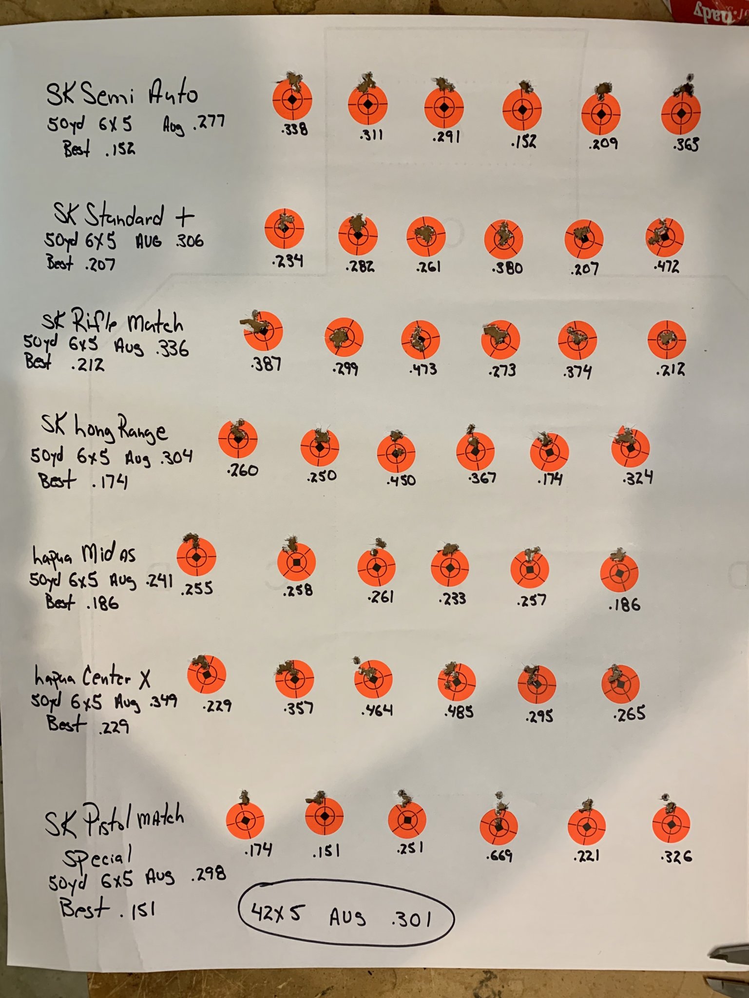

Finally got out to shoot this R50 Orkan sent me to test in the Benchmark with my chamber. I screwed the Benchmark back on and put 1 wet patch down the barrel and then dry patched it out.

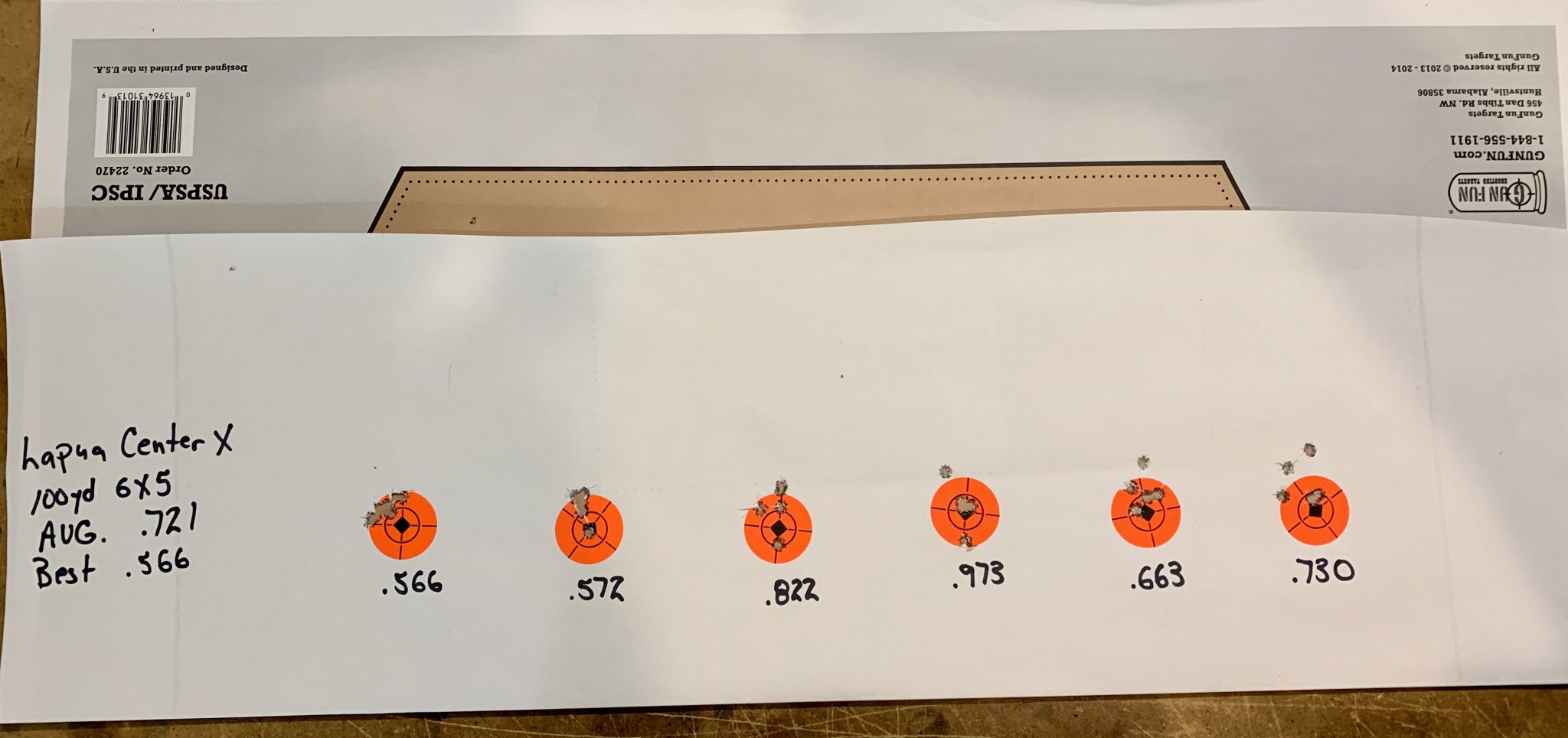

I took it to the range and put 15rd of SK Match RM through it to re-zero @ 50yd since I had to swap barrels, remove scope and had it previously zero @ 25yd with the previous barrel.. Shot the 15rd to get it zero @ 50yd then I shot this 10x5. I shot them in the order marked 1-10 on the target....
You will see below on the 100yd target, I took a picture before shooting the 10x5 of R50 showing the zeroing bullet holes @ 100yd with CenterX as I didnt want to waste the R50 zeroing so I could get a full 10x5. I then covered the 2 that were in the 10x5 with the 2 red dots before shooting the 10x5 with the R50. @ 100yd.
In conclusion, the ammo shot really good. It was 93F out, 82% humidity and dead calm. It was HOT. Not the tightest RimX groups of the 5 barrels I shot, but not off by much either. It was the best 50yd 10x5, 6x5, and group size of everything I shot through the Benchmark RimX to date at just over 0.2" with an impressive 0.042" group and many in the .1's... At 100yd, it shot really well in the .6"s both 10x5 and 6x5 which is pretty darn consistent with smallest group measuring 0.321"... Not bad at all.
50yds
10x5: 0.264"
6x5: 0.216"
Best Group: 0.042"
100yds
10x5: 0.698"
6x5: 0.655"
Best Group: 0.321"

Hi Padom, Please don't take this question the wrong way, just trying to understand your measurements. Are the measurements center to center? Group #6 at 50 yards looks like center to center is about 2 bullet diameters but measured at 0.179" which is less than one bullet diameter.
Hi Padom, Please don't take this question the wrong way, just trying to understand your measurements. Are the measurements center to center? Group #6 at 50 yards looks like center to center is at least 2 bullet diameters but measured at 0.179" which is less than one bullet diameter.
All measurements are the same way OnTarget scores CTC (center to center) and how every 22LR ive posted is scored. Outside to outside minus .223.. Now, some will argue the bullet holes are smaller than .223, which is true. But thats how JBM Ballistics, my Kestrel, OnTarget software app, all measure and reference 22LR bullet diameter so I subtract .223. Ive been consistent in the way Ive measured every target. Hope that answers your question. We arent competing for Gold medals here or winning prizes so do what you want with the info.
The size of the actual 22LR bullet hole in paper varies, depending on the type of paper, used also. Example, I am measuring these bullet holes in this specific paper with a caliper at 0.117". Just for your reference
