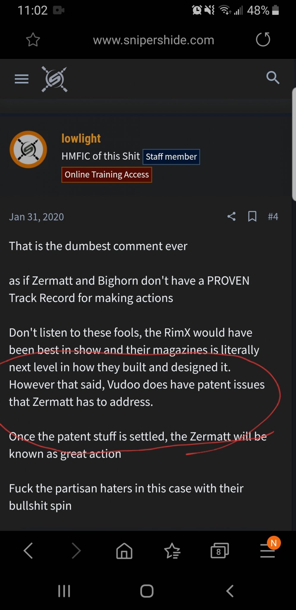

I am getting ready to order a rimx action. My question is, with the lawsuit with vudoo over the mags. What could come with it? If vudoo wins would zermatt have to redesign the mags? I guess I'm just nervous to order an action only to have it obsolete after the lawsuit.
How would it be obsolete? Its a proven action, proven magazine. You buy the action and the mags, it works just like the rest of ours does..... It doesnt stop working because of a lawsuit, if there even is one.....
I believe Zermätt worked out an agreement with Vudoo on this when they were making the mag. I don’t think there are any issues between Zermätt and Vudoo. But don’t quote me on that because I could be dead wrong.
The only potential patent issue I’ve heard about is the magazine for the Bergara B-14R. As far as I know, however, nothing has happened between Bergara and Vudoo yet so I don’t know if there is actually a problem or not.

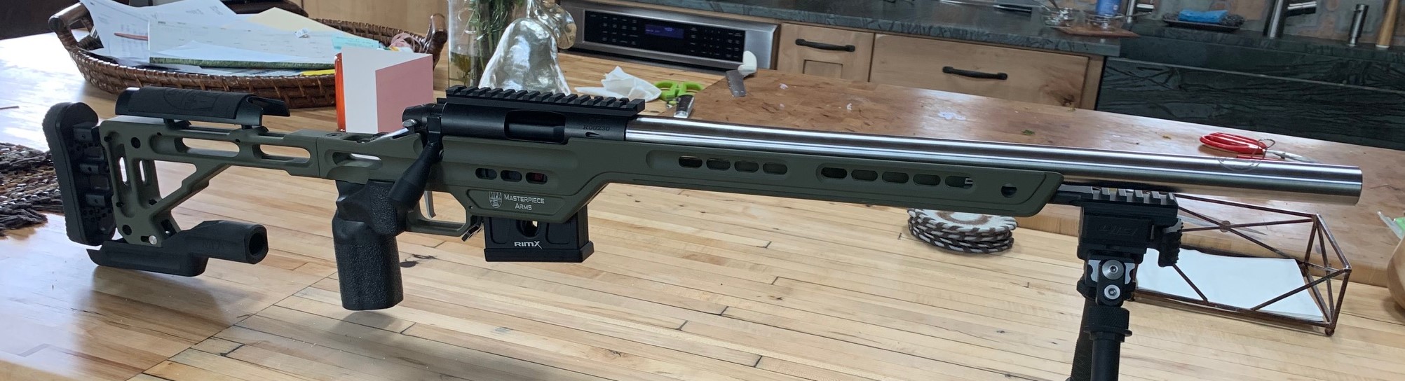

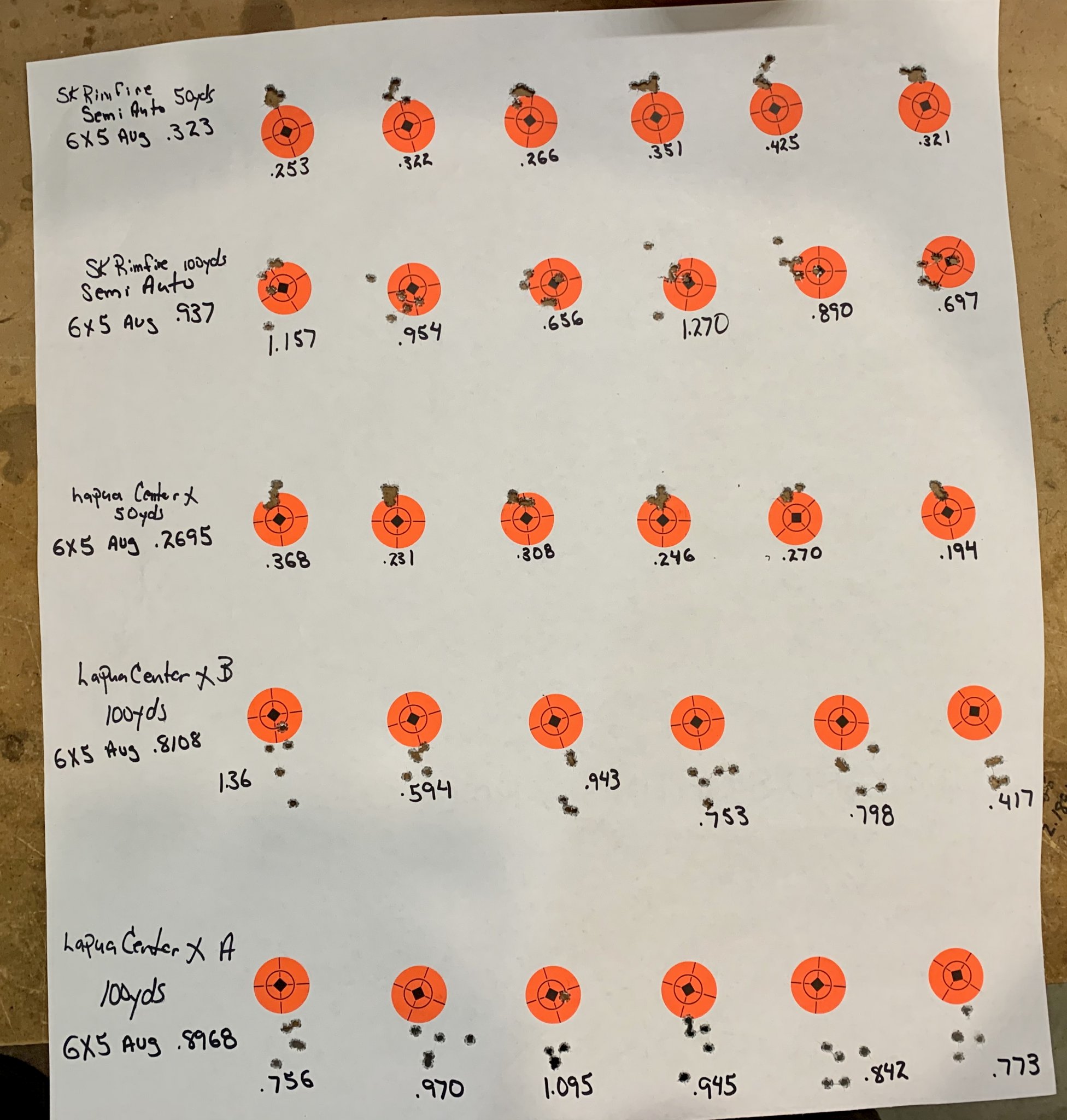

Got out with the RimX to try a couple of different Lots of Center X. Was just using the SK Semi Auto to get rounds down the barrel and was really surprised by its performance, especially for $5 a box ammo.
RimX
Green Mountain M24 @ 18”
Bix and Andy TacSport
Manners T2A
Keystone Accuracy did the barrel work.
Mine and my buddies Green Mountain both are fast barrels. My 18” with Center X chrono’d 1125fps and his with a 20” and Center X was 1122fps.
