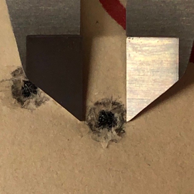

Padom, the work you have done here is incredible! So much so that it has inspired me to build a $4K .22LR based on your test results! These comments are not meant to be dis-respectable. The method of measuring the outside lead smudges to determine group size is flawed. Variables like the paper type can have a huge impact on the result. Below are two photos of the same .22LR bullet hole (S&K Long range) and a Mitutoya caliper with the jaws just outside the lead smudge marks. Note that the first photo show the measurement of .1940" (nearly 3/100" under size) and the second photo is simply a close up of jaws and the bullet hole of the same shot. Note that the paper type is from the National Target Company. I have competed in three position and prone NRA/ CMP and international shooting matches for over three decades and this has been an issue in these shooting disciplines so scoring gauges and scoring plugs are commonly used on close to the line shots.
You're splitting hairs here. The way I and 99.9999% of the rest of people here and anywhere else is consistent. Nobody is using 50x magnification to go oh damn your so far off your calipers are .003" off from the actual edge. We arent posting these results for $10 million prize...
If you want to eliminate using calipers, subMOA is a free app or ballistic X is inexpensive for smart phones. You have to learn the icons but then it's pretty easy to use. I personally think calipers are good enough for what we do, just measure outside of ring to inside of ring and you have your center to center measurement. Or measure c-t-c to directly with your calipers, It's not rocket science. Like Padom said, no prizes involved, so why question the shooter, the visual group should speak for itself. I'm just amazed at the accuracy of these 22lr groups. It's a great time to be shooting rimfire these days!
Reactions: Schütze
I have OnTarget and been using it for years for everything except 22lr.. the 223 ring is way bigger then a single bullet hole so its more accurate to use calipers for me vs trying to decide with the app where the center is.. its all good enough though.
The fact that you post photos and videos online showing the results is awesome and provides all the conformation that is needed. These visuals provide a great summary of the overall accuracy. BTW that's .030" ( 3/100's) in the above photos not .003" (3/1000's). The accuracy of these things are incredible. Also your using 20" barrels in all of your tests. Do you have any recommendations on optimal barrel length for accuracy?

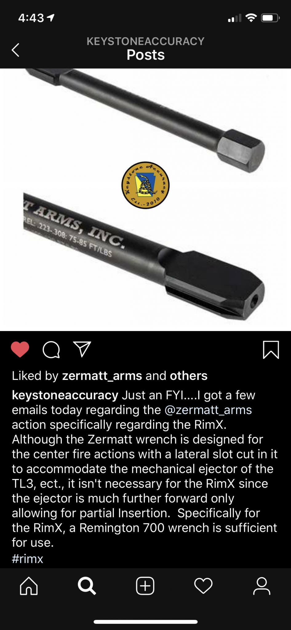

Any reasons I shouldn’t be able to do it myself with my barrel vice and a wheeler Rem 700 action wrench ?
Per PVA the rem 700 rear action wrench fits Zermatt receivers, but I can’t confirm this since I do not have one.
l’m sure someone else knows and can answer this

I imagine you need a wrench with a slot for the ejector (for Bighorn actions in general) or you have to remove it
I can’t say what wrenches you can and cannot use, but in listening to Ray @ Zermatt on the PRM podcast , don’t remove the ejector from the action when torquing barrels. The lug engagement ( or lack there of)forward of the ejection port is not where you want to put your rear entry action wrench.
I had taken my ejector off prior to hearing the podcast or having my barrel and dry fit my own action wrench. It was very loose Ahead of the port - as designed, but unbeknownst to me at the time.
Ray also mentioned running barrels everywhere from hand tight to 25 to 40 ft lbs.
Good info.guys. That is the kind of ZERMATT ACTION WRENCH AM USING from the above post.That wrench set half way of the action and does not set further more forward AND AM WORRIED ABOUT THAT IF i should go more than hand tight.
IS REMINGTON 700 WRENCH KEYSTONE IS TALKING they mean WHEELER ACTION WRENCH FOR 700? OR ANY PICTURE FOR THE REMINGTON 700 WRENCH?
