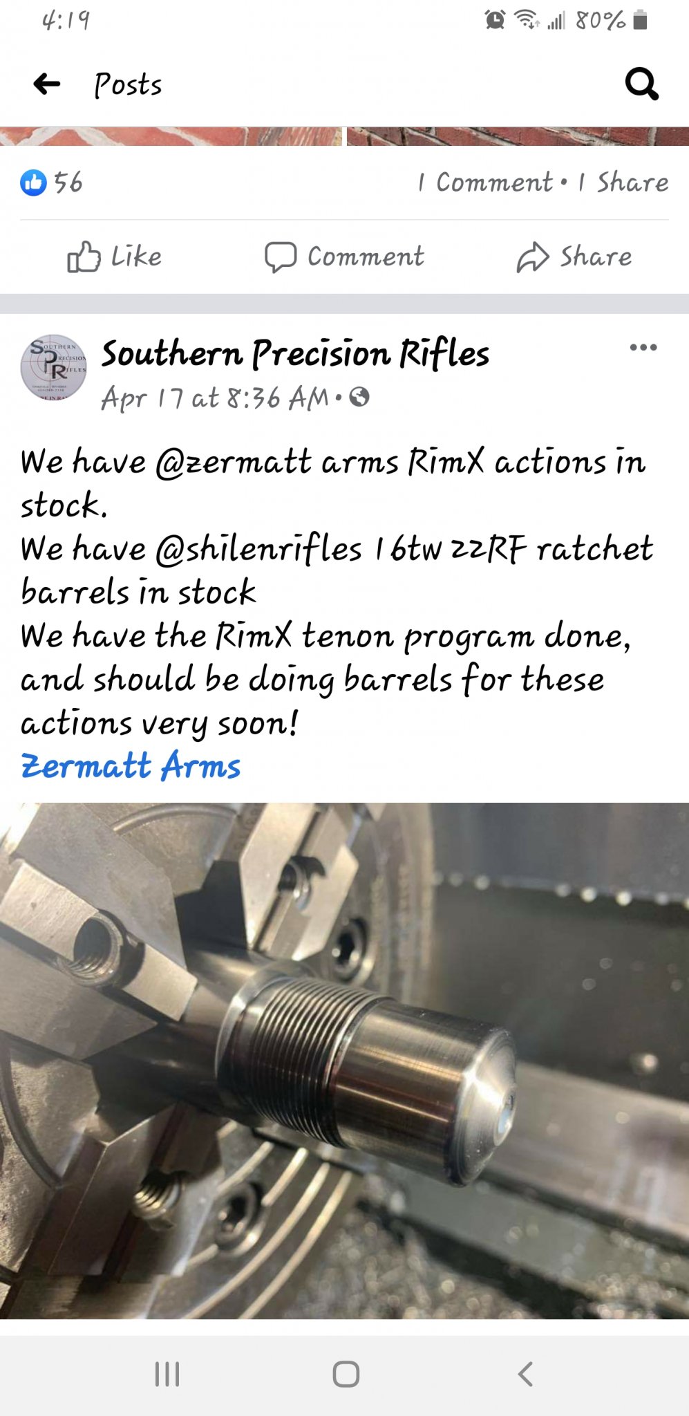

I have chambered four of these new rimx actions in my shop and I think they are great! My personal rifle is a laser and every bit as accurate as my benchrest rig. Great product!
