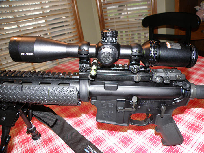

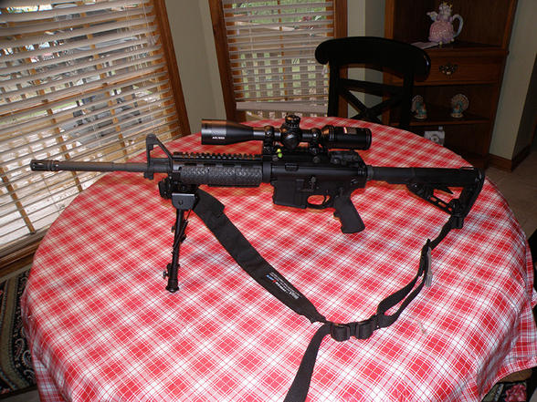

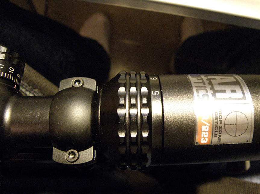

My preference is the vortex razor HD II, 1-6 power. It has excellent glass, a useable and simple BDC reticle similar to the ACOG but with more mag on the top end and a very nice 1x red dot on the bottom end.
