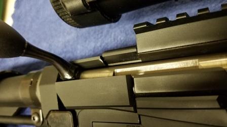

Just a few questions, I have traded for a 6mm creedmoor rpr and it won't hardly chamber hornady 108eldm factory ammo they are jammed into lands hard.. Factory ammo measures 2.790 oal,
My dummy round that cycles well slight jam 2.690 oal
Anyone seen this?
Its interesting you mention this. I have a gen 1 .308. It never did this with factory ammo, but did when I first started reloading. I measure all my rounds to 2.80". Every time I went out, 2 or 3 rounds would jam and the bullets would be scored from the rifling. Since it only happened a couple times each trip, I just figured it was my mistake reloading, especially since I was new to reloading at the time.
However, one day I went out and my barrel nut came loose all on its own. I tightened the barrel nut back up (to I think 70 ft lbs). I don't know if it's directly related, but I do know that I've never had a single problem ever since.

I checked the nut it is tight.
called ruger to ask about how much free bore I should have didn't get a number, they asked what measurement I was getting.
they overnighted it back to there place to look at it. Should know something pretty quick the lady said.
Super nice people to deal with so far ill let you guys know what comes of it.

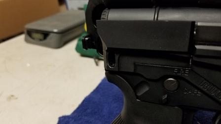

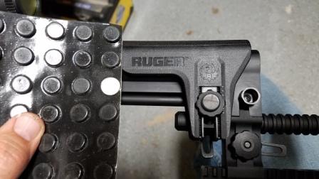

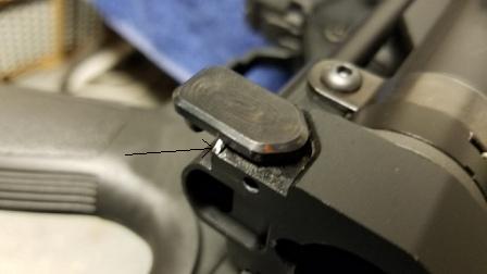

When I first received my RPR I had a few small issues. Here is what I found to fix them. I have the GEN 2, 6.5 cm, Vortex Viper 6-26 X 50 with tall Vortex Precision rings and a Harris bi-pod.
First it looks like they did not de-burr the parts before coating them. This leaves sharp edges and small amounts of metal at the edges. One, it does not feel good to have sharp edges and two, some of the parts don't fit well. When I picked up my rifle they had to use a hammer to push the button to fold the stock. They stated they had to do that with every RPR they received. The issue can be fixed with 330 or finer sand paper and a small dowel or hex key to wrap the sand paper around. I just knock down the burrs around the stock locking hole. I used some grease and just went slow until it opened with only a slight rub. I then worked the button back and forth about 30 times to mate the two. It now works very smooth with no play at all.
On the keyed part that locks into the stock, I had to file a rough end so that that part can rotate to lock the stock into the folded position. Some don't even know the stock locks back. I also added a small peal and stick black rubber bumper to the cheek knob so it doesn't rub on the rifle. This also helps align the folded stock so you can lock it in the folded position.
Another issue is the bolt hits a valley 3/4 back so it's not as smooth as it could be. This is due to the miss alignment of a piece that should be flush with the action but is not. If you work the action enough times it will smooth out but it shouldn't have to . If you wanted to take the gun apart and refit the piece then the bolt will run smooth except for the zipper nose that is due to not polishing out the machining. The zipper noise is slowly going away. Also, make sure you torque all the bolts, many were loose. I have pictures that illustrates all this but they are too large at the moment to post.
