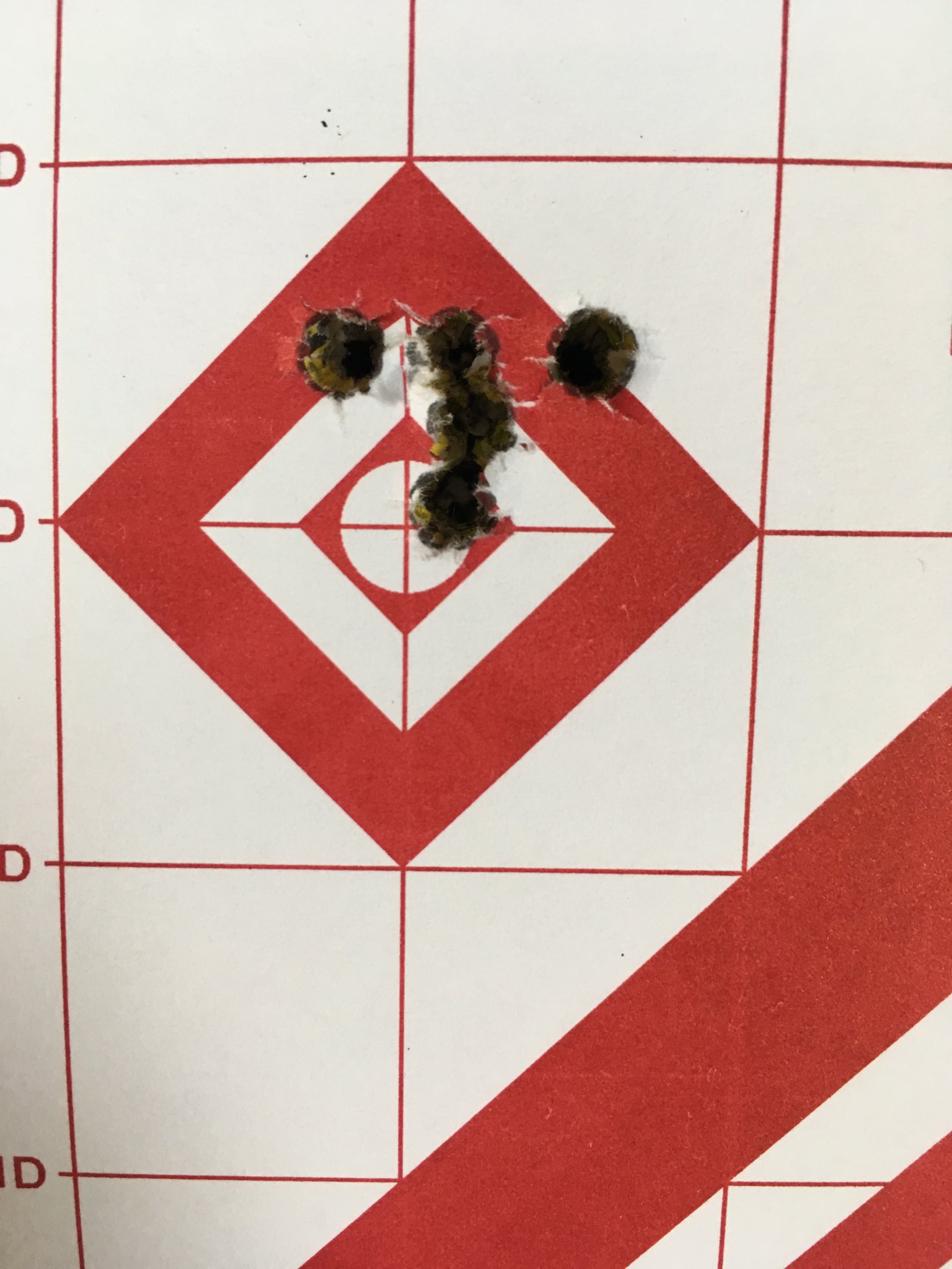

FWIW I shot some Hornady American gunner 140 HPBT 2633 ft/sec avg with a 13.7 SD. Not too bad IMHO considering the price point of the ammo. 10 shots recorded on a magneeto speed.

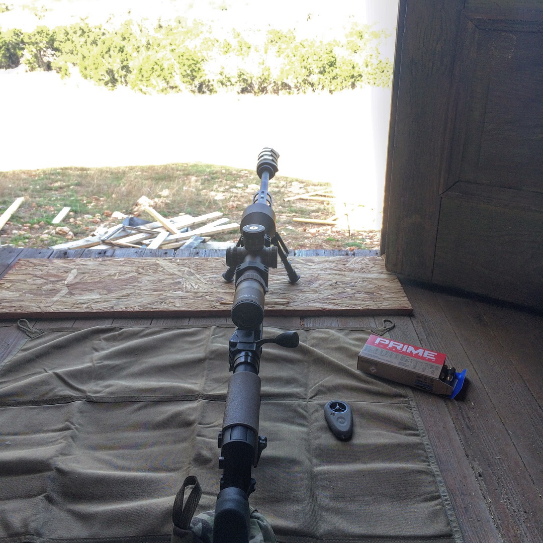

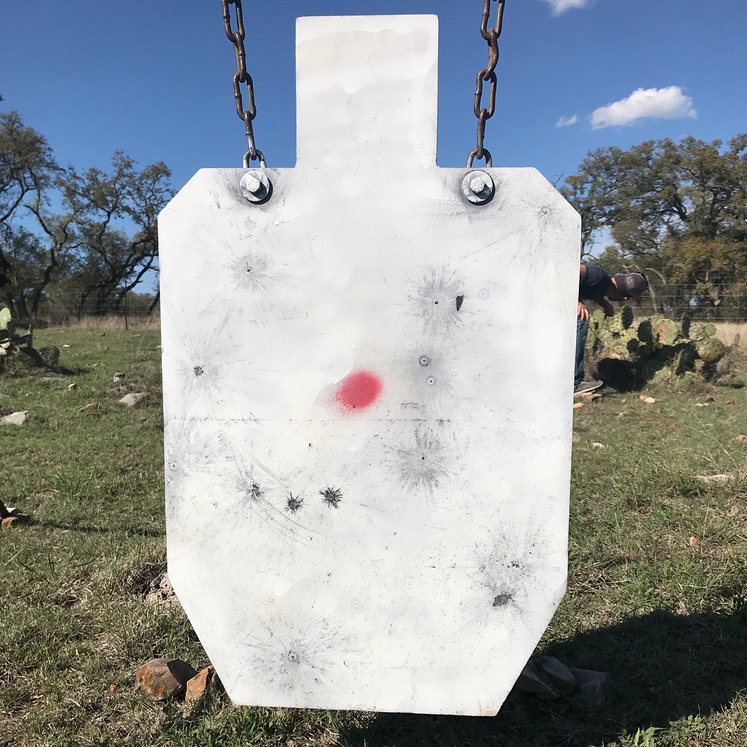

This past Saturday I got to finally get my 6.5 out to my land and do some steel ringing. Went from zeroing that morning and by the afternoon it was ringing steel at 1050 yards. Shooting Prime 130s. First time to shoot this distance and I’m hooked! Love it!
