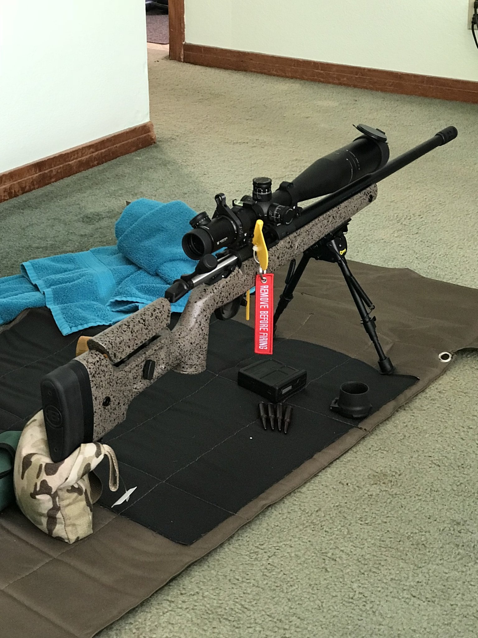

My setup Bergara B14HMR 6.5cm with Vortex Viper PST shooting my first match in April here I’m dry firing practicing

^^^ If I was buying a match rifle, I’d buy one that has a crap ton more features, is more customizable, is probably more accurate, and cost about the same price. Something like.. I dunno.. an RPR
