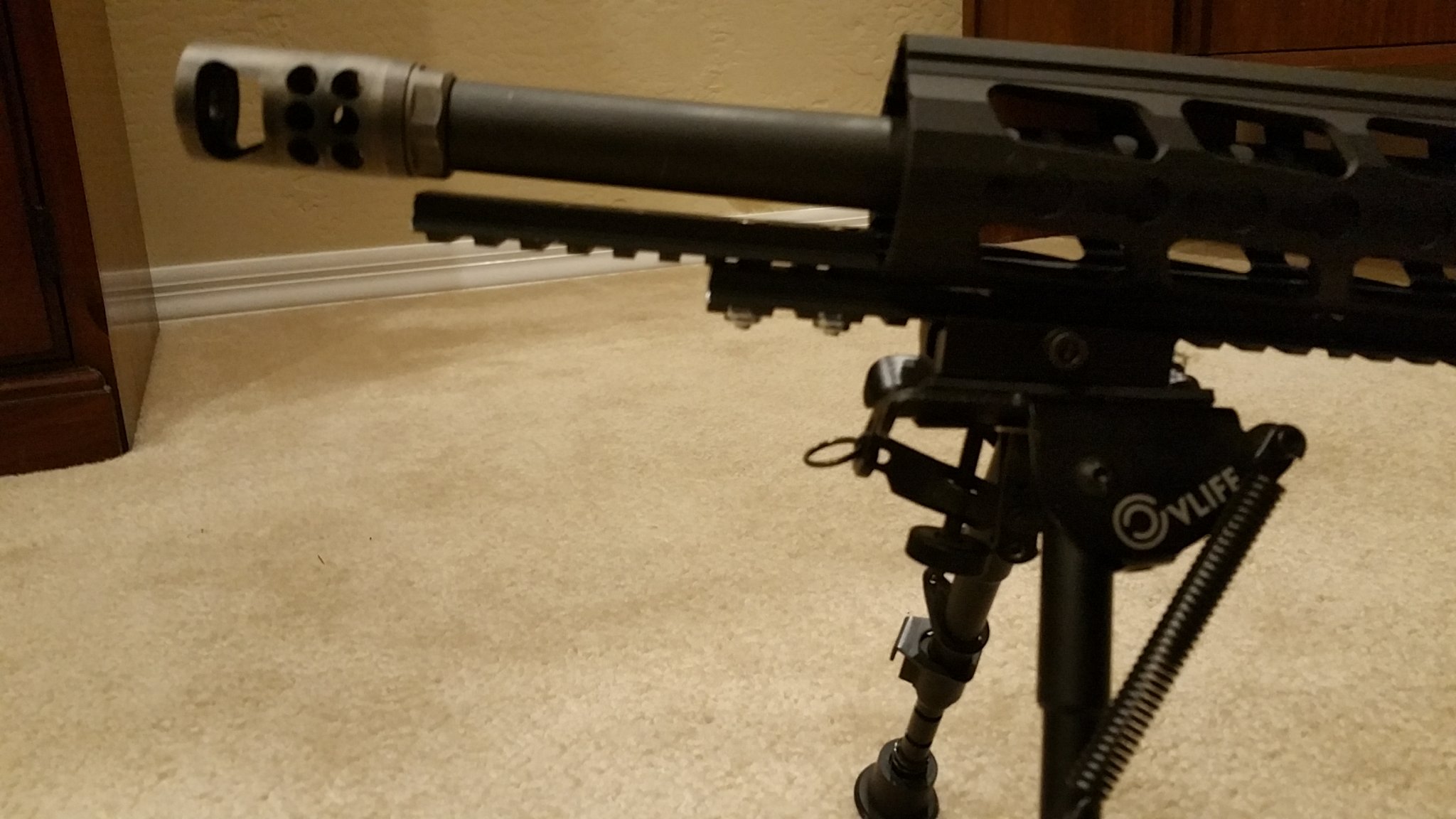

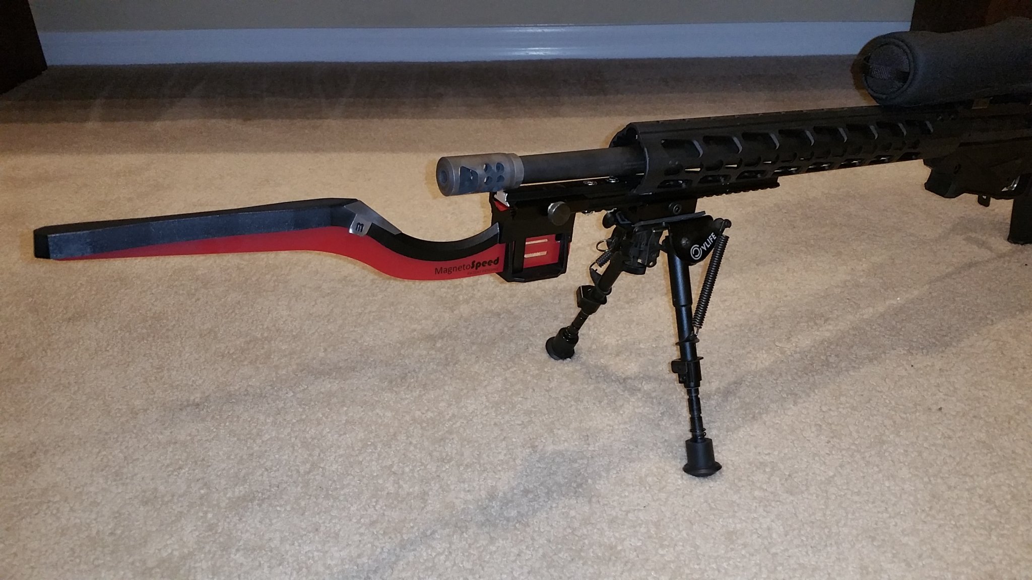

I can see that now. I've seen a few that were mounted to a stand beside or under the barrel. Not sure I want to hang it on the barrel/suppressor due to POI changers.
There was a significant POI shift on my RPR .308 when I had my Magnetospeed attached to the barrel. So, I jury-rigged a rail mounted to the hand guard to mount the Magnetospped and it's been working pretty well (though it's NOT pretty).
Unique idea. I was told by a friend that MAGNETOSPEED had one available as well, but was very pricey for something that gets used so little.
Actually, Magnetospeed does not have anything that keeps it from being mounted onto a barrel. They do have an adapter to mount on a picatinny rail (like off a pistol or a rifle with a hand guard with rail that goes almost thee full length of a barrel). There is an aftermarket product (very pricey) using jointed shafts so as to not mount on the barrel. I just didn't really like the design. So, I created this rail to use the Magnetospeed adapter.
