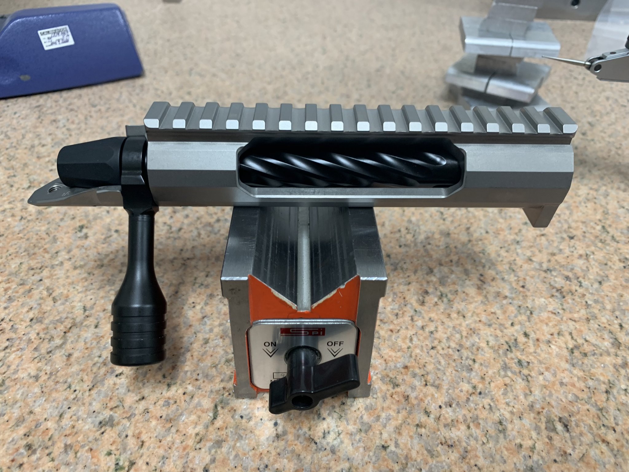

I have owned several Ti actions and presently own 4. I really like them for light weight. I have two LPA with integral bases, a Ti Xtreem (?spelling) 700 foot print long action and a Mauser that is titanium in every part, spring, screw etc. All have been issue free, accurate and a couple have a lot of use and rounds. I would never hesitate to use one where weight is a consideration.

There is alot of titanium here vs the new Defiance TI X
