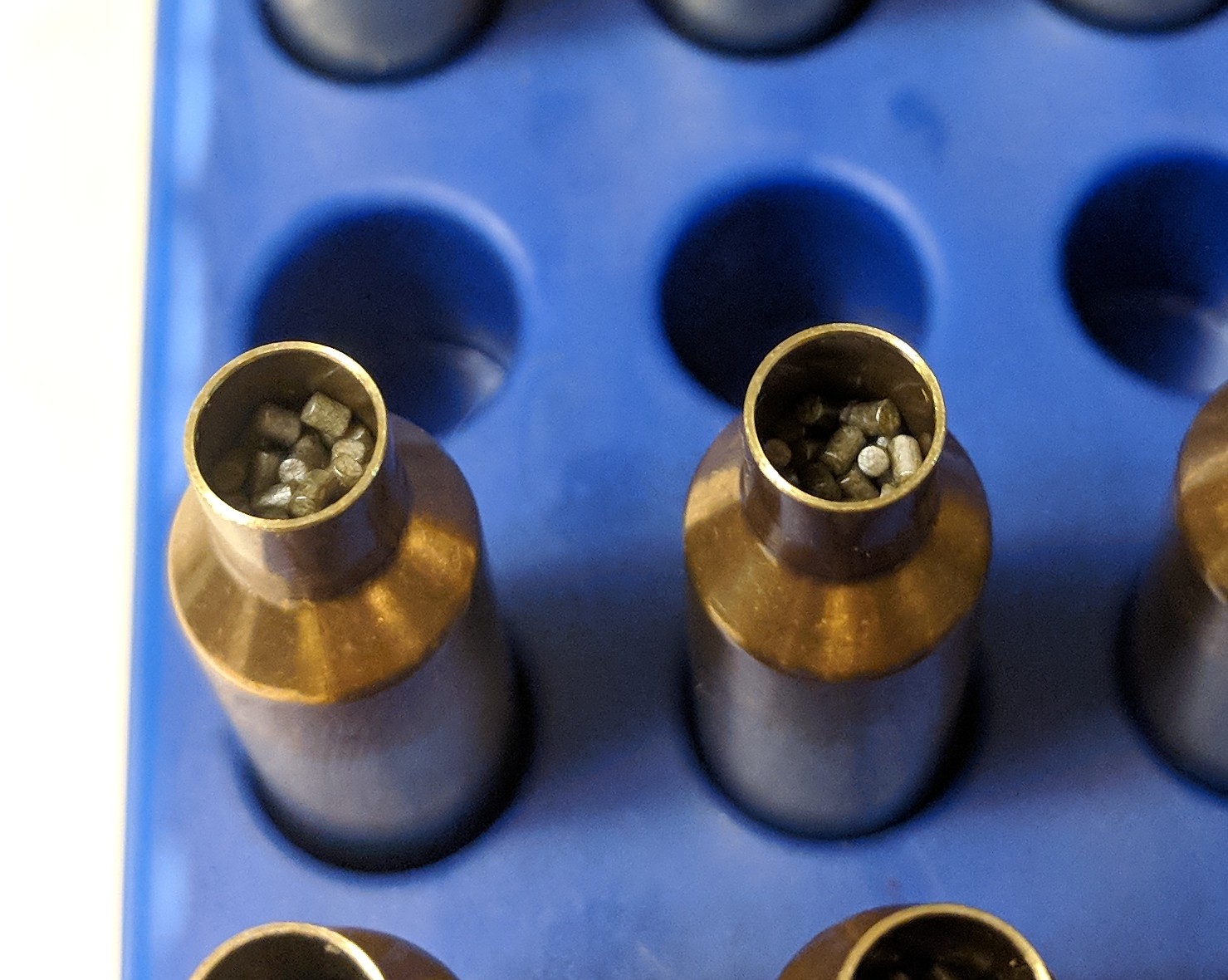

Picked up some H1000 to try. Hogdgon says I can stuff 48.0 gr in there as a Max load, compressed of course. This is 46.8. I've never done compressed loads, just going by my photo, is this a no-no?

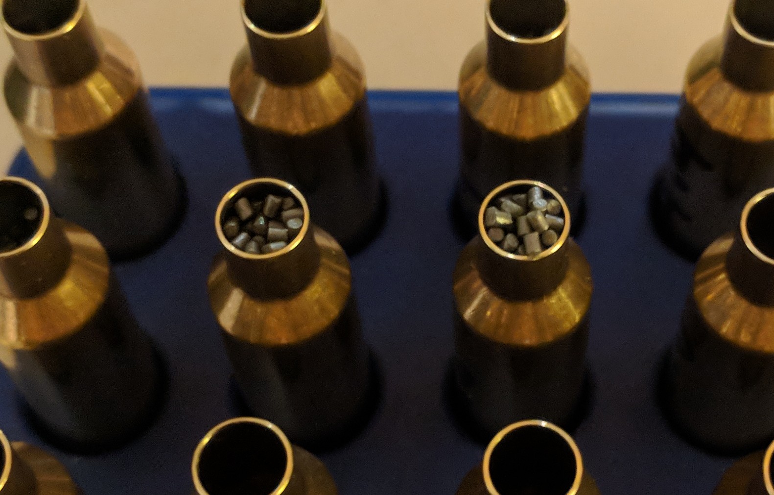

Drop tube made some difference. No way I'm getting 48.0gr in there, this is 46.8 Peterson SRP brass. Again, never having done compressed loads before I'm not sure if this is a bit much. I've got loads from 43.2 to this in .4 incremei. We'll see this weekend!
