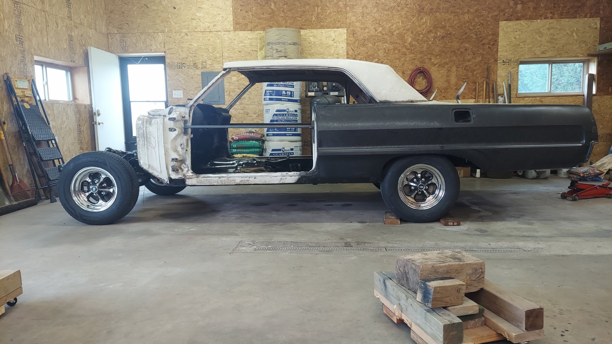

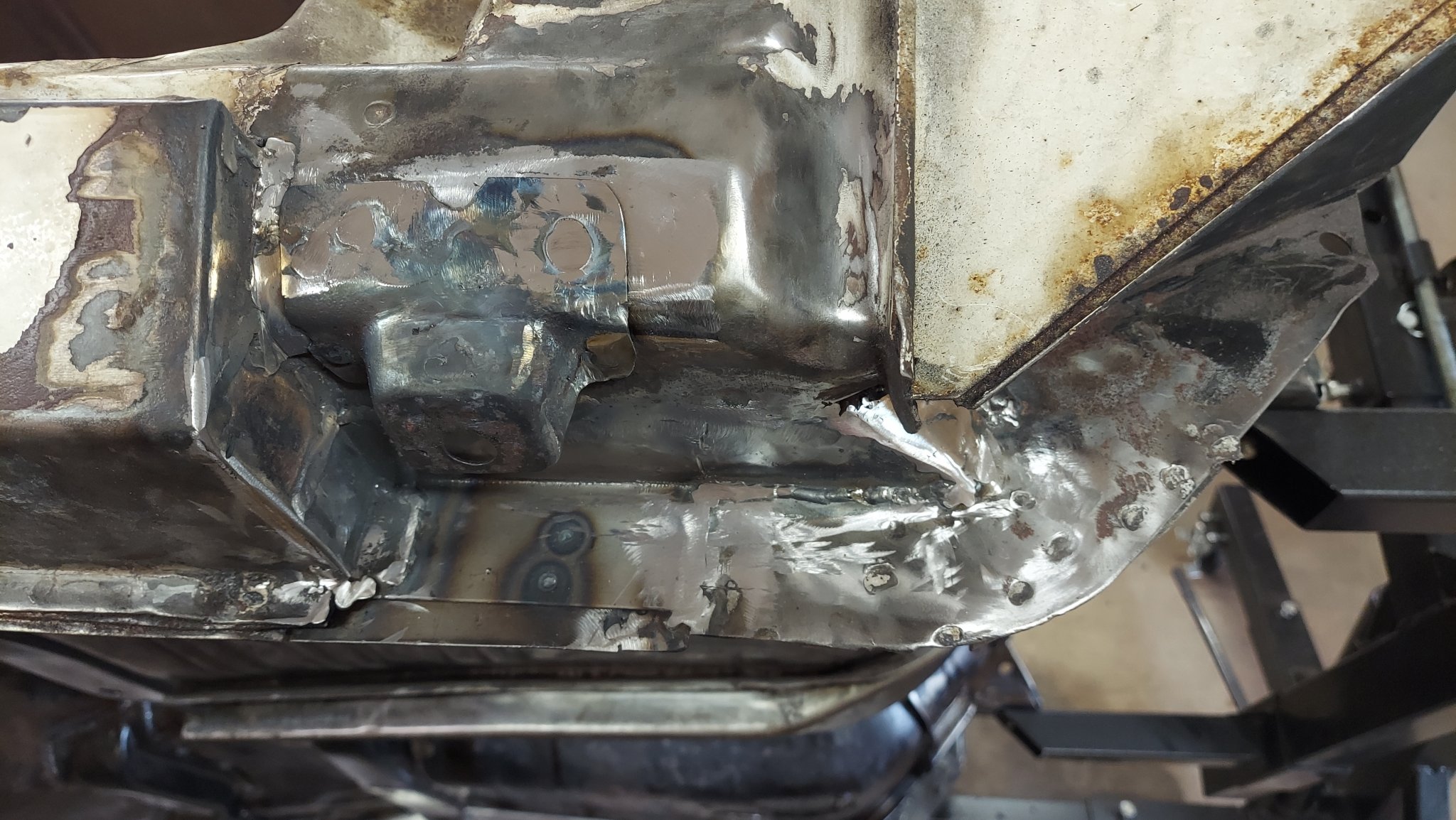

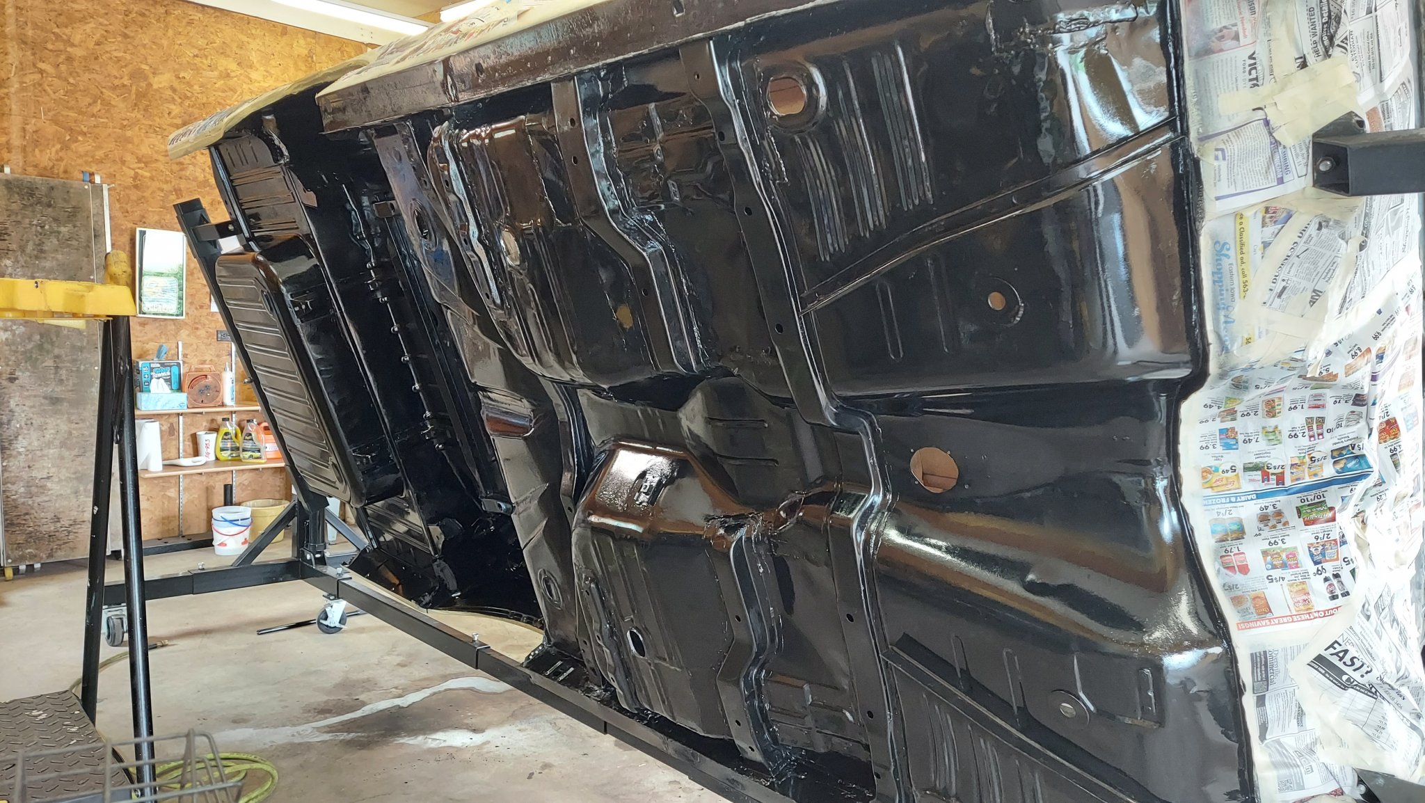

The Impala I posted about while ago got mated to the new frame.
All painted and ready

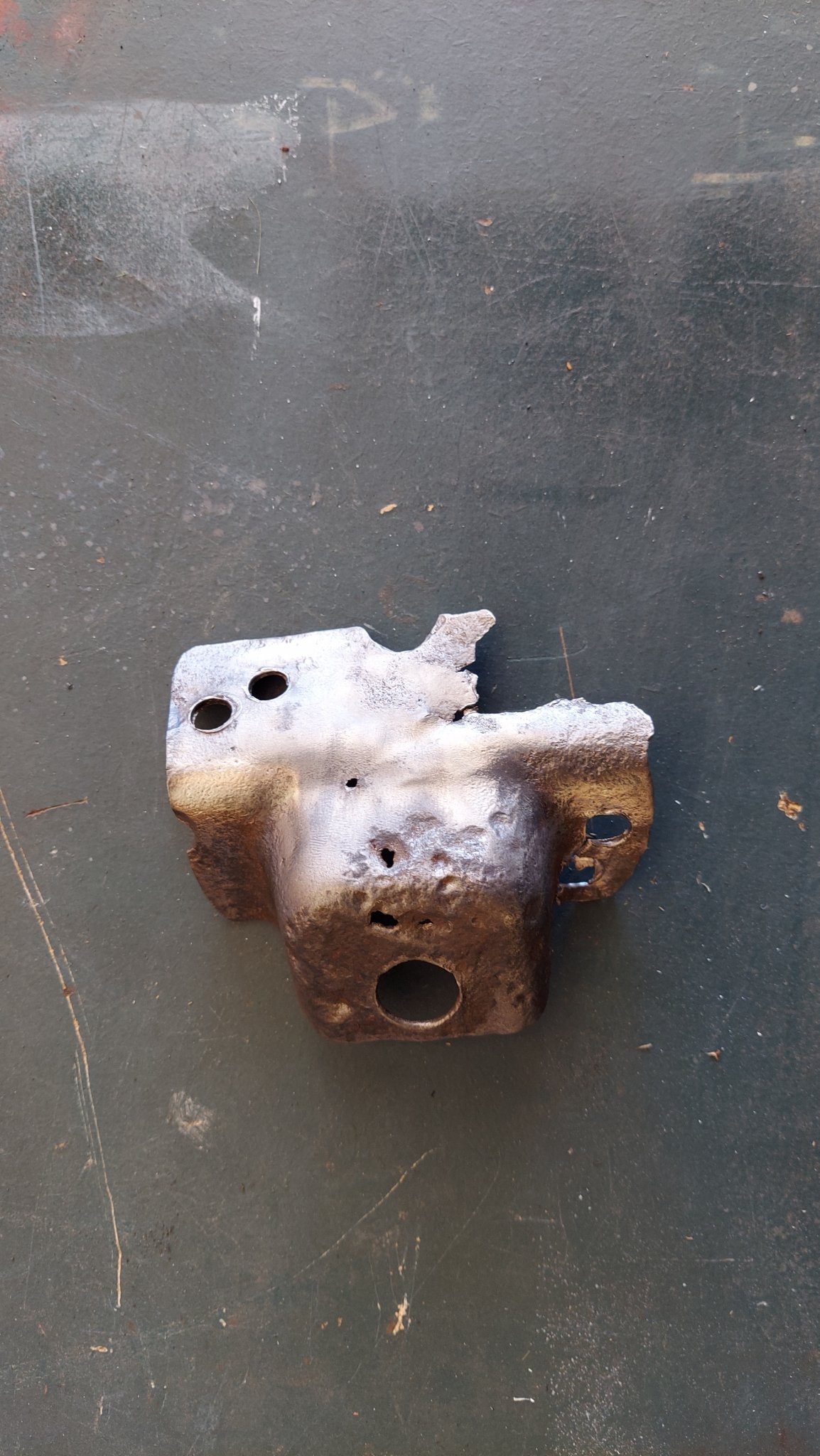

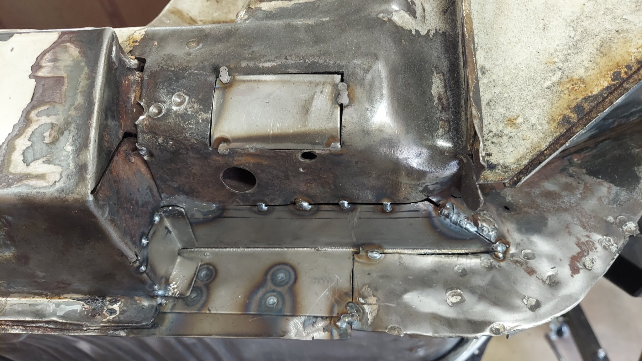

There were a lot of little parts like this fender mount I had to rebuild from what was salvageable

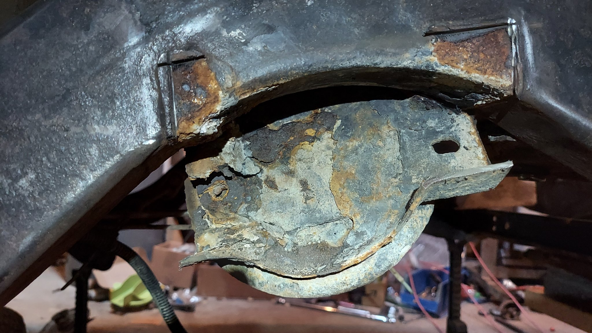

And my TJ had a lot done. It's back on the road again.

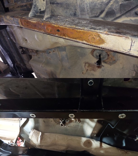

The spring buckets needed replaced so I relocated them to keep the springs from arking with the lift.
The skid plate mounts needed redone too.

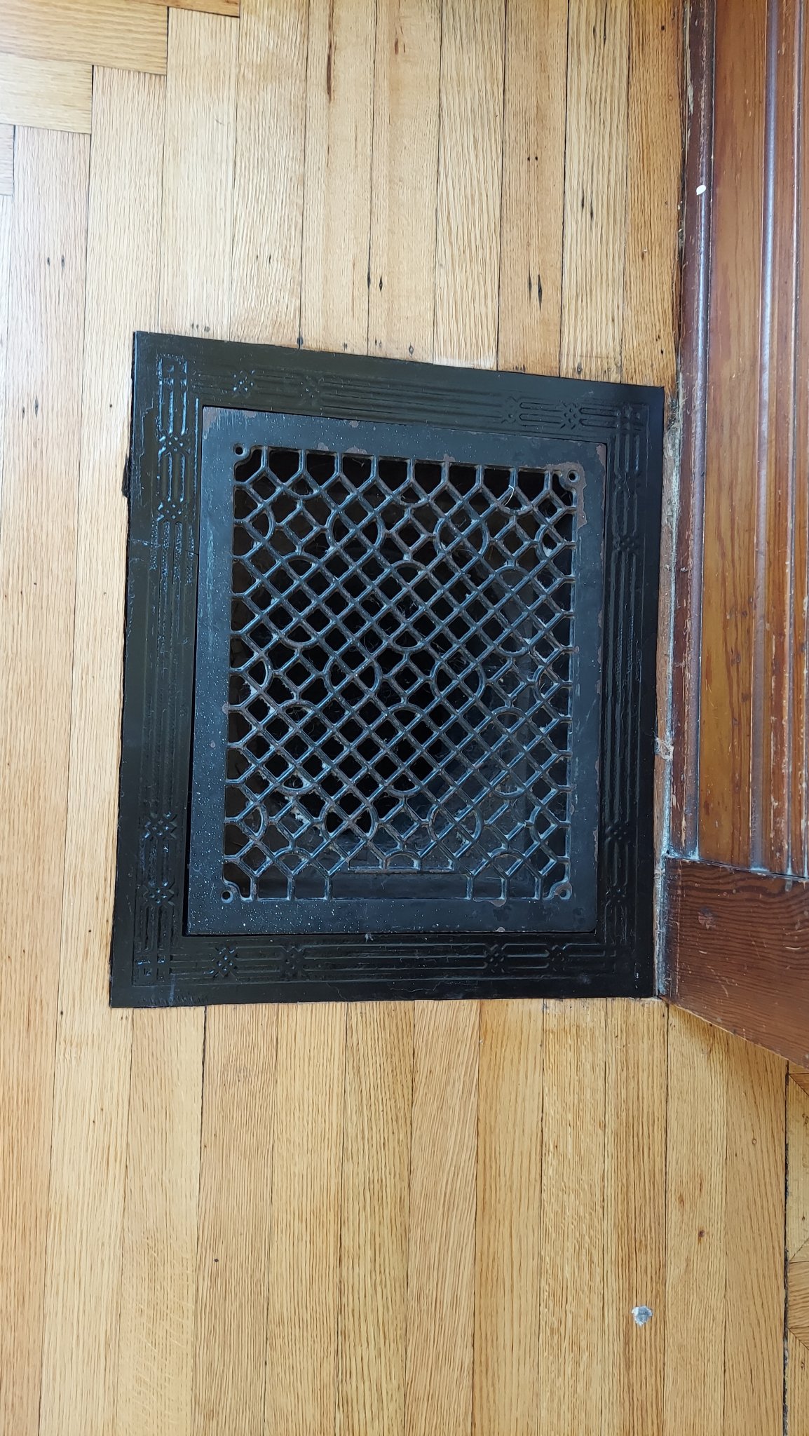

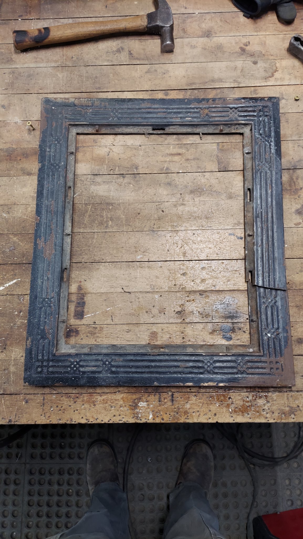

And an old floor vent I fixed for a customer at work with a little weld n grind.

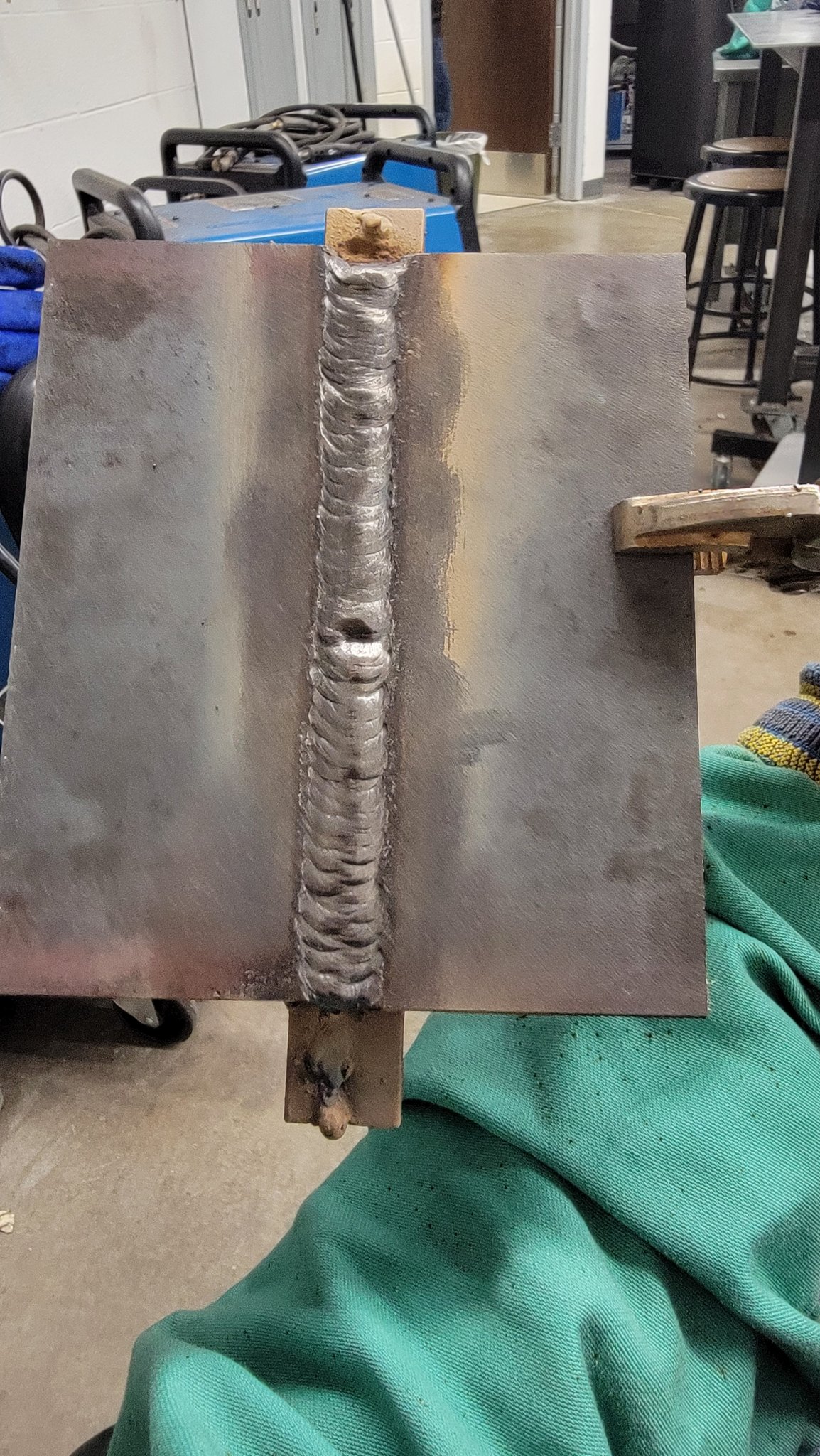

Kids didn't belive it was possible to run a test plate vertical up. Despite the short stroke on the restart it didn't go to bad.
Looks a little cold maybe ? Could be technique. Little bit of undercut. 3/32 or 1/8 ? Coupon thickness ? Happens to me if I'm not careful. Really don't weld stick enough to keep my hand in it. Vertical uphill is more than doable. It's required most places.
I tested on pipe so I've never actually done a plate test with stick. But most of what I weld with stick is plate. Go figure lol. The tests I've seen were overhead uphill on a 45. All positions in one test.
Not bad.. If you would clamp / weld something out to your off side to rest your arm on your travel will become more consistent. If you want to challenge the kids set one up without the backing strip and have them run an open butt. Great to see someone spending time with the "Future Welders of America"...

1/8 7018, 112 amps, 3/8 plate. These new fancey welders we have run way different than the older machines.
I have 13 students in this vertical stick class. 3 of them ran their test plate with a 6010 open root 7018 fill and cap. The other ran out of time to get the technique down so we ran backing plates.
We start pulse mig in the horizontal and overhead on Wednesday. The other 42 students I have this school year are wrapping up their OA welding and brazing class and we start MIG flat and vertical this week.

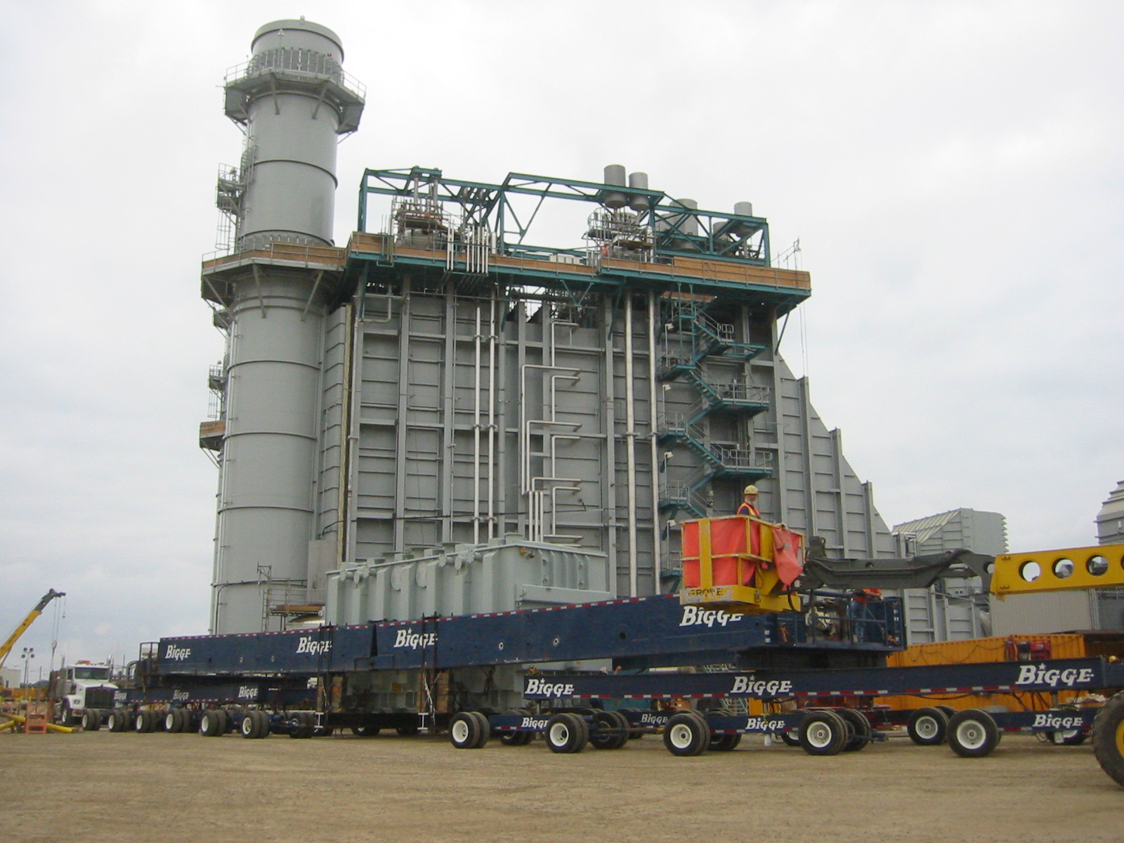

"That Life" is for a certain breed of craftsman.. A few things about it... Those big money, OT jobs don't pop up in your home town. A craftsman becomes a "Traveler" when he is not sleeping in his own bed at home. May be 100 miles from home or 2,000 miles from home. At that point you become a Road Hand. You can't dabble at it, you have to commit 100%... You must be a person who is squared away and keeps their ducks all in a tight row.... The better you get, the better you get. There is a big, long ladder to climb. 30 years ago, I had some college kids come out in the summer and be an "intern" with me. When I get an email from them they are now Senior Project Superintendents, CEO's and Engineers at the largest construction companies in the world (Bechtel, Kiewit, etc) and are running Billion $$$ projects. Building power plants, computer chip FABS, water, sewer, desalinization plants and more.. I choose to be a "Rig Welder" and started in the oil patch and refineries.
Time line photos... Start out as the welder and leave the trade as the field engineer drawing the plans.

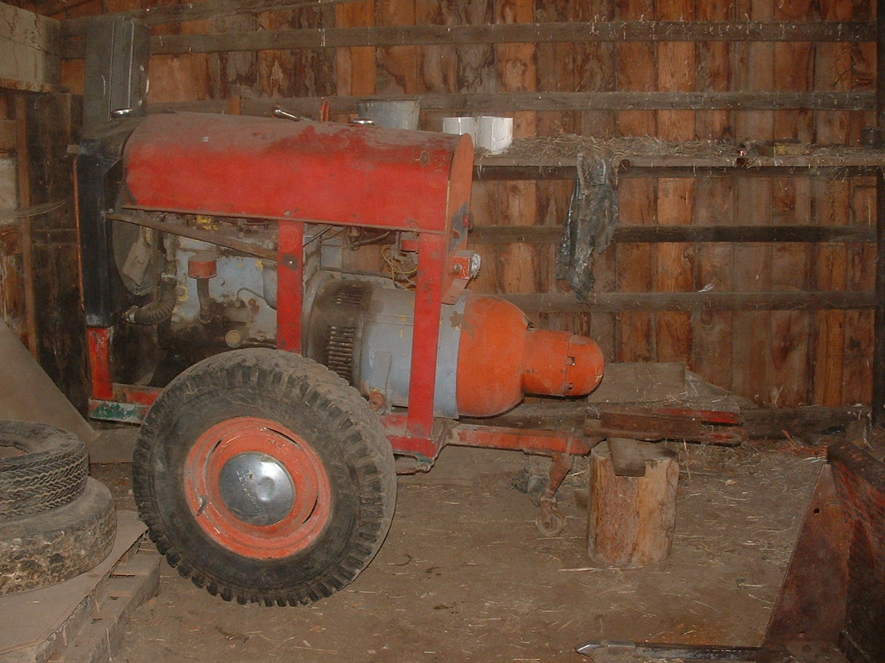

I've got a 48 in my shop that needs to be restored. Going to be a complete teardown and rebuild.
Frame was shot so I built a completely new frame. Then I decided I wanted to chop it and built a chopped frame. Then I was over it and wanted to sell it all and only ended up selling the chopped frame. I'll get around to it one day.

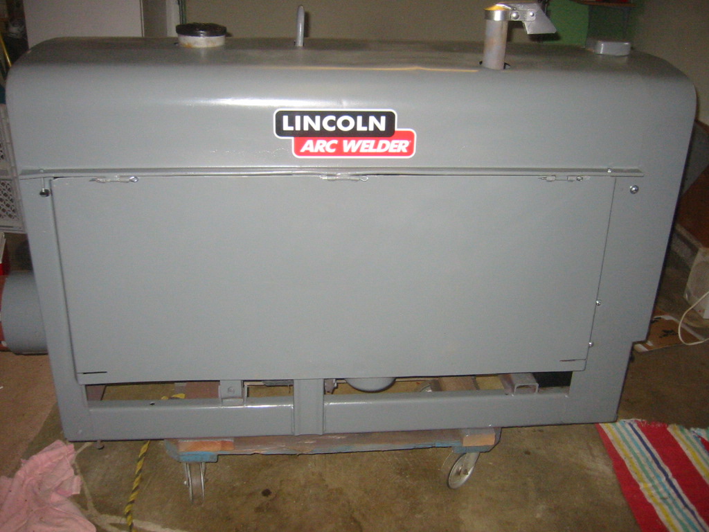

I collected the SA200's all over the West and restored most but used some for parts. I tried to steer away from those that did not have a ring gear on the flywheel since an electric starter is a great option. Stayed away those with the hexagon main armature housing since Lincoln started using some aluminum in those models (Green Light series).. Everything else was fair game. The short hoods had 4 ranges and the long hoods have 5 ranges so there are benefits to both of them.
Today, Lincoln is having the main armatures made in China. I hear it looks like a 10 year old wrapped the wires. The pipeline welders are buying a new machine and having Bill's rewind and bake the main armatures before they take it to the field.
Reactions: XP1K

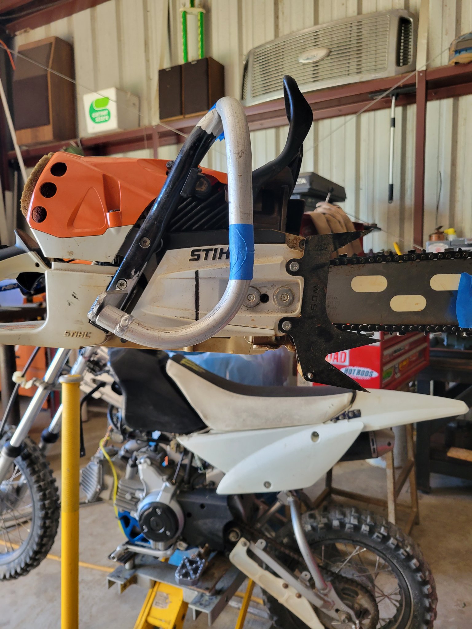

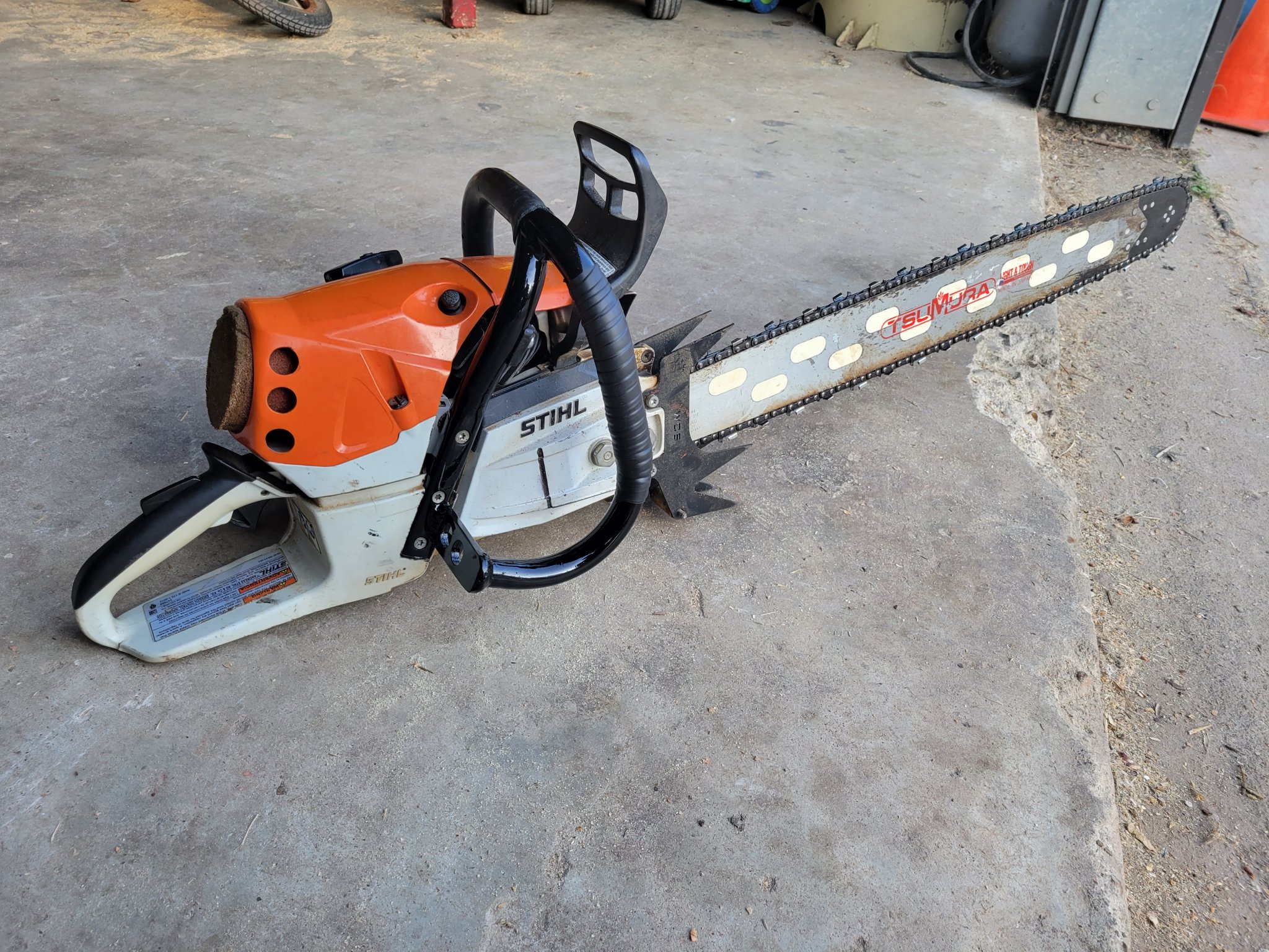

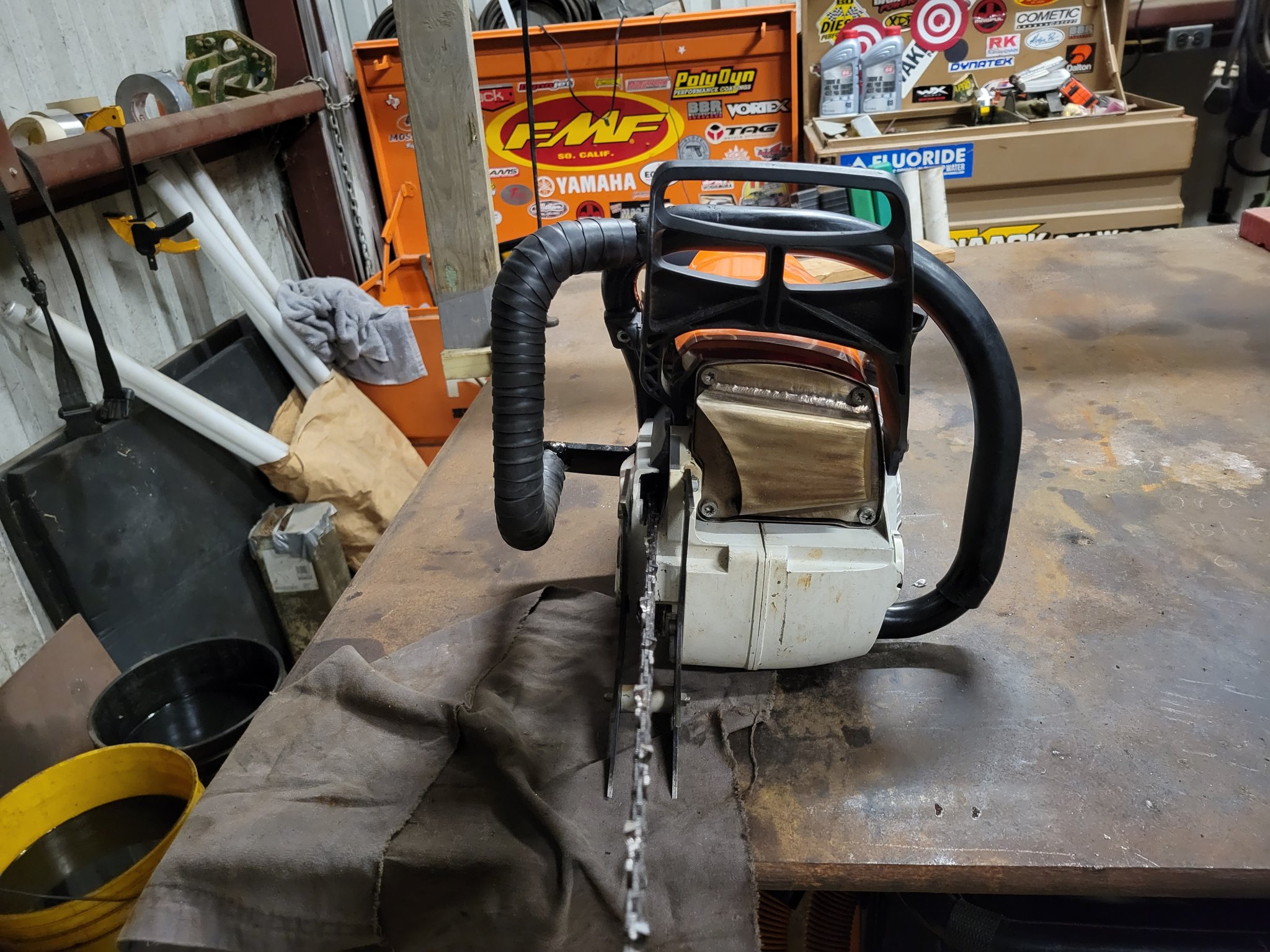

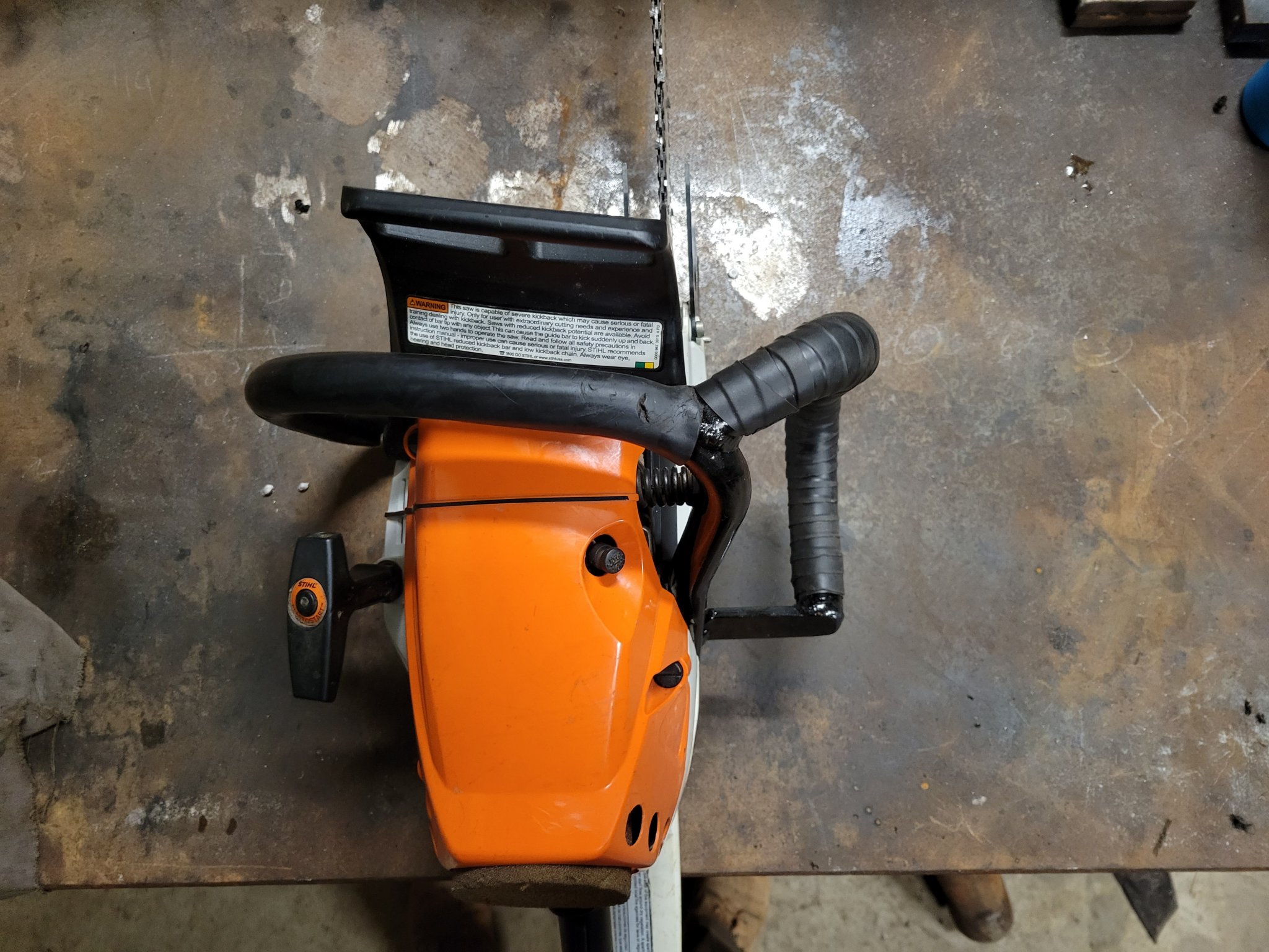

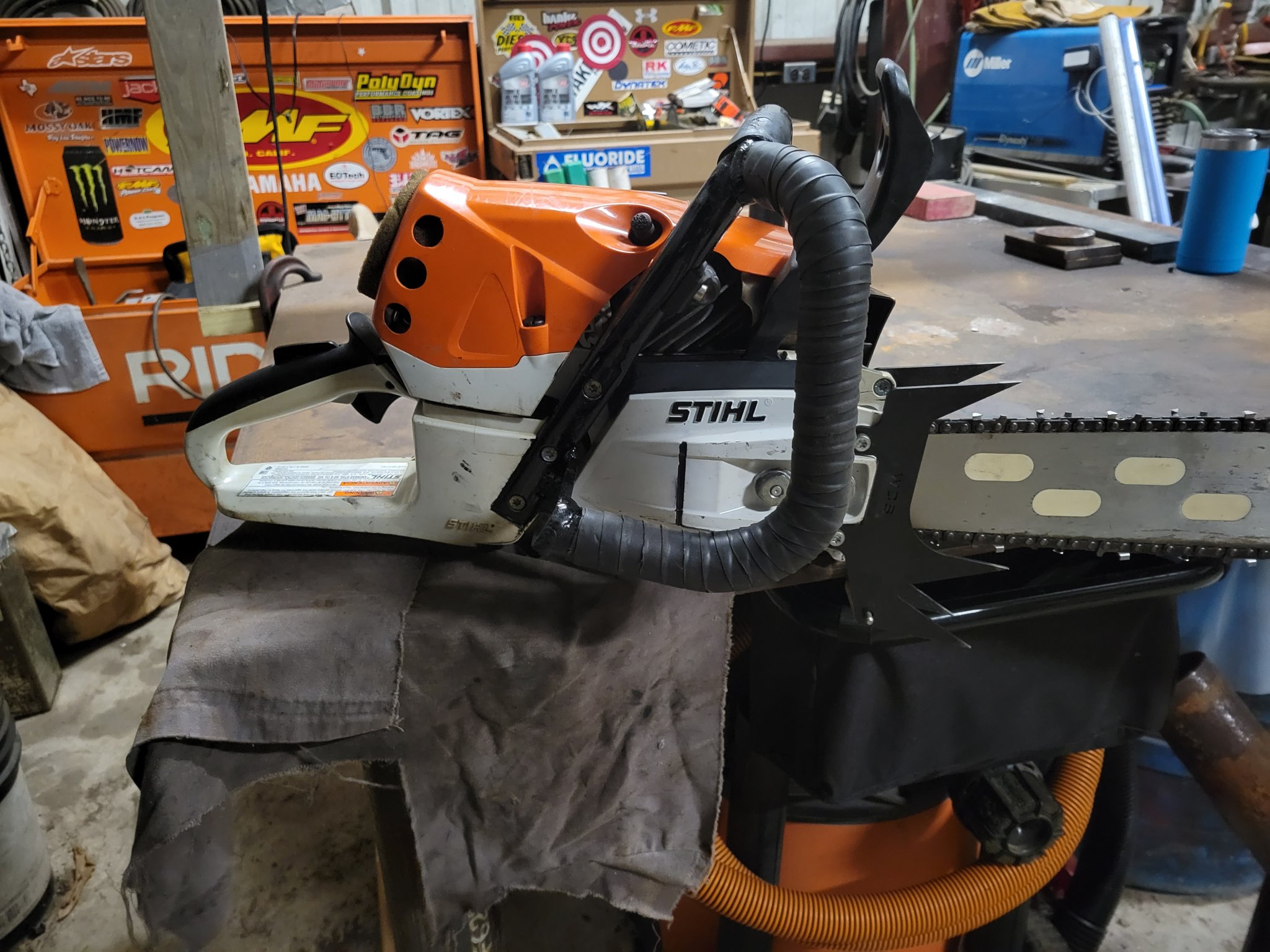

I ordered the same handle on my still saw, but when I went to try and get a case for the saw, good luck.
I still is sitting with ought a case, lol.
Yeah it's not going in the case anymore lol. I gave my dad the normal size big stihl dawgs for his 441 when I put the wcs 3 points on mine. His saw won't fit in the case with them either. Those cases are barely big enough for the saw.
Edit to add, I just went back and looked at the pic you were talking about. That's V1 of my home made wrap. This is V2
Time line photos... Start out asrel the welder and leave the trade as the field engineer drawing the plans.
Just as important, if you want a relationship, it takes a special kind of person "to be there" for you. Ex didn't mind, she exploited it, current woman freaked out when I quit my job to go work on a pipeline in WV a few years ago.

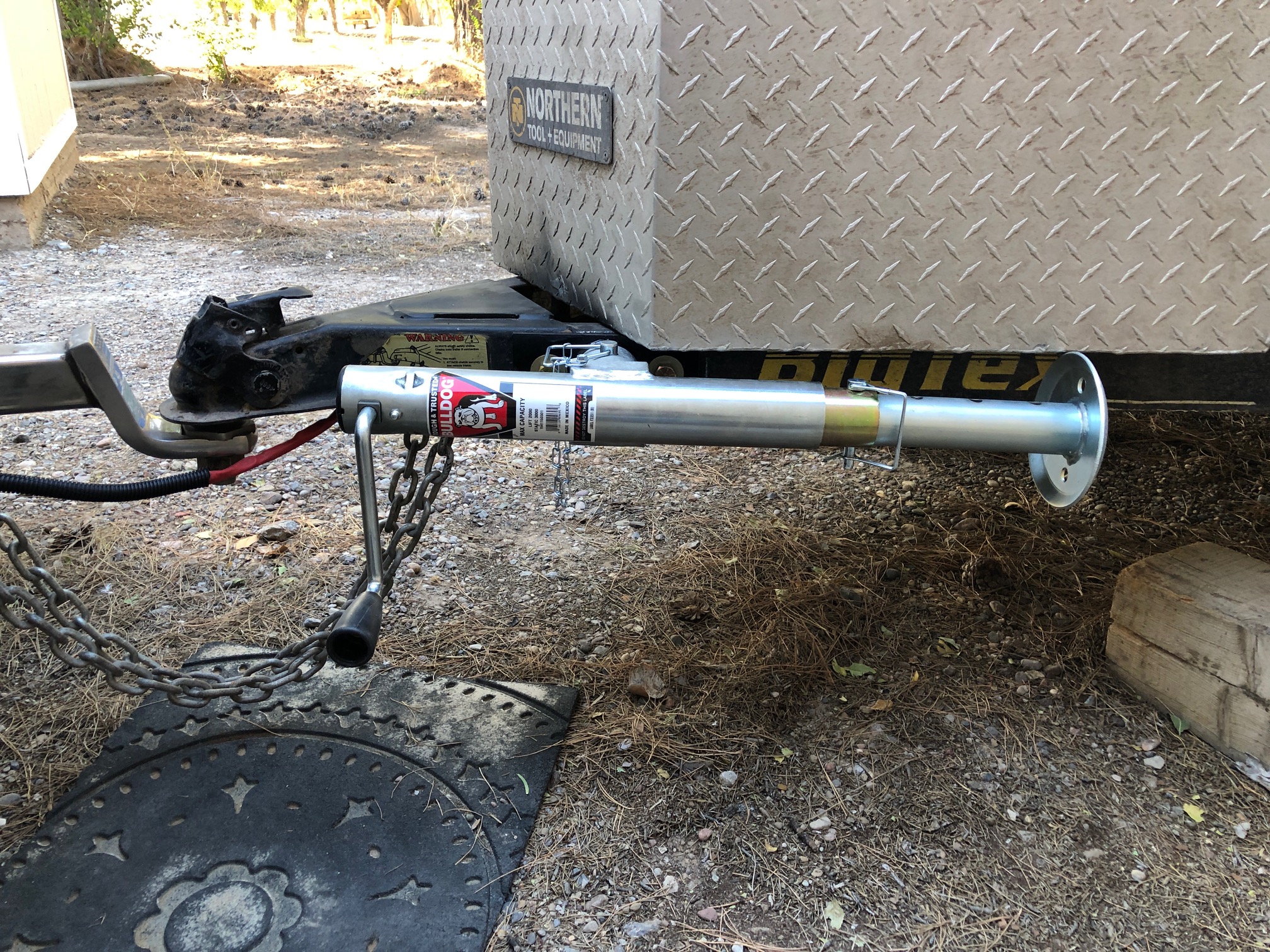

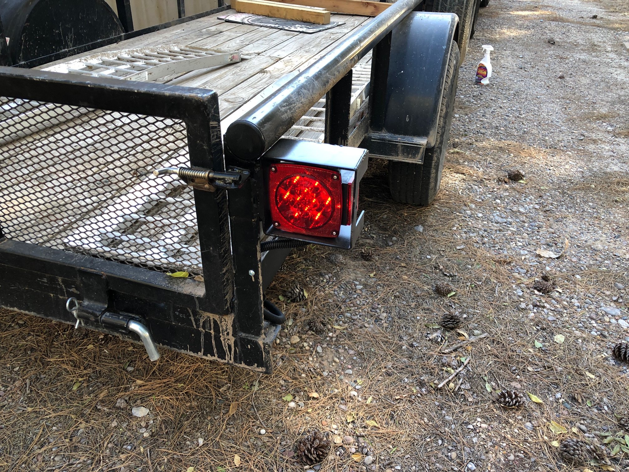

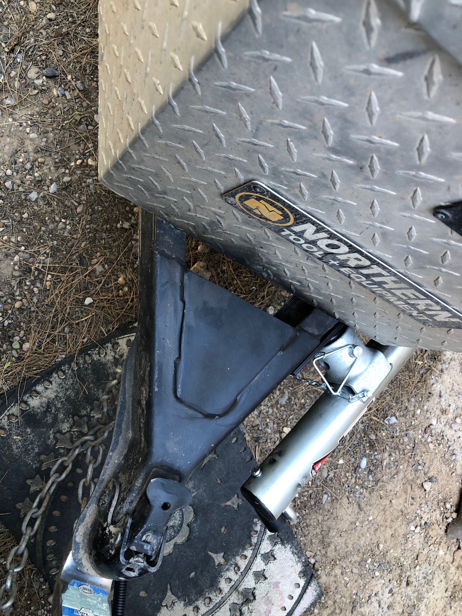

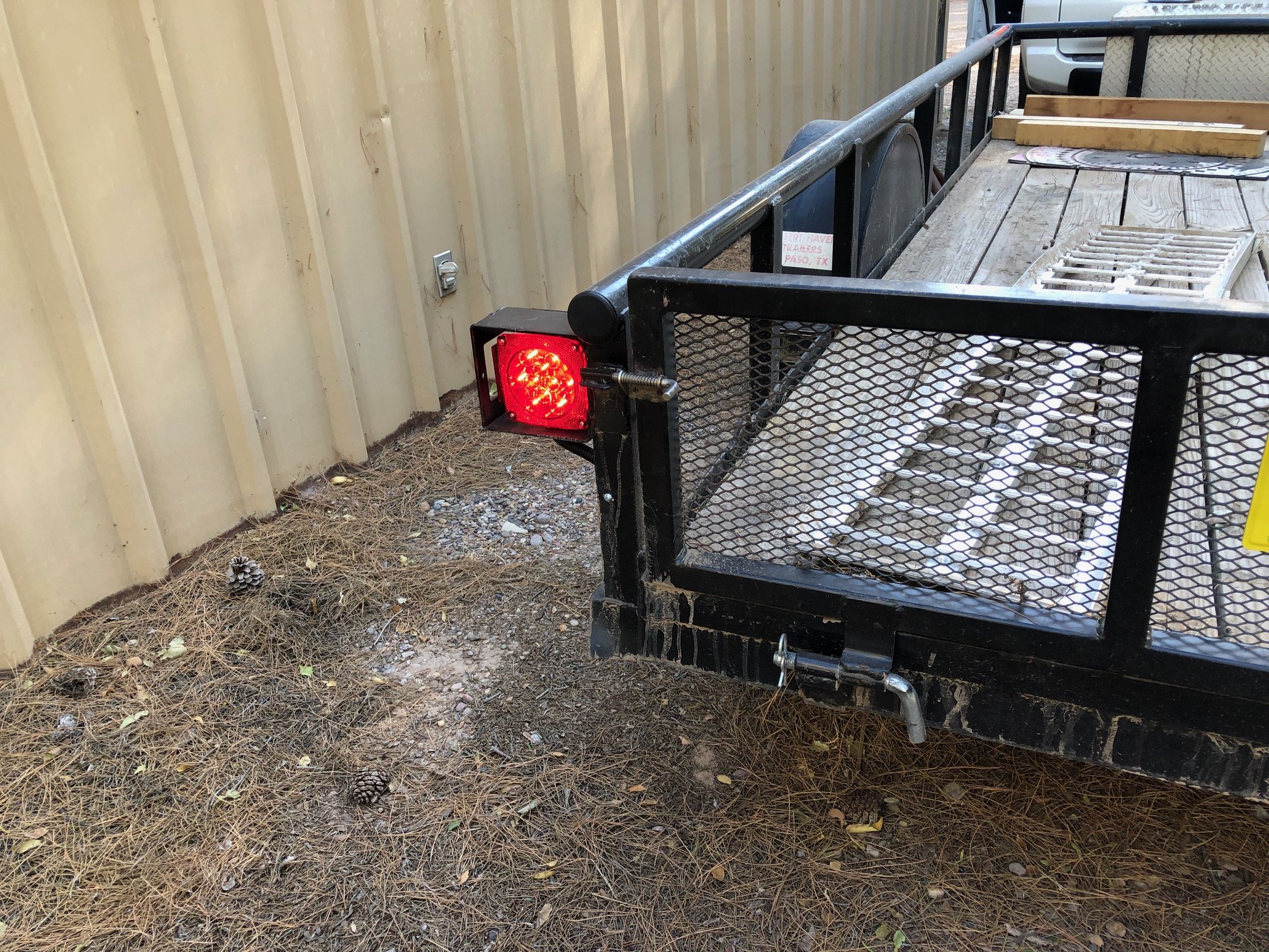

Tore the crap out my trailer while hauling my ATV into the Gila a couple of weeks ago on a Elk hunt. Didn't have a tag myself but was helping two of my friends who had muzzle loading tags. All the rain this year washed out the arroyos which caused the trailer to drag while going through them. Needles to say it was a rough SOB resulting in the A frame jack bent back up under the frame tearing the mount and ripping out bolts. Tail lights were drug off and generally the trailer was in need some attention so last weekend and this morning spent putting it back together.
Cut out the damaged A frame section and welded in 3/16" plate. Welded the Jack mount to 1/4" plate and bolted to trailer frame. New LED tail lights installed up higher housed in 11 ga shrouds and Swing sidewind jack installed. Hopefully it will make it a little more mountain proof.

Looks good... You might consider a skid pan under it so you don't lose an axle... LOL.. I like the weld on bracket with the option of 4 holes. I have one with two holes in it (horizontal), that some idiot put on... Drilll 2 more holes is on my to do list.

Put a little bungee around the jack handle or it'll be the first thing to get bent.

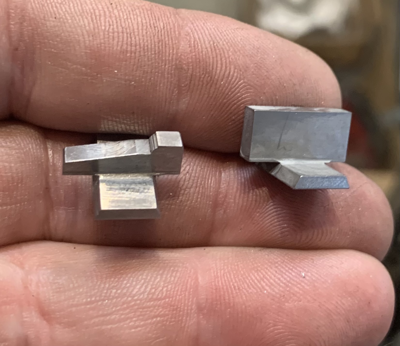

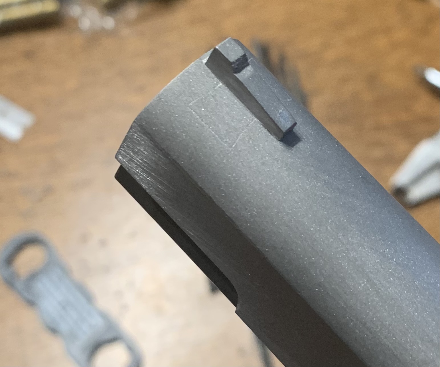

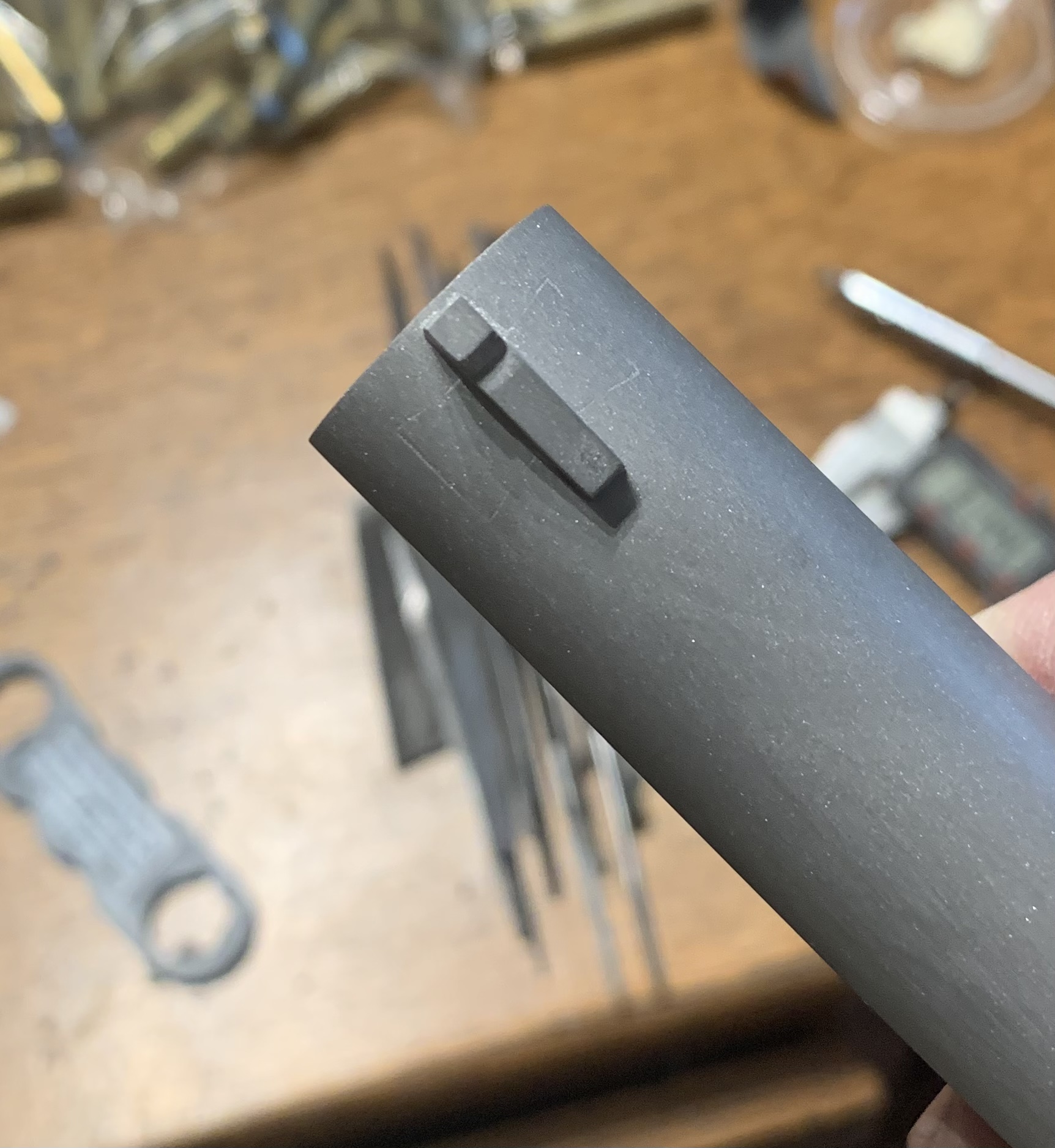

The project… Caspian frame and slide. Carbon, not SS. Going to get engraved and silver plated. Furniture, pins and screws will be royal blue Colt-style… right now just have cheap blackening on them from factory. Grips are camel bone. Totally awesome material! I lapped and fitted the slide myself and it is glass smooth.
I got it “running” last weekend. But needed a better front sight.
Sirhr
Dovetail centered and then Soft-soldered in place. As this gun is getting silver-plated the tiny solder lines will disappear under plating.
After hand-filing and then block sanding, the whole frame top was bead blasted back to a solid matte finish and given a light steel wool burnish.
Basically now ready to go to engraving!
You can just see the dovetail line. The trick is not dishing, rounding or gouging the slide!!
Top image. Nicely blended and totally solid with no lines to give away the dovetail location after finishing and engraving.
