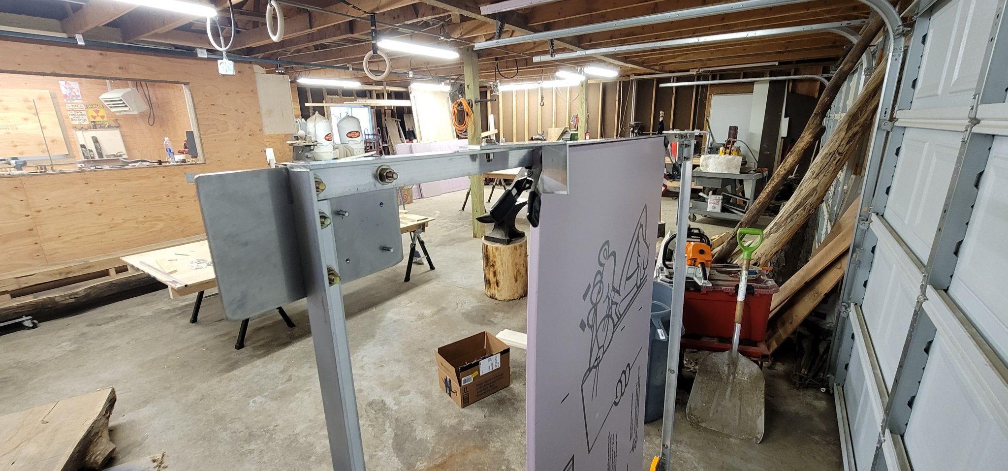

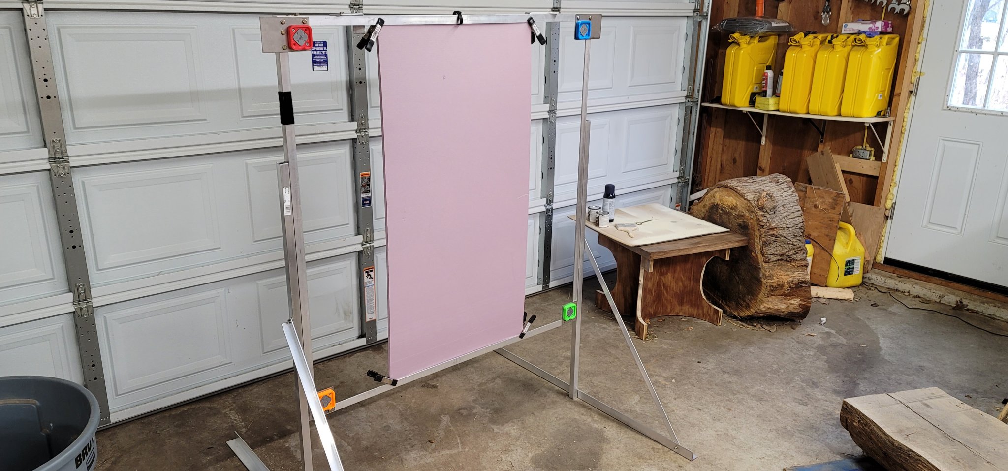

After a 6 month wait, my ShotMarker showed up (nice Christmas present to myself), so I rigged up this frame for it. All aluminum and a little 316 stainless, unfortunately didn't have to weld anything, just careful measuring, deburring and a little tapping. Oh, can't forget about the riv-nuts.
It"s not quite as easy to break-down and assemble as I'd like, but it'll work. Very sturdy and rigid. It can stand on its own or hang on 2x or from ropes/chains. Frame is 4'x4'. Total height is about 5'8".

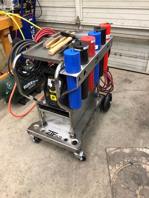

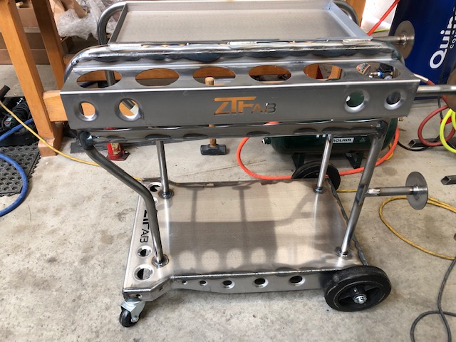

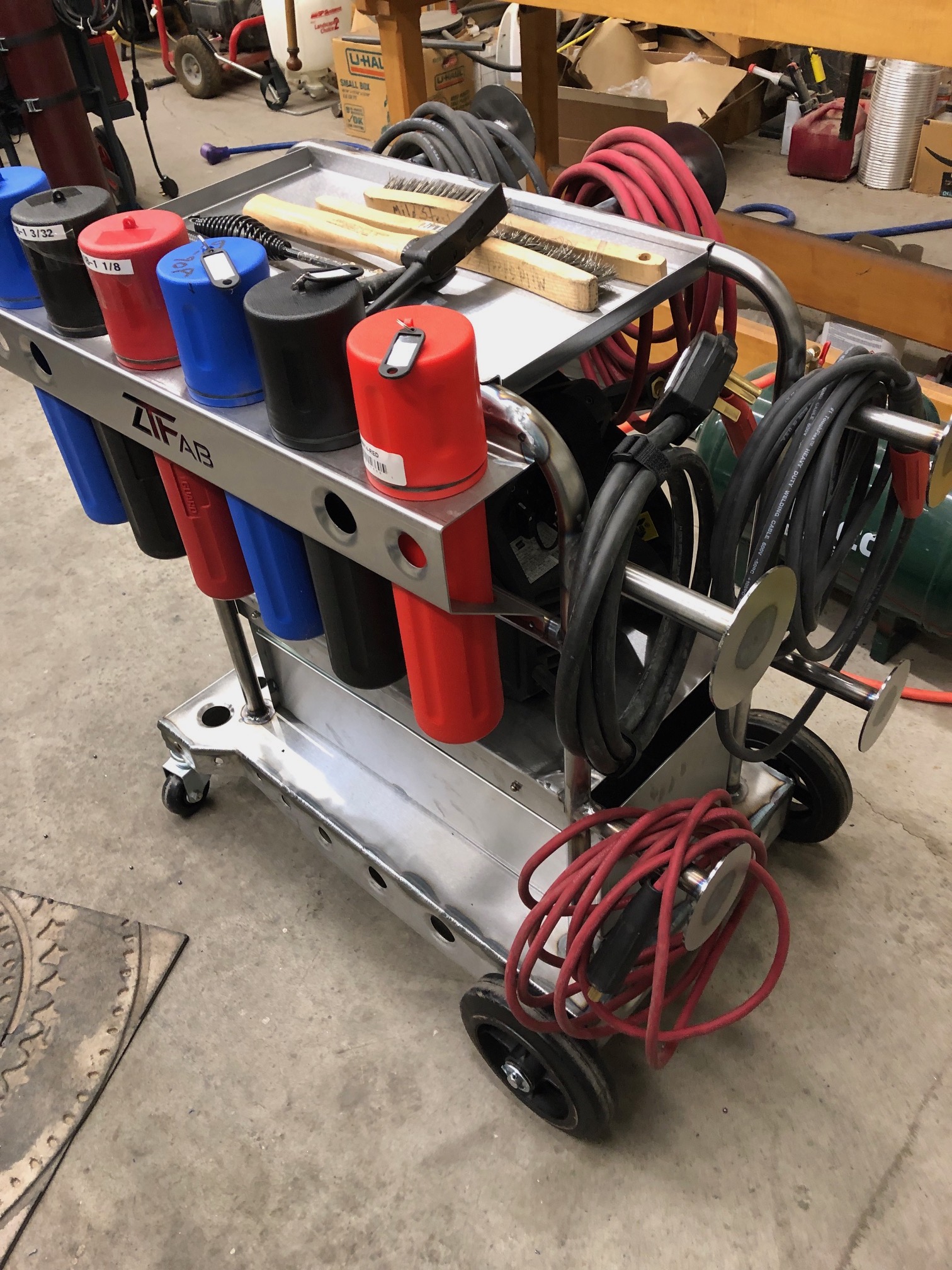

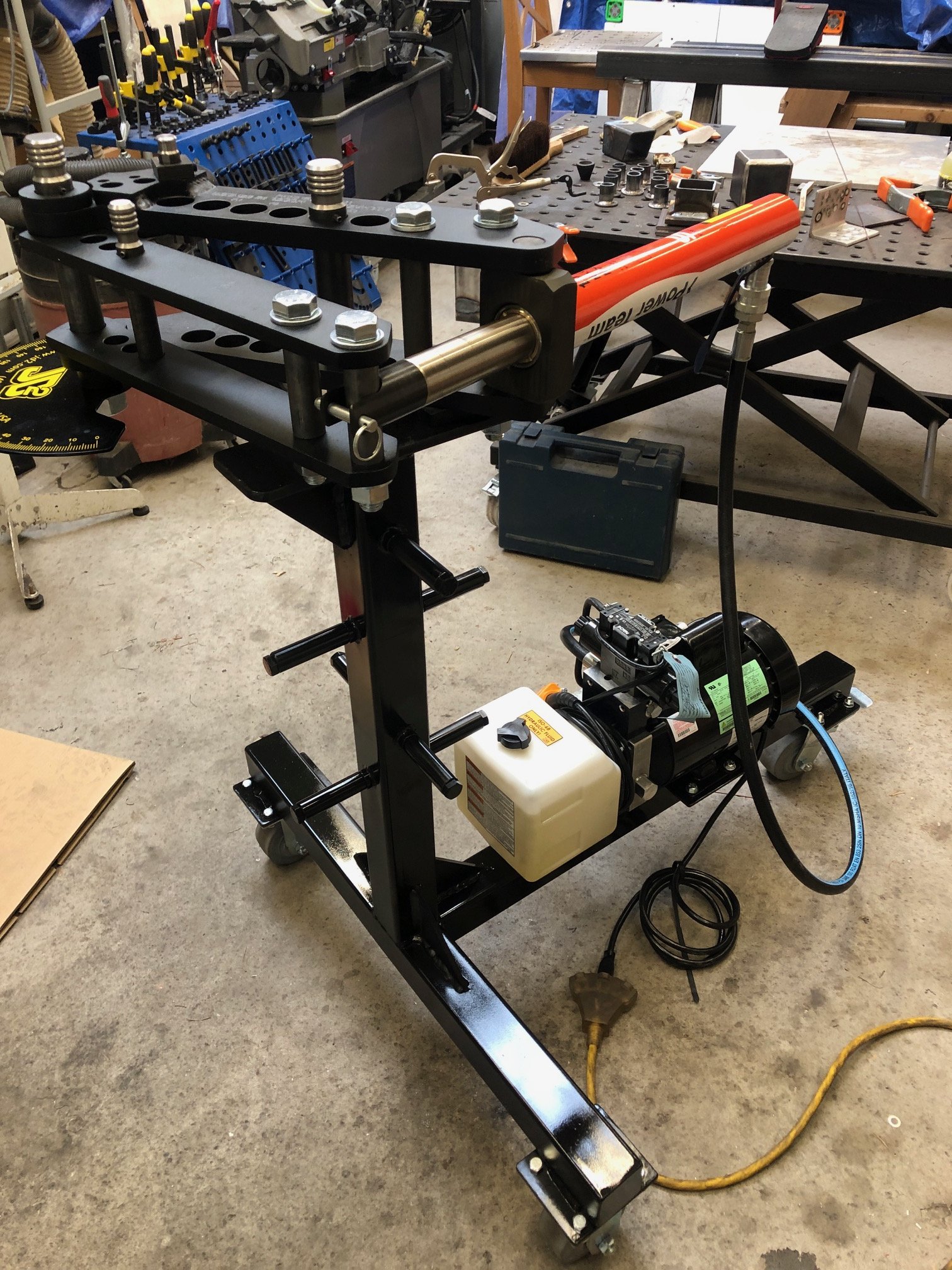

Wanted a cart for a recently acquired ESAB Renegade 300i. Unit only weighs 30lbs but wanted to have all my leads and rods close by whenever I use it. Ordered a cart from ZTFab and put it together this weekend. They make excellent cart kits and the fit up and quality is excellent. All joints were TIG welded using a Magic Wave 230i. Open corner joints on the frame were welded autogenous using the CycleTIG function which is basically pulse which you can set the number of cycles to control warping. Just need to put a coat of paint on it.

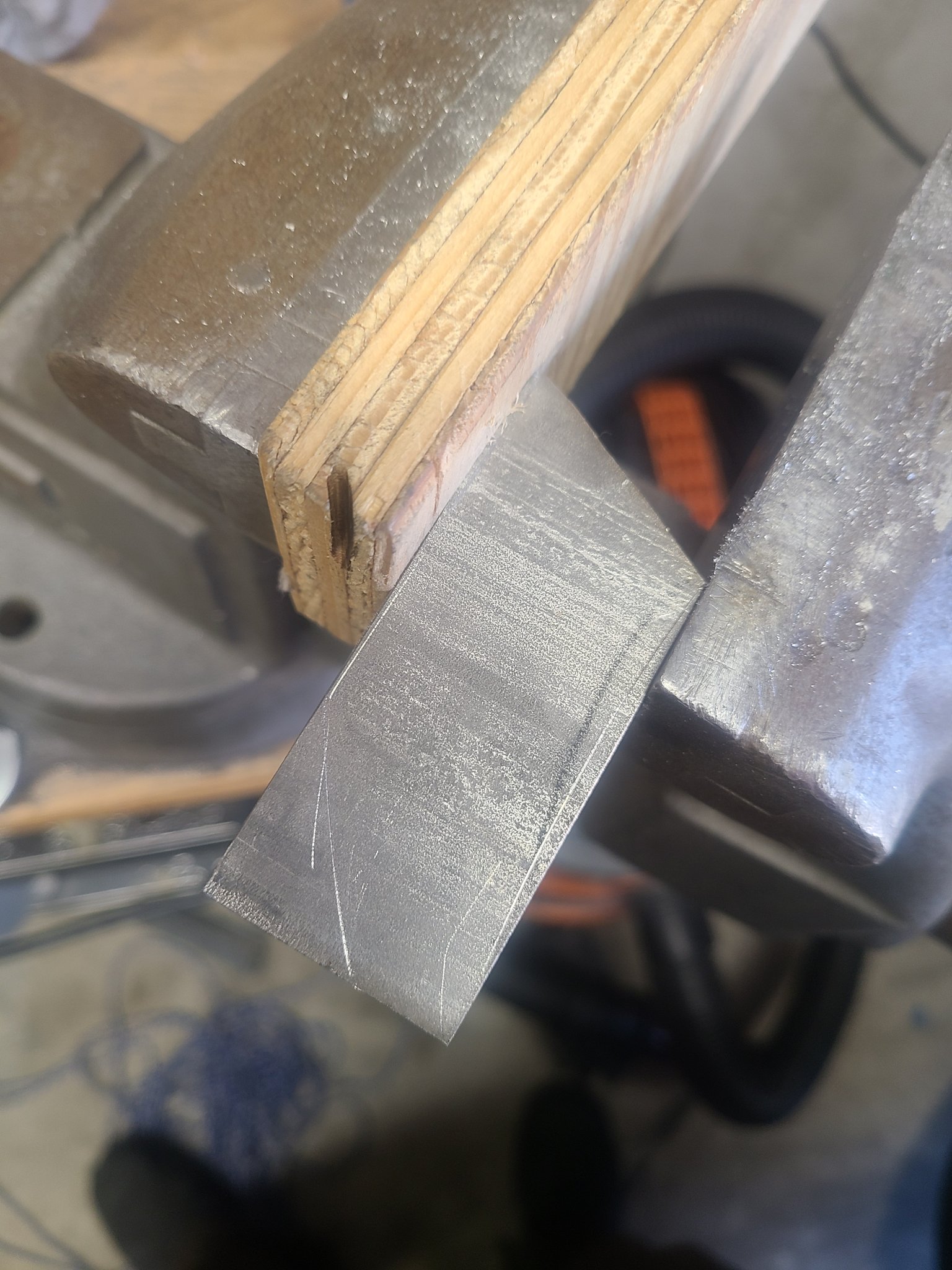

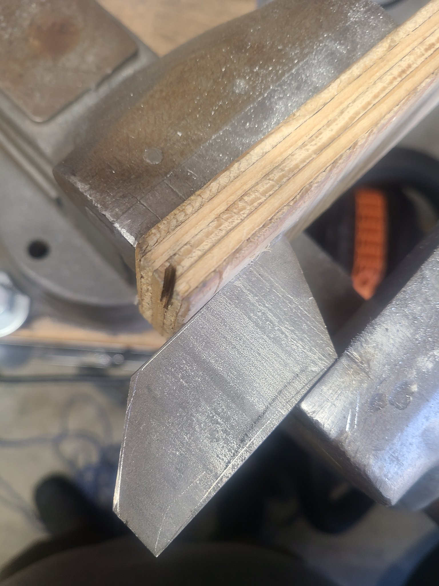

I’m in need of some grinding services. A2 plane blades and chisels. Need the edges squared up and bevels re ground without being burnt. Need all bevels to be flat ground, not hollow. If anyone has some open time and wants to make a few bucks drop me a pm.
Personally I wouldn't grind them especially if you want a flat grind. Hand sharpening with water stones is the best option. All my plane blades are either Hock or Lie-Neilsen and sharpen chisels the same way. What is the quantity of blades you need sharpened. Send me a PM.
I've got some sheets of aluminum and have plastic layed-out in the livingroom. About to spray the layout fluid on them, then fire-up the nibbler to cut out what we need. Then give it a go to bend a few beads on the face edges. By hand, on the livingroom floor.
My Lady only said "maybe lay some vapour-barrier down on the floor, first. Don't scratch the hardwood floor."
Space,,,, the final frontier....
Reactions: Hobo Hilton
They can be ground on a surface grinder with the sine plate and ground flat within 0.0005" over 6" fairly easily. My schedule is so jacked right now I don't think I have any open machine time till late June.
7 chisels and 2 plane blades. I have a honing guide, but only use it every now and then to reset my multi-beveled bevels, lol. Free hand sharpen mainly, and do a decent job of it, but over the year they get wonky.
So I send them out once a year to have the edges squared and bevels set at 30 degrees. The man I used to send them to has passed away.

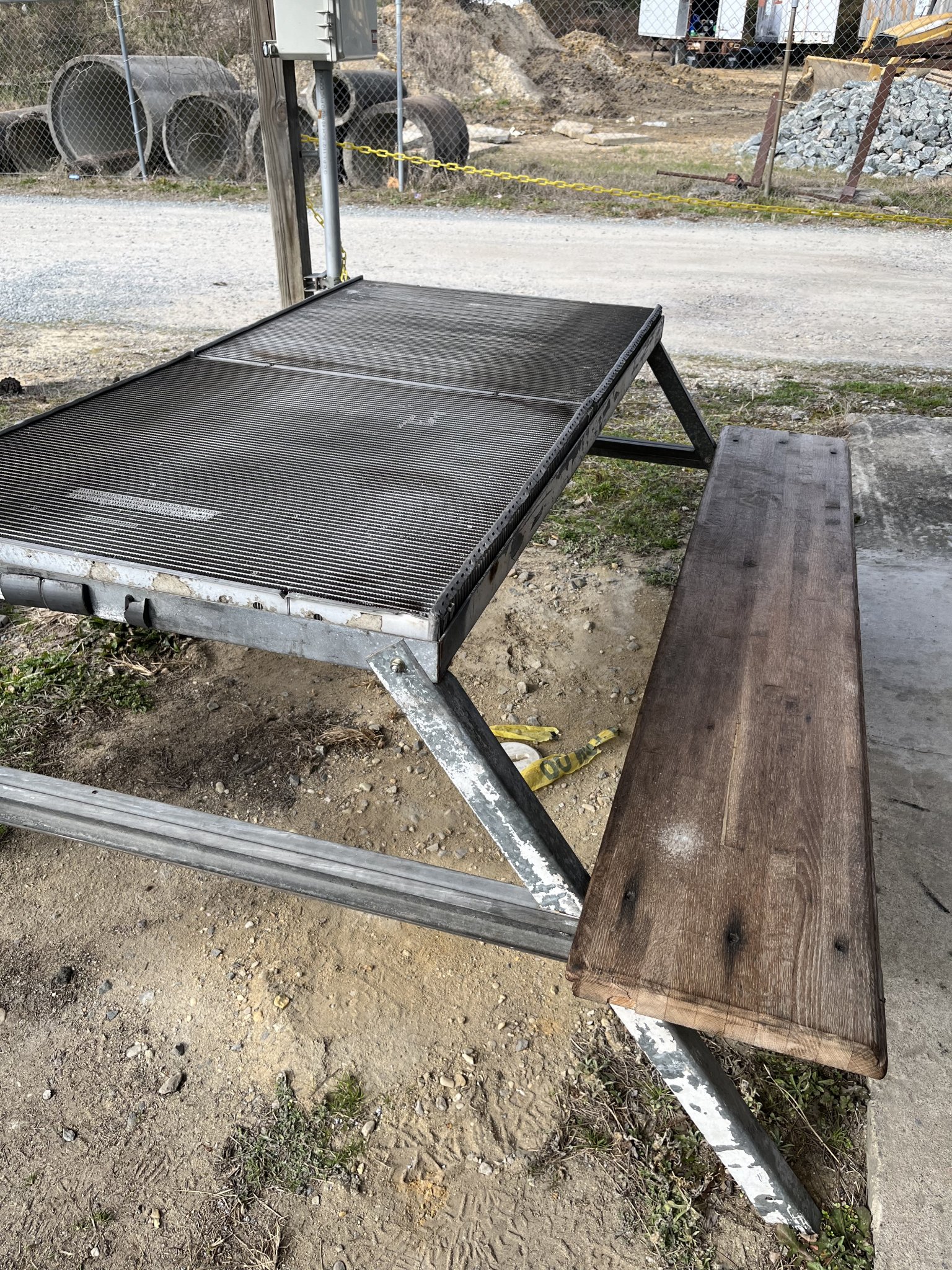

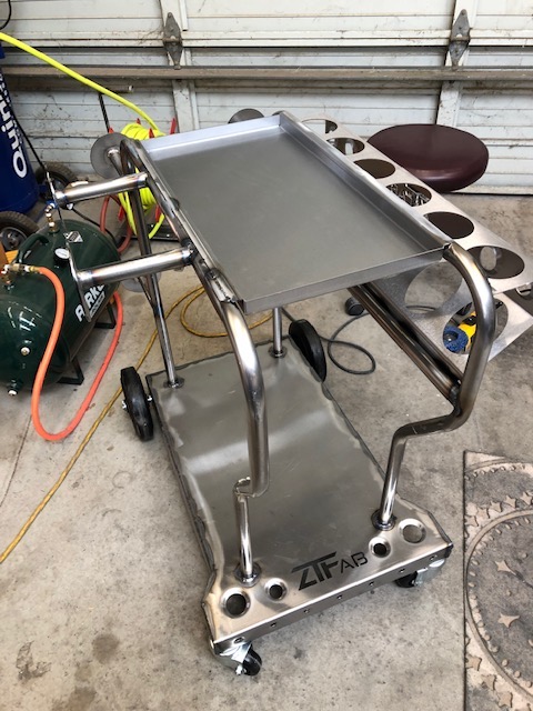

I took this picture for another forum, it's a picture of the welding table in my shop.
Yes I have a blacktop floor and azalea bushes in my shop, don't you? That's the tail pipe off my Koenigsegg Jesko, they all have Walker tail pipes that color, of course you poors wouldn't know that. :D

Very nice work. Did you roll the tubing yourself? Love the big Blue and run Millermatic 255 in my home shop
yeah i rolled it myself, this was a contract job, i run Miller XMT's with a spool feeder normally they are worth the coin and give alot smoother ride on the weld than the millermatic's do. My dream list is a PipePro stainless package cat turbo, or kubota, nothing like 1800 r's and nice and quiet, i'm so tired of a screaming welder, but it's not my primary job anymore so although i miss it, i really don't. Maybe one day when i'm too old to use it I'll spend the 27k to pick one up..... it's on my bucket list.

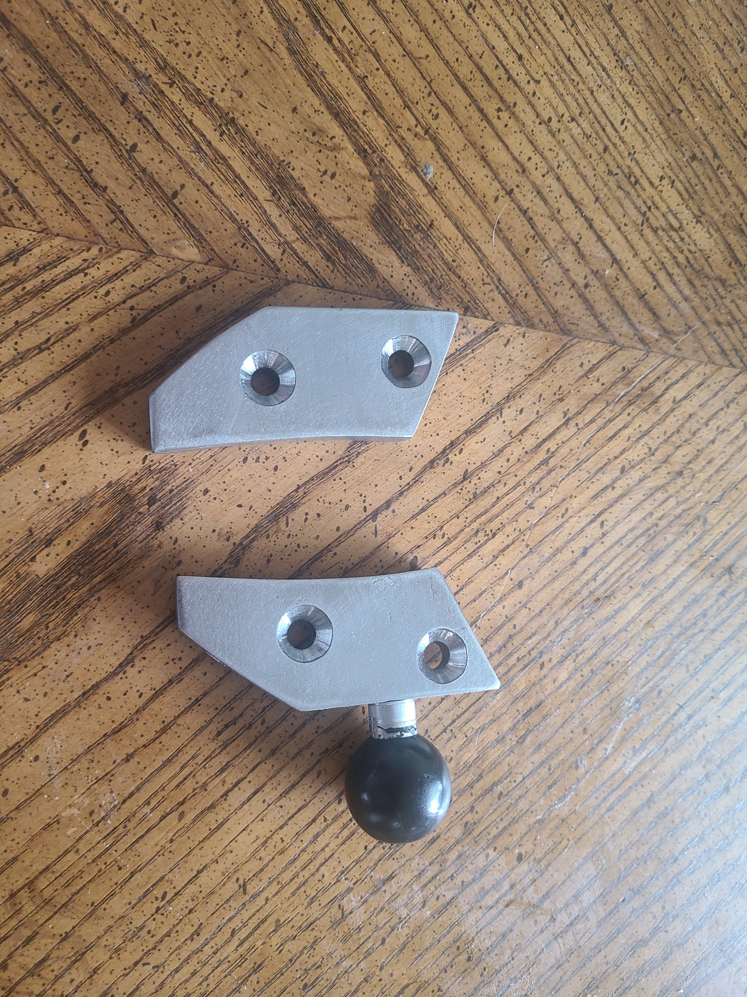

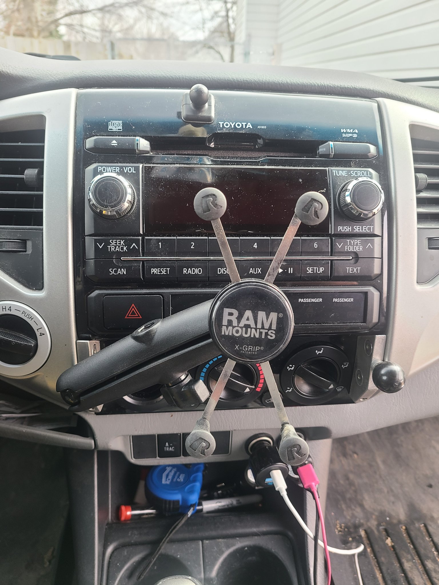

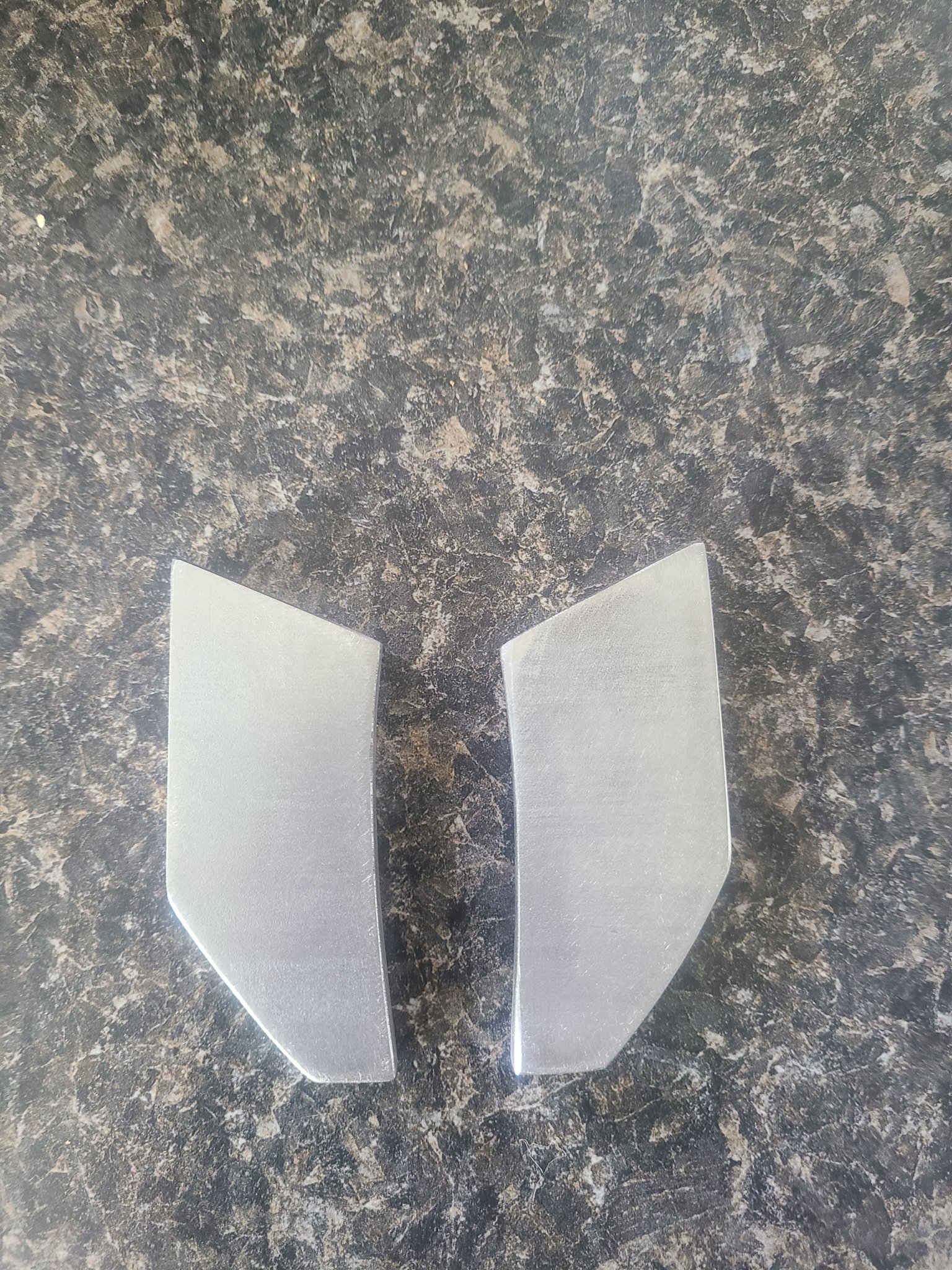

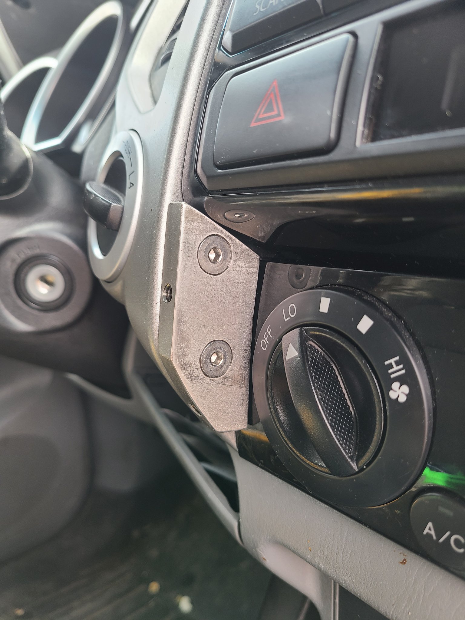

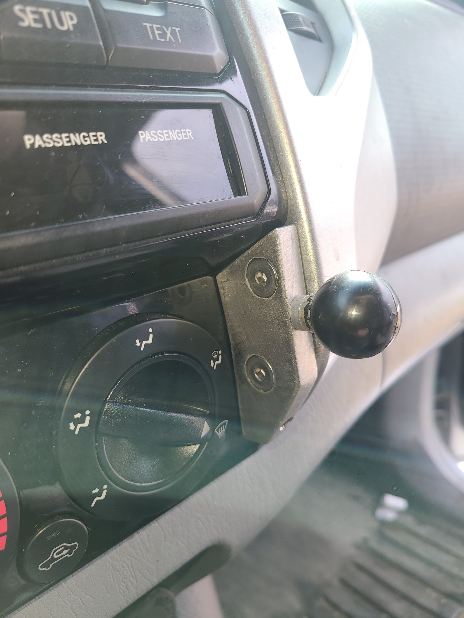

Needed a better way to mount my phone in my Tacoma. Found these.
https://www.tacomaworld.com/threads/2nd-gen-dash-mount-for-ram-style-mounts-gb-ongoing.765430/

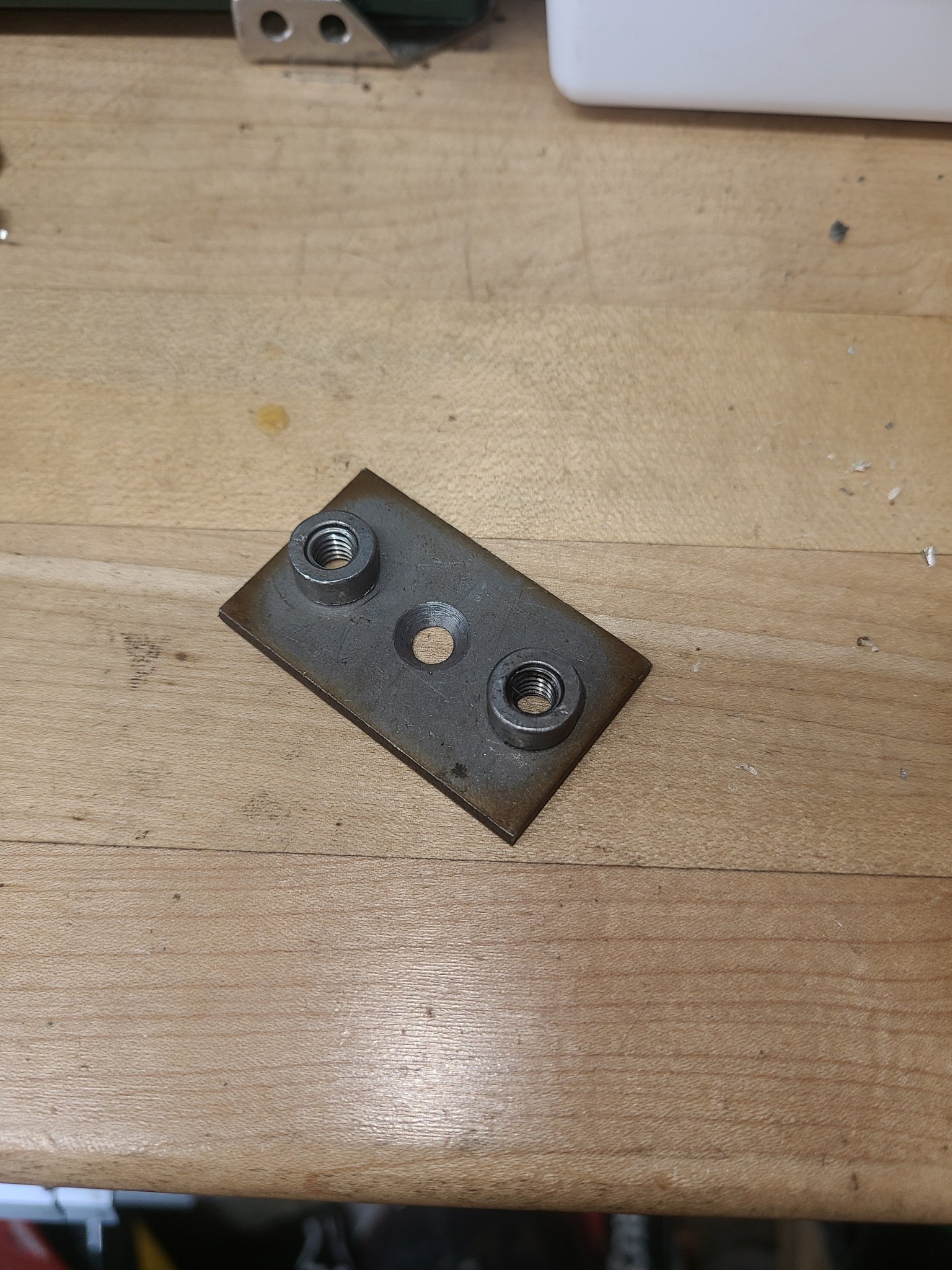

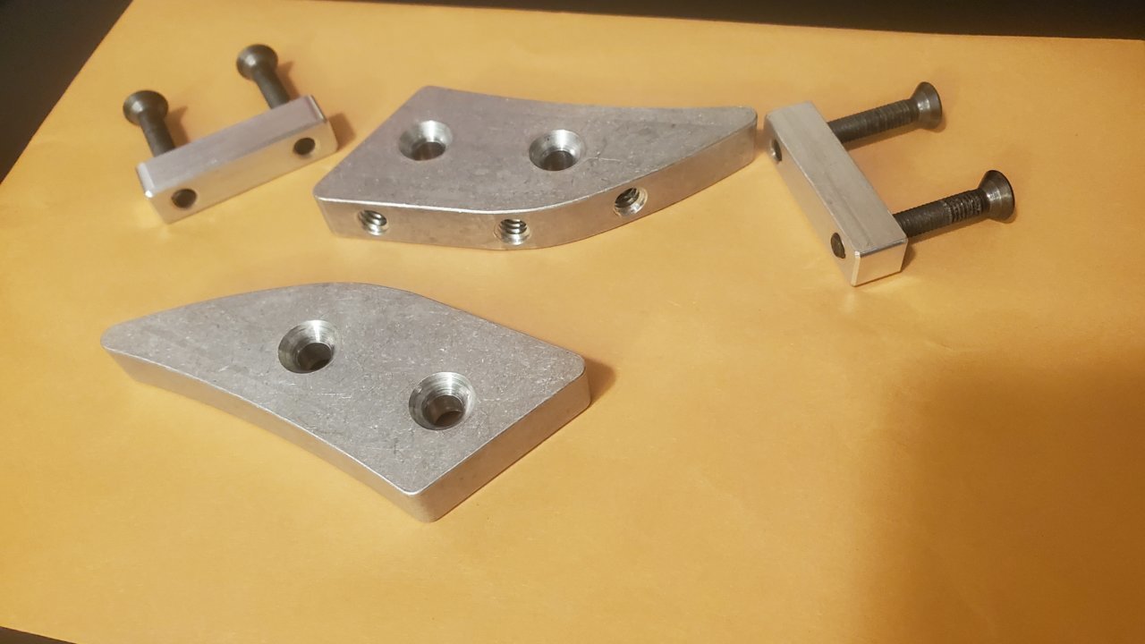

Decided I didn't want aluminum. So I decided to make my own out of stainless. I put 2 ball mounting holes vs their 3. Got the stainless at a place in Texas at Christmas time helping my dad on a project. Finally finished it today.
3/8 stainless. Cut with angle grinder cut off wheel.
Shapes done with angle grinder, bench grinder, and finished with files.
Holes drilled with drill press and ball mounting holes tapped 1/4-20.
This is the backer. Had to chop the corners.
To mount the radio needs removed. Not hard.
Just barely installed it. Phone placement likely to move.

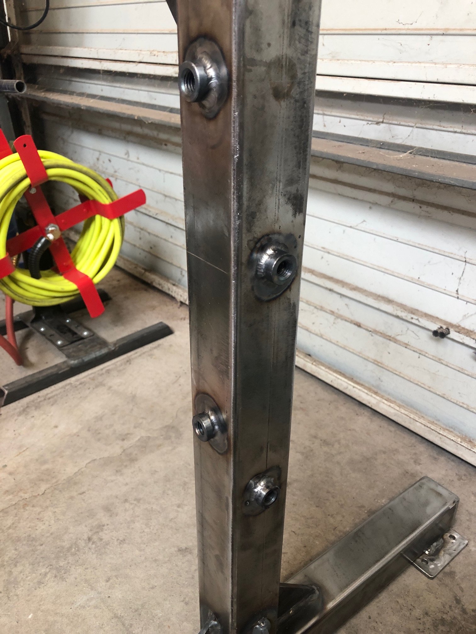

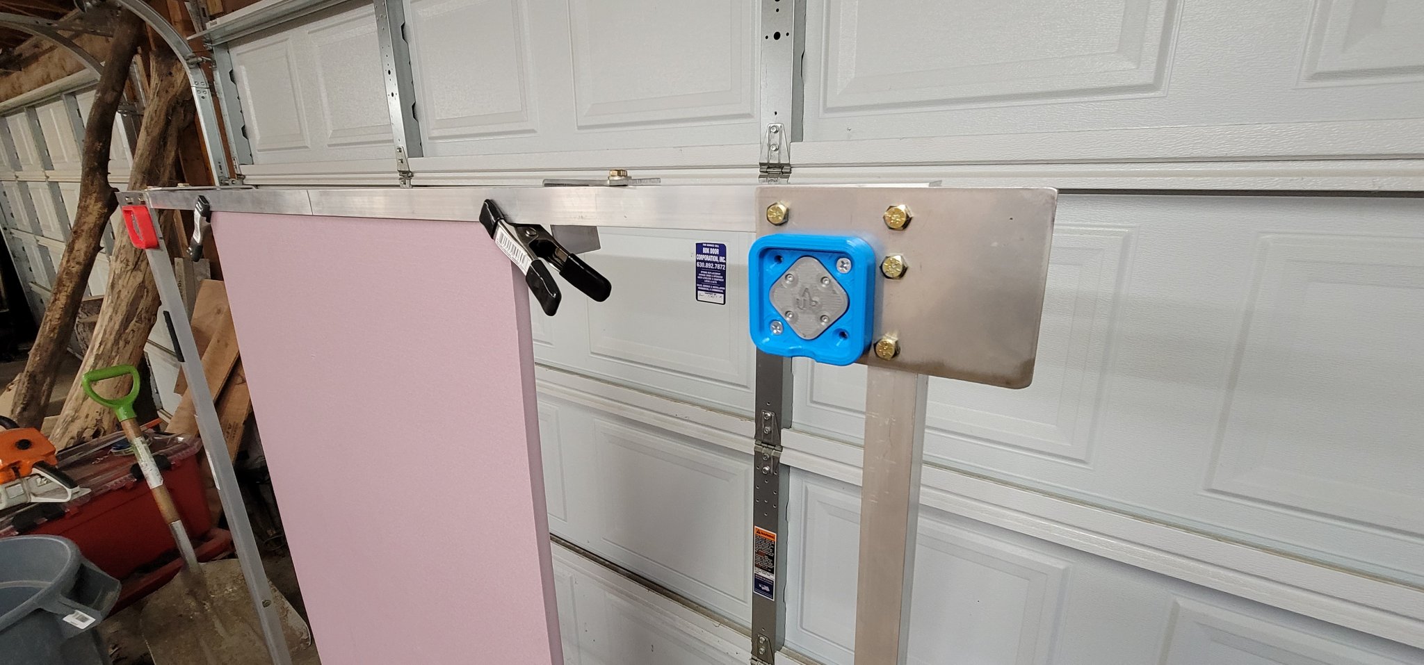

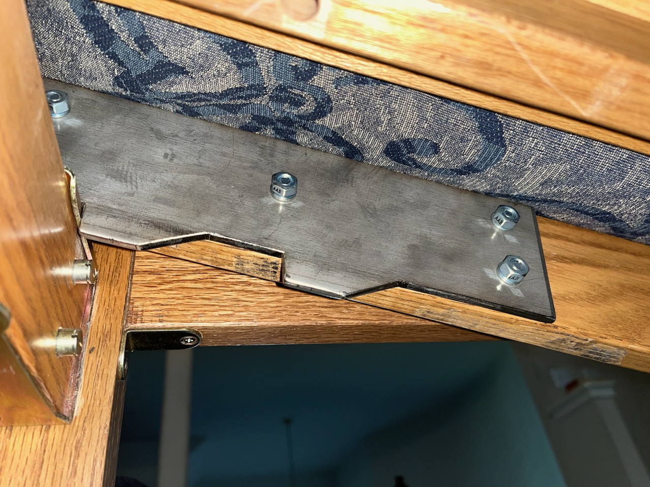

The project I helped my dad with. Making 2 stainless plates to fix my parents upstairs futon. Bolted in better than it was designed in the first place. Cut using angle grinder and dremel cut off wheels. Finished with files. My dad says I make working with stainless look like wood.
It is bolted to the side rail. The previous stops were plastic and broke.

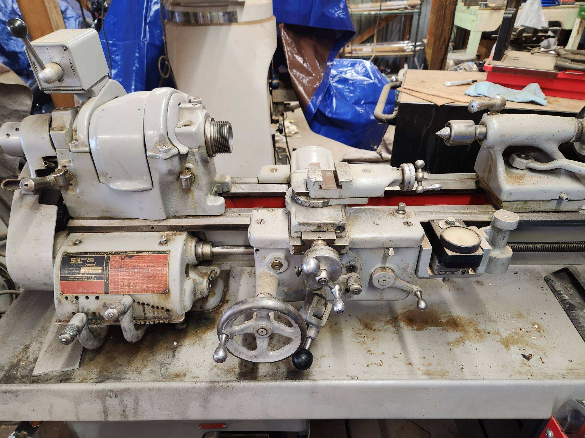

Newest addition to the shop SBL Heavy 10. Still in good working order but going to do a complete disassembly and rebuild since all the felts need to be replaces and given a good cleaning. Dorian tool post planned and still undecided on a chuck. Possibly a DRO and coolant system but will decide once the rebuild is finished.
This pic smells like coolant and oil. I think I caught a whiff of Kroil too.

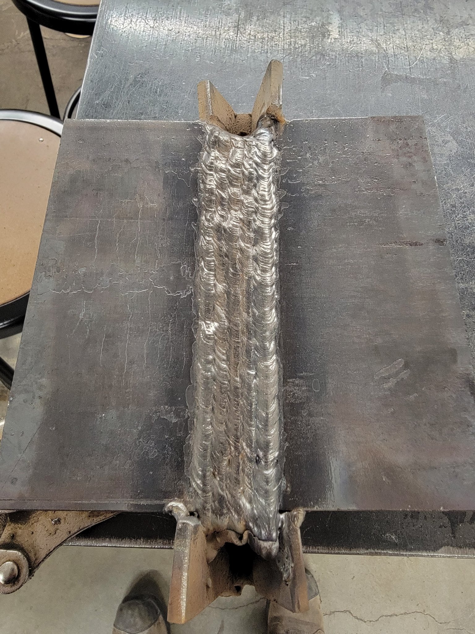

Decided to run a 1" 3g stick plate the other day. Couple small spots of undercut but went decent for a spur of the moment decision. Going to cut and bend test it one of these days.
Good practice. Do padding drills when I don't have a specific project to work on in my shop. Mostly TIG and the drills keep me in practice with stick and mig. Keep a 3/8" coupons on hand for that purpose.

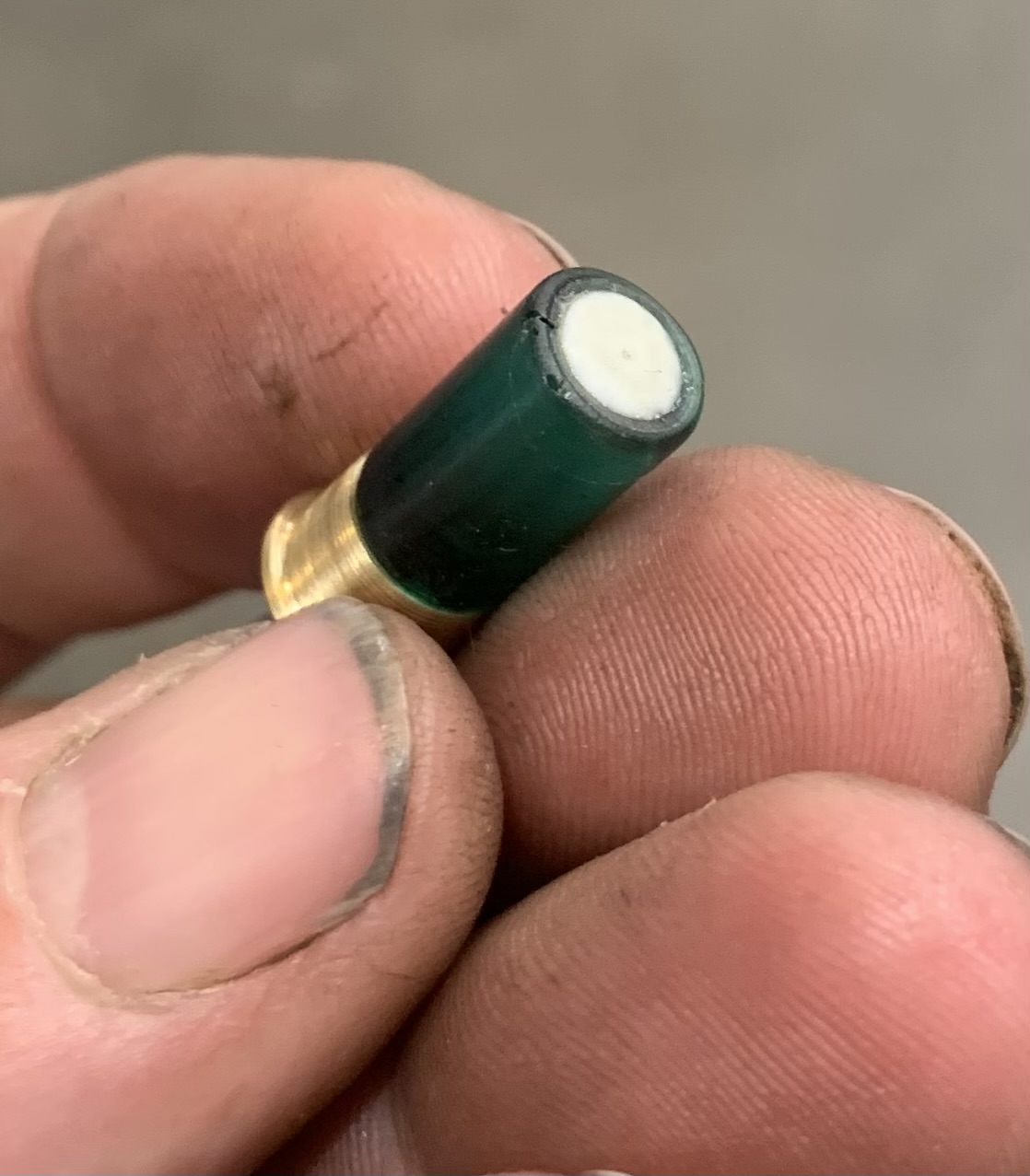

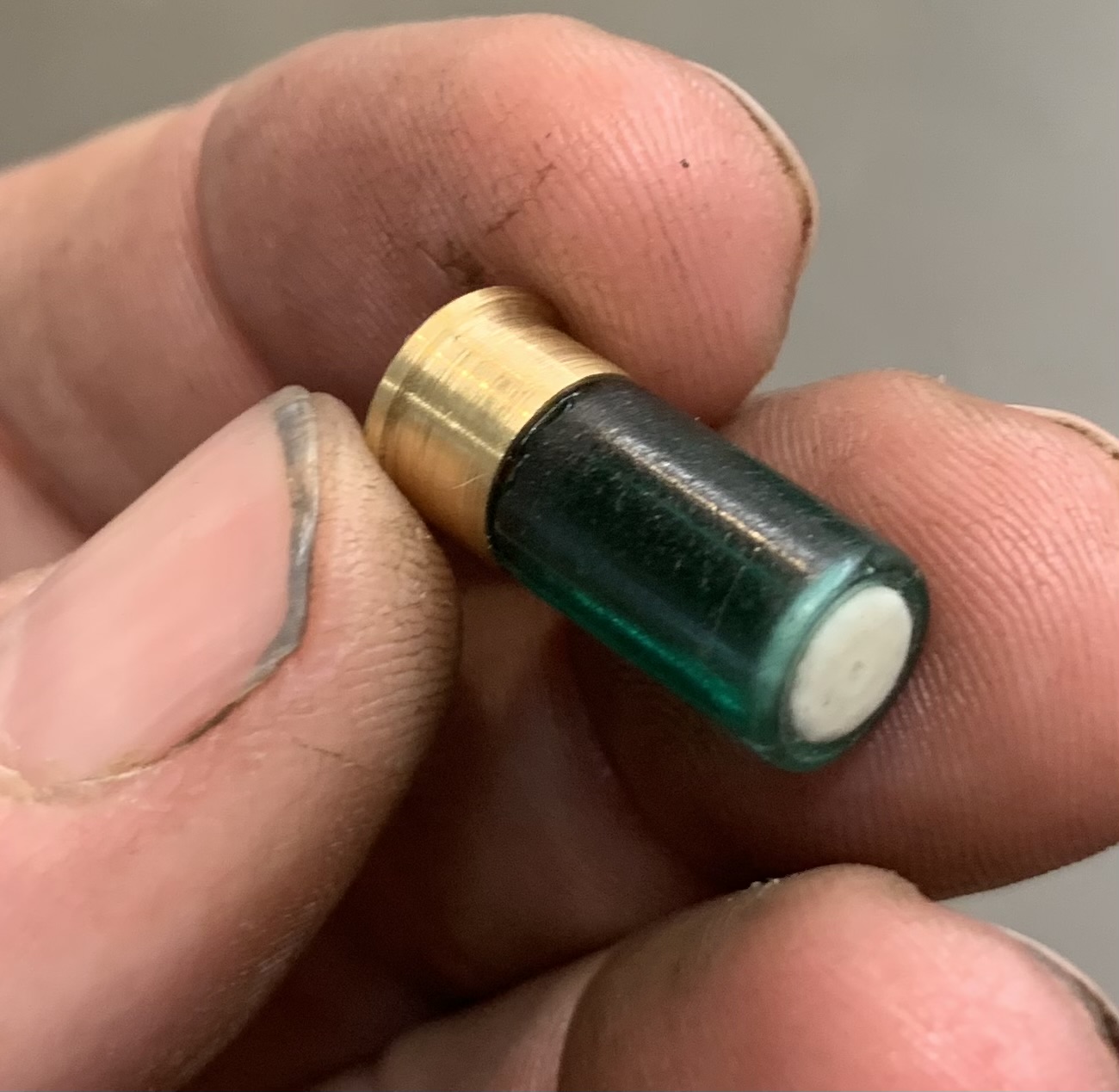

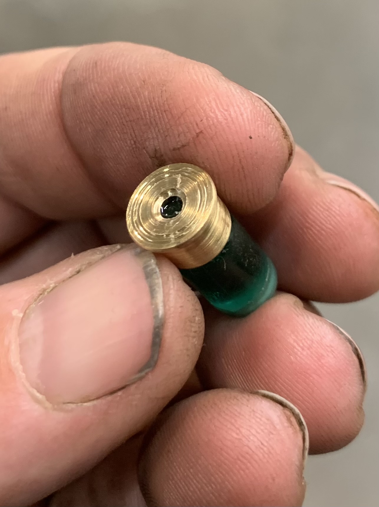

Not entirely metalworking… but trying to make a few of these lapel pins as gifts and refining my technique for turning glass and gemstones in a lathe.
So far, it’s sort of working! This one is glass, brass and ivory…
Plan is to insert a Diamond chip primer.
Next one will be ruby or spinel.
‘They’ told me I couldn’t turn glass in a lathe.
But ‘they’ can kiss my ass! Carbide tools, a collett and water coolant applied with a q-tip… and glass machines just fine. Even drills ok!
