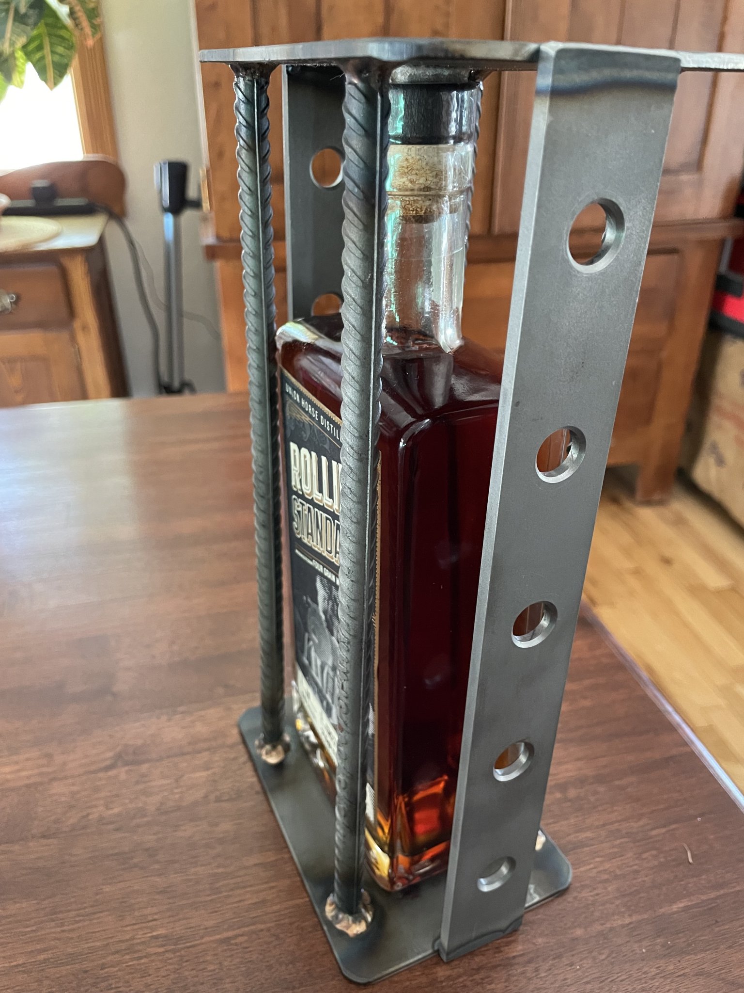

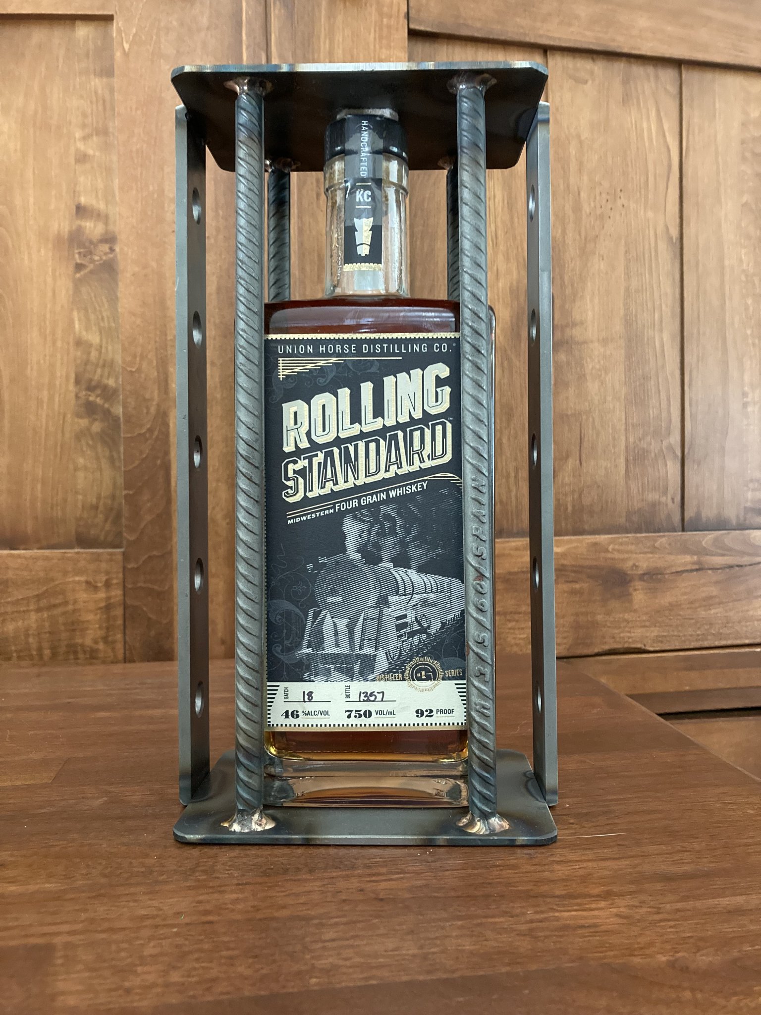

Another one for the microbrew.
Nothing but the finest rebar from Spain.

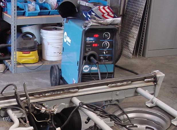

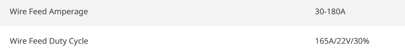

Advice requested!
Lincoln Electric WELD-PAK 180i MP DV
Not a pro welder, amateur hobby welder, just a bit past booger welds. I have an AHP 220 to cover TIG/Stick but need to run MIG too. Material size 3/8" is the biggest I'll be tackling with MIG. Is this Lincoln an acceptable value when I factor in it will be a MIG welder 99% of the time? I really like the simple-stupid setup and most of what I read said the settings just work. Is there a more suitable MIG only inverter machine I should look at?
TIA all y'all...
Advice requested!
TIA all y'all...
It's going to be a little light for welding 3/8". Duty cycle is only 30%.
The old "Millermatic's" have been around a long time and have a, somewhat, higher duty cycle.
Noted and thanks for the input...
Annnnnnnd down the rabbit hole I go........
Found the Primeweld 285. That could replace the AHP on the welding cart and be the one and only. I'm not sure how simple/stupid that one will be but learning new tricks doesn't hurt the brain that much...
Thoughts?

Almost no one actually needs to weld 3/8" as a hobbiest.
And if you do... take your time, learn to multipass, and use what you have.
Welding 3/8" material, does not equate to a 3/8" weld...which should be multipass with ANY machine.
I have passed bend tests with 17v and 140 amps...annually.... you dont need a shit load of power to make good welds
The little lincoln is a good machine.
I love tools and use a 480v, 3 phase machine all day at work, but i come home to a 120v machine with a 40% duty cycle and it does 99% of what i need it to.
So.... dont spend money that you dont need to spend...especially in this shitty economy.

If i had only one machine, it would be a 220v miller.... mig only.
I do stick weld from time to time at home, but its usually once a year on something really dirty...like a trailer or a tractor... that i dont feel like cleaning or pulling into the shop.
Tig welding sucks.... its like a high maintenance blonde... everything has to be just right, clean, perfect, and then you screw it all up and start over at your own cost. Its not worth my time.

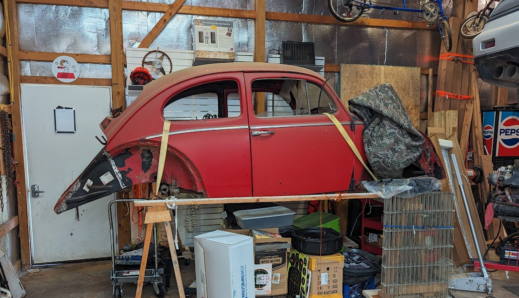

Good eye. The horizontal warped up about a 1/4" but thinking the weight of the wood will take the camber out.

This is my old Miller 252 with the optional digital readout (not all of them have that).
Never had a problem other than consumables like tips, gas cones, and feed rollers.....which should be expected.
Sucker welds like a dream and it's about 20 years old now, still rockin like it did day 1.

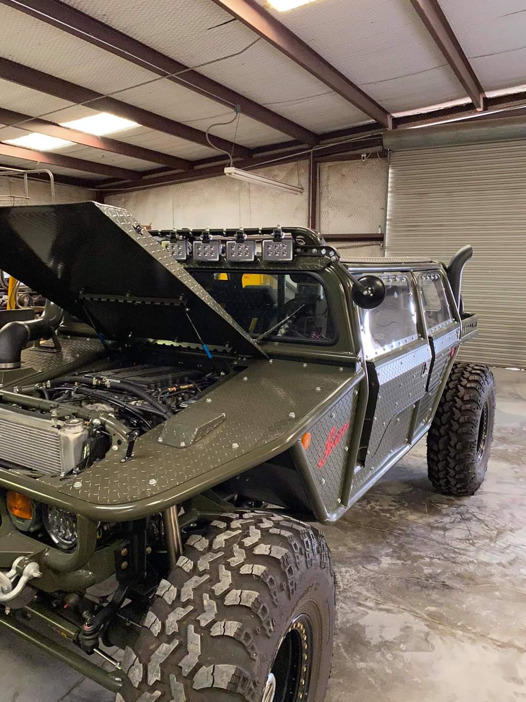

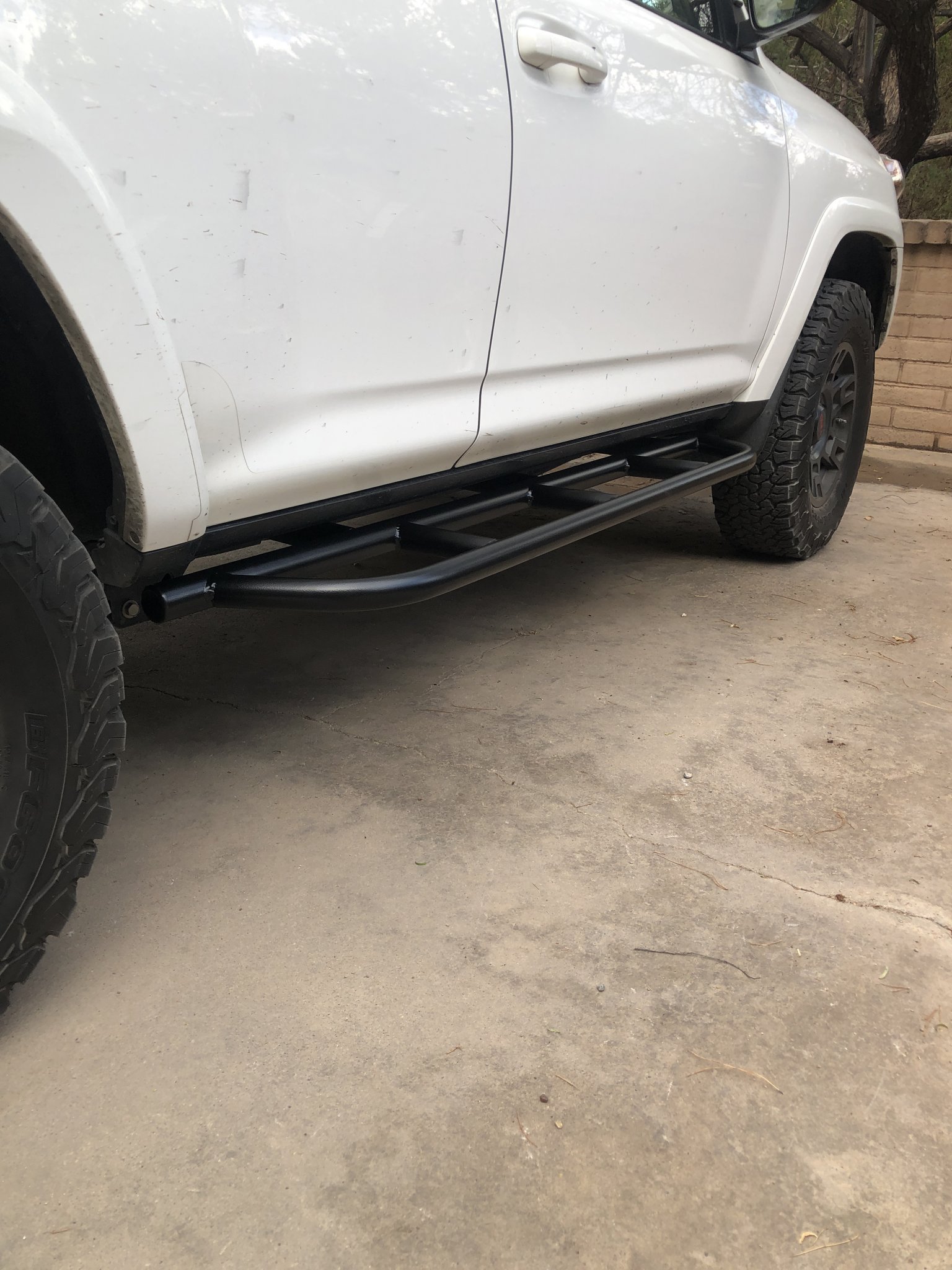

My metal work, it is not this side, for some reason I did not take photos of the drivers side, but the same area, where the black part is.
Next up
Got the wrong muffler, new one is on the way.
Reactions: Balor

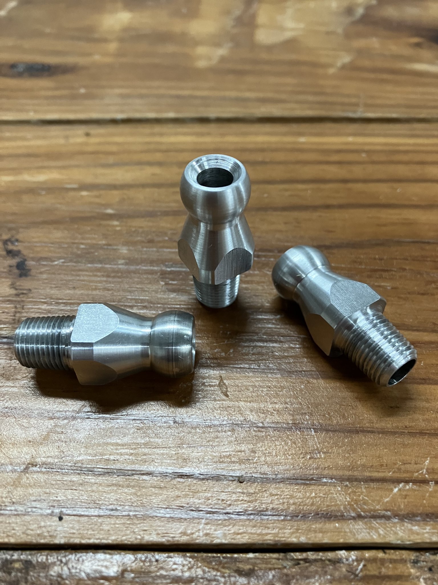

I got super tired of replacing the plastic coolant line connectors on the mills, so we made some. I swear if one of the meat heads breaks one of these…
IF you dont market and sell those, you are a moron. Anodize them, and do it. Im not kidding. i broke one the other day on my cnc lathe by accident, barely even touched it.
