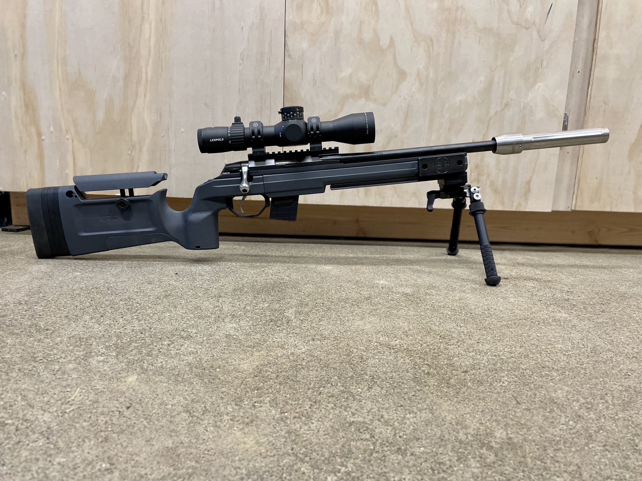

Just finished up this T1X. Set up for shooting NRL 22 matches. Currently weighs in at 15.5lbs. With SK Rifle Match it does about MOA or a little better at 100 with much of the dispersion vertical. I have some Midas + on the way that will hopefully arrive before a match next weekend that should clean up that group a little.
what barrel tuner is this?
Looks like an ATS with a suppressor in front.
