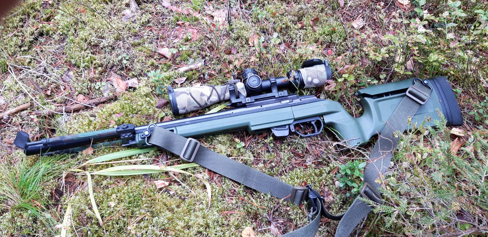

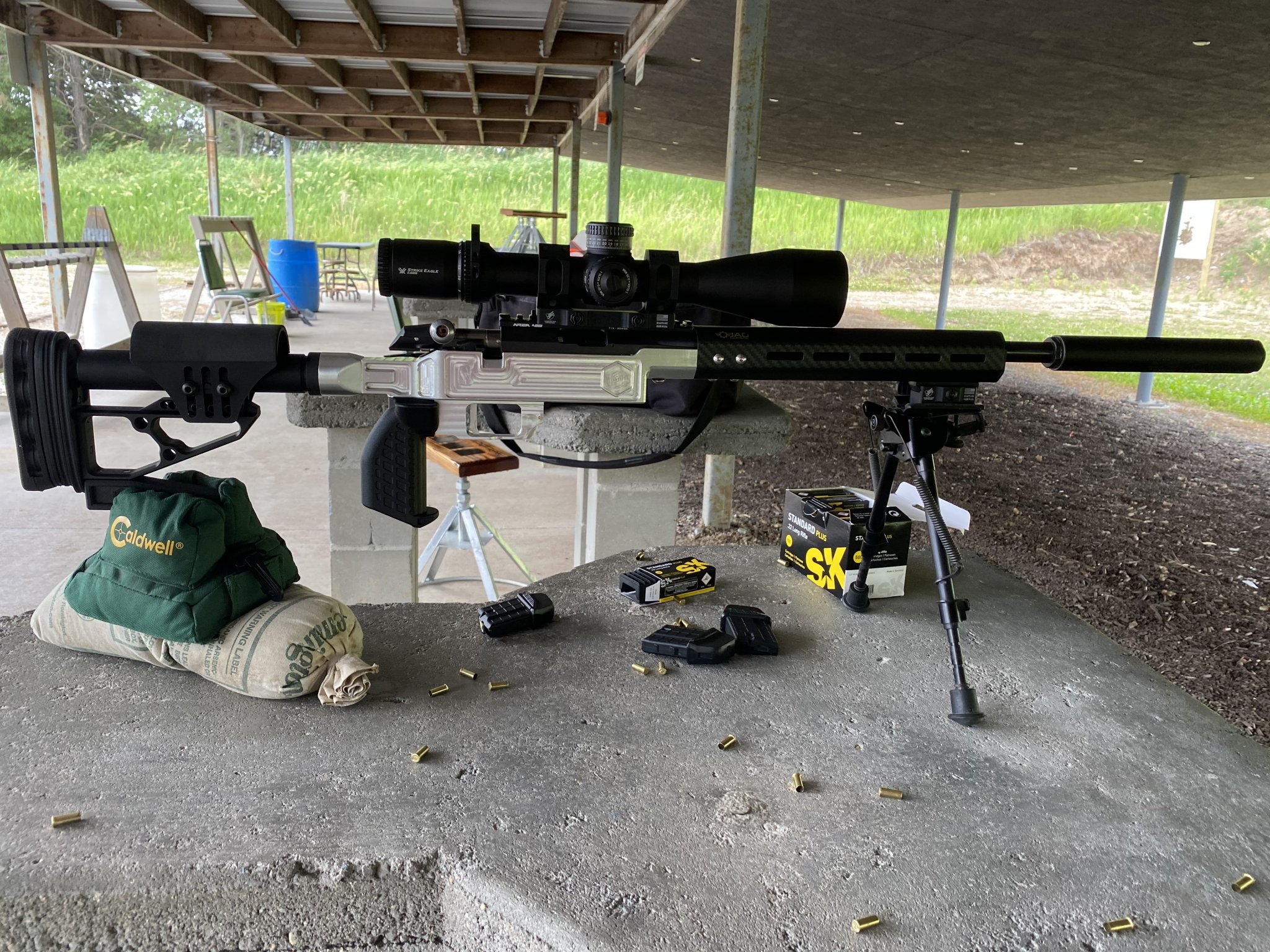

So I got the Tikka out this weekend for it's maiden voyage. I ended up gonig a different route on optics due to wanting to try an NRL 22 match, and the MSRP of my Midas Tac would put me into open class which I DO NOT want. I sent Athlon a very polite email asking if they could lower the MSRP of their scopes to more closely match retail, as I bought my Midas Tac based on advice here on the hide. I doubt anything will come of it, but it doesn't hurt to try. I'm well aware of the warranty change on the Covenant scopes, but for the sale price they're going for right now, nothing else was even close feature-wise, and likely not glass-wise.
Area 419 30 MOA rail
Cabela’s Covenant 7 3-21x50mm wrapped in Arken Halo rings
Tikka T3X recoil pad, vertical grip, and beaver-tail forend
Harris S-BRM 6-9” with S Lock
Mountain Tactical trigger spring, breaks at a crisp 13oz
Form 1 can by Nick at Ecco Machine and Fabrication (re-core)
My only gripe so far was some FTE issues. I’ve since done the ejector spring mod I found here at the hide, and will try that out next weekend. I also have a Victor company cheek rest kit on the way to replace my hasty DIY kydex version. I love this thing and can’t wait to put more rounds through it next weekend. I'll order some higher-end stuff to run through it at some point, as you'll never find it locally here.
Reactions: WeeHooker and clsx
Nice setup, killing me waiting on the left-handed T1X. Who made your tube for the Form 1? I'm running an XRT 6.0" setup and I'm pretty pleased.
Thanks! There were a few lefties on GunJoker when I bought mine. Nick at ECCO machine did the tube work as well as the re-core. It performs, very, very well.

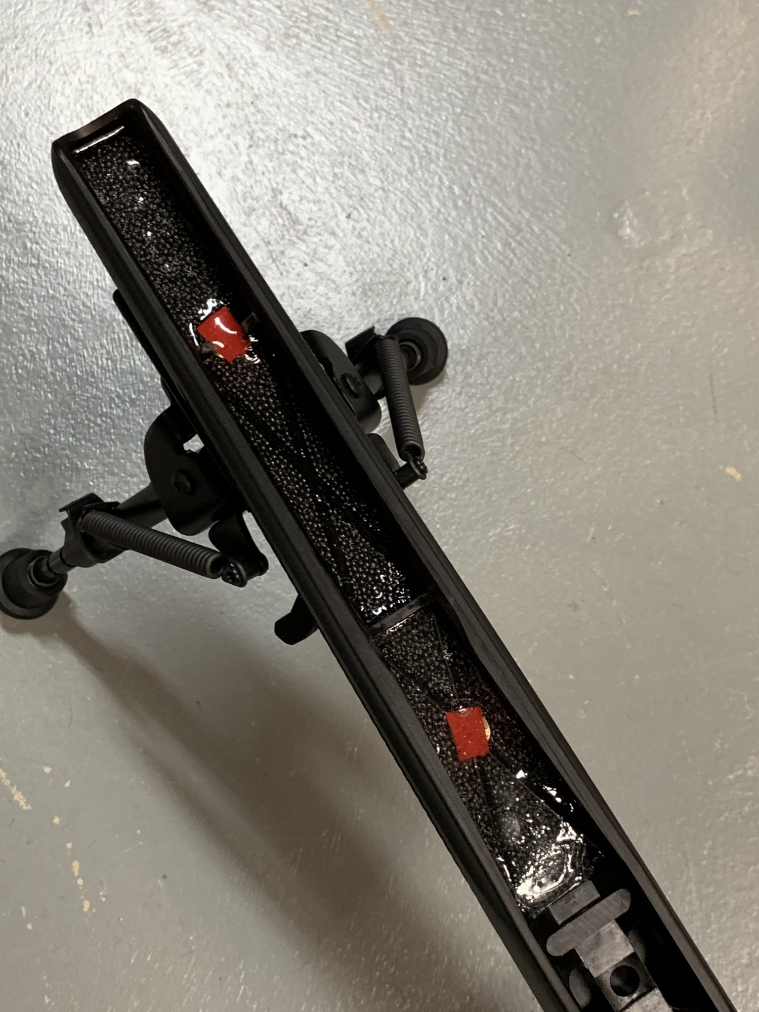

I added a little over 1 pound of #9 shot up front with some epoxy. Also added 4 pounds of # 9 shot in the butt stock ( 4x 1 lbs plastic baggies wrapped in padded cloth. Rifle balance point is the mag well. With an extra 5 lbs on this gun it really feels solid and planted now. I also opened up the channel around the barrel a bit and removed the block. Much better shooting experience now. The red spots are just some tape to keep the epoxy out of the threads of the brass nut insert.

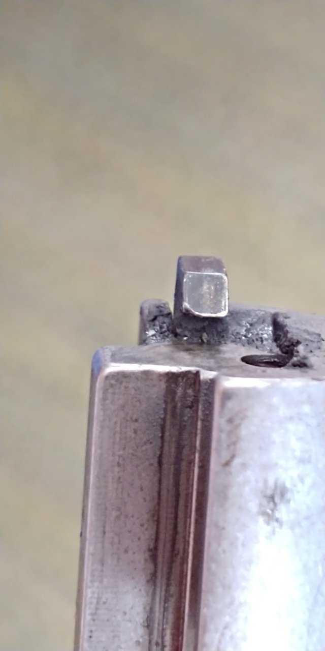

I'm getting extremely weak ejection unless I really man-handle the bolt, even after re-bending the wire according to the post here at the Hide. Is that just normal with this gun? Also, had some fun with CCI Quiets suppressed on Saturday, 6.5mils to get to 100yds. :ROFLMAO:
Apparently this is fairly common. I called Beretta and they sent me [no charge] a new ejector assembly. Only takes a few minutes to install, and helped the issue. It is still kinda weak, but it works most of the time. No where near what you get from Ruger or CZ, and I feel it is just a design situation. Given the way this thing shoots, I can deal with the occasional fail to eject.

I wanted a T1x from the time they were announced, but none of the wholesalers I order from ever seemed to have them in stock. I already had a couple of CMP 40X/XB rifles that I had converted into repeaters using the V-22 magazines, and that I'd re-barreled with Benchmark & Lilja barrels, so while they were very accurate & reliable, I'd set them up as heavy comp rifles for 22RF PRS-style matches, and wanted something lighter, but with very good accuracy. When CZ announced their 457 models, the American really appealed to me, so I ordered one in that had nice wood; it ran smooth & with near 100% reliable extraction/ejection and it was easy to get the trigger adjusted for a light & clean break - but it shot like crap. I wound up putting a Shilen ratchet rifled bbl on it that was about 1/2lb heavier than the OEM bbl and required a little sanding of the bbl channel to fit, but after I chambered it with a PTG EPS reamer, the accuracy is all that I'd hoped for, so it satisfied my desire for that lighter yet accurate rifle, and I more or less forgot about buying a Tikka.
So from what I've been reading here and on other forums, it seems to me that CZ457s' feed & ejection functions are generally very good to excellent, but accuracy is hit or miss - no pun intended. I've read far more reports of very good accuracy with the T1x than not, but have heard from several owners who've had less than stellar function, with ejection issues more common than any other problems. Both CZ & Tikka use hammer forged barrels, so wouldn't it be great if Tikkas were as reliable as the average 457, and the average 457 was as accurate as the average Tikka?
Reactions: HPIguy
So I called Beretta this morning. I was told the updated magazine assembly is not a thing, that they have not changed the design at all, and it's likely an issue with my bolt and I would have to send in the whole gun. With the gun being new, I'm going to run some more rounds through it and see if it improves any. If not, I guess back it goes.

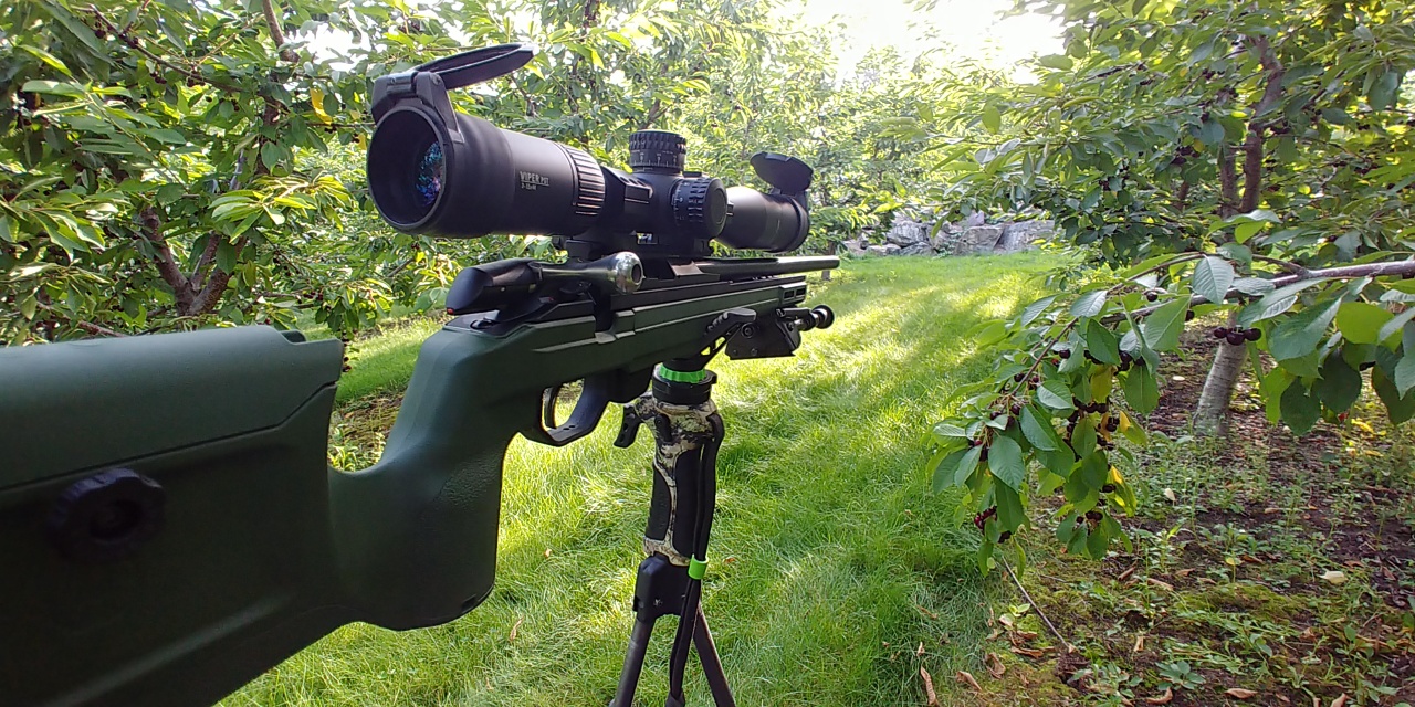

Went back to the cherry orchard early this morning to see if I could eliminate another cherry eating rock chuck. I dispatched a big male a few days earlier. (last Picture) It was a nice morning setting under the cherry trees. Just had to reach up and pluck a few cherries now and then. Sat for 2 hours watching their main hole .
They must have known I brought the Tikka T1x with PST Gen ll scope shooting CCI Quiet 22lr and it scared the crap (pun intended) out of them & because they didn't show. But I will be back again Tough job but somebody has to do it.
In the interest of continuing to try and diagnose my issues before sending this thing back, does this extractor look right? Looks like the bottom edge is rounded off rather than being sharp as most extractors are.

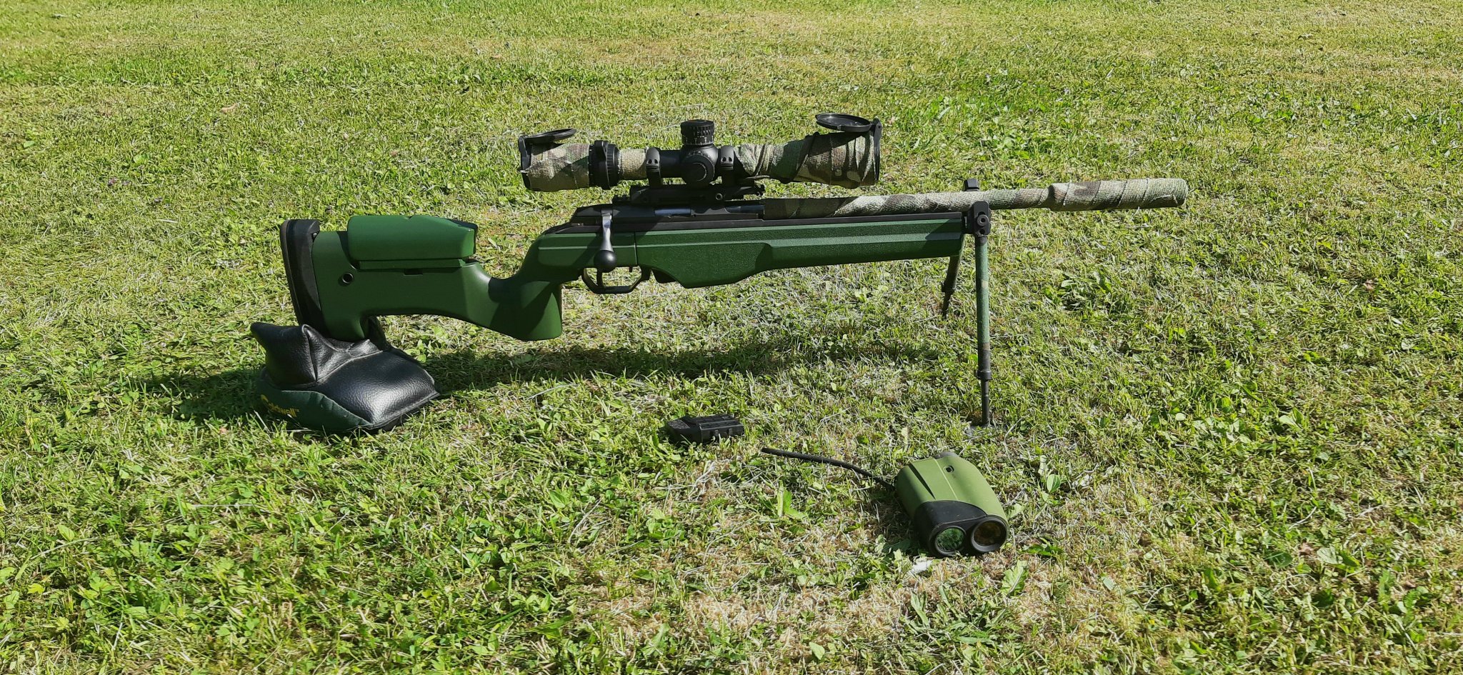

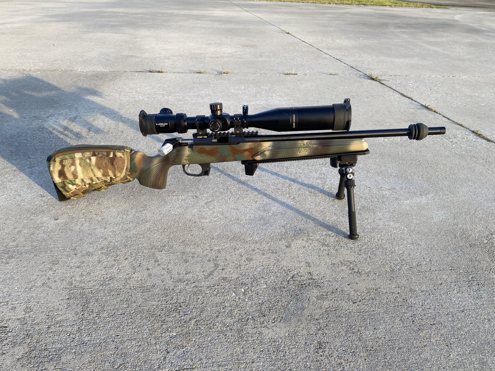

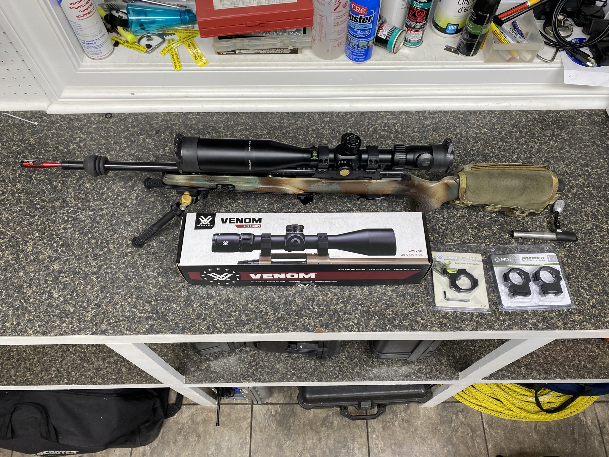

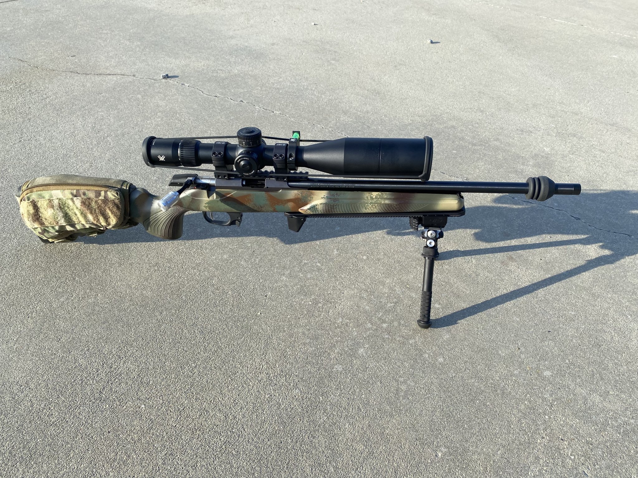

I swapped out scopes on my T1X NRL22 Base Class Bomber yesterday after work.
I had an Athlon Argos BTR Gen 2 6-24 X 50 on the rifle and picked up a Vortex Venom 5-25 X 56 at a gun show for below MAP.
I used MDT Premier 34mm rings in 1.25" height as they're are not a lot of options in 34mm rings as far as vendors and height.
The scope level is a Vortex as well for this project.
Run down on the Rifle:
T1X MTR 20" Barrel
Stock is the take-off from my T3X CTR with the beavertail fore end and vertical grip plastics + Longer LOP over the .22 Stock.
Stock Pack / Cheek Riser is a Triad Tactical
ARCA Rail is Area 419 as are the Rail Barricade Stop and Atlas Bipod Mount.
Barreled action has a Mountain Tactical Bolt Handle and trigger spring.
The Pic Rail is another Area 419 piece with a 30 MOA slant in it.
Barrel Dampener is from Limb Saver / Sims Vibration Labs - Standard size
The bolt handle is one that I machined out of aluminum hex bar stock in my home workshop - Lathe and vertical mill

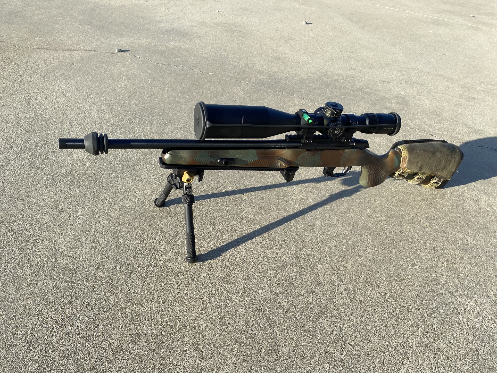

After Photos:
Initial impression of the Venom is that the glass is a pretty good step up from the Argos corresponding the increased cost between the two scopes.
The eyebox is definitely an improvement Venom vs. Argos,
The Elevation stop system is a large improvement.
Dials on the Venom are larger w/ 10 mil / Rotation vs. 5 mil / Rotation on the Argos. Clicks are good and solid on both scopes, with a slight edge to the Venom - It Costs More, Expect More.
I have the EBR-7C reticle in the two Razor Gen II scopes that I have on the my other Tikka Rifles, those are illuminated, this one is not. Commonality is a good thing when you only need to learn 1 reticle across 3 rifles.
The Venom is a pretty heavy scope at 35 oz. but the Argos isn't far behind at 29.6 oz.
The weight bias seems to have shifted forward after the ARCA rail install and scope change, but that was with the Bipod as far forward as it would clamp reliably, as well.
Total Weight with a full magazine and the new scope is 11 lbs. 8 oz. on the shipping scale at work.
Hoping to shoot it this weekend to zero it and see if it likes the new optic.

I swapped out scopes on my T1X NRL22 Base Class Bomber yesterday after work. View attachment 7687227
T1X MTR 20" Barrel

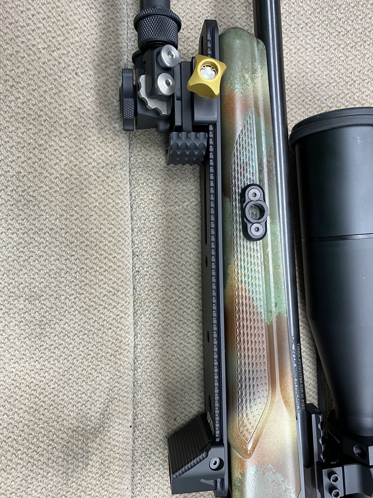

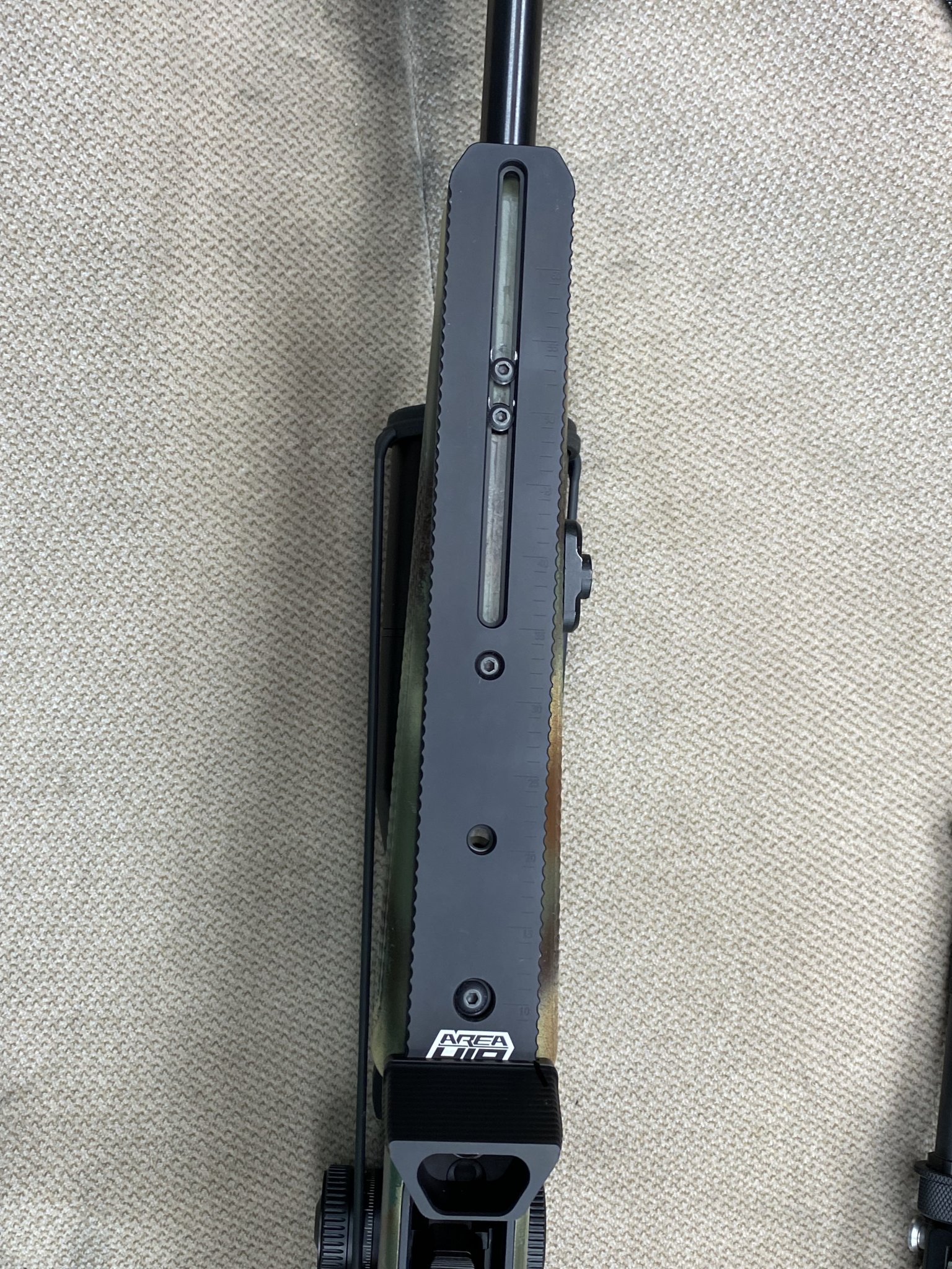

After Photos:View attachment 7687233

11.8 ain’t bad. My T1X ACC is 16ish.
NRL recently bumped the MSRP Limit to $ 1,200.00 for Base Class.
Venom is $ 699.99 MSRP with a MAP of $ 499.00 ish
T1X is $ 489.00 MSRP with a Street Price of about the same right now.
That puts that combo a few dollars under the limit.
I should add some weight to the butt to get the balance a bit more neutral, and that would probably end up in the 12.5 to 13 Lbs. zone.

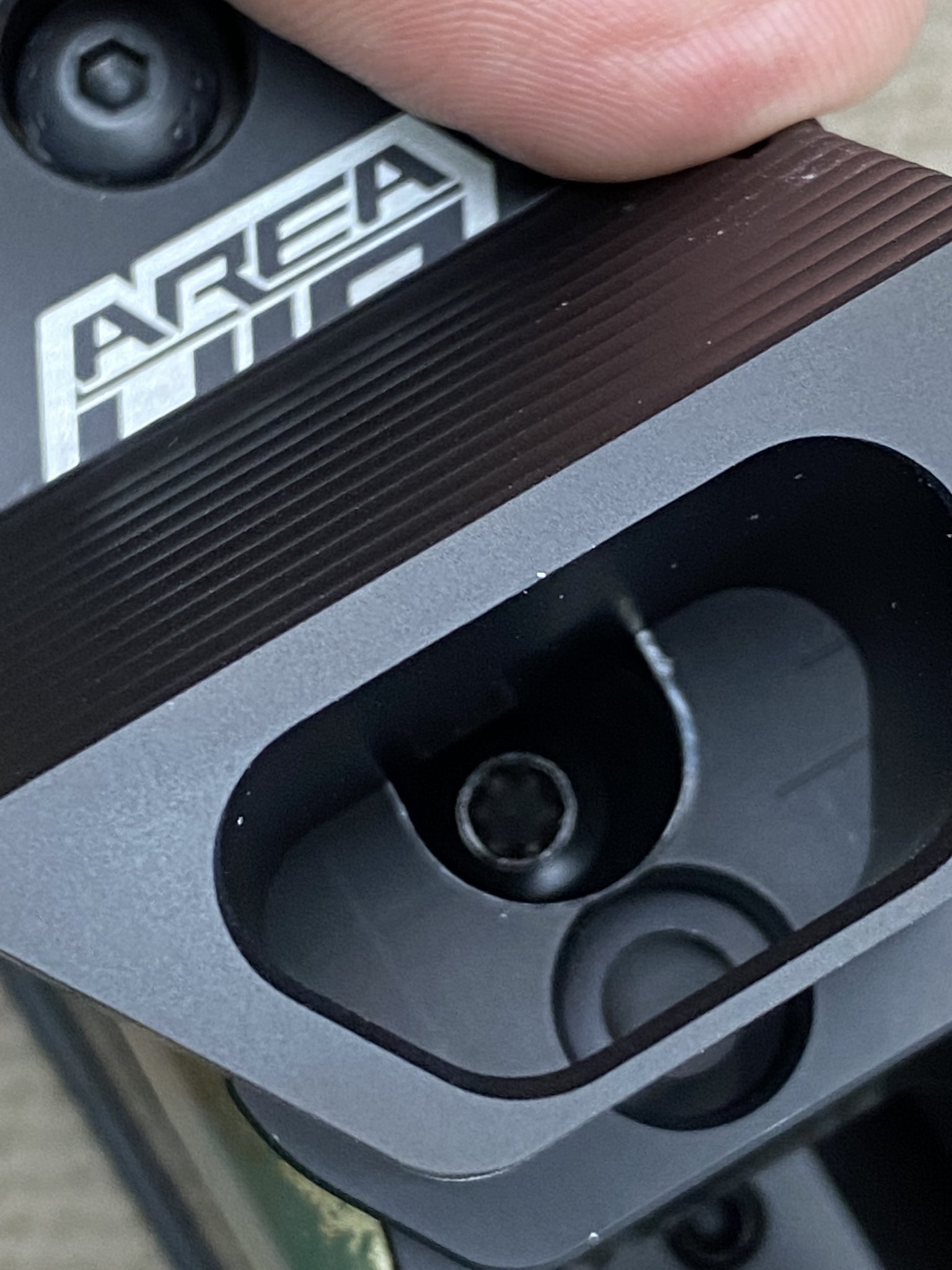

The ARCA is a 12 inch, and all the toys, knick-knacks and do-dads makes it add up...
The goofy fastener spacing is due to experimenting with a KRG rail off of my Bravo chassis prior to see if it was a viable option.

I only did the 20" to match my T3X CTR. And I actually like aesthetics of the 20" with the can, but we're all different. Long centerfires (26"-28") with a can look way worse to me. Hell by the time you get to the end of the can, you're halfway to the target. :D
I gave up on the base class thing as after talking to many people, you're just handicapping yourself on glass. Parts inbound.
