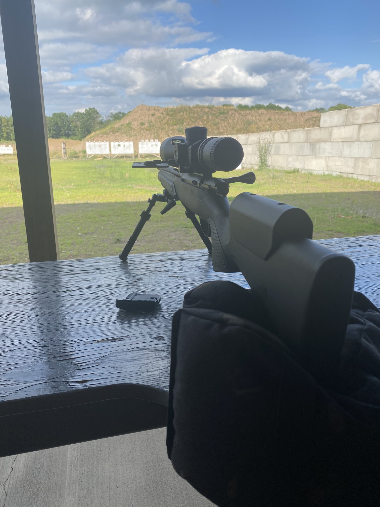

Made another range trip yesterday evening.
Zeroed the scope for 50 yards, Chrono'ed both CCI SV and SK Rifle Match with the Lab Radar and did some shooting.
The CCI SV Ammo @ $0.15 averaged 1080 fps with an ES of 70 fps and SD of 16.6 fps for 38 rounds recorded.
The SK Rifle Match @ $0.27 Per Round averaged 1062 fps with an ES of 42 fps and SD of 11.6 fps for 14 rounds recorded.

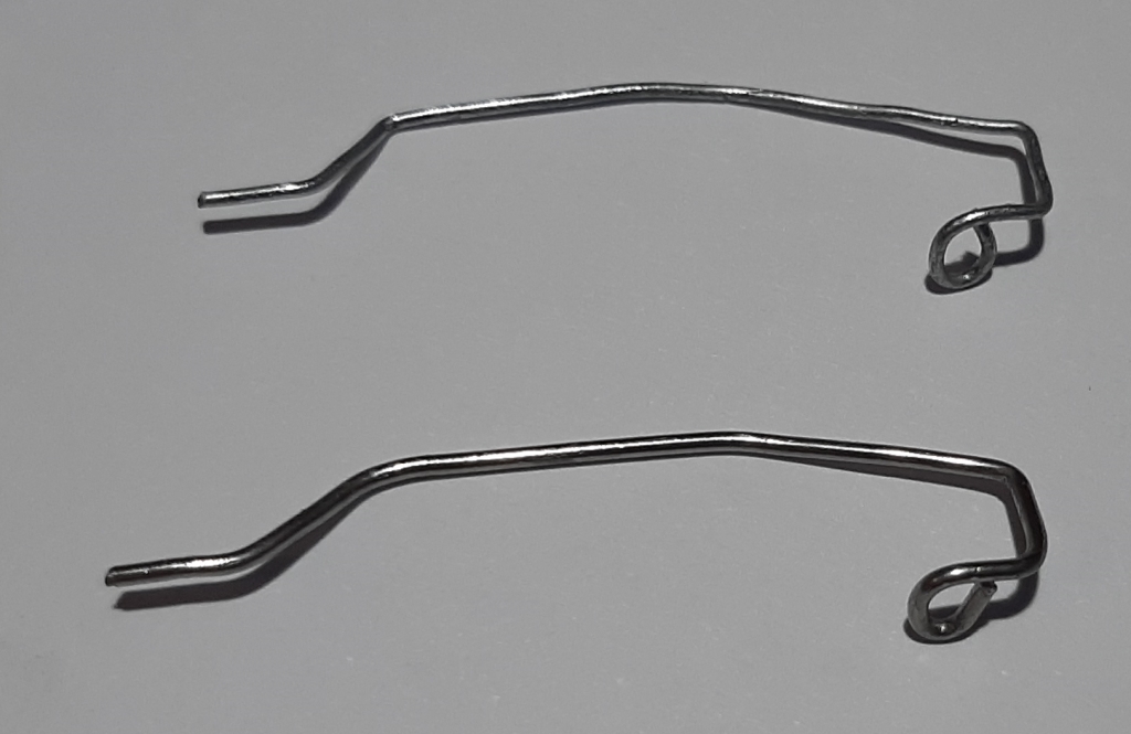

Can you enlighten me on the extractor spring mod? My 16” T1X only fails to feed with Tenex, runs SK clean with all four mags. My 20” tikka Fails to Feed between rounds 5-7 on every single magazine, the same magazines that feed flawlessly on my 16” gun.
If you search for Kissofdeath's video it explains it better than I could. Basically you have to bend the back part of the spring out at an angle so that the bolt pushes the spring out of the way as the round feeds. The round will then feed straight into the chamber if you do it properly. You also then need to take the front of the spring out of its notch and bend the entire spring out to increase the spring pressure or you will have weak ejection.
Also the magazine well screw needs to be loosened and then the well pushed back to its most rearward postion and retightened. Also, there is some side to side slop of the magazine well into the action. I put 2 layers of tape on each side to make it fit snug. Not real tight just snug. Enough to take out the movement.
Also the magazine well screw needs to be loosened and then the well pushed back to its most rearward postion and retightened. Also, there is some side to side slope of the magazine will into the action. I put 2 layers of tape on each side to make it fit snug. Not real tight just snug. Enough to take out the movement.
I will look for that video. Thank you.

I'm getting extremely weak ejection unless I really man-handle the bolt, even after re-bending the wire according to the post here at the Hide. Is that just normal with this gun? Also, had some fun with CCI Quiets suppressed on Saturday, 6.5mils to get to 100yds. :ROFLMAO:
I also had weak ejection on mine when I first bought it. Somewhere between 500 and 1000 rounds it sorted its self out and I would only get weak ejection on the last round of the magazine which was much less of a big deal to me. After about 5000 rounds it went away completely.
Reactions: HPIguy
That would be an excellent solution if I was willing to spend that amount of money. I am looking for something that is about 25% of that cost.
Probably as inexpensive as is out there. Inexpensive camera Arca rail sections and clamps from Amazon to mount it.
You'll also find pic rail clamps listed as "NATO rail" gear from SmallRig and others.
Reactions: Buckhead
No, it is not normal to have weak ejection. Mine has not had one fail to eject in about 6 - 8,000 rounds.
If you put the bend in the ejector wire to assist the feeding you also have to bend the entire wire from where it is attached to the screw in the opposite direction to increase the spring pressure. The front of the spring goes into a slot and is kept there by a bit of extension on the spring. I didn't remove my spring screw to put the bend in the spring. I just used a flat screwdriver blade with what I measured would be the appropriate length of the bend. Once I had the bend established then I worked tthe front of the spring out and bent the entire spring outwards from its attachment point. Then I worked it back into the slot. It throws the cases at least 2 feet clear of the action even if I work it slow.
Reactions: HPIguy
Yeah, I did both bends. Maybe just needs more break in possibly. Care to take a pic of yours, or get some measurements of how far off it sits off the magwell at various points? I'd really prefer to fix it myself if possible, I don't have good luck shipping firearms.
I will try and do both when I get back to my house this weekend.

Yeah, took a few tries to get it lined up, but I'm pretty confident it is. Something else I've read is to make sure you push the magwell assembly rearward before tightening the bolt. I'll check both this weekend when I transfer to the new chassis. Thank you!
Be careful when reworking the spring. Mine ended up breaking just by taking it apart. I had to use a loose spring to make a new one. Since then, i have had no problems with ejection. The cases are ejected much further. This is really the weak point of the T1x.

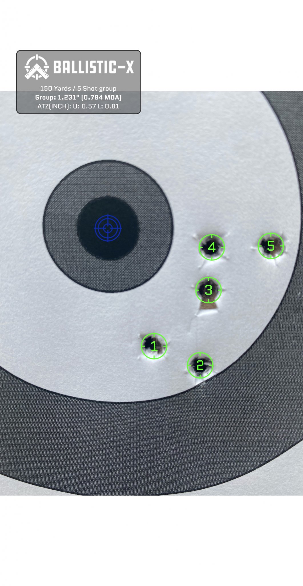

Hello all, I recently got a new lot of SK Long range match. My 20” tikka will shoot groups like the one pictured below at 50 yards, but averages about a 1.5” group at 100 yards…I was at the range yesterday and at 185 yards on a 4” gong I was only able to get 1 hit out of 10 shots with splash both low and high. Could it just be the lot and my rifle don’t like each other? It just doesn’t seem right that I can shoot so good at 50 but at 100 and over it goes to s***. I’ve tried action screw torque from 25-40 and ran patches with boretech rimfire through until clean. Same result. Keep in mind this rifle is well under 1k rounds probably 5-600.
I've seen this with centerfire guns. Ammo will shoot rally decent groups at 100yds, then go to shit at 200 and beyond. I'd bet money if you ran some of those over a chrono, the ES and SD is very high.
That would suck big time. I suppose I’ll have to get access to a good chronograph and try it out. I have 250 rounds of Standard +, Tenex, Norma Tac-22 and CCI Standard in my bag. Will probably just re-zero with what little Standard + I have for the match tomorrow and hope there’s a 200ish yard zero target so I can get my dope.
I really hope that isn't the case for you, but off the top of my head I can't think of anything else that would cause it. I've read on here of guys buying entire cases of the really high dollar stuff and it was all over the place. It's still rimfire at the end of the day, no matter what it costs, sadly.
I appreciate the info. Unfortunately I did buy an entire case as there was no option to buy a smaller quantity. I’ll report back after I do some shooting tomorrow.
.22LR is about good for 2MOA at 200yds at best, just due to statistical dispersion...Shoot 8in plat next to a 4 inch plate and see if you have better luck. In my limited expereince, the best way to test usable ammo accuracy is shoot paper at 200/300. Shoot 3x5 round groups, aggreate the results in an app/excell and do the math on the mean radius of disperion
The weird thing is with my 16” Tikka at the same 4” gong at 185 yards with a different lot of SK I can hit 8-10 rounds every time on a calm day. Just got me a little bamboozled at this point.
The MOA of a group absolutely grows at each distance with .22 and the vertical will be a direct result of the ES.
FWIW I did remove the little plastic support near the chamber end of the barrel and shaved the inside of the stock with a razor knife as it was dragging on a dollar bill. I also used 25 inch pounds on the action screws.
I am using a tuner and there was an obvious change in size and shape of groups at 50 yards during the tuning process. I did not try it without the tuner first though.

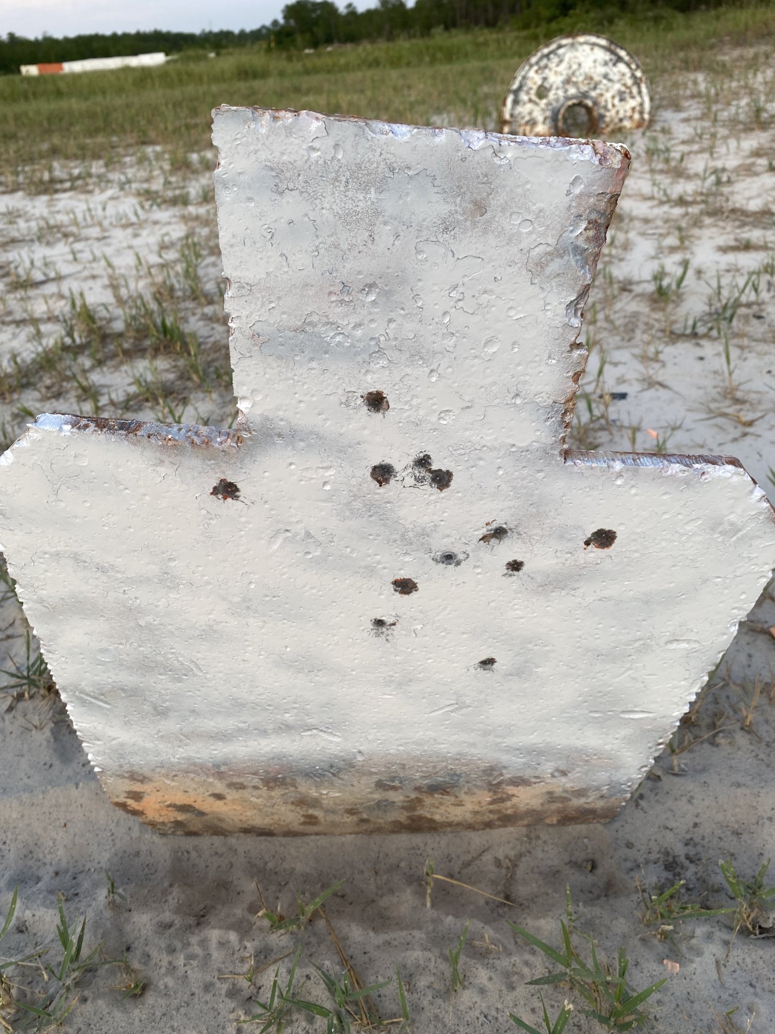

I took my T1x out at range on steel today. Bowling pin shapes at 323 yards were easy with no wind. 2/3rd IPSC at 411 really required being correct on wind; 5-16" between 1-3 mph. I attempted a 10" plate at 502, the effect of the ES was apparent there, hit maybe a third of the time and could see them going over and under the rest. Switching to a full size IPSC at 512 I went 8 for 10, the misses were wide from wind. No access to the targets and no fresh paint, so no way to get any group sizes at that range.

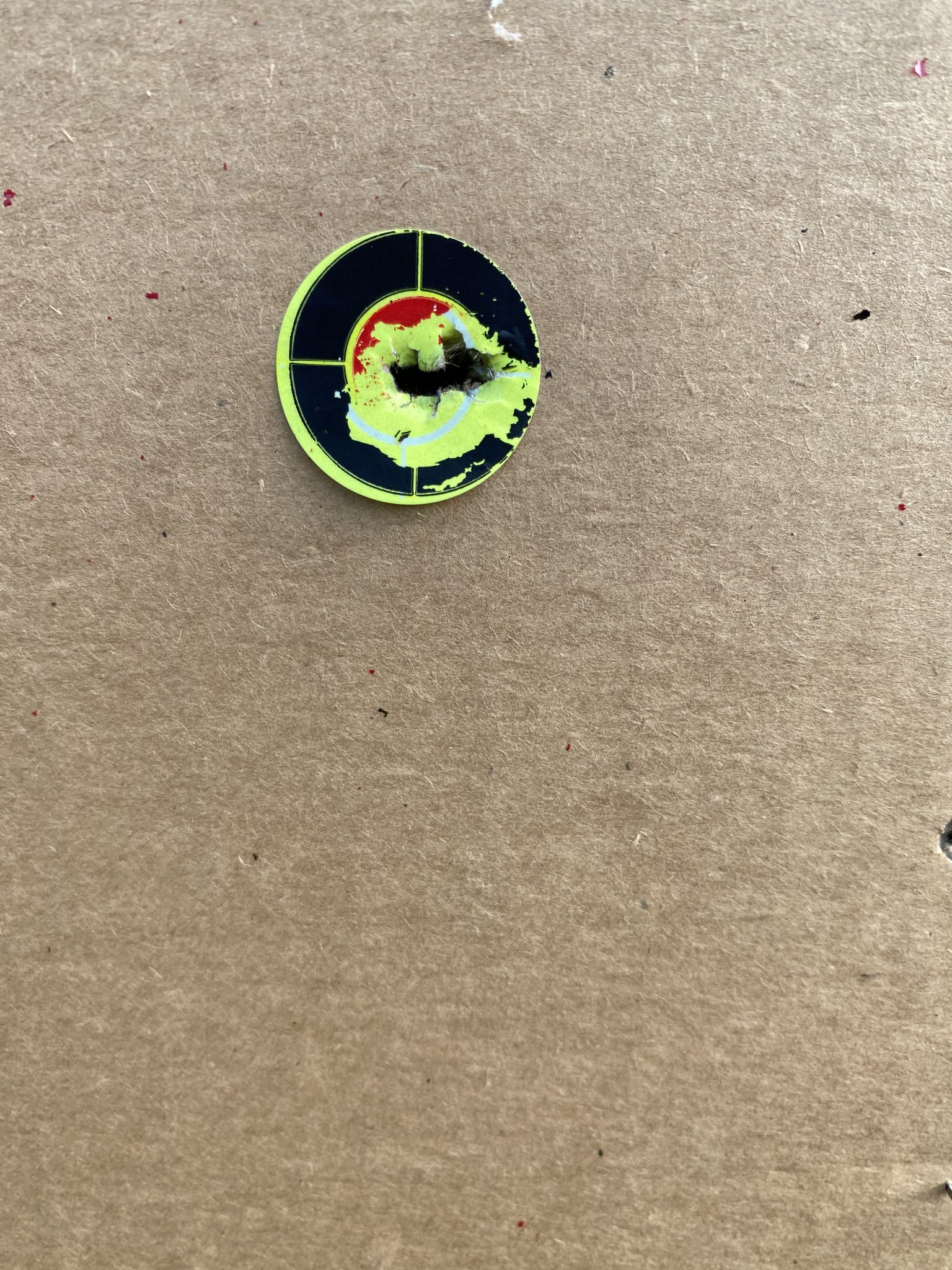

I couldn’t take it. I took a halfish day off work today to drive to South Dakota for my first NRL22X match. After work I drove 45 minutes the opposite way to the gun range. I shot SK LR, Standard +, Tenex, Tac-22 and CCI Standard. After I shot 5 round groups at 150 with similar poor results (2.5- 4”) I figured something was awry.
This is what I ended up with (SK Long range match at roughly 42-43 inch pounds hard to tell with the wheeler wrench). I am more than satisfied with groups like this. 2 more after around MOA. You don’t know what you don’t know I guess.
