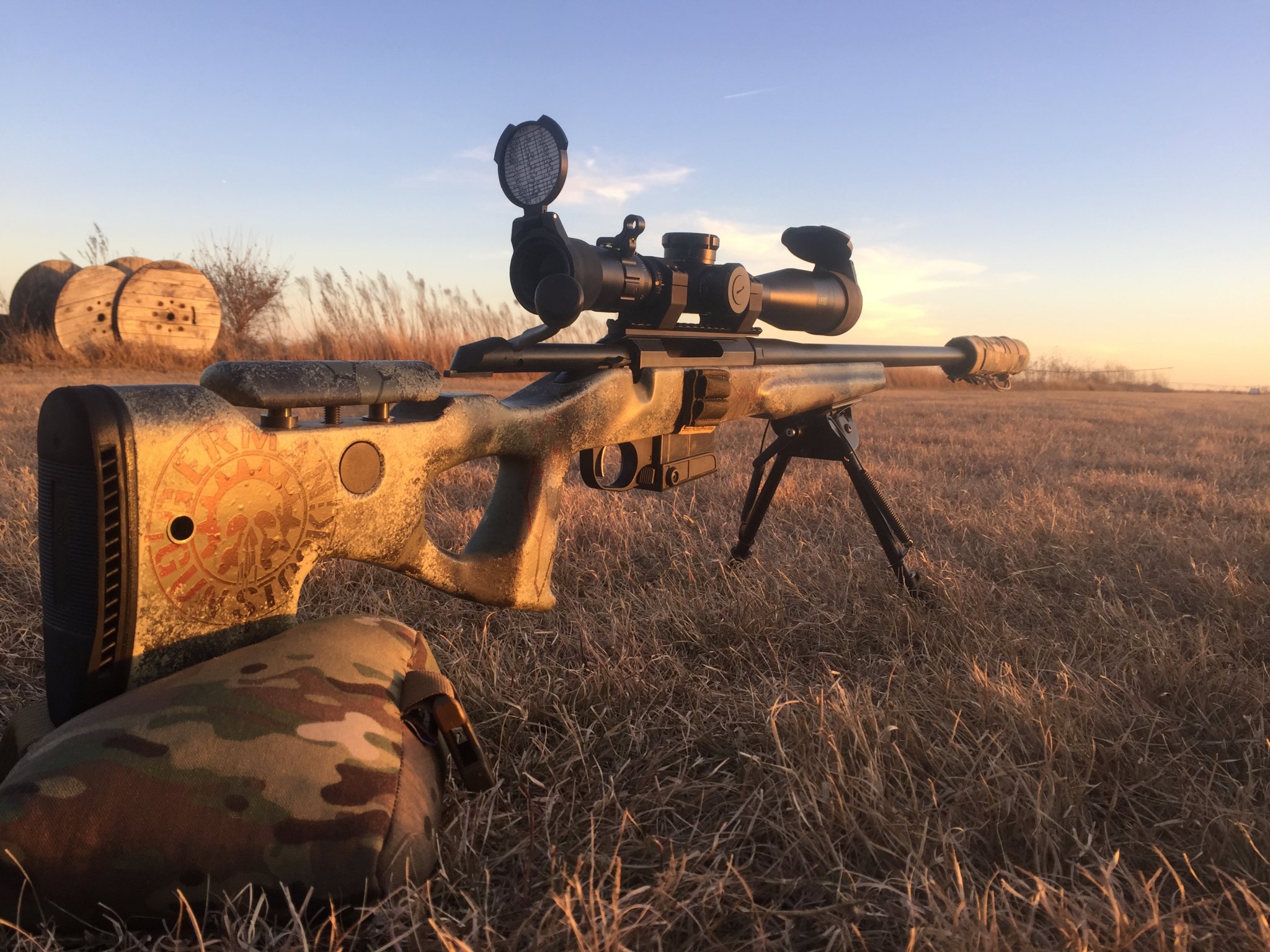

First picture is a CTR in a GGS Predator with factory bottom metal. Second is a T3 270 in a Ranger with the factory bottom plastic. Third is a 223 Varmint in a Ranger with Mountain Tactical CTR bottom metal for AICS mags. The last picture shows the aluminum bedding insert with the stainless steel recoil lug. They also make a Raptor version that I will have pictures of in a week or so.

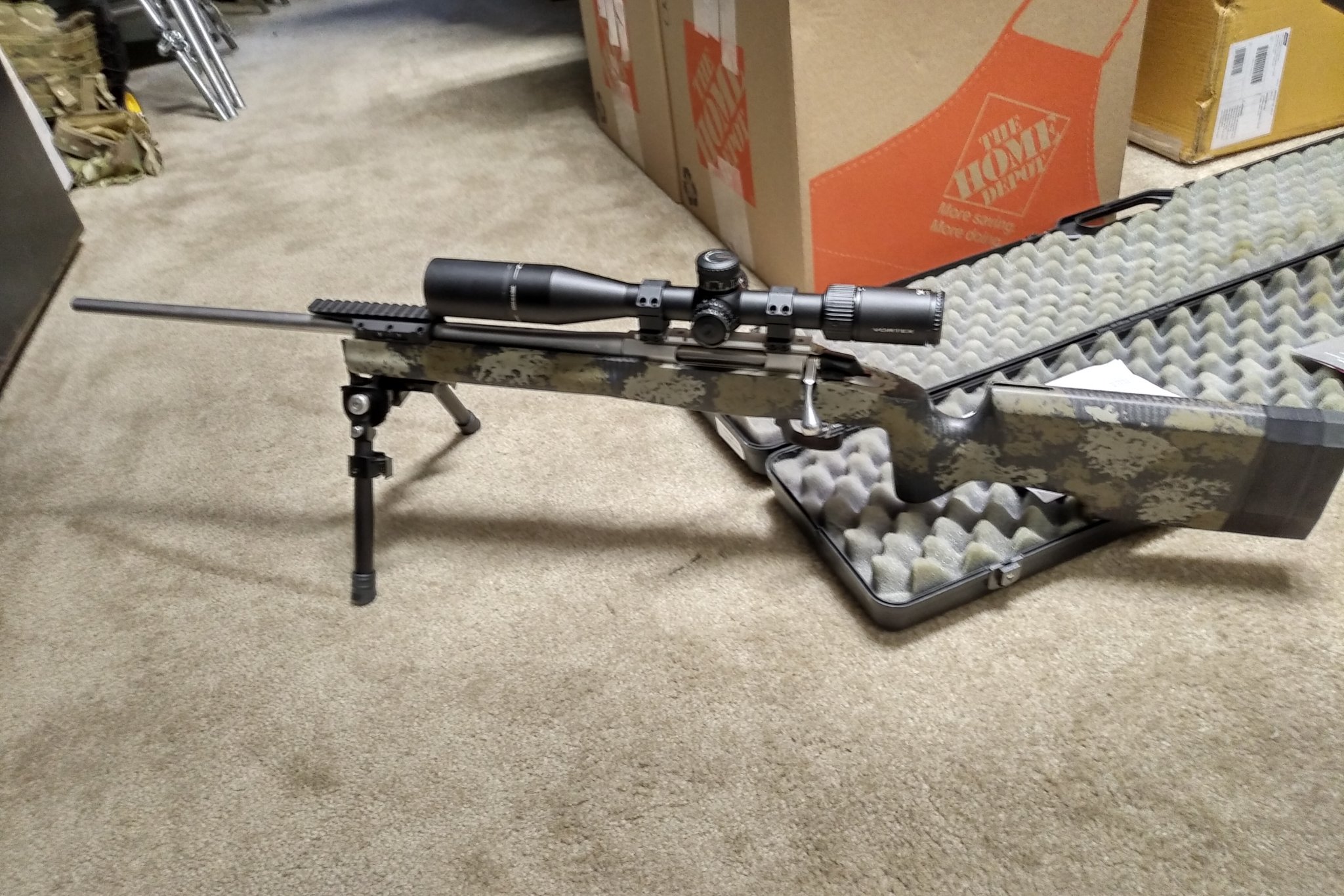

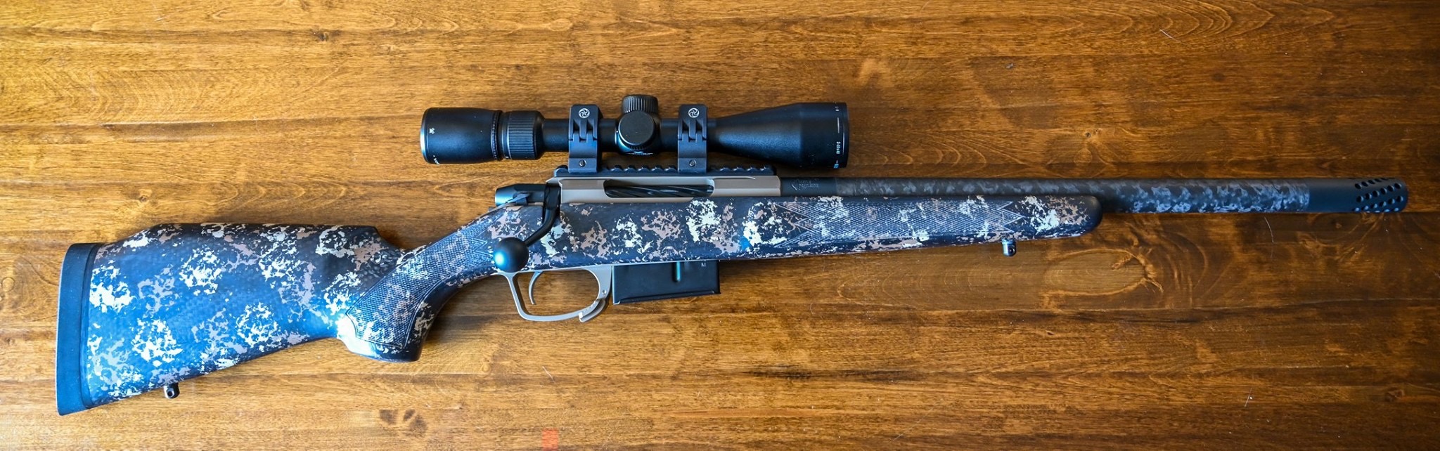

Well, my T3 TAC A1 arrived today and I got to unbox and check it out briefly before heading off to bowling tonight. Wasn’t able to put it in jail yet, so the official clock will start tomorrow evening.
I hadn’t had a chance to check one out in person, so I took it on faith based on many threads such as this that this was the rifle I wanted to buy, and I have to say just in the brief time I had to fondle it I know I made the right choice. It felt great just coming out of the box and shouldered very nicely right away.
Can’t wait to get it out of jail, put my scope on it, and give it a go!

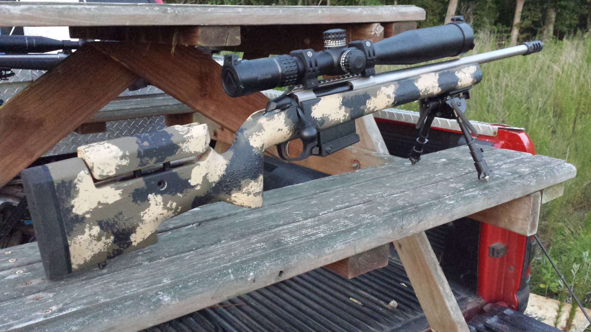

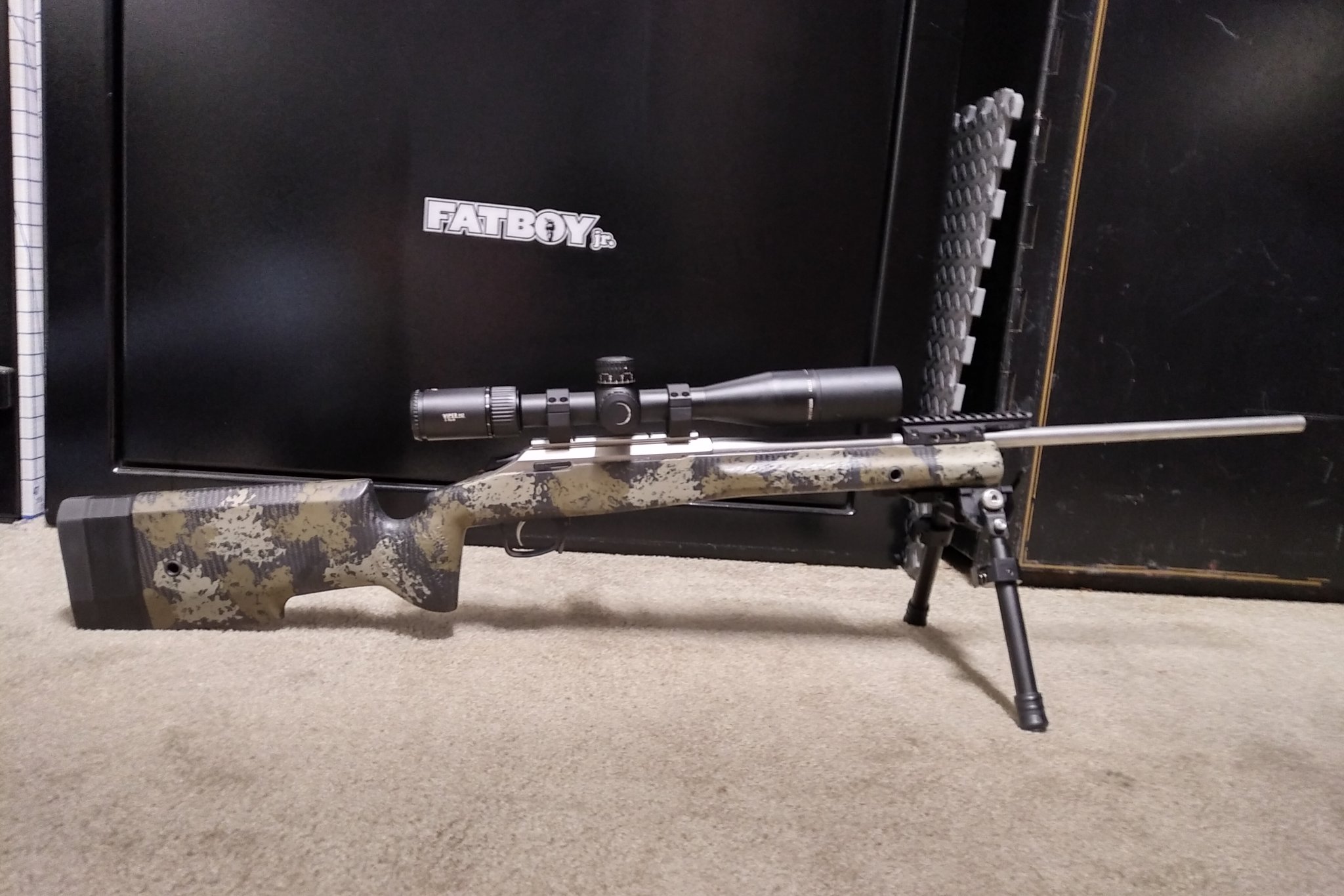

Tikka T3X re-barreled by McGowen Precision Barrels .308 Winchester Match, 1-10" twist, Stainless Steel (Cerakote in Burnt Bronze), Medium Palma Contour, 11 Degree Crown, 26" Long. 5/8"x24 TPI Muzzle & Area 419 Hellfire Muzzle Brake in an MDT LSS chassis. Athlon Ares ETR 4.5-30X56 APRS1 FFP IR MIL Scope on a Mountain Tactical 20-MOA Base in a 34mm tube Burris XTR Signature 1.0" Height Rings

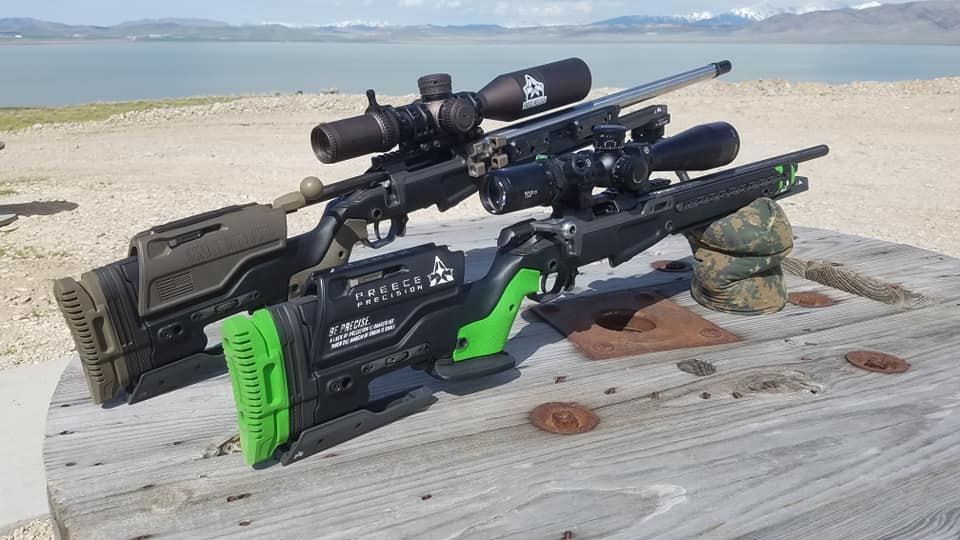

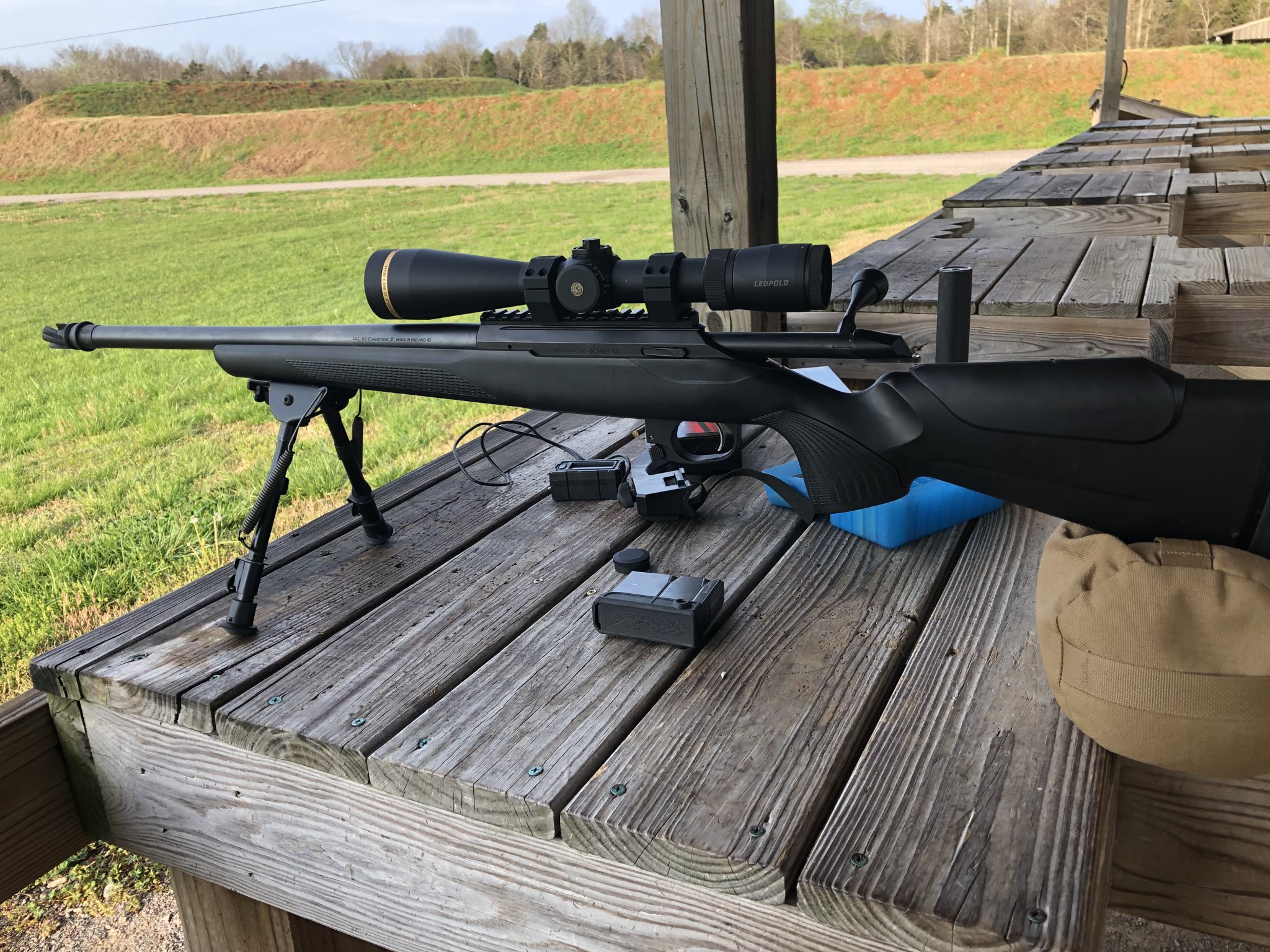

Tikka CTR with factory barrel cut to 16.5
Thunderbeast cb7
130 gr hornady ELDM, RL16 shooting 2616fps.
Took it out the 1000 and back and vx5 was great but not going to be serious dialing as this will be a suppressed hunting rifle but good to know it’s capable!

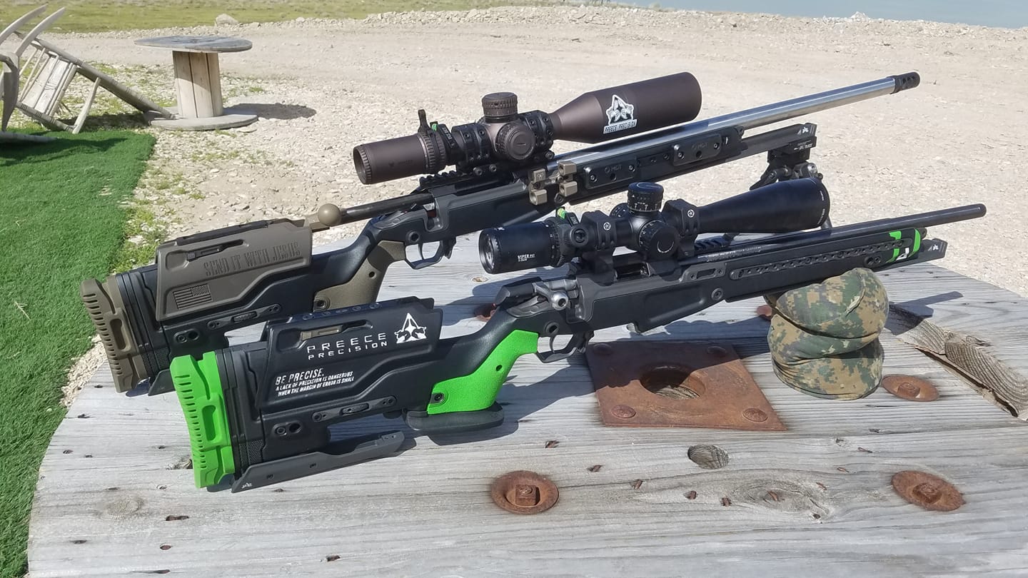

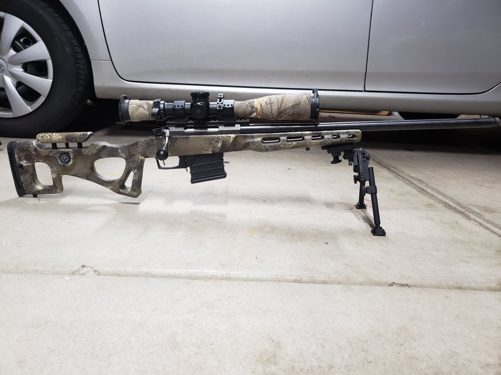

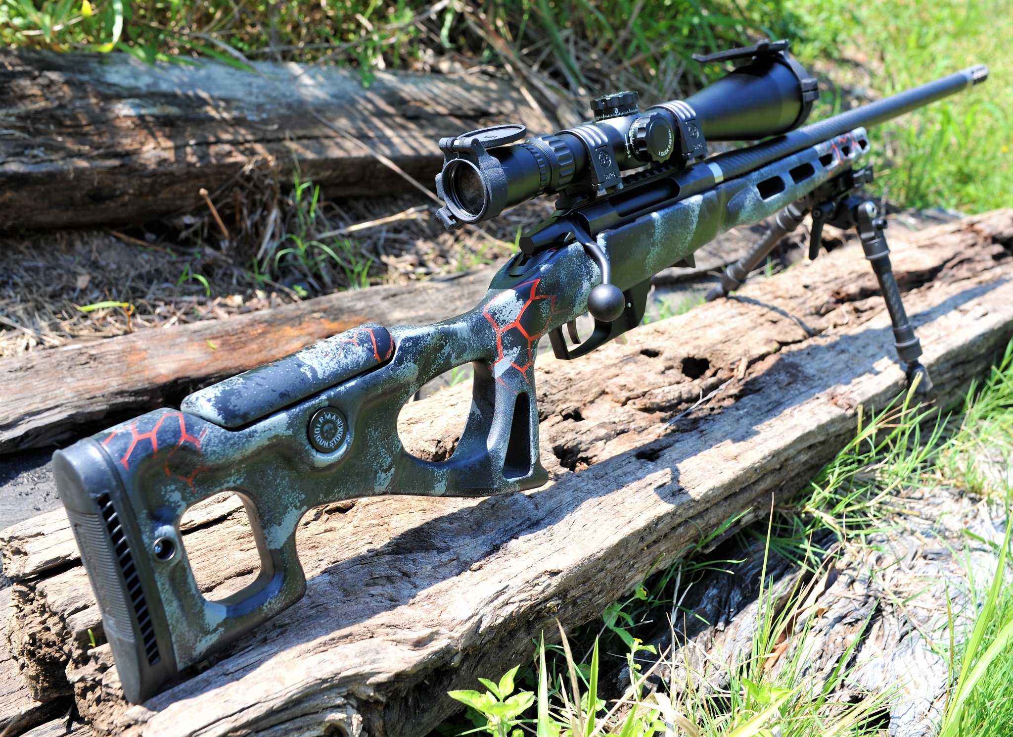

Took the 6Creed out over the weekend to get it ready for the Mayhem national match here in Utah this upcoming weekend. The thing is a shooter with the 112Gr Barnes Match Burners. I also upgraded to a Sphur mount, I had ARC rings on it before but I noticed the hinge pins were walking out under recoil so I figured it was time.
Looking good. Which sphur do you have? And where did you get that arca 2 rail?
