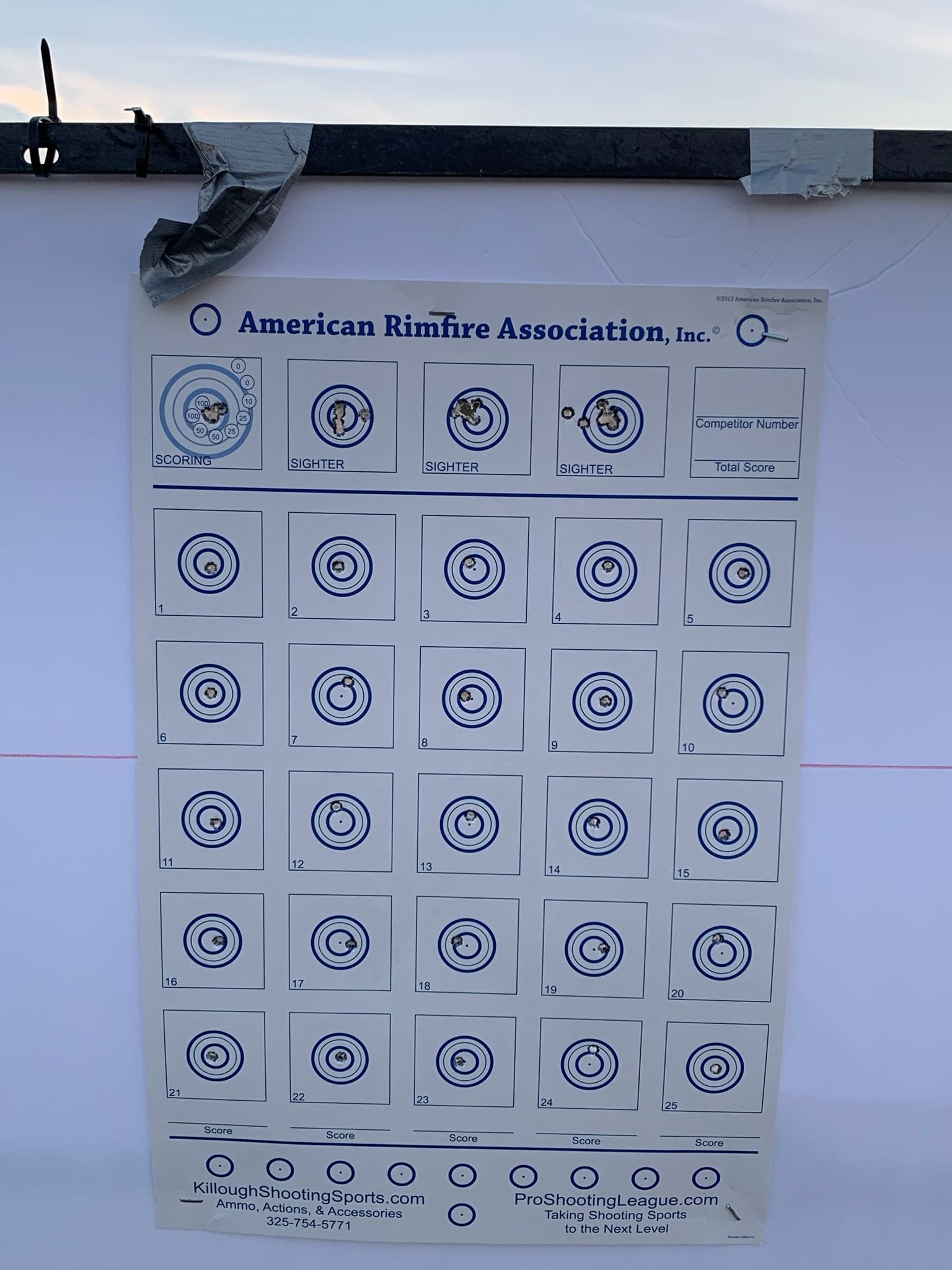

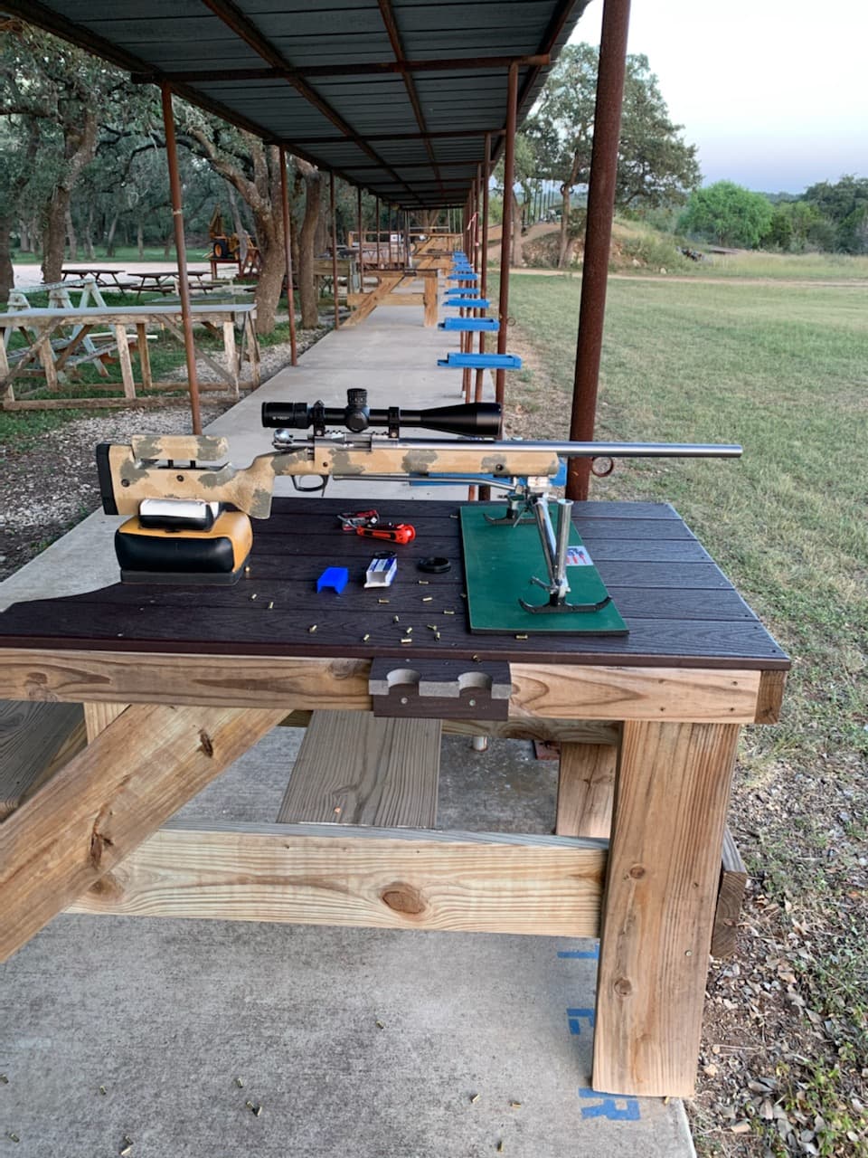

Well my buddy Otis got some range time with his new V22S...Krieger HV barrel, no tuner yet. Here is the first 50 rounds out of the gun. Zero ammo testing just some random CenterX. Switching wind about 8 mph no wind flags.
So, is this good or bad? At this point, it's totally unknown due to the fact it being only a single target shot in conditions I wasn't able to witness.
I've shot enough RFBR matches over the years with all the top shooters and equipment to become fairly adept at judging what competitive scores should be due to wind, range peculiarities, and known shooter's skills along with the quality of their equipment they may be using at a particular match.
In this case an approx 1950 score could be anything from maybe the top 25% to the bottom 25%, but in my estimation it's most likely to be an above average score considering no flags and the reported winds by Mark.
I'd have to say this shows a lot of potential and I'm looking forward to seeing future reports that I might be able to analyze.
For those it may interest, I've created a visual composite of the target using TDS so you can get a rough idea of the shot distribution.
Landy
Landy
Well Landy we should get some more data this weekend. I talked Otis into coming out to a 12 card ABRA match this weekend in Boerne, Tx! He will be using his TR f-class setup at the match.
