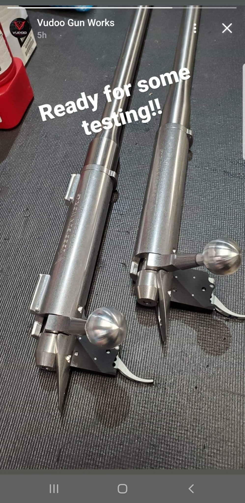

Hey Mike - I thought the contour of the bbl on the left action in your last photo looked familiar, but couldn't tell if it's the same as the Shilen R 5 that I bought in anticipation of receiving my V22S, or the slightly heavier R 0. Killough didn't have any R 0 blanks in stock, and I wasn't really sure I wanted the heavier one anyway, so I took what I could get... Looking forward to seeing your results with the V22S/Shilen, regardless of which blank it is.
The one on the left is the R0 Shilen Ratchet and on the right is the Vudoo/Ace. Ridiculously small groups out of both today with BAs mounted in J Allen and MPA chassis. No tuner, bipod, rear bag, just to set a baseline. Will build actual BR platforms going forward, adding components after each range session.
