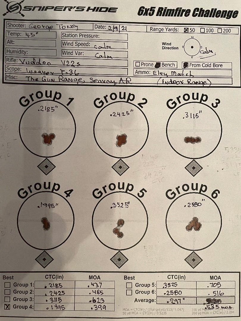

Very little but the V22S seems a bit more consistently accurate. What I was saying is that I have both guns and the V-22 is a wonderful rifle and shoots extremely well (mine has a 18" Bartlein barrel). My V-22S has a 24" Shilen Ratchet barrel.
It would be more helpful if you explained the problem you are seeing.
Usually, it is absolutely pointless to weigh in on internet group postings but for Gods sake, make SOME reasonable attempt to be accurate every once in a while.
Follow along...we’ll use only #4 as an example.
Now a .22 bullet hole has a generally accepted diameter of, say, .220” properly using the outside of the smear. you wish to add/subtract a few thou....fine. If you have a group with two holes EXACTLY side by side, it would measure .220”
If you have a group with two holes, with paper in between them.....it is mathematically impossible to measure less than one bullet diameter.
Not my issue, a basic math issue. 1/2 those groups are off, but hey, what do I know. This is not very complicated folks.p
this is, after all, somewhat about precision riflery. Does that mean about all matters except accurate evaluation at some level ?
Because the target had a fairly decent resolution and more importantly well defined grease rings, I decided I'd take a quick and dirty stab at the measurements.
It's difficult to calculate the measurement uncertainties for either my numbers or the poster's, but I've done enough of this to be fairly confident they're approximately in the +/- 0.010" range for both of us. That means there's at least a remote chance our numbers are equal, but it's doubtful.
If I had a scanned image with 300 dpi resolution I could lower the uncertainties to around +/- 0.002". There's not a single person in the whole world who can measure RF groups to 0.001", including me, and anyone with sufficient knowledge of metrology would say the same.
I've never posted on the 6x5 thread, but I have monitored it since it began and I noticed this target there a while back and thought it had better measurements than most. It's probably only about 10% from being correct and I've seen Lord knows how many that are so far off that all I can do let my jaw fall to the floor and wonder how it's possible they came up with the numbers they do.
Check my math, but I don't see anything close to 50% error rates.
Landy
Post s
Not my issue, a basic math issue. 1/2 those groups are off by a measure of 50%or so , but hey, what do I know. This is not very complicated folks.p

Travelor, great shooting.! DOES THAT SAY "INDOOR RANGE"?
I have a daughter in Ark, and would love to know more about "A 50 YARD INDOOR RANGE."
Could take my SS for a visit.
