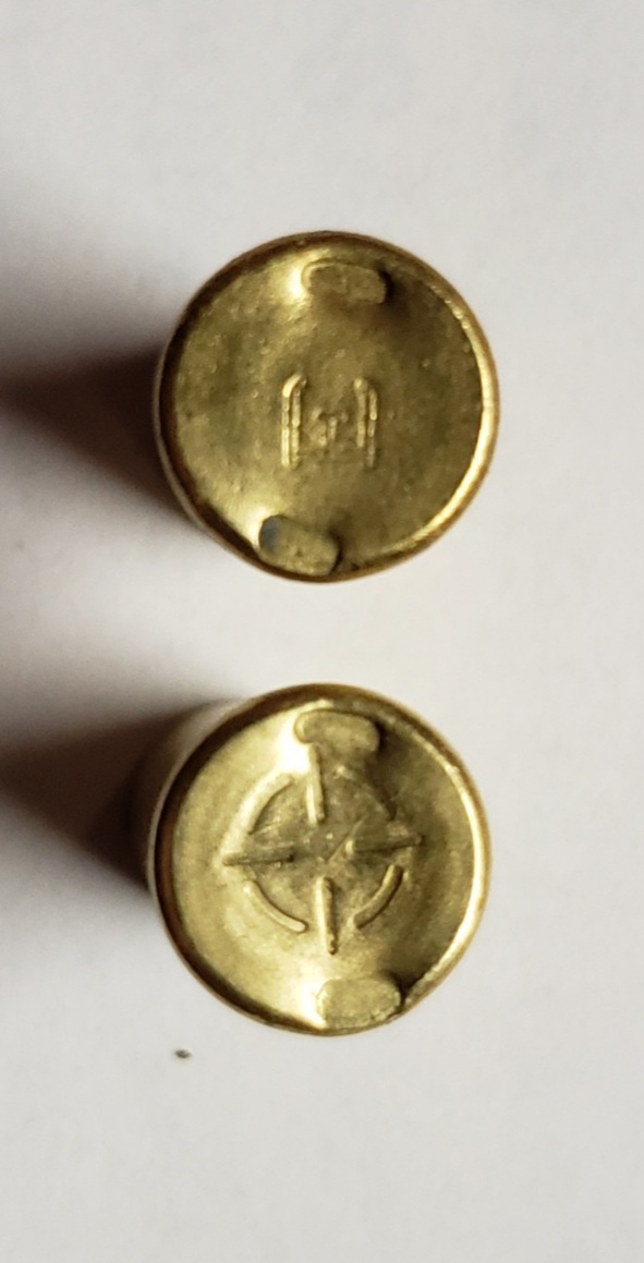

Mike, the new Pin cane today. Big difference, thanks a million.
The two on the left are the strikes from the new one and the 5 in a row are the old.
I also put in the white spring (15#) whereas before I had in the 17#.
Auman, is the new firing pin for a V22s? Looks much better than the earlier version in your picture.

Is everyone going to get this new firing pin?
Those receiving the early actions have the original version of the pin with the impact occurring on a larger radius. The easiest way to know what you have is to read post 1341 in this thread. If your impact doesn't look like the picture I posted, reach out to me via PM.

Mr. Bush to be clear are the actions leaving St George now with the new pin?
RAVAGE88, I have a V22S with the early firing pin. You have kindly sent me a new firing pin I believe ( snow has the USPS not delivering mail). I shoot Eley Match and RWS 50. Which spring would you recommend? I will be taking the bolt apart already and was wondering. I have had zero failures to date.
Start with the one that's in it (its shipped with a 16 lb) and look at the targets. Generally, I believe most are running 14 and 15 lb springs.

I received the new striker/firing pin yesterday, and wasted no time in swapping out the original for the new pin. Hoping to get in a little shooting with the rifle today, although with much cooler temps and a little light snow, not sure that will happen. Thanks for the quick shipping & continuing customer support!

Travelor, I'd been shooting my V-22S with the 14lb spring & the original striker for several hundred rounds and never had a FTF. Swapped striker out for the new one that Mike sent yesterday, and had several FTFs. Took the bolt back into the shop and put the 15lb spring in - still had FTFs, though not as many. Finally went back to the 16lb spring, which is what was installed from the factory, and had one or two FTF out of the final 100rds. Need to message Mike to get his advice; I'd screwed the striker into the gas shield until the threads bottomed-out, then backed it off far enough to index plus one full revolution.

Dennis,
Screw the pin back in until it bottoms out and loosen just enough to index. The additional revolution reduced pin fall by .015" and changed your timing. Please let me know what your results are after you've tried this....

Mike,
I'd watched your video on the V-22S and knew from that about the .015" per revolution due to the 64tpi. Buy them books and buy them books...and they just eat the covers....
