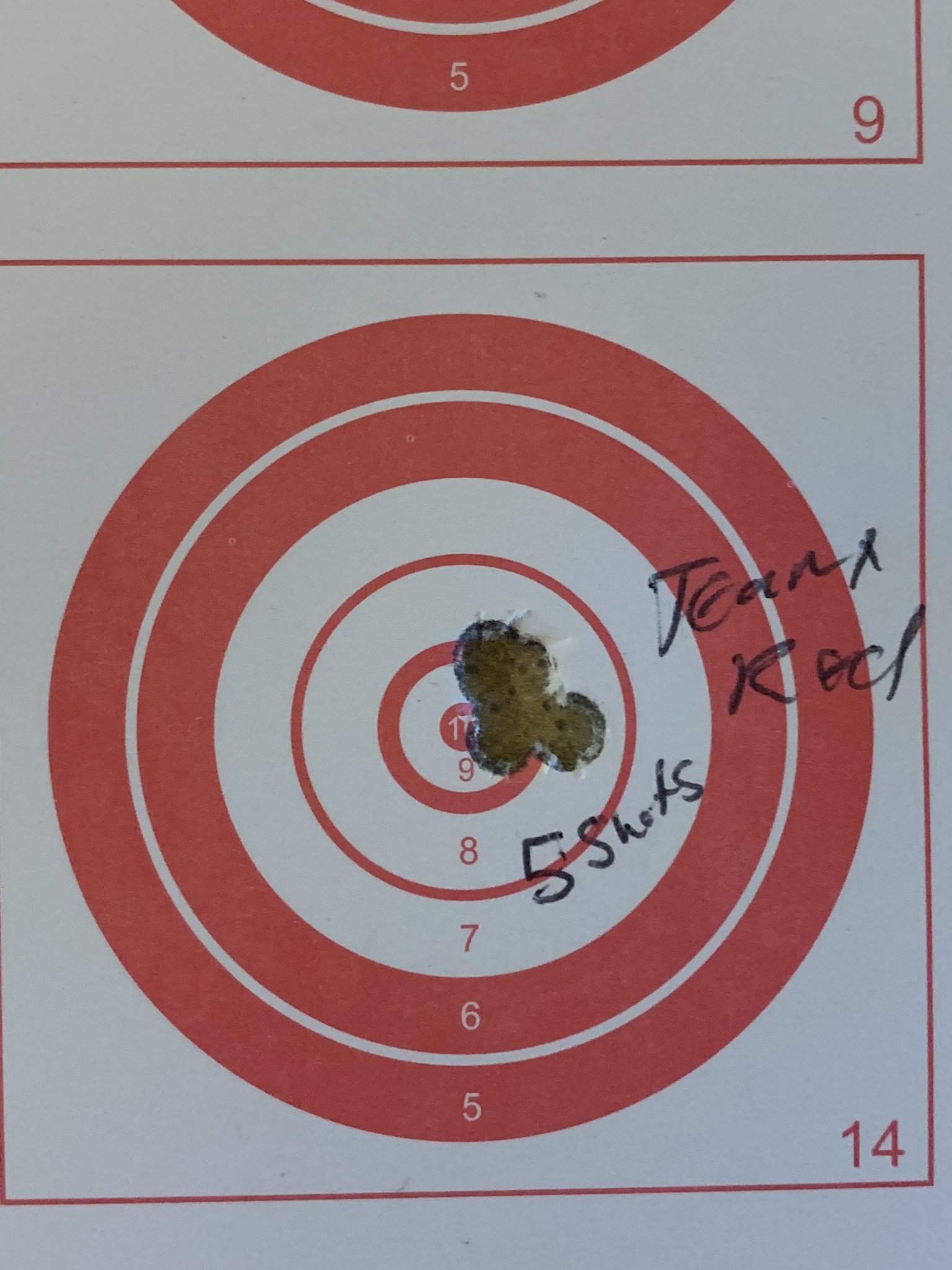

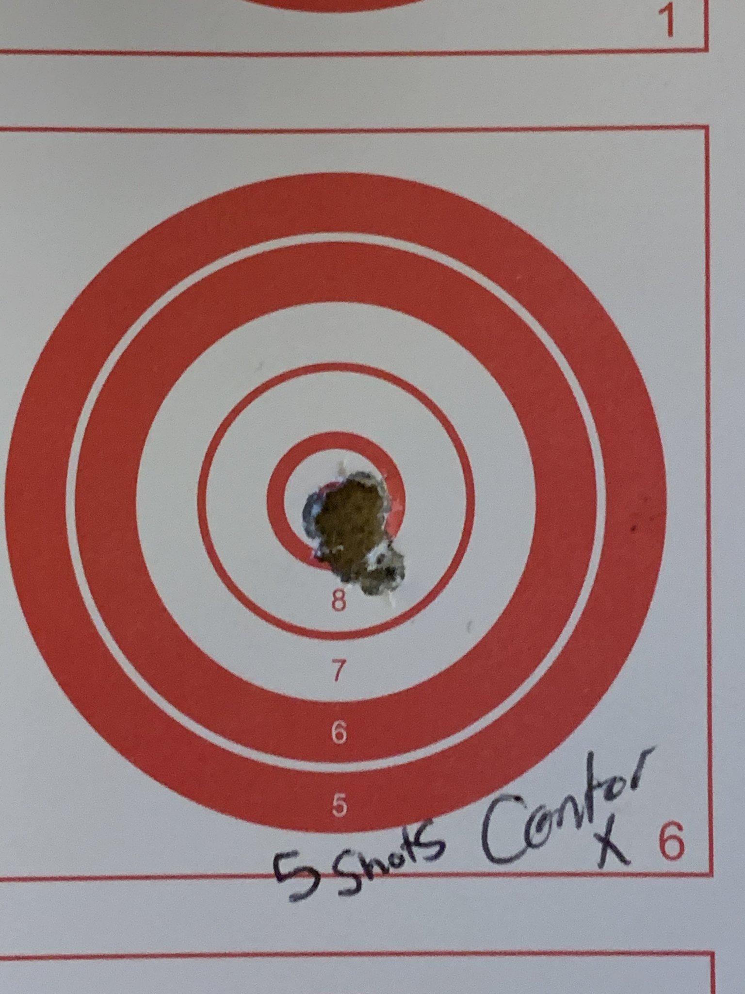

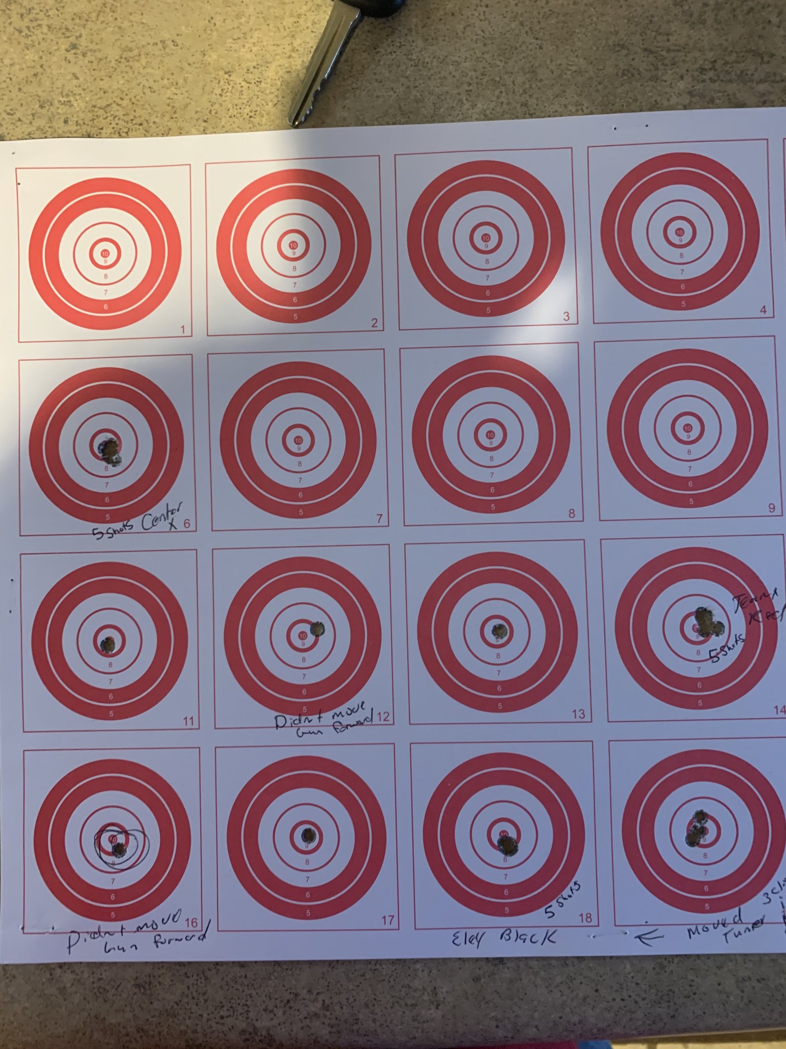

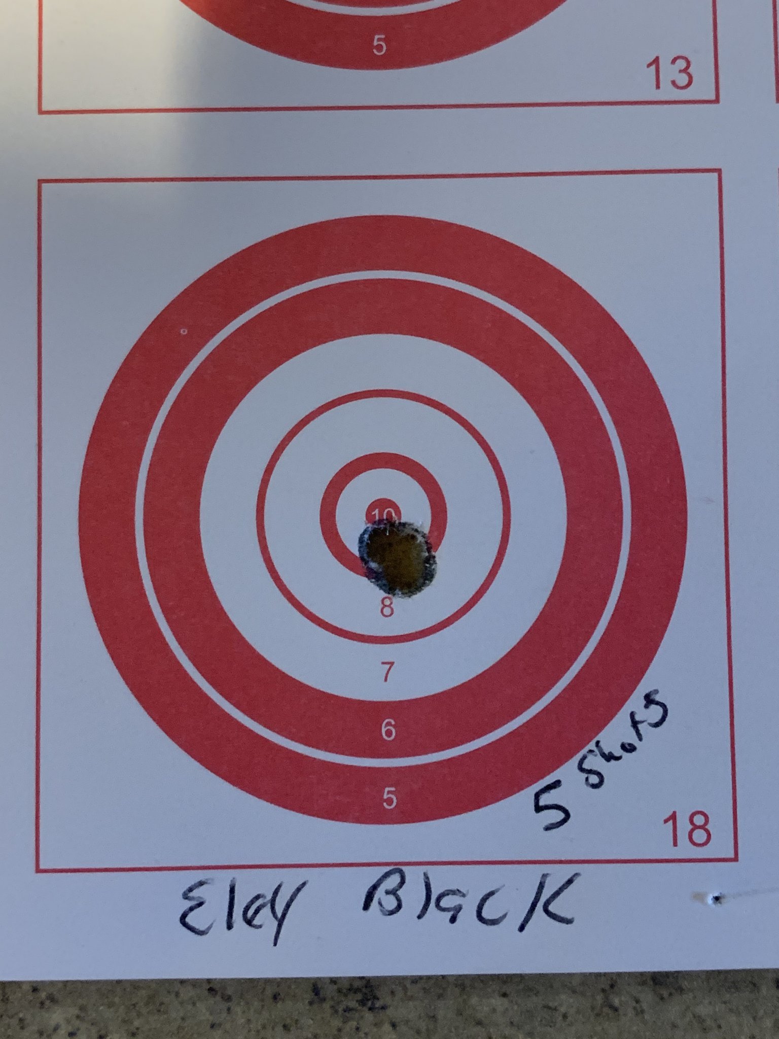

Did some ammo testing and tuner adjusting with mine yesterday.
Dennis,
Screw the pin back in until it bottoms out and loosen just enough to index. The additional revolution reduced pin fall by .015" and changed your timing. Please let me know what your results are after you've tried this....
MB
Mike,
I took the V-22S out today after switching back to the 14lb spring and doing as you recommended, dead-ending the striker threads, then backing off only enough to index it. Fired 90rds without a single FTF, and no more vertical than what could be blamed on the wind. Hoping to get a calm enough day to refine the tuner setting, then get it sent out to Mesa for lot testing. Thanks again for the support!

That's awesome news Dennis, I'm headed to Lapua in OH next week.
Reach out if you need anything....

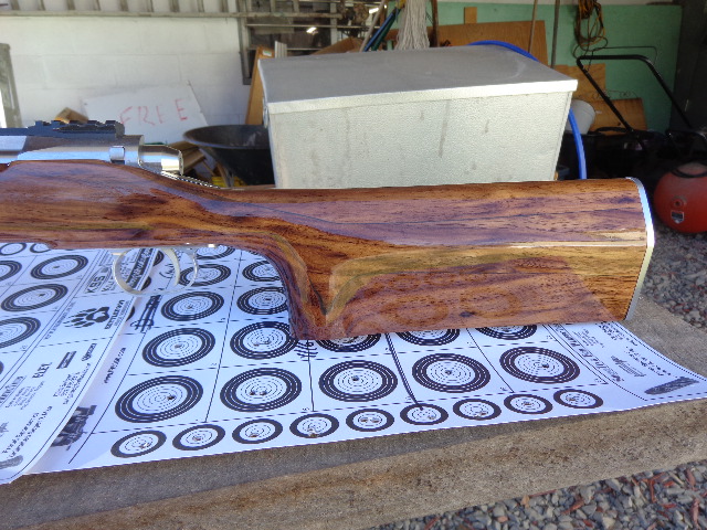

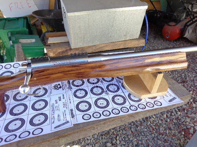

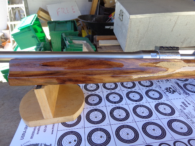

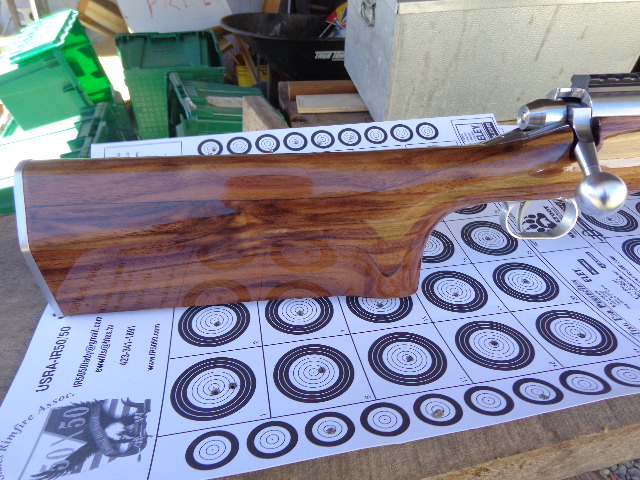

It's really interesting to see something like your new stock Sgeorge - speaks to the confidence you have in your new V-22S, and the fact that someone like Mr. Peightal was willing to take on the project also speaks of his regard for the potential of the V-22S. Very much looking forward to seeing photos of the finished rifle, and groups you get out of it once you get it in hand.
While I won't be shooting any big RFBR matches with my V-22S this season, I'll certainly be watching for news of how the new rifles built on this action perform for those who're able to make some of the matches.
