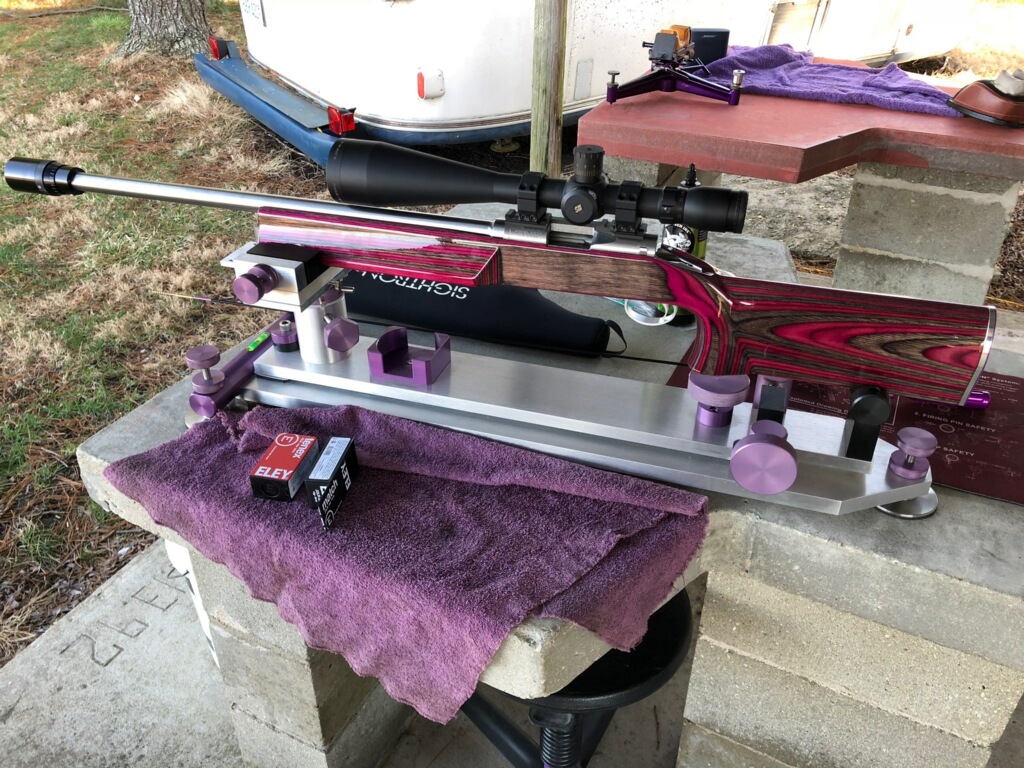

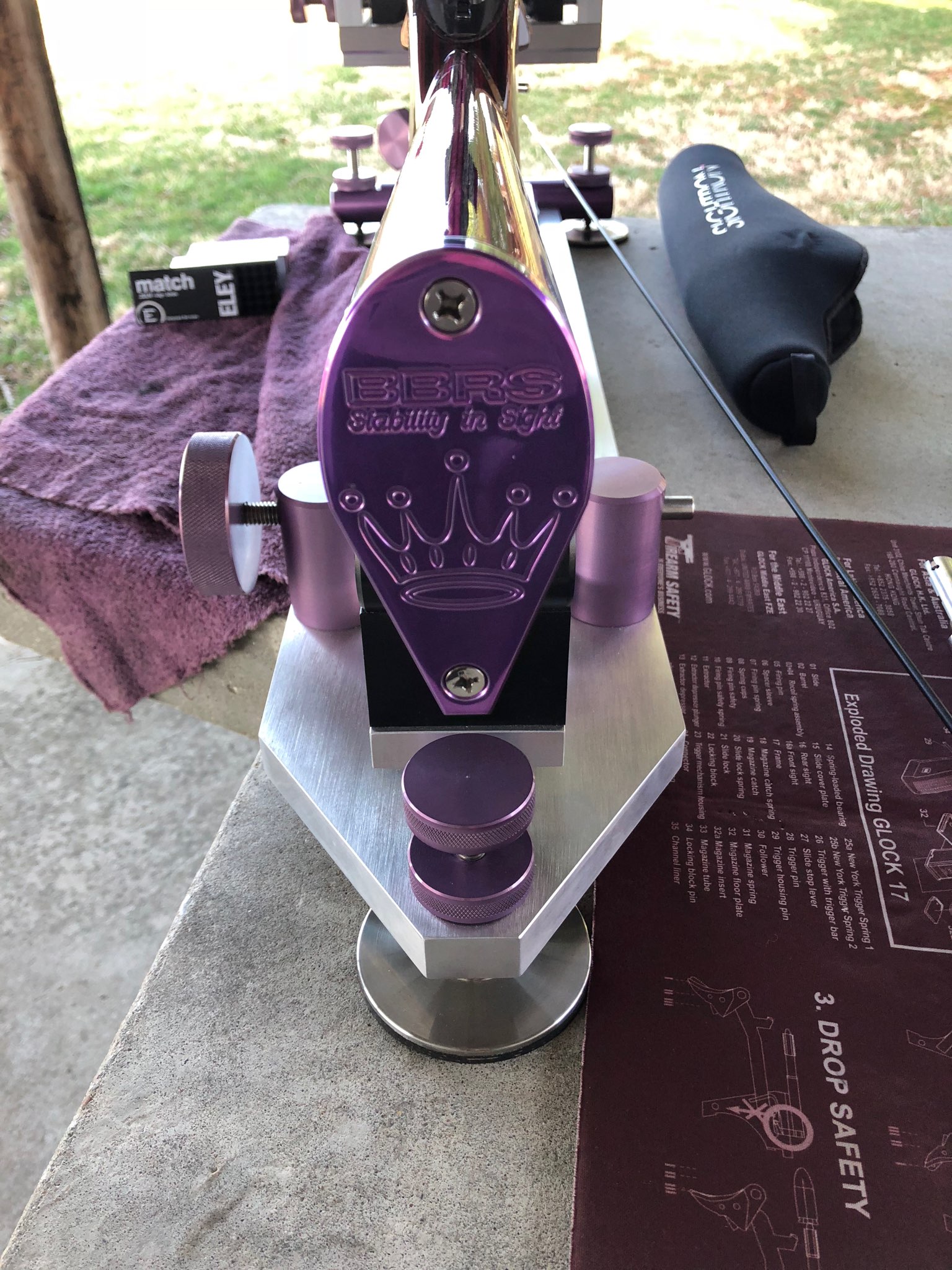

Just a little eye candy taken from a friends new build.
It sure looks like a Harrell's Precision Rimfire Tuner ... http://harrellsprec.com/index.php/products/harrell-rimfire-tuners-403

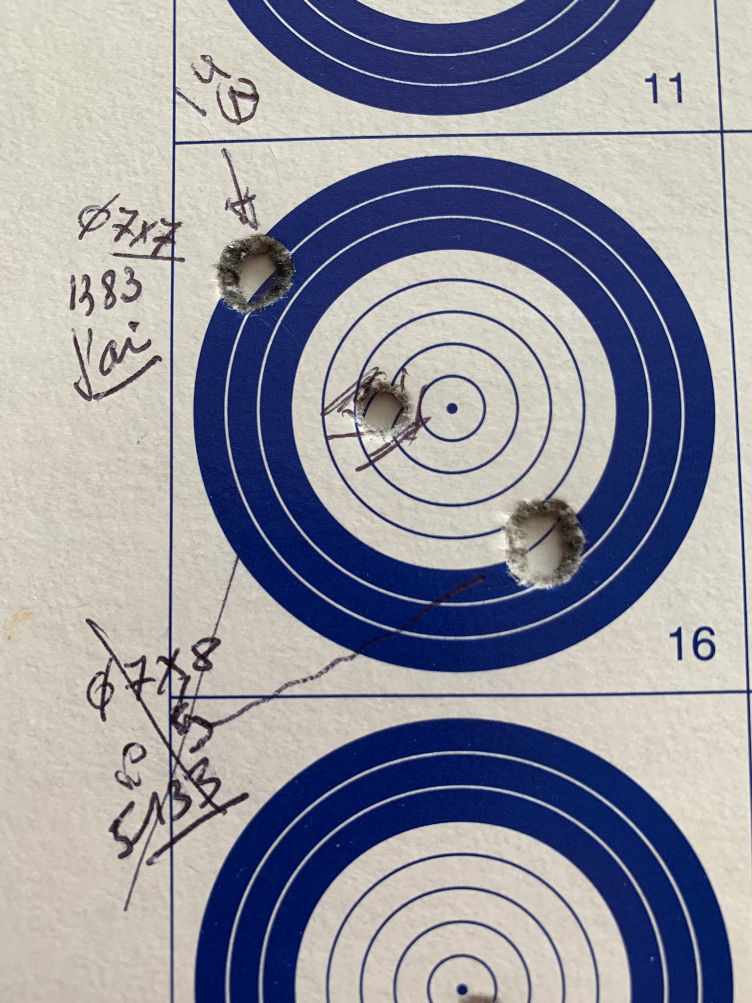

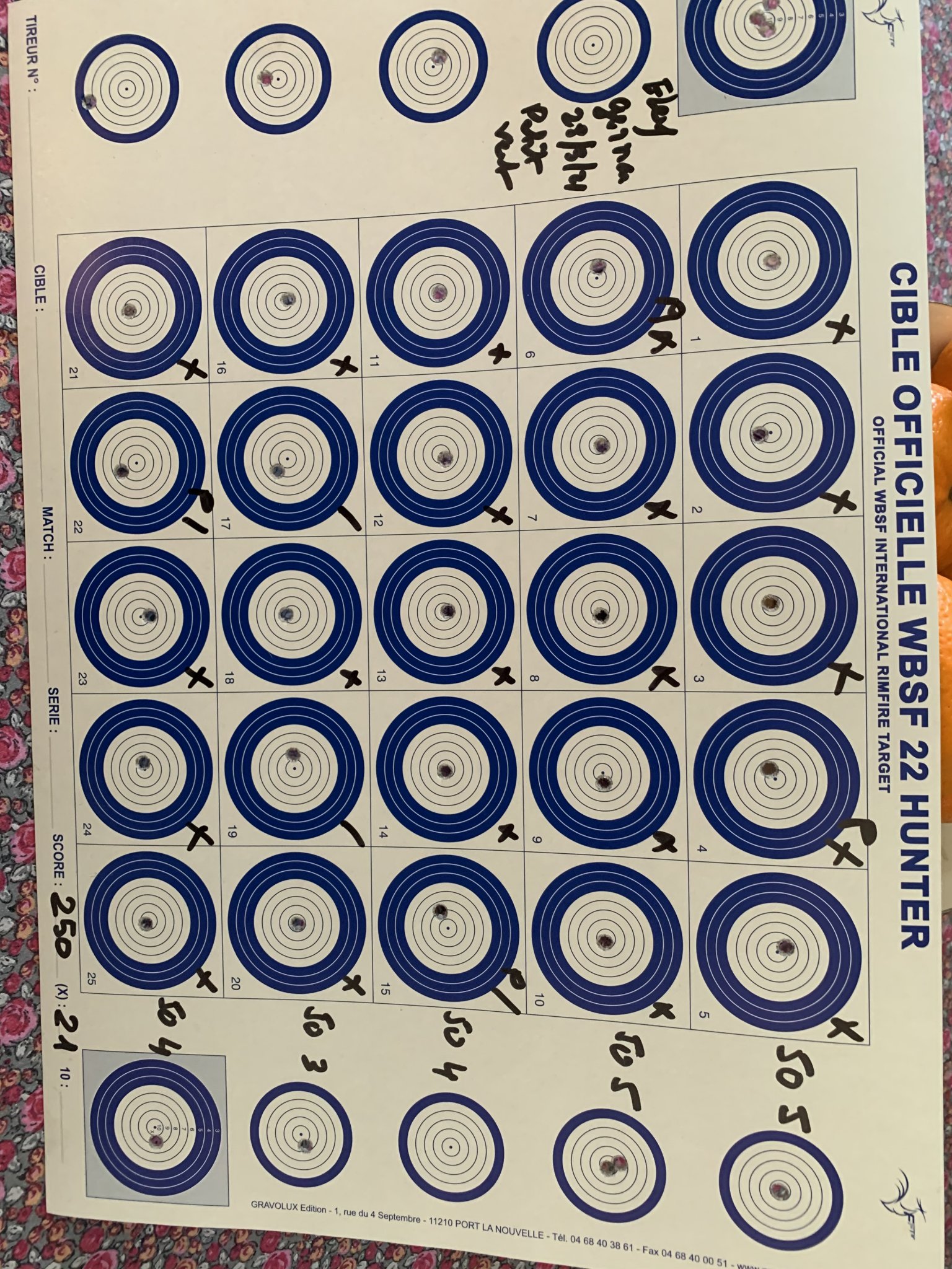

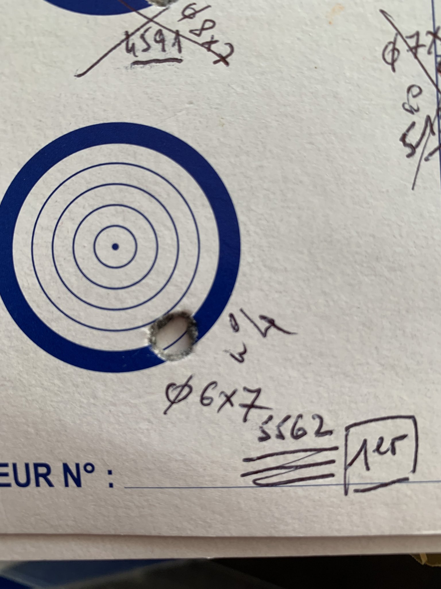

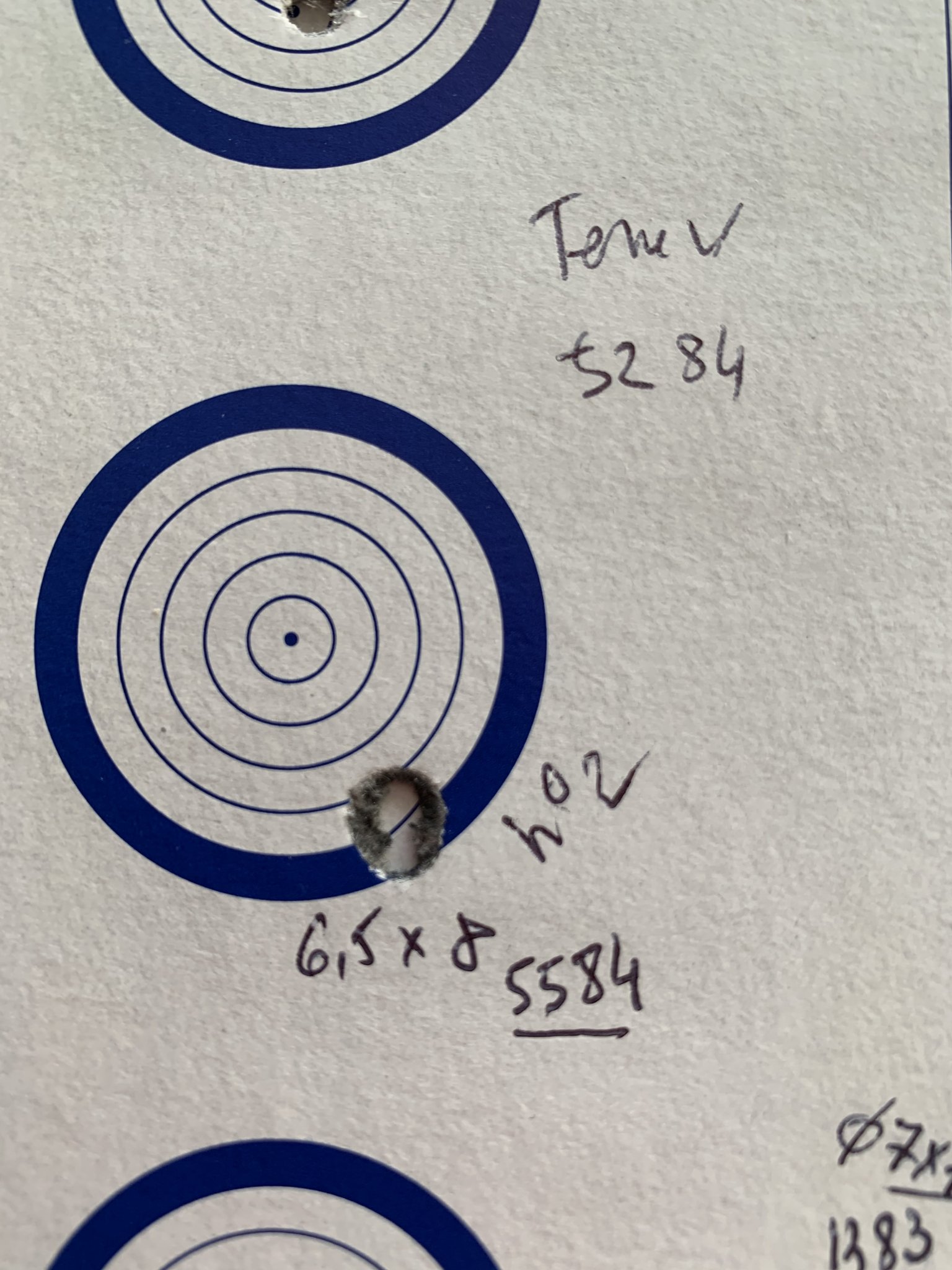

Following what is written by Norm I would like to give a logic that I use with a new rifle, this is a protocol set up by a former rifleman.
Shoot in sequences of 5, 10 15 20 clean up between each group shot and then space out this clean up as you increase the number of rounds fired.
We shoot without tuner and we see little by little the grouping evolve then will be the adjustment of the de-escalator and tuner with "good ammunition" it is necessary to shoot at least 1000 rounds to begin to have results in target.
Then it is necessary to shoot at least 2000 rounds before considering testing one or more batches of ammunition and it should not be forgotten that we must know how the gun reacts to fouling and its periodicity of cleaning.
To test ammunition batches at the shooting tunnel is a good sorting but it is still better to test outside to see the behavior in the wind.
In France we have the importer of Lapua, RWS, Eley, I ask him for 2 boxes of 50 per batch that he has in stock and I test indoors at home to make my choice, I shoot 30 rounds per grouping.
I look at the shape of the grouping and its diameter and I choose the most circular with the tightest dimensions and I always have good results on target.

10 rounds each type except for Center-X which was a 20 round group. Didn't get to measure them up yet but it seems like the Ctr-X and SK Std + are pretty close. Ctr-X groups a little tighter. Had one flyer out of the SK. My rifle has a 22" ACE barrel. Without measuring I would estimate the groupings for the Std + and Ctr-X to be around low to mid 2's. The others a bit larger. The most flyers appeared from the Wolf. I was quite pleased with the way things turned out. Now all I need is AMMO!
Good morning to all,
To pick up on your test I'm still surprised to read that you use the Center X a lot,
With the barrel Shilen ratchet I can't find a lot of center x that is in the 1/2" grouping. The same remark with Tenex the only one that surprised me is the Eley Match German (I have a supplier that recovers leftover batches that were qualified for the German bench team, the card that is pictured was made with it).
I'm in a team that even uses R50, Midas+, x act for serious match, by ordering in large quantities we manage to buy the M+ at 11$ the box of 50
Reactions: GTI
$11/BOX for Ctr-X!
Holey Moley!
Everyone in my neck of the woods raves about Ctr-X. Ctr-X this and Ctr-X that........ It seems my rifle isn't that impressed with it. Std + seems to run better than Ctr-X. I haven't measured the groupings yet but the Std + seems to be consistently smaller. I shot a 2450-14X with WOLF and no tuner just messin' around. Obviously more testing is needed. I'll give the Ctr-X more time. It does, after all, produce less flyers than the others and that can make quite a difference in a match. We also shoot a lot of IR-5050. A flyer can be devastating in THAT match. I'd hate to get beat by a guy shooting a 250-4X and me shooting a 249-17X on account of a flyer......It happens.
