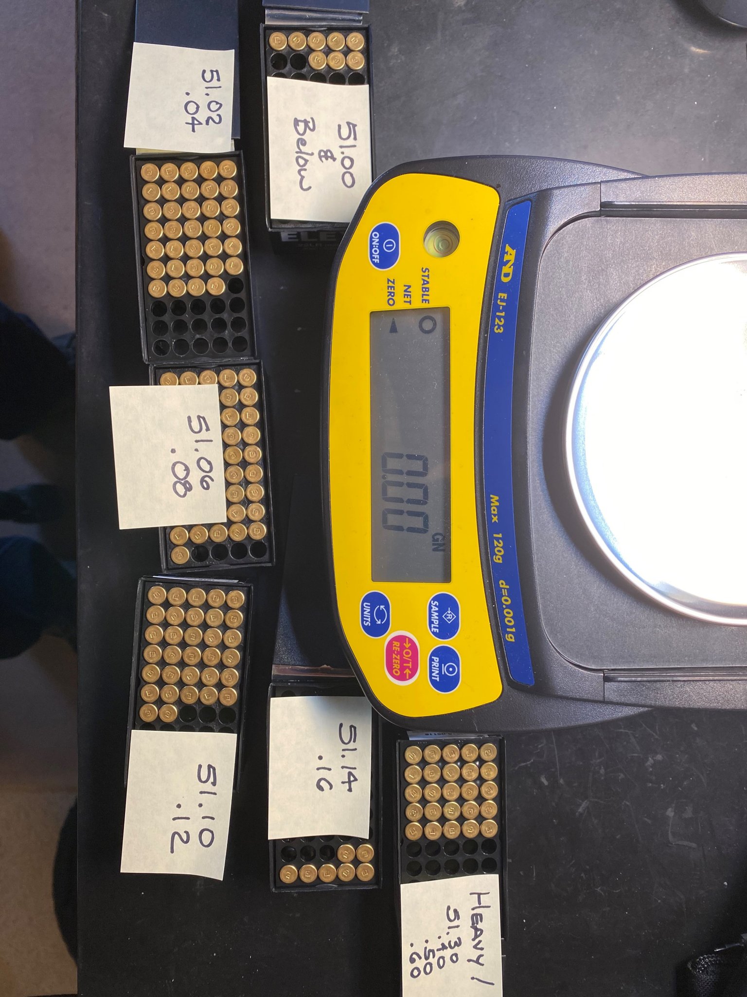

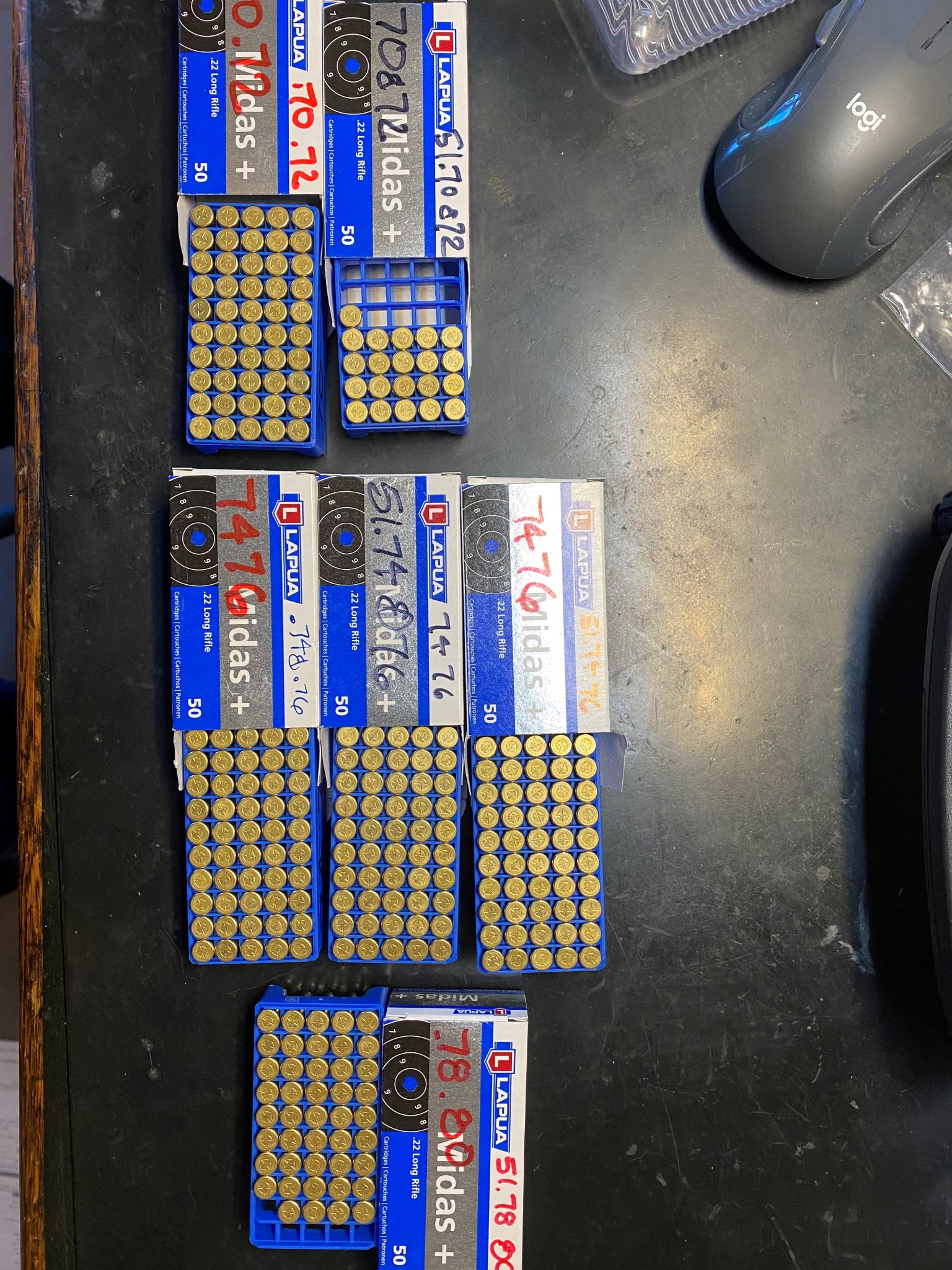

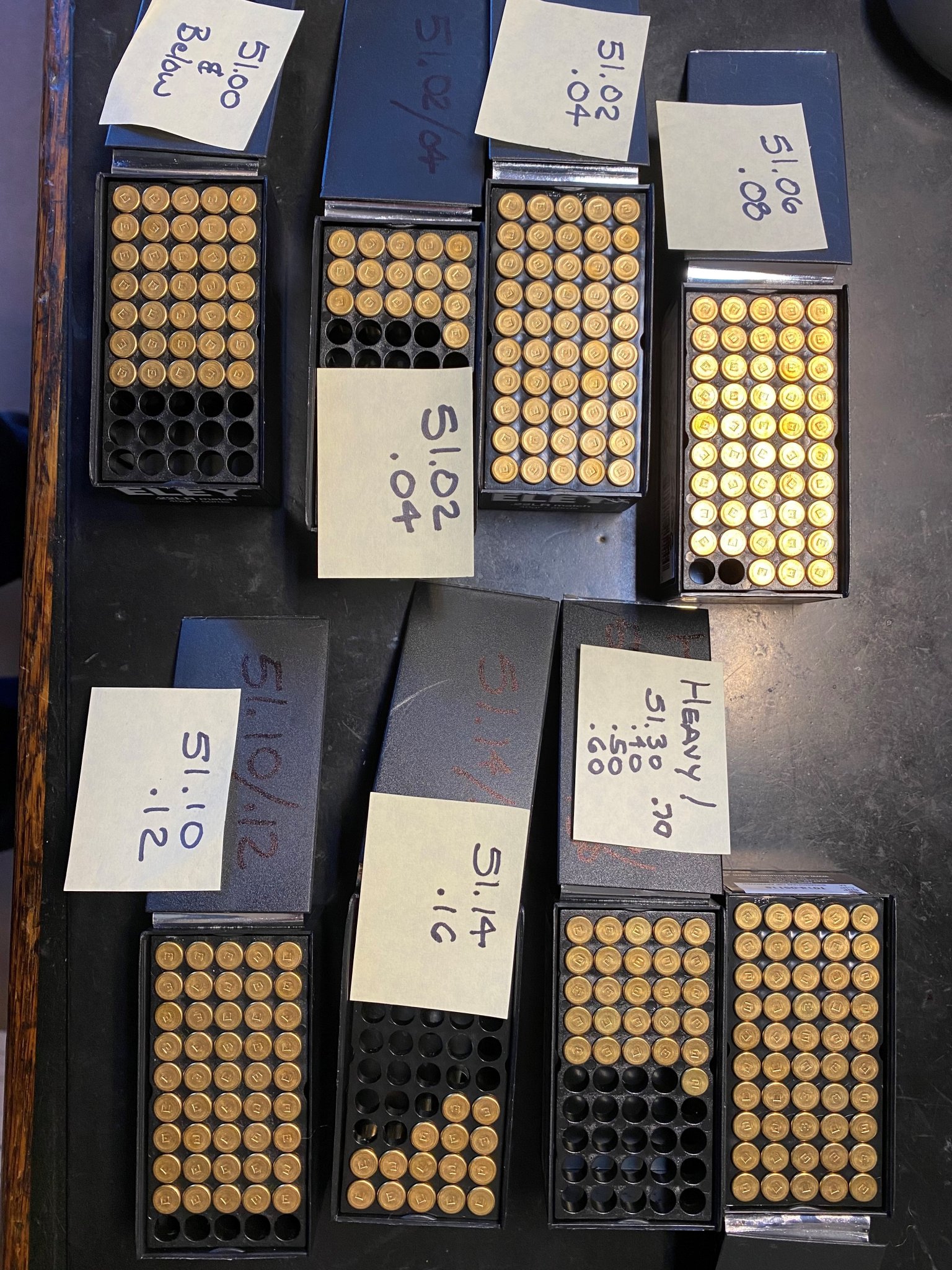

Hi 4certain, why do you weight sort the ammos ? what kind of difference did you found on light ammos and heavy one? 22" is short for a barrel ? i ordered 62cms from Mike (like 25" i think)
Good afternoon Iceman.
A friend who has shot much - much more Benchrest than I strongly suggested I give it a go. I purchased an A&D EJ-123 Scale (more than I wanted to spend) but it was the only one I found that would weigh to the 0.02 of a Grain. So far I have sorted both Eley Black Box and Lapua Midas+. The weight of the Midas+ is much MUCH more consistent than the Eley. But the sorted Eley shoots better in my gun. It seems that shooting "Like Weighted" ammo helps get rid of the Ammo Caused Fliers. I can still get Wind Fliers or Fliers due to not setting the rests correctly, or from poor rifle/trigger management. But at least it seems to slow down the Ammo fliers. I credit my last two scores to that 250-21x and 250-20x. See attached pics for my weighing results. The older pic shows the scale with some Eley boxes...
Enjoy the process.
4Certain

Don't fool yourself into thinking you can eliminate fliers by simply weighing remfire ammo! Did you check each round for consistent rem thickness. How about consistent crimps. Did you mic. bullet diameters and overall length of each round? And don't forget about lube, is the same amount on each round? No way possible to check primer compound. All these things contribute to fliers or the inconsistent accuracy found in remfire ammo. Which are you eliminating by weighing? Think about it!
Reactions: GTI
To your point littlestar, isn't that part of the fun/challenge/frustration of rimfire? I would think that if one wanted to do one-holes at 200 yds get a railgun and load your own. What's the fun in that?
(My opinion of course)
I agree 100%. You can pay $200 a brick for ammo. Lot test. Weigh ,measure,, chronograph and computer analyze groups and still pull the trigger and say." Where the heck" did that shot come from! Thats the nature of remfire.
Reactions: JimTN and GTI
Ha! Indeed! Quite So....
I figure all I can do is control what I can.
The rest is like going down Suicide Hill in a Grocery Cart.
A Grocery Cart with Mega Front Wheel Wobble, Wobble, Wobble......
Lots of Excitement....
Not much Control...
4Certain
LS, when my good shooting friend (who has been shooting Benchrest a Long Time,) suggested consider weight sorting ammo, I asked the questions you did above. I did it in a different way. But I asked none the less. I had already measured rim thicknesses and decided that made no sense to me. And measured other things. I am only 5 months into Benchrest. But I am a long time shooter.
My friend told me of some measuring he had done. He disassembled quite a few good Eley bullets. He weighed the projectiles. Wiped off wax and weighed again. Weighed the powder. Weighed the Brass + Primer. Shot the primers then cleaned and weighed the brass. His conclusion what most of the weight differences was in the primer.
My guess is you do not know this gentleman. I am fortunate to. You may not trust his story. I do. Is the weighing 'perfect'? Well, of course not. Are there variances? More than I can count. But one thing I have seen. Weighed as George encouraged me to, has made a difference. All fliers gone? I wish. But so far, they are less and not as radical. It made enough difference that I will continue to measure and test.
Is rimfire ammo by nature full of variances? So it would seem. Does the more expensive ammo have fewer variances? It would seem so, but I have seen some variances in good ammo that were shocking to me. But those differences weight sorted out, seemed to yield some pretty good groups.
I figure I will continue to learn to sort and handle ammo properly. Learn to align my rests properly. Confirm rifle tracking for each shot. Learn to read the wind better. Continue to work on my technique. Listen to those who share info without contempt and ire. And hopefully have fun and enjoy the convoluted, winding inexact process.
Wishing you all the best.
4Certain
4Certain

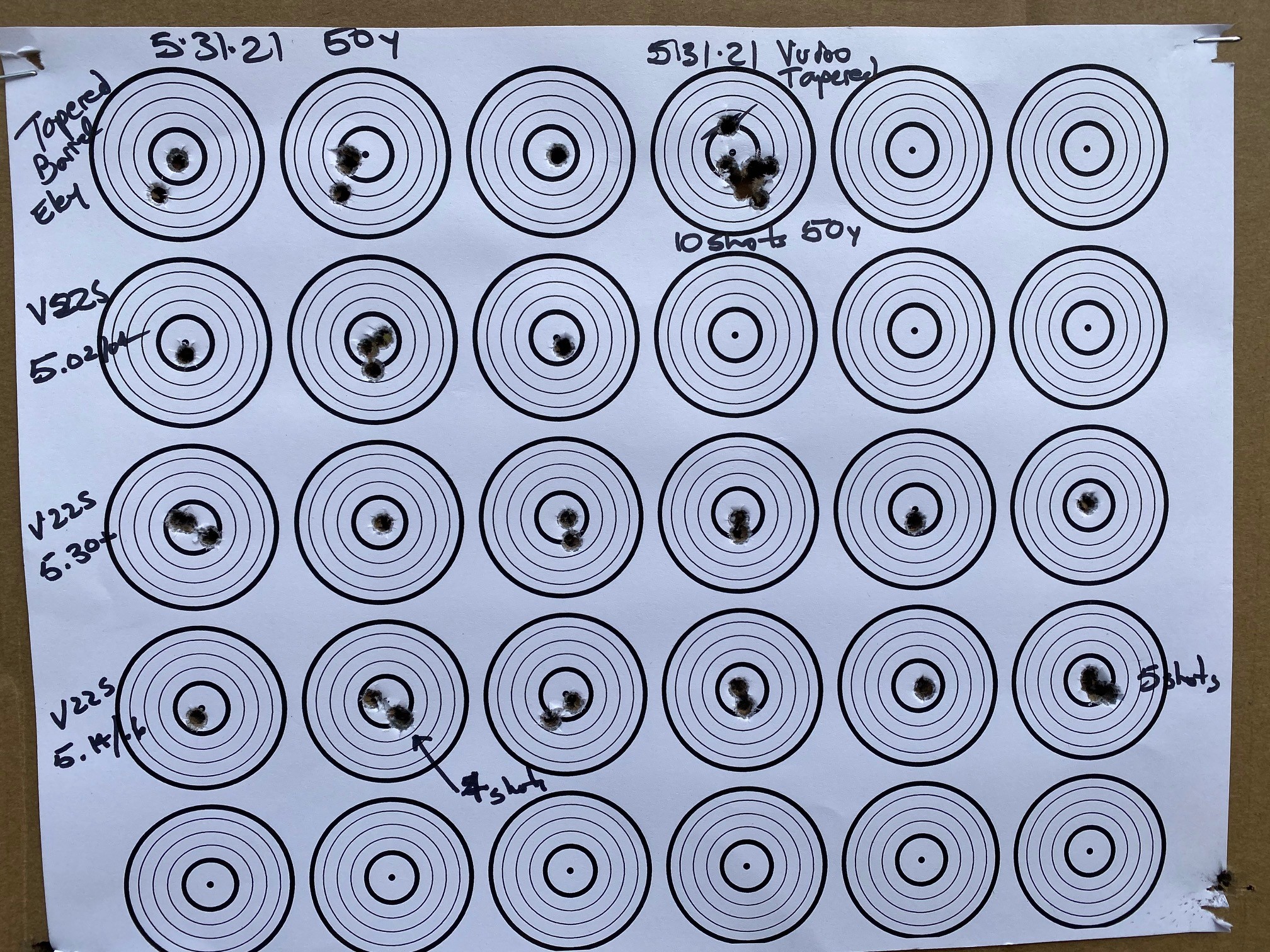

Some Practice Groups from my Single Shot Vudoo this morning. 50 yards. Target like a Benchrest target.
The top row is from my Vudoo Tapered Barrel Repeater. Rows 2 and below are Single Shot.
4Certain
Eley Black Box. Tried several weight groups. 51.02/04. 51.30 up to 51.70. 51.14/.16.
A couple of nice tight groups on the 51.14/.16.
