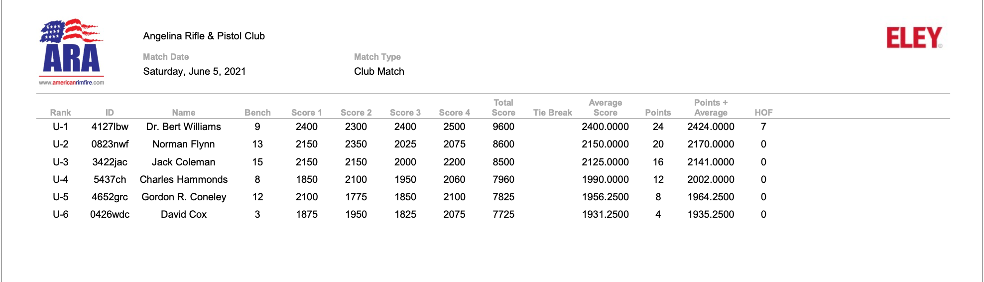

I shot my V-22S in our local ARA match on Saturday. We had a small turnout of six unlimited and three factory shooters.
I placed second with a four card aggregate score of 2150. The match winner was on fire with a 2500 card and an aggregate of 2400.

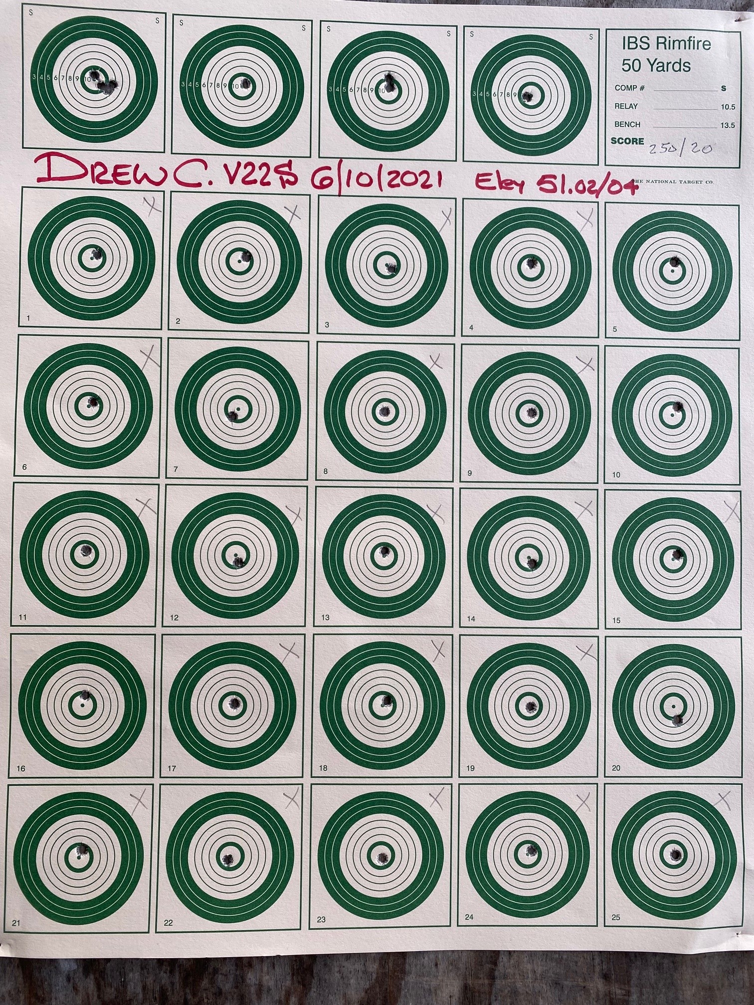

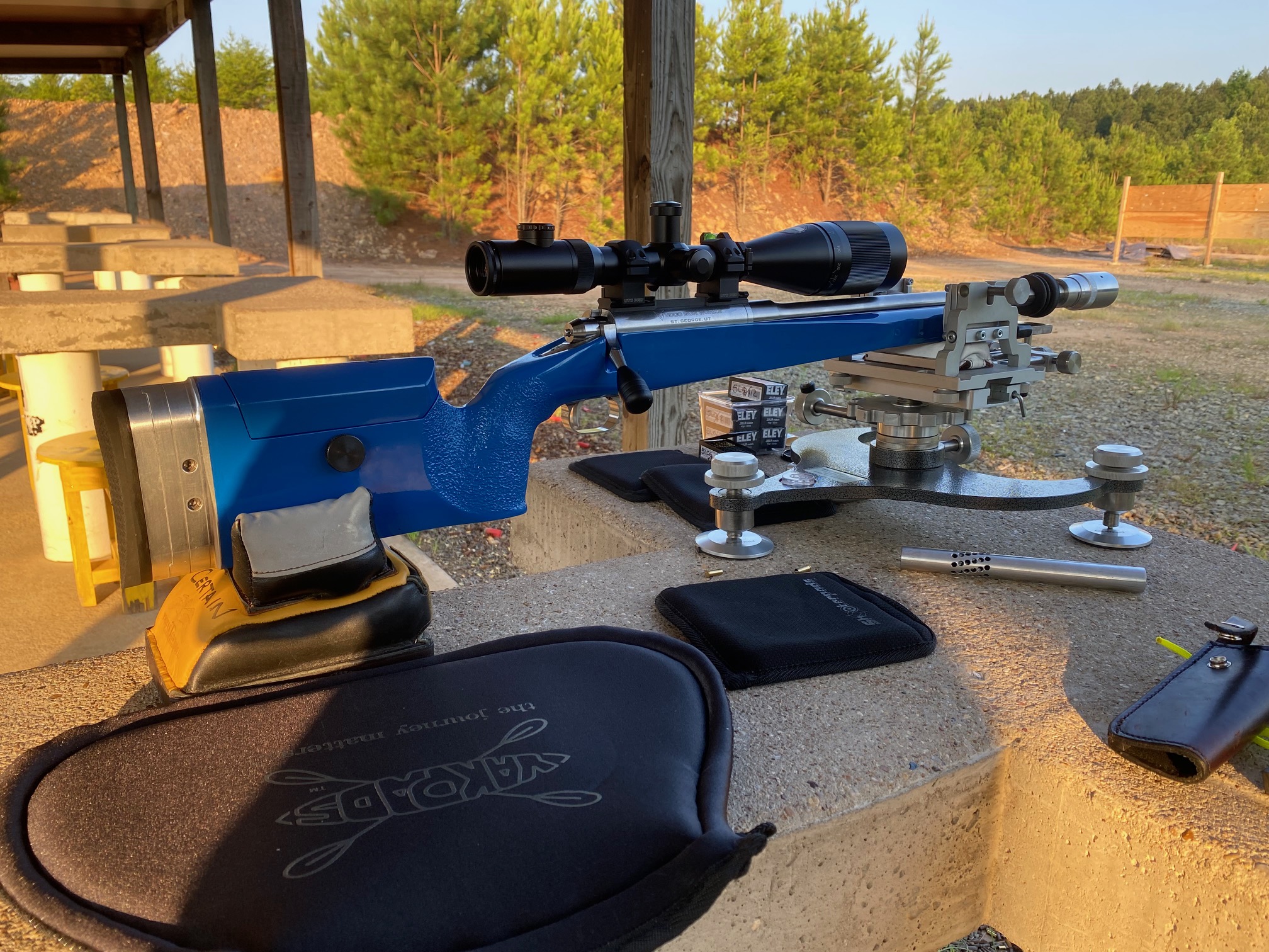

Target from yesterday's Match, 6-10-2021. 250-20x. Vudoo Single Shot. Eley Black Box. Weight Sorted to 51.02 & 51.04 grain.
Last Three Targets have been 250-21x, 250-20x, 250-19x;
Our gentleman who scores the target uses a test pin to check outer edge of bullet.
Great fun shooting with the guys.

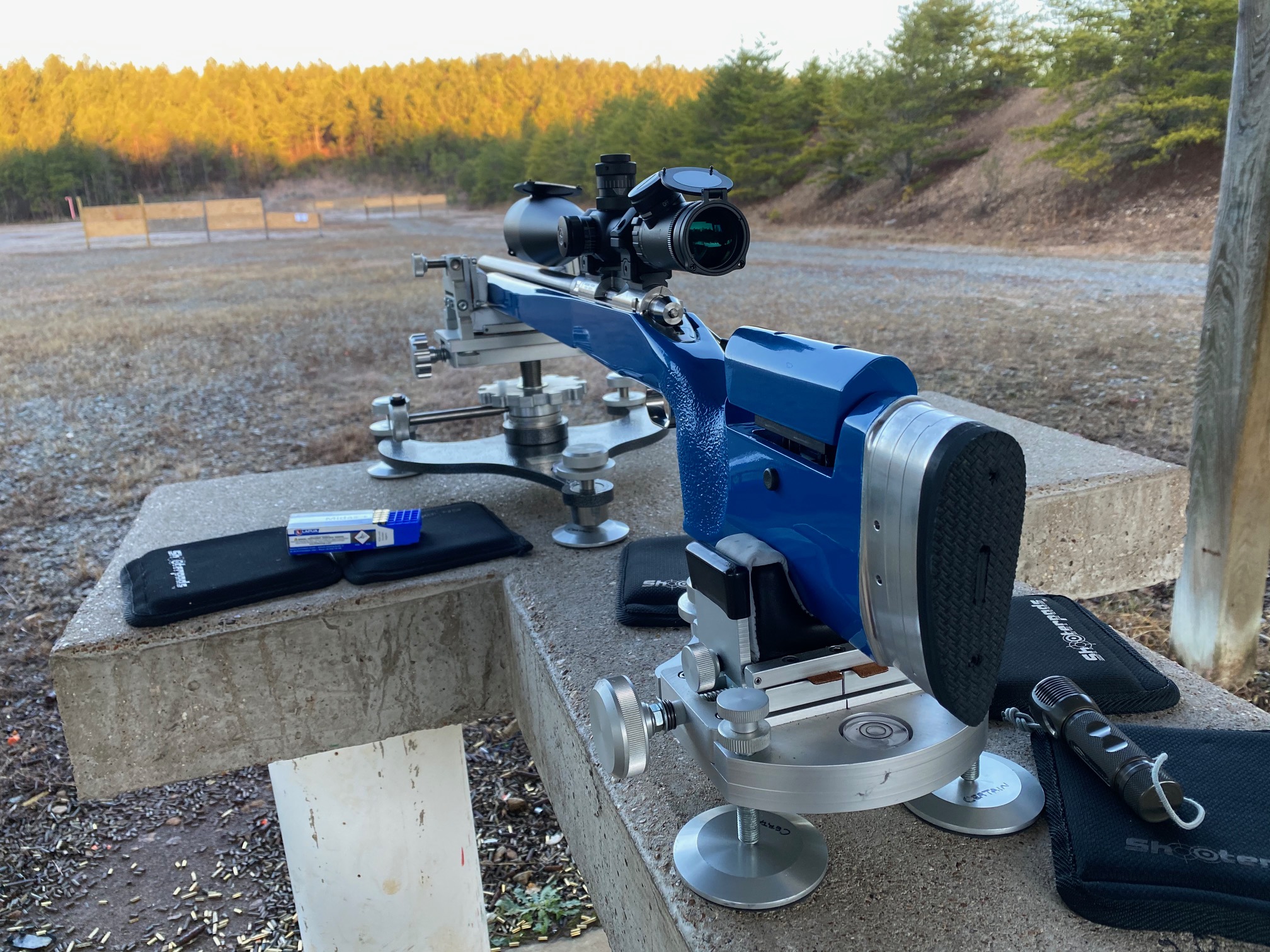

4Certain
Nice shooting!

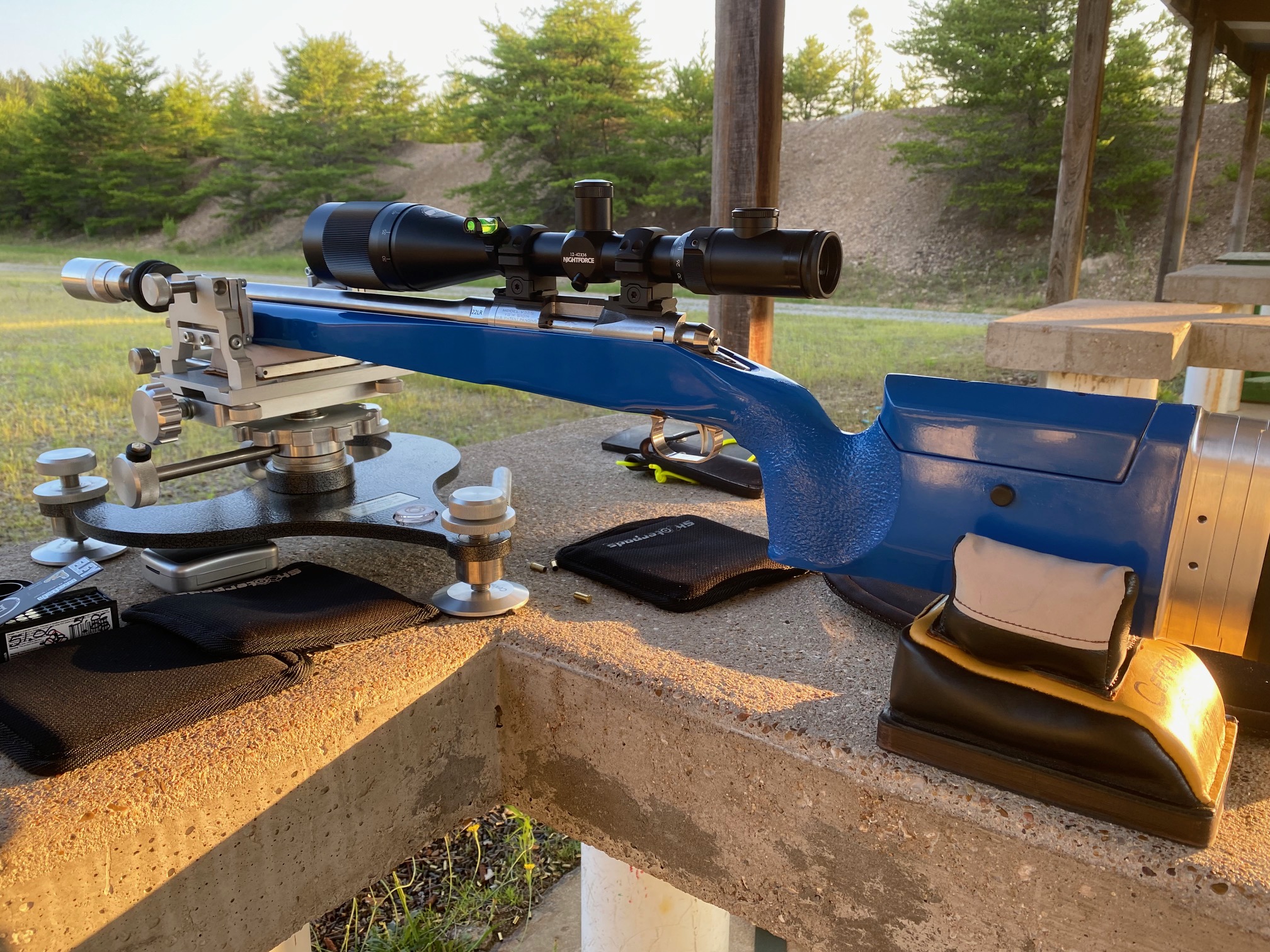

@4Certain Very nice. What rest are you using?

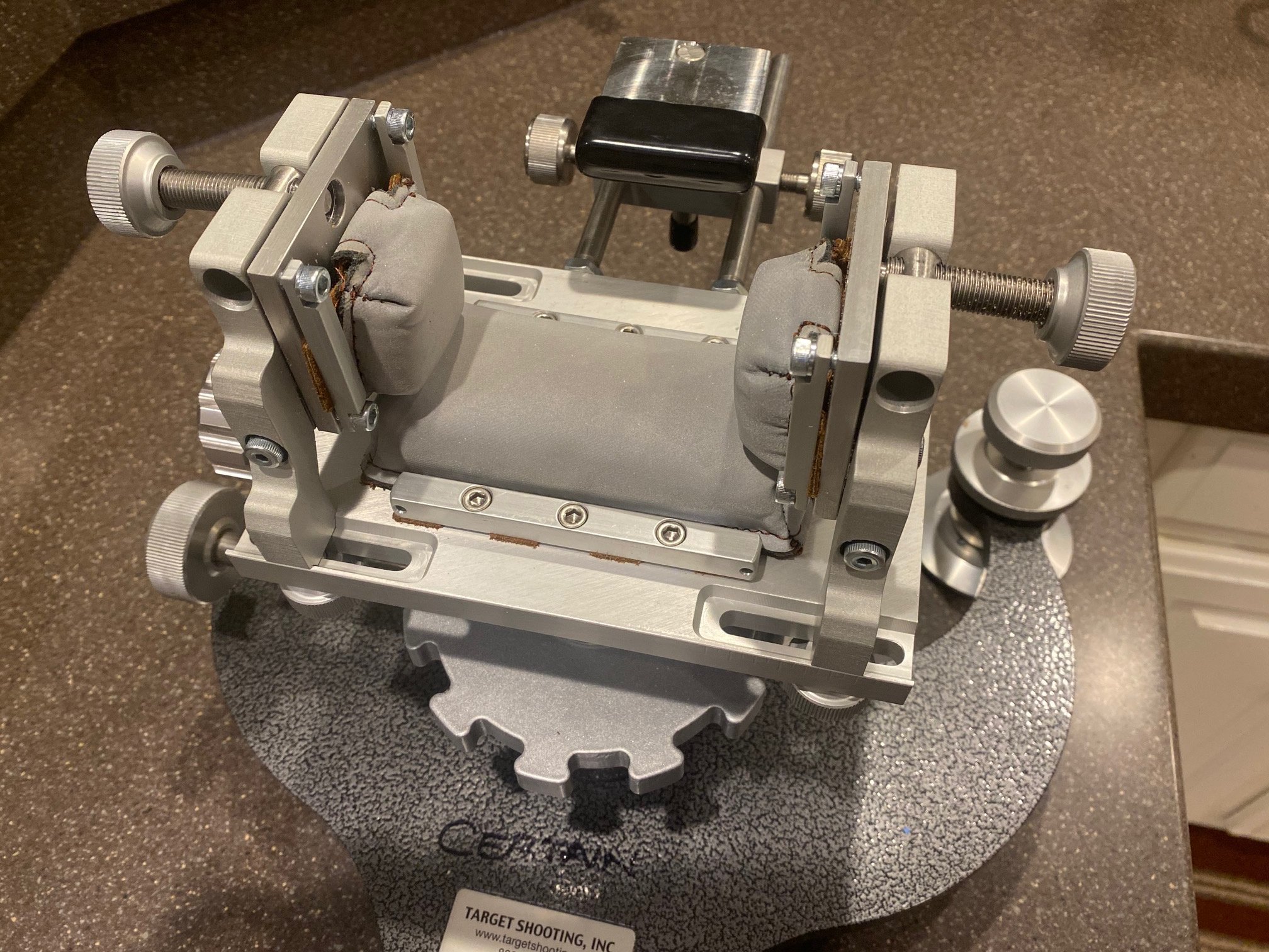

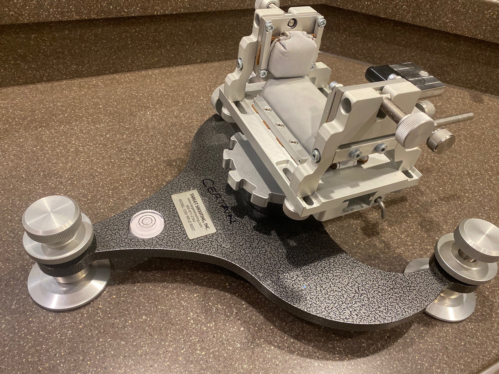

Thanks QH.

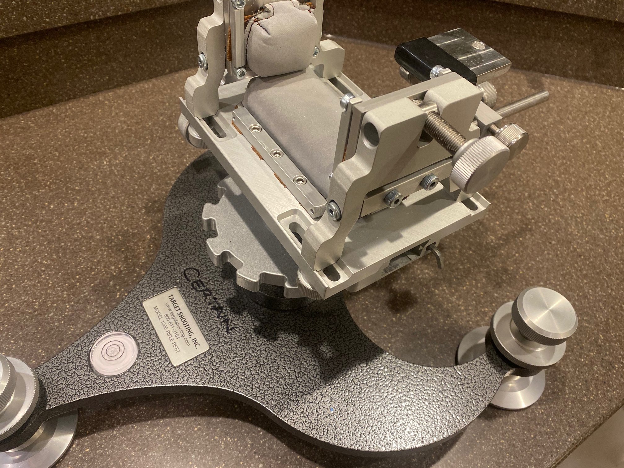

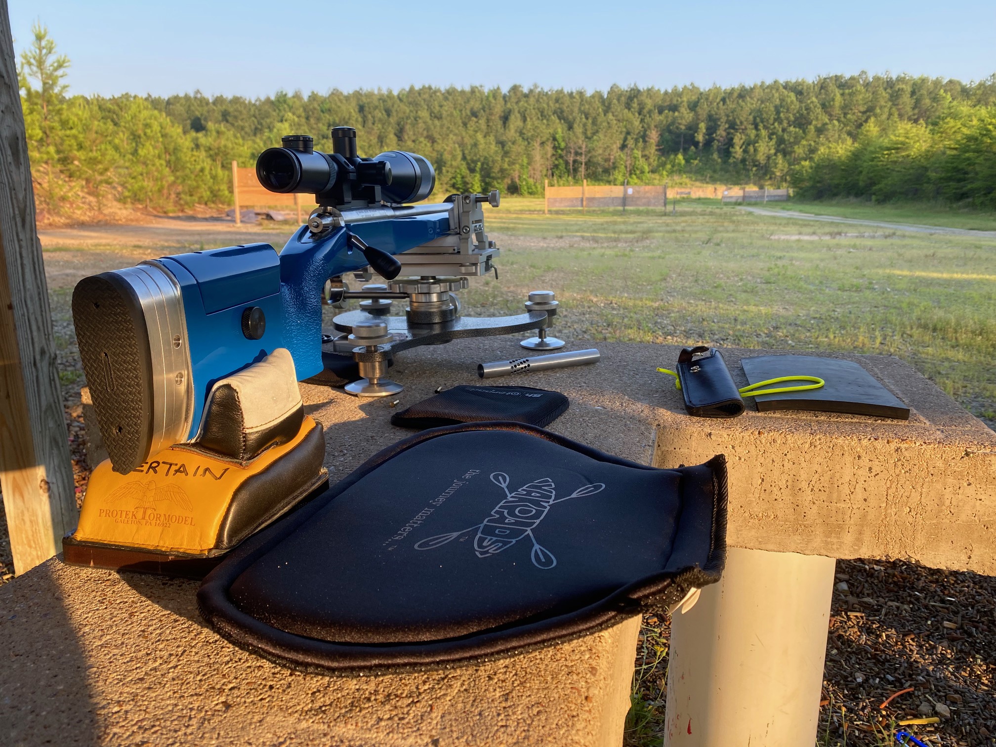

I am using Wally Brownlee's Target Shooting Rest Model 2400. www.targetshooting.com;
I use a Protektor Rabbit Ear bag in the rear.
But I do like Wally's Small Mini Rear Rest shown under the Vudoo Single Shot in the Pic.

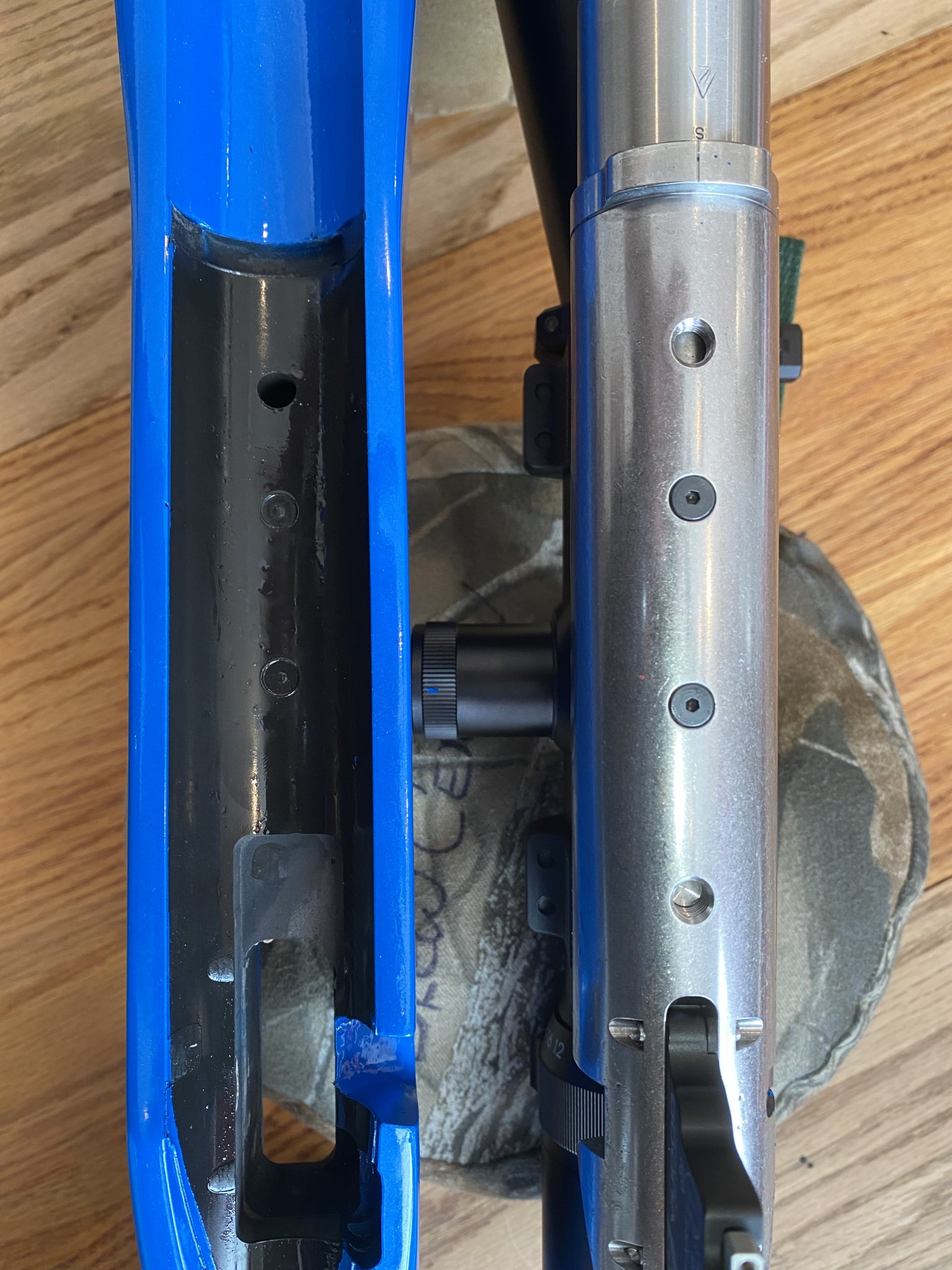

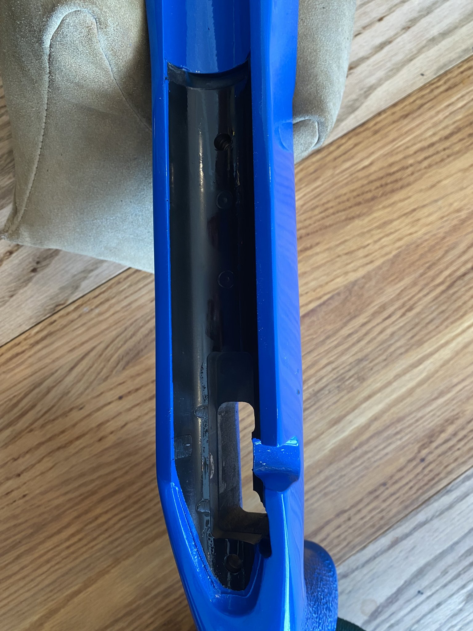

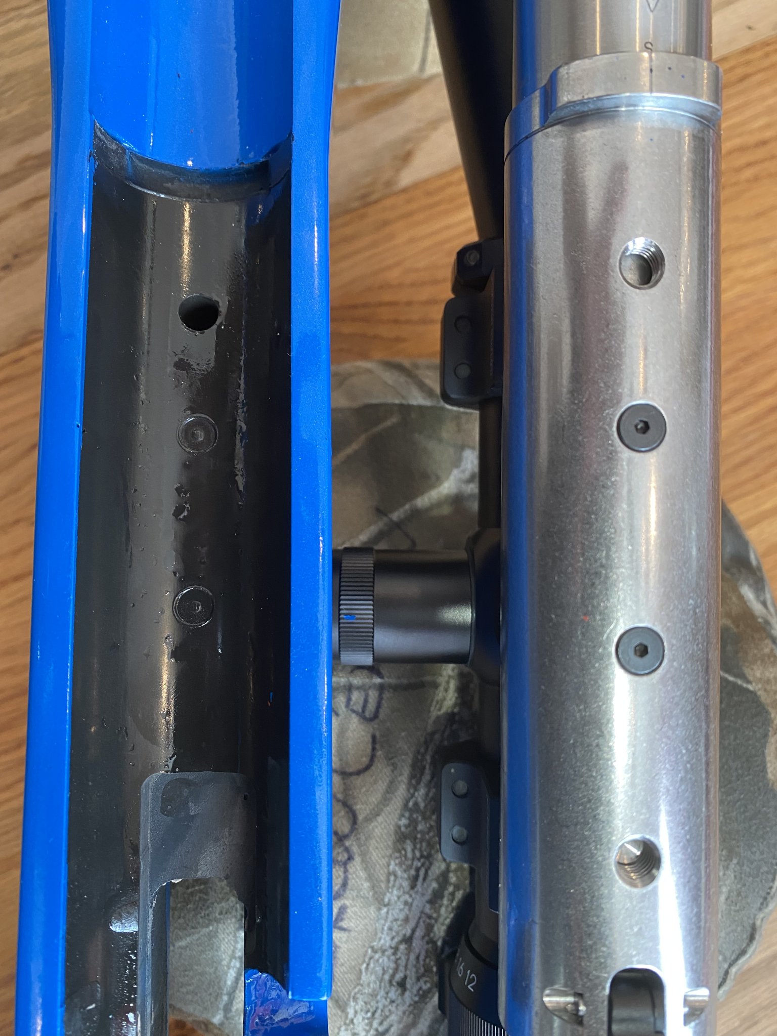

It was my understanding that all V22s"s were bedded if sent ordered with a stock from the factory. Yes or not?
Yes they are bedded. Paul Parrott reports they are bedded with Marine-Tex Epoxy colored with black dye. Marine-Tex is normally white.
It is very snug and secure.
4Certain

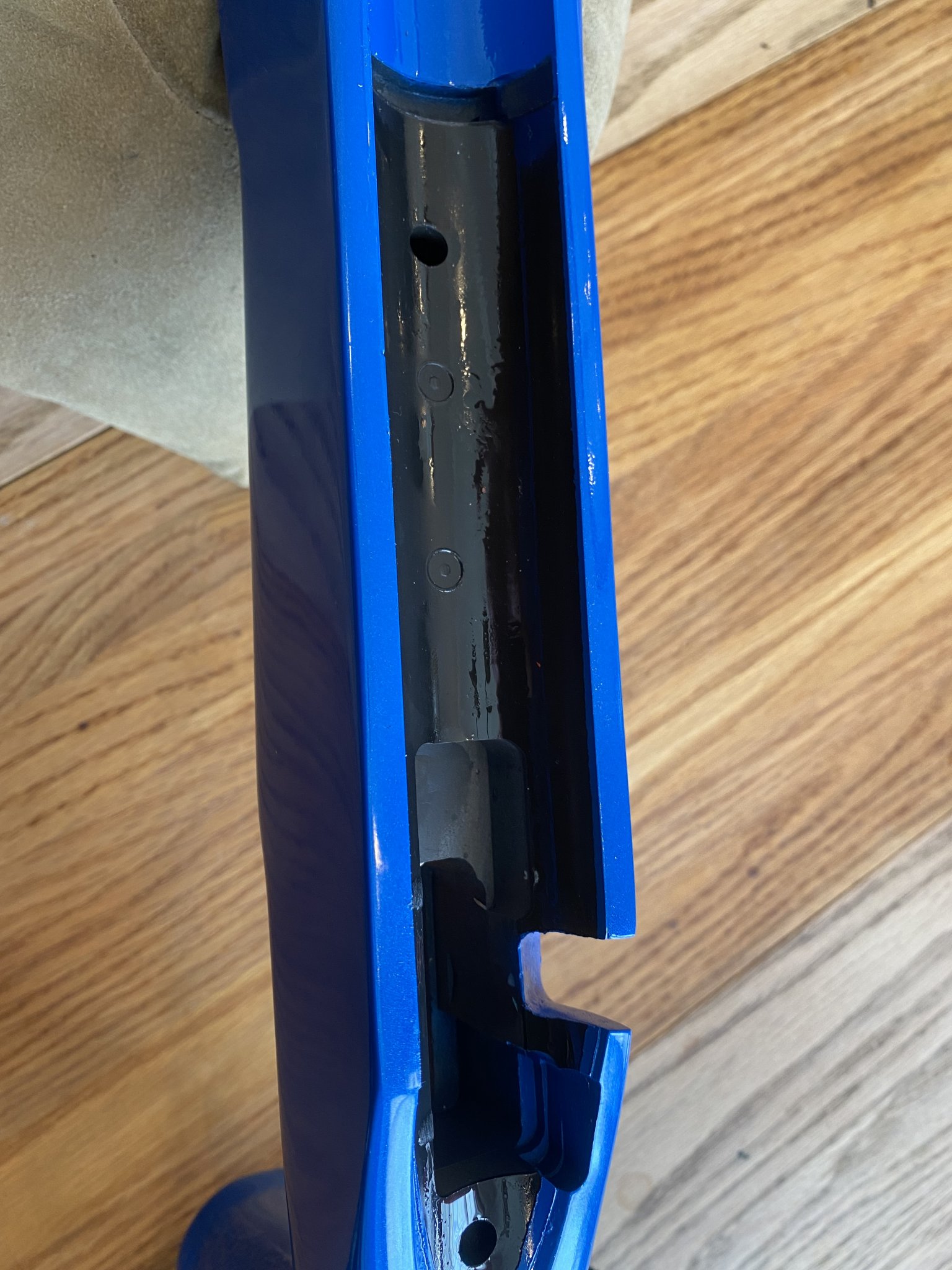

Reactions: 10ring1
In these pictures does the bedding have oil or something on it?
Is VGW using the White Marine Tex as opposed to the Grey?
Yes, my bedding had oil on it. Was it from Vudoo? or from me? I do not know. But it was fine.
After doing some additional machinists checks and measurements this morning, the Vudoo bedding is excellent. and well aligned.
Color is as per statement above.
"Paul Parrott reports they are bedded with Marine-Tex Epoxy colored with black dye. Marine-Tex is normally white."
4Certain
Marine Tex is available in both white & dark gray. They make it in white because it was originally sold as a repair for fiberglass boat hulls - hence the name "MarineTex". There have been periodic shortages of the gray product over the past several years - most notably after problems with Devcon Steel Bed's hardener going bad shortly after the container was opened, which increased the demand for MarineTex greatly. I used to use both MarineTex & Devcon, but after having an issue with the hardener in several 1lb kits of Devcon dry out and go bad, I had to stop buying the stuff.
BTW, whether that's oil or bore solvent in the photos that 4Certain posted, it should be wiped dry - though MarineTex is resistant to many oils & solvents, some products will soften the cured epoxy. At any rate, it serves no purpose to expose any of the epoxies used for rifle bedding to excess amounts of any oil or solvent.
