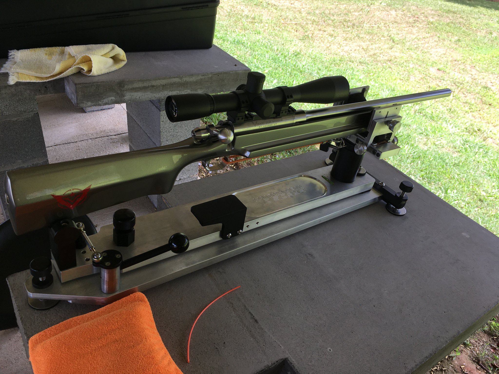

My V22-S seems to like Eley Match fairly well, the fly splatter shot made with NO tuner on the rifle. The ABRA (red) target was shot with Eley Match with the tuner installed a couple days later.
Jim,
My humble opinion:
on the 3 blazons the grouping is different and scattered, the best would be the 2, I think there is a big job of tuning the tuner because these groupings made with the tuner for me I will not accept them and the Eley Match lot is maybe not terrible...
What I do to try a lot of ammo I draw a vertical and horizontal line on 5 blazons, then I set the reticle of the scope on the fly and I shoot once on the blazon, I change blazon I shoot and so on 5 blazons.
Thus I can observe the position of each impact in relation to the traced cross the reading is clear and is not polluted by several shots fired at the same place. Of course the rifle will be put back in battery before a new shot, it also allows to make measurements of distance or position. Then I shoot 5 shots in the same grouping on another blazon, the cross drawn allows me to place the reticle of the scope and thus be sure to shoot each shot at the same place and see the grouping if it has horns or a good roundness.
the wind conditions were identical?
on the other hand the fly at 100m terrible, I'm kidding.
Sorry but what do you mean by "blazon", possibly the target or bulls eye??? I appreciate your analysis of my groups, the lines drawn on the target could help and I will try this in the future. The purpose of my post was to show that a Vudoo V22-s can/does shoot Eley ammo with good results (depending on your standards). If you are under the impression I've had this rifle long enough to do all the "tuning" needed to make it competitive, sorry but no. I picked the rifle up from the FFL on 7/5/21, and did not install the tuner until 7/16/21. So far I'm tickled that the gun shoots this well with less than 500 rounds down the barrel with a mish mash of ammo.
The fly shot/splatter was shot at 50yds, no tuner, on the 2nd trip to the range. Yes I had wind flags.
The ABRA target I posted above is some of the very first shots fired with the tuner installed on the gun BEFORE any adjustment(s) to the tuner were made. I don't have any ammo dedicated for this gun, nor have I lot tested any ammo for this gun, this is just some Eley Match ammo that I was able to purchase earlier this year, and do not have a single brick of any one lot # of this ammo , just a mix of different lot #'s. I ordered 5 bricks, but every brick (10 boxes) was/is just shrink wrapped, and could have anywhere from 2-10 different lot #'s. Just odd ball scraps left over from 2017 and 2018 per the lot code info. Did I get "took" on my order, possibly, BUT having so many different lots gives me a better idea of whether Eley ammo can be considered a viable alternative during these days of quality ammo not being readily available. These "scraps" are shooting pretty good IMO.
I'm still testing which method/combination of recoil management works the most consistently for the gun & rest.
I'll shoot in the local matches with the ammo I have on hand, and enjoy the company of my friends/competitors.
Is the gun ready to win a match?? Only if I'm the only one at the match and the match director doesn't compete.

So far in the last 6 months I build 5 V22S and had FTF in the beginning, and did tried all the different springs, finally in the last 2 months we settle in the 16 lbs. spring, and with over 500 rounds in each one, so far no more FTF.
What I found out, is first you have to removed all the paint from the spring, it will flake off and creates a gunk between the spring and the firing pin bad enough to make it drag, and slow it enough to induce the FTF . Second the tolerance in the bolt assy. are so tight that it requires about 500 to 600 rounds for all the components to wear in and smooth themselves out.
So far all of the 5 rifles each have over 1,500 rounds fired, and no more FTF with either Lapua or Eley ammo. and all were chambered with a reamer set up for Lapua ammo.
Several matches have been fired with this rifles some ARA and some ABRA and doing pretty damm good. I won one ABRA 4 card match with a 196 198 198 198, another customer shot a two day ARA match and came in on 2nd. place againts 22 shooters.
The V22S has great potentials but it does takes over 1,000 rounds to get everything smooth out, and my two cents, stick with the 16 lbs. spring.
