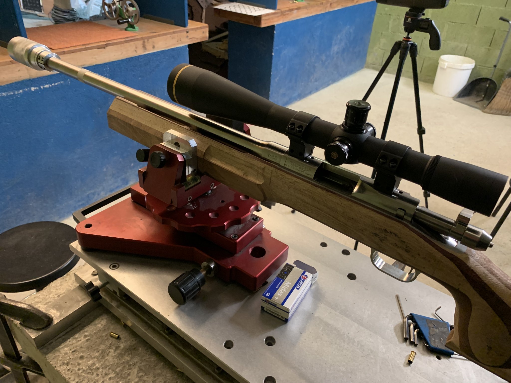

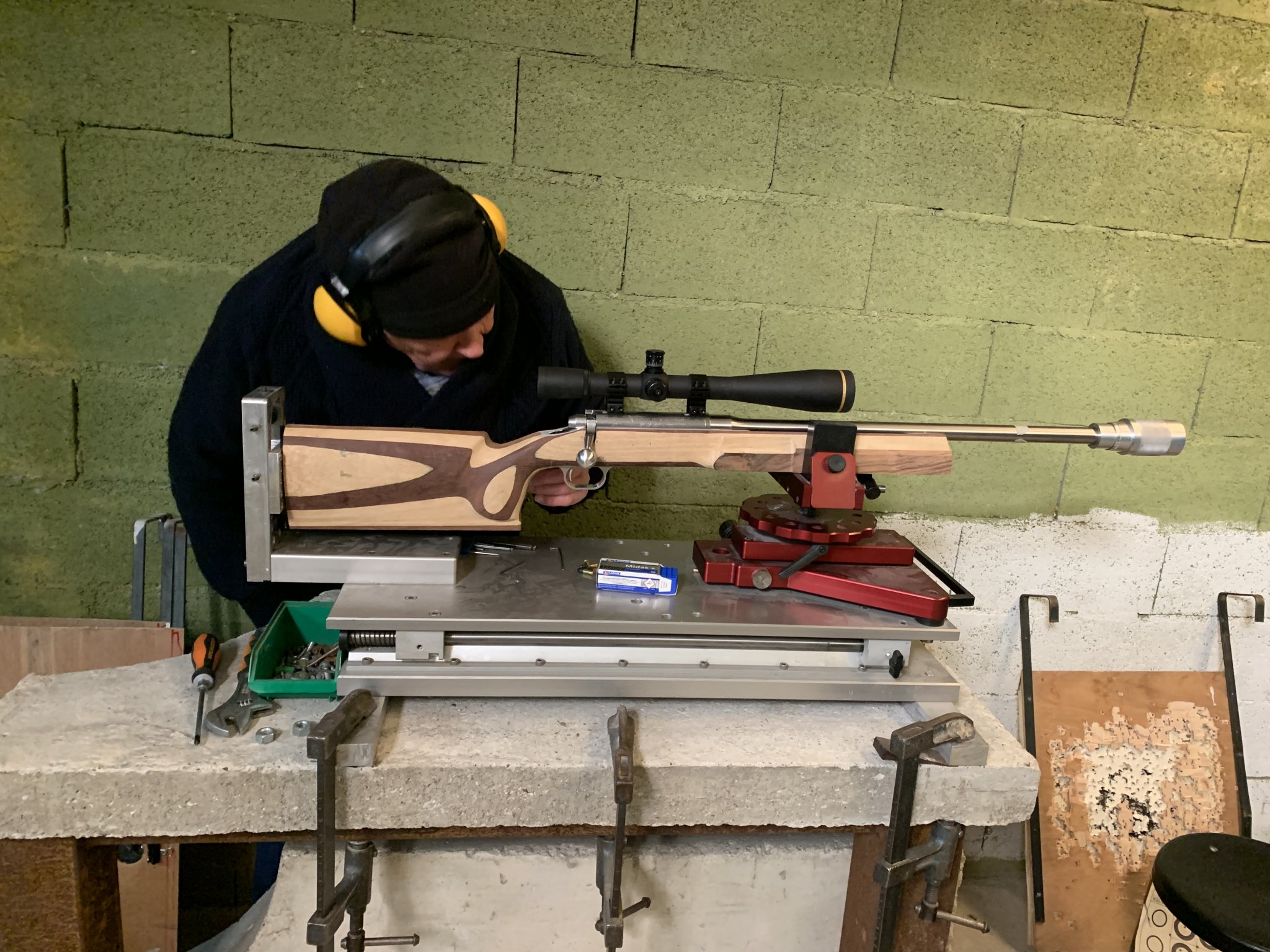

I could not put a comment on these 2 photos
here is the 087 mounted on the stock unprepared externally, the beeding and tightening are done the photo shows a tuner but in reality this barrel does not need it.
we tested it on a shooting table and the result is very favorable with Midas + but one batch in particular because I tested another (reputedly very good on another shilen) the result was less good, same observation with Tenex
What to say, a defect of percussion, it did not eject the not percussed cartridge, the ejection is soft.
But it was only a test for the barrel this shooting session
.image of the shot without tuner
