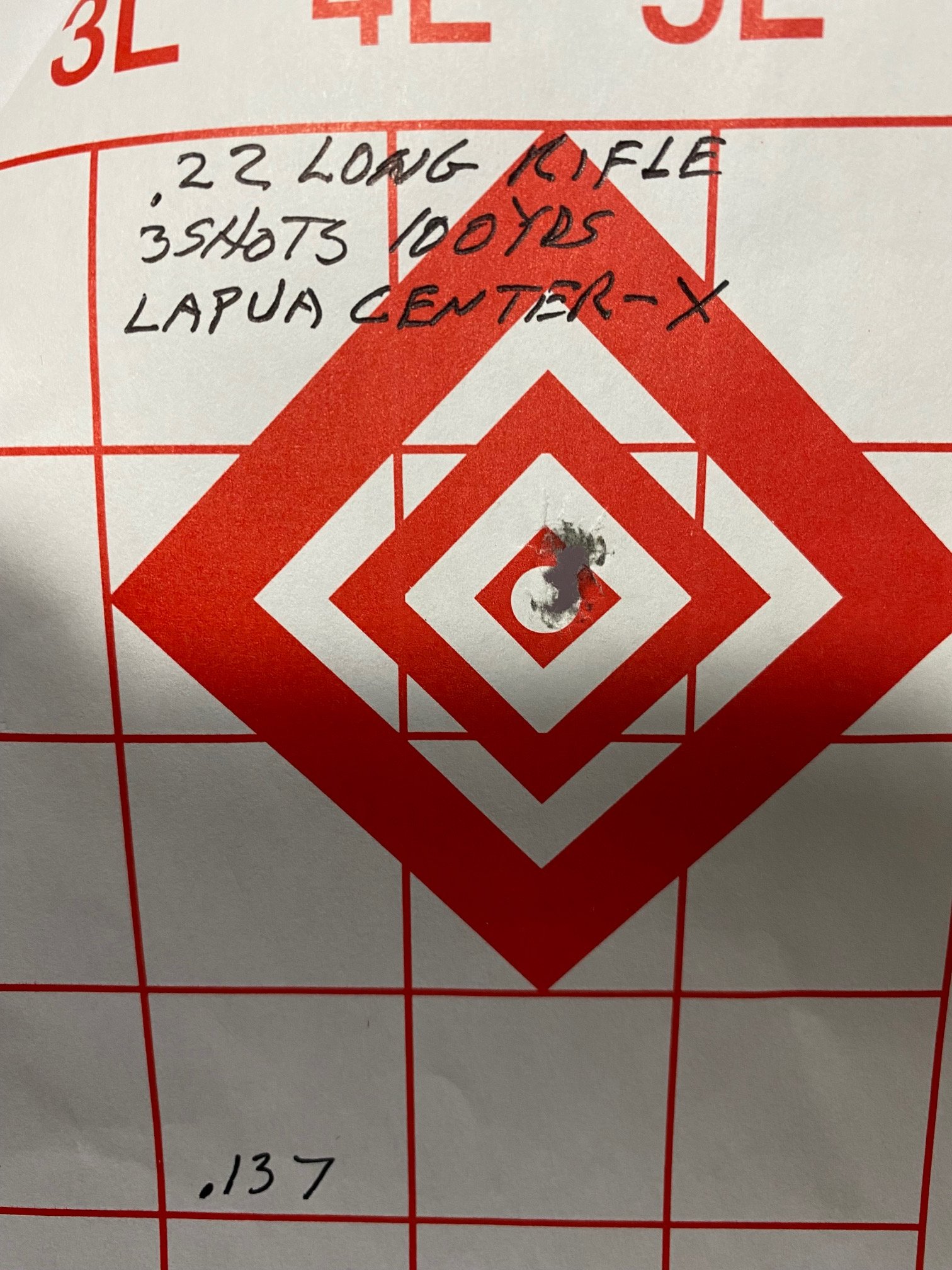

Yes the test group was fired at 100yds off a front bag using center X . The barrel is one provided by Vudoo by agreement to Hill Country Rifles in New Braunfels Texas and the manufacturer was not told to me ….. but I’m not going to argue with success .137 is better than these old eyes can shoot
.137" is 3.48mm. The best ever test in the Lapua test tunnel is something in the 9mm range at 50 yards. Of course everyone can show that three shot group in one hole.

For all the talk on numbers here is the test target on my rifle. I don’t care if it is .137 or 10.xxx what I do know is it will outshoot my elderly capabilities and that is important to me. At my age an enjoyable distraction is what I want as I’ve done all the competitive shooting I need to
