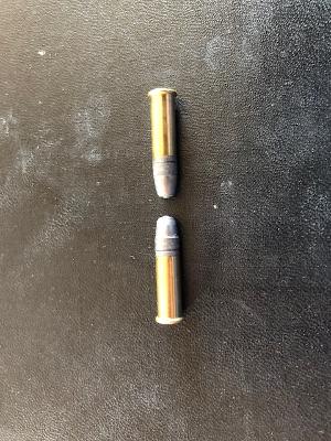

Evelio,
I have two barrels Bill Myers chambered. Both were done when the Eley EPS bullet was in wide use. I'm sure he chambered both barrels with the EPS bullet in mind.
I just chambered and closed the bolt on some Eley Tennex rounds. I can't see any engraving on the bullets. If it is there it is very little. Both barrels have been shot but not enough to wear them out.
Sorry I can't answer your question about how much engraving Bill used.

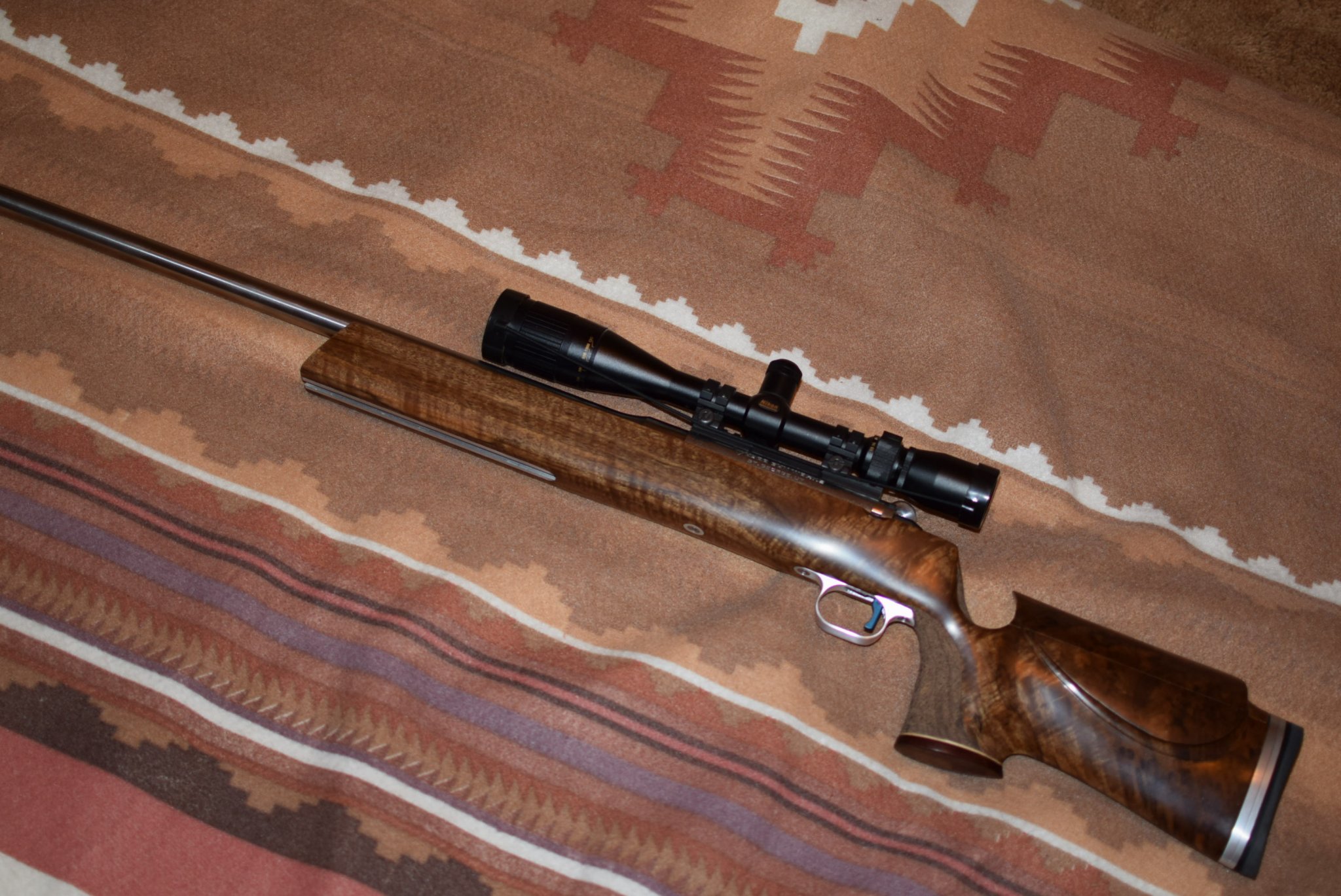

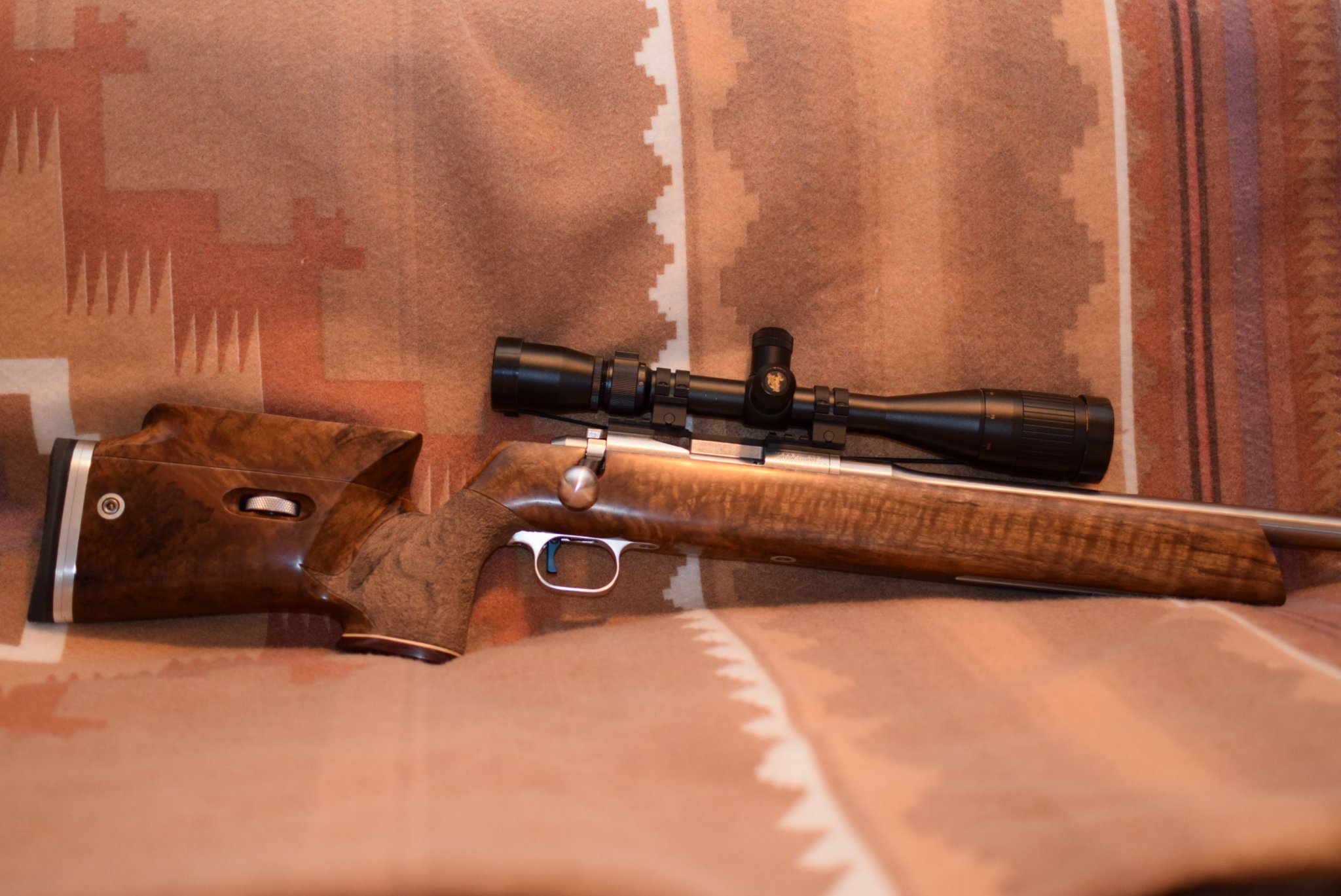

This is a shot of my latest V22S in its new prone smallbore stock of English walnut done by Doan Trevor. He's had it finished for a couple of weeks, but instead of having him ship it to me, I wanted to fly down to ABQ to see & visit with him again (it's been 12yrs since I last saw him at the 2009 Berger LR SW matches in Phoenix), and bring the finished rifle back home with me. I think I could've picked a better day to fly, as temps were in the upper 90s by the time we left ABQ to return home, and even though we had a nice tailwind to speed our return trip, it came at a price - rather frequent moderate turbulence. There was also quite a bit of smoke from several forest fires in the mountains between ABQ & Santa Fe that reduced visibility and had caused the FAA to issue some TFRs (Temporary Flight Restrictions) that forced us to fly a fair bit out of our way in order to stay out of the smoke and away from the aerial tankers which were working the fires. So it took us 3:05 to fly down against 15-20kt headwinds, vs 2:25 to get home with the tailwind. Whatever - it was worth the extra cost of avgas and the discomfort of flying in hot & bumpy air to get to visit with Doan again.
I mounted the old Nikon 6-18x44 Buckmaster in the photo because it was handy - a good friend who lives 165mi east of here bought a Leupold 24x BRD at an online auction for this rifle, but it's going to be a few days (or weeks) before I can get down to his place to pay him for it and get it mounted. So the old Nikon (which has always been a reliable scope) will just have to do until such time as I'm able to get my hands on the Leupold.
Since my intended use for this rifle is smallbore prone, and since no one at VGW knew for sure if Flavio Fare was going to make a trigger that could be adjusted for around a 1lb break, I ordered the action with the 60* cocking piece so I can use a Jewell or the CG Extreme that's currently installed. I used a Shilen select match ratchet rifled R0 blank, chambered it with a Nevius reamer, and finished it at 25". Since I'd only fired it a very few rounds before shipping it off to Doan (by pulling my 1st V22S out of its McMillan Kestros stock long enough to shoot 30-40rds through this bbl'd action), I really want to shoot it ASAP, hence the Nikon perched on the 20 MOA sloped VGW base. The stock has some very attractive figure, even if this photo doesn't show it. Will try to get outdoors with it for better lighting which should show that figure better.

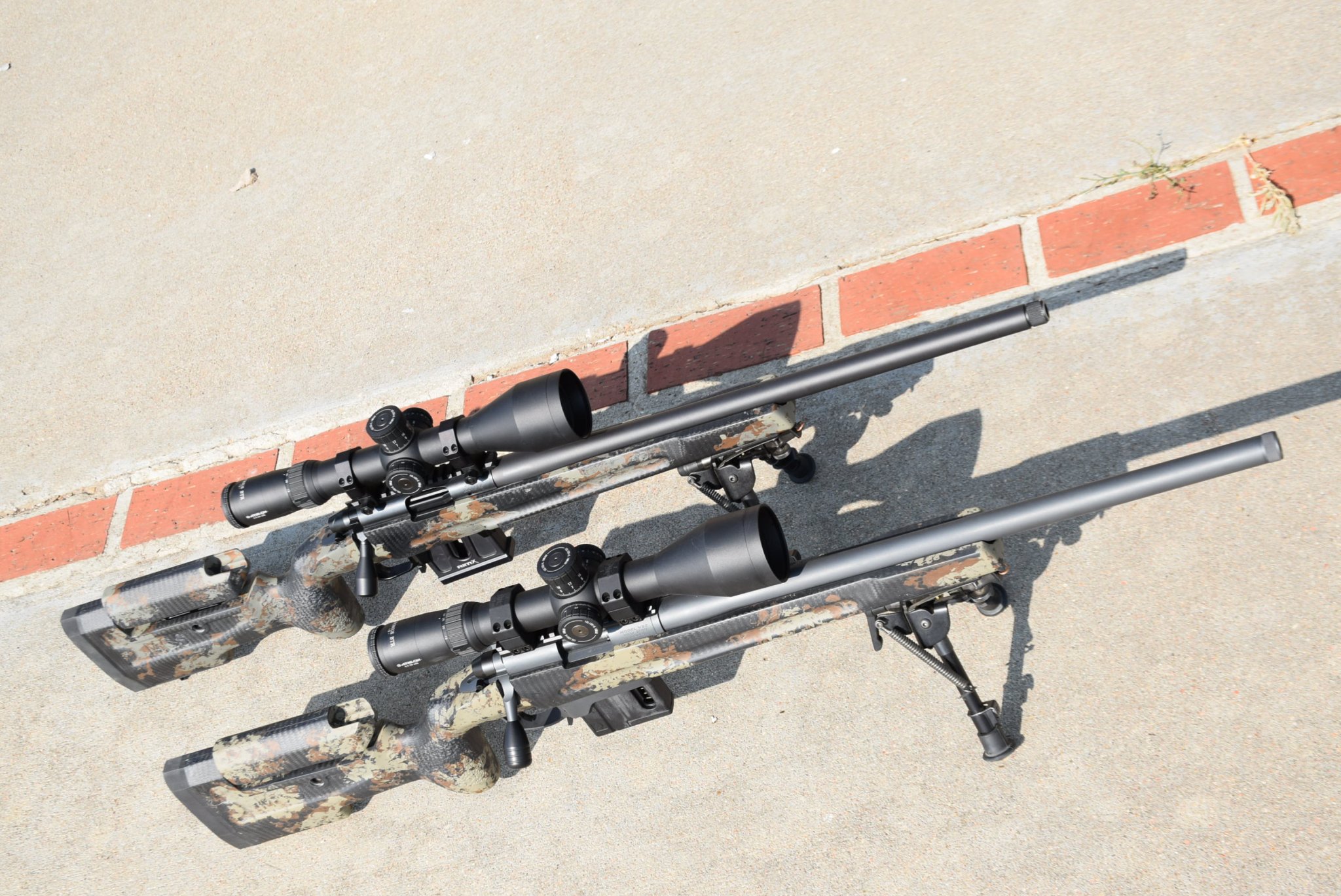

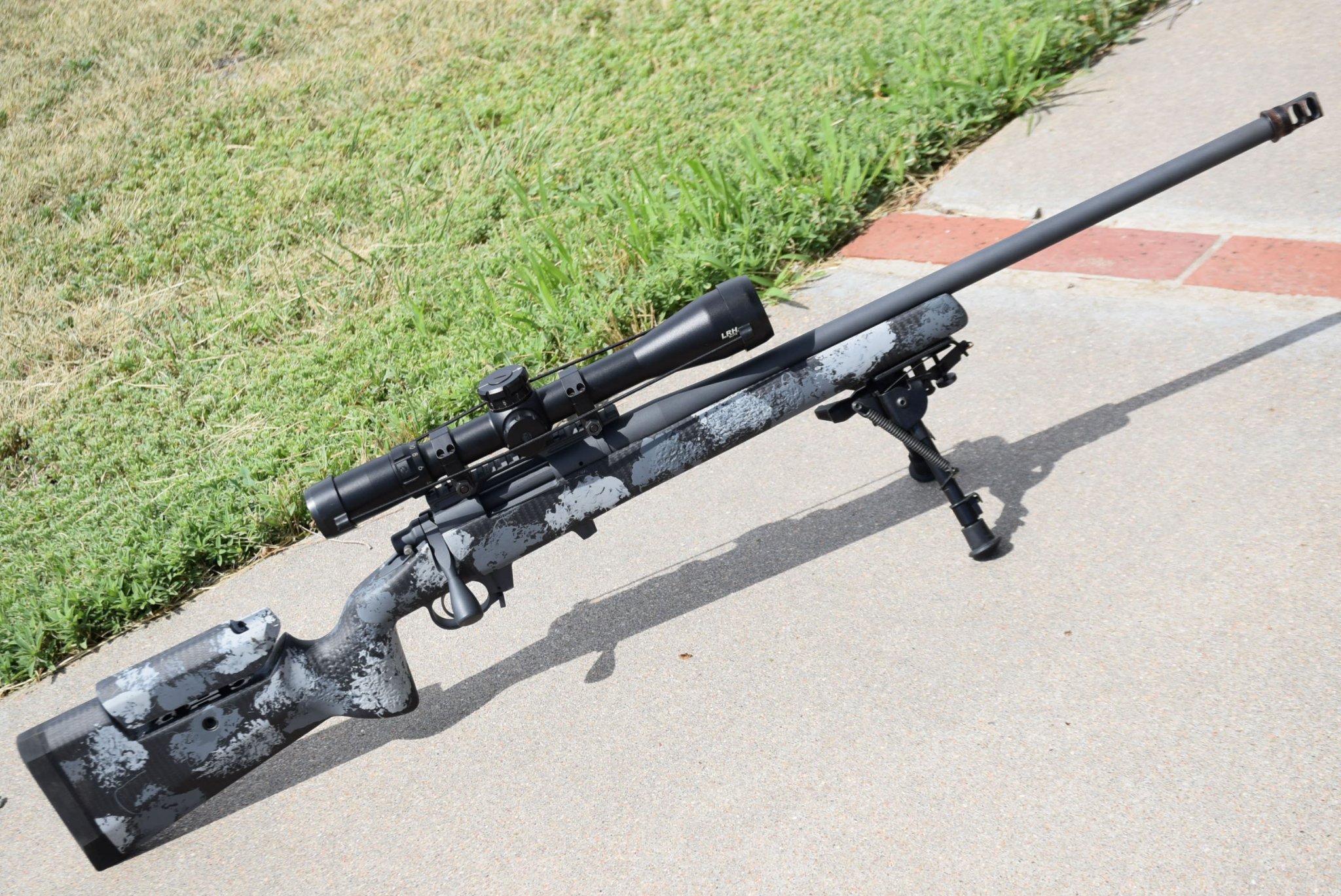

Never seen a stock CeraKoted sniper gray, but here's a photo one of my V22 repeaters (front rifle) that I bought as a bbl'd action that VGW CeraKoted in sniper gray, with my Rim-X that I shot the bbl with armor black behind it. Both are in Manners PRS1T stocks with molded-in scorched earth finish. If you're curious about the difference between sniper gray & black, look at the bolt knob on the V22 - they didn't shoot it with CeraKote for whatever reason; it's either anodized black, or shot with a flat black paint of some kind. The 2nd photo is of a custom M700 I built for myself, with sniper gray on the bbl'd action & DBM, while the stock is a Manners EH1A in their molded-in midnight camo.
It's built around a bare M700 receiver with a PTG custom oversized bolt that I ordered with the .061" firing pin hole and complete PTG undersized striker assembly to match, and mini-16 extractor. The bbl is a Krieger 1-7.5tw in a custom sendero contour that I found online., chambered in 6XC. The stock is a Manners EH1-A w/Hawkins DBM; it's intended as a long range coyote rifle, but I haven't taken a single dog with it yet. Since I intended to hunt with it, I went with a Trigger Tech Primary trigger, set at 1.5lbs. This is the 1st EH1-A stock I've owned - kind of like shooting behind it. I like the Bushnell 4.5-18x40 LRHS scopes too - this is the 3rd Gen 1 I've owned - the other two got sold with similar rifles wManners T3 stocks that I built for myself, and wound up selling to customers.

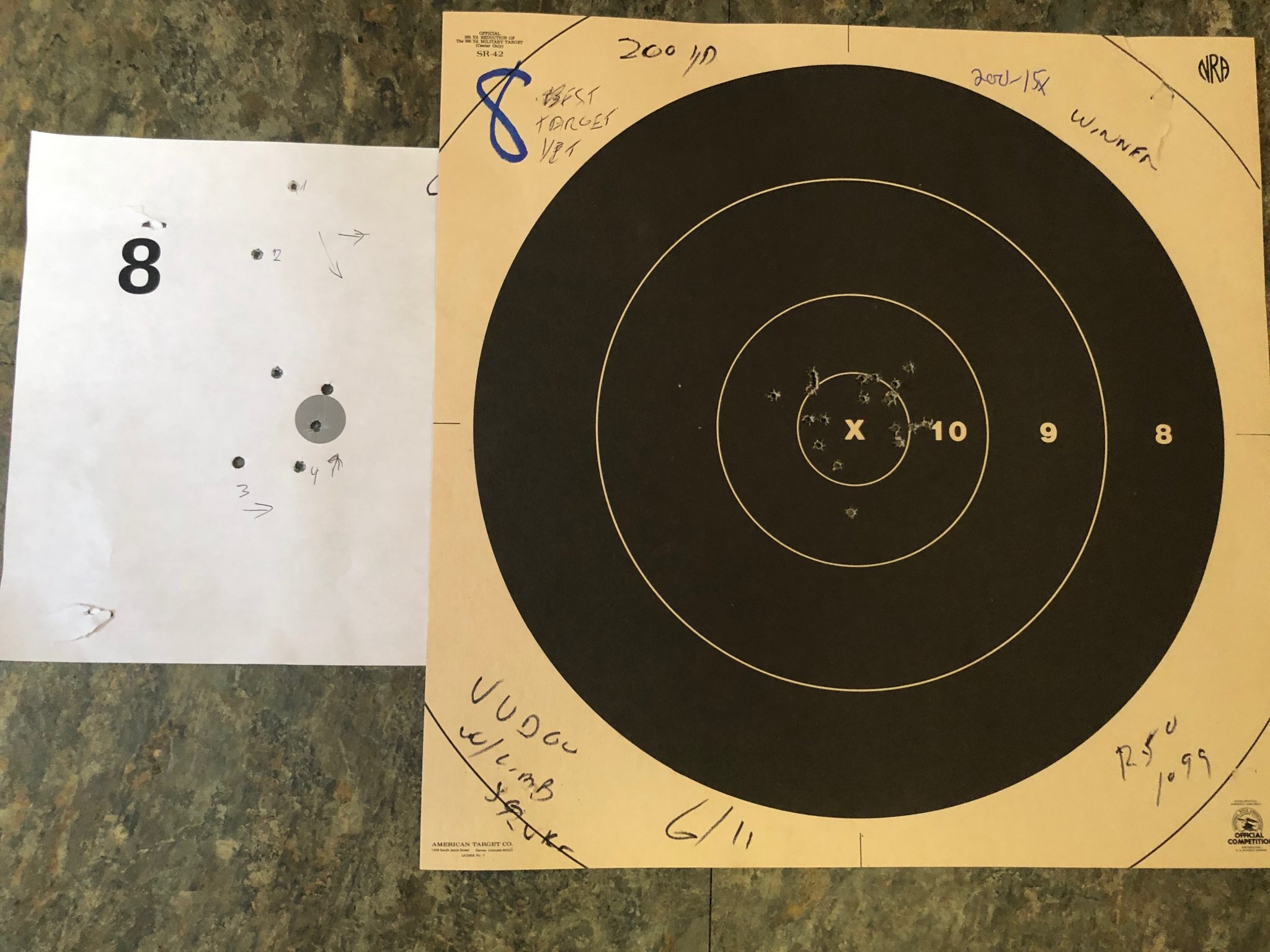

My best target yet! I've been shooting Midas for a 3 way tie last week. Why I decided to use R50 today without trying,( which I never do), I couldn't be happier! Athlon 10-40 scope with 4x cheater. When I got home my new Holeshot rear rest showed up. Good day!! Don’t see target? It was 200yds. Score 200/15x
