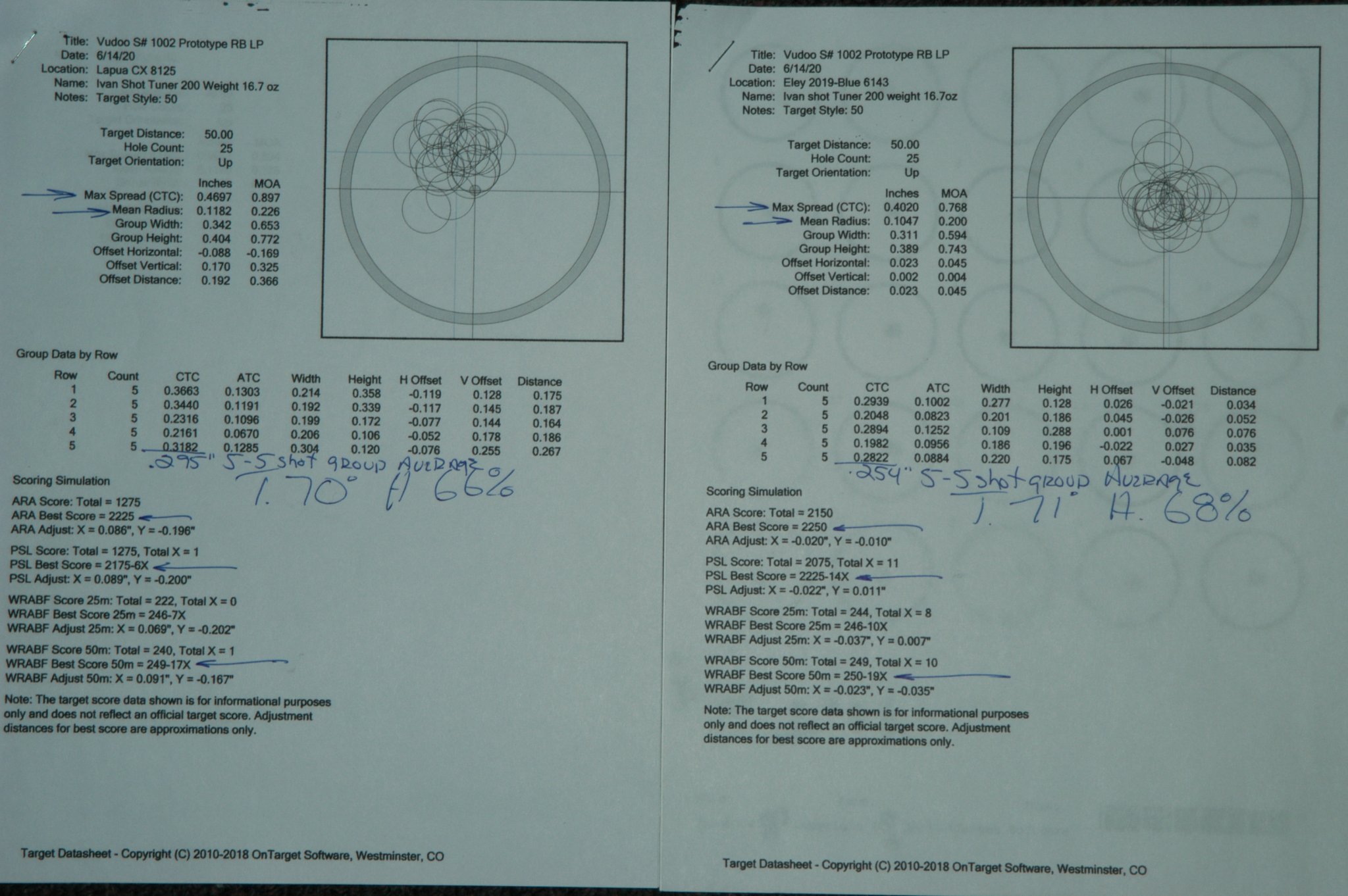

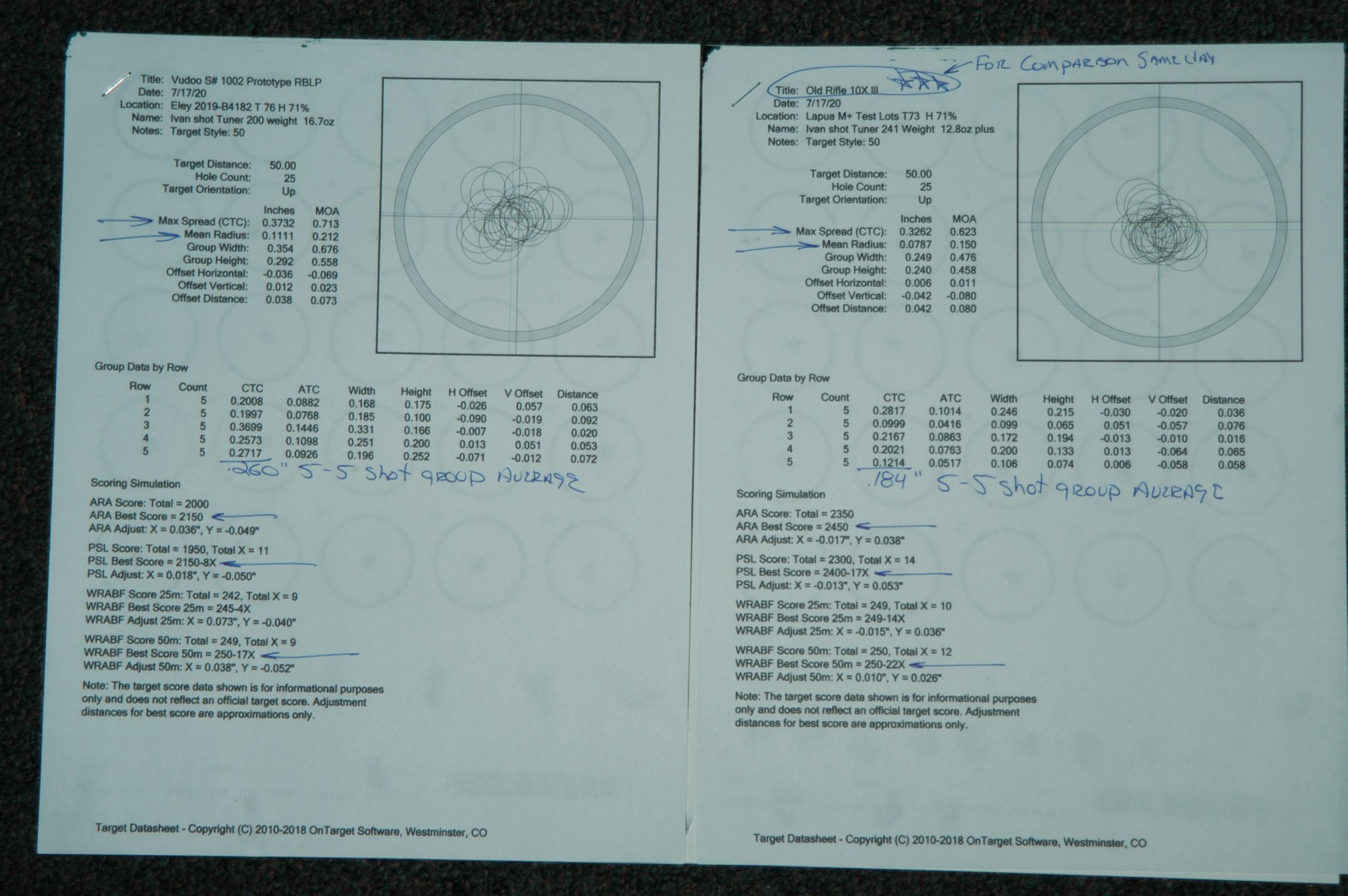

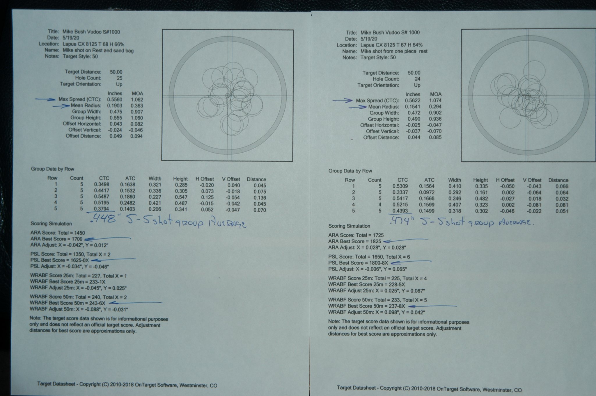

You have to start some where, the first set of data sheets are from when Mike B. was here. Remember Mike has never done this type of testing before, so don't be too hard on him. Vudoo Test Results 7.17.20 004.JPG
The second set of data sheets are from the actual first Vudoo, Ivanhoe rifle build.Vudoo Test Results 7.17.20 007.JPG
The third set of data sheets are from today testing the Vudoo, Ivanhoe rifle while trying to show you where we need to be comparing it to my rifle I shot in competition. The last target was shot with new Lapua test lots I just received today as well. Vudoo Test Results 7.17.20 009.JPG
Guys it's been a long day! When I get a chance I will call Landy, I think he will be happy to weigh in on this and explain some things. Remember numbers never lie.
Hope this helps!!

As I understand it the action is still being worked on to make further improvements. If anyone can fix the issues and make it competitive it's probably Ivan. I feel certain that the final model will be competitive once all the adjustments and testing are done.
Looking at the above test data sheets , the results were actually pretty bad for a BR gun. It be "in the hunt" the groups should be in the .1"'s to .2".
So far mot impressed even though I have one on order.
In real world performance you'd be surprised how few guns pull off your stated expectations, especially guns that will shoot in the .1's on anything considered consistently.
this seems often repeated " internet lore"
spend time looking at historic Eley/Lapua test tunnel results or Landy's substantial published data if you doubt my comments.
Ivan, nice data.....thanks.
Given this is early, with a platform in development, could you throw out an idea, from your personal testing history, approximately what percentile you'd place this? How many guns do you figure you have tested in your facility?
