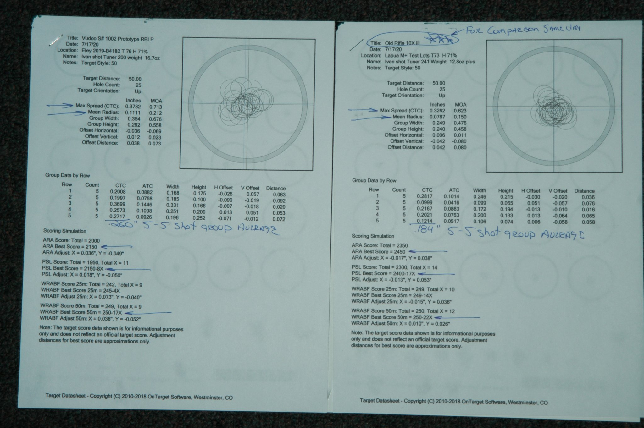

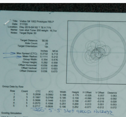

a 0.184" avg grp size of five 5-shot groups, its gonna be good enuf to not be ANY limitation for me as a shooter. It'll still be the nut behind the bolt holding me back. :)
ETA: as will the 0.260 group. :)

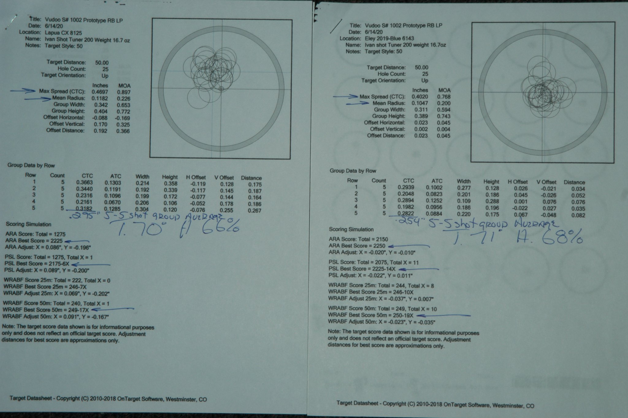

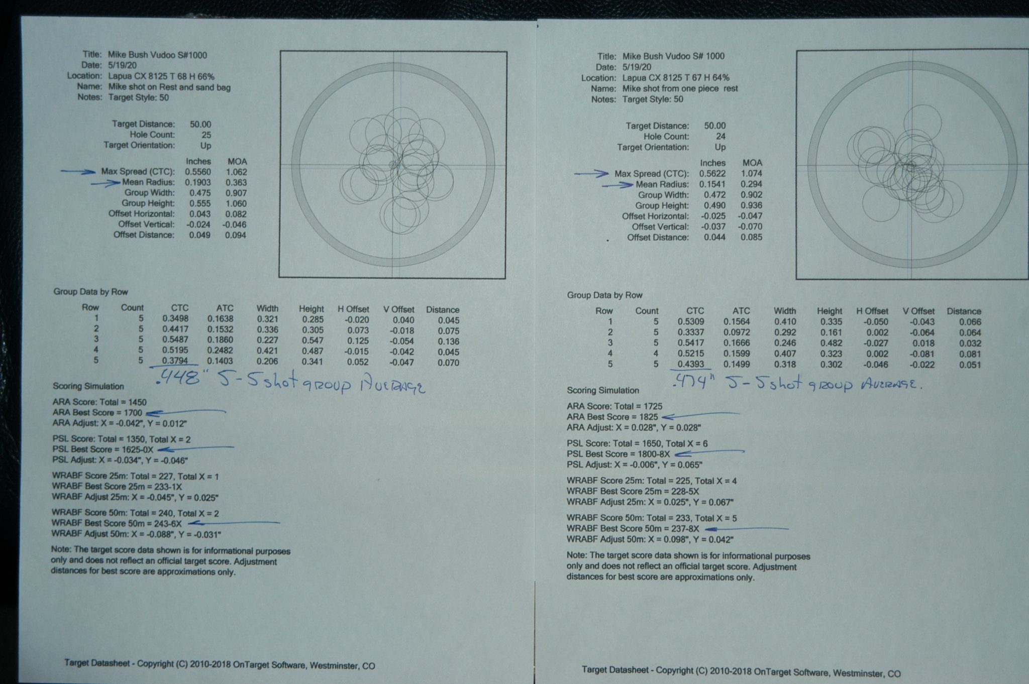

You have to start some where, the first set of data sheets are from when Mike B. was here. Remember Mike has never done this type of testing before, so don't be too hard on him. View attachment 7376969
The second set of data sheets are from the actual first Vudoo, Ivanhoe rifle build.View attachment 7376970
The third set of data sheets are from today testing the Vudoo, Ivanhoe rifle while trying to show you where we need to be comparing it to my rifle I shot in competition. The last target was shot with new Lapua test lots I just received today as well. View attachment 7376974
Guys it's been a long day! When I get a chance I will call Landy, I think he will be happy to weigh in on this and explain some things. Remember numbers never lie.
Hope this helps!!
Ivan
Hope this helps!!
Ivan
Ivan, a question on your testing design. I see you are shooting 25 shot groups in both rifles as a comparison. Do you have a design expectation for the new Vudoo? Is it to shoot 25 group shots as well as your competition rifle? Or better? Just curious what the team is shooting for (pardon the pun)....
Reactions: Drknite
The .184 came from Ivan's match rifle, the "control" in the testing, not the new Vudoo SS rifle. FYI only.
Gotcha.
The 0.260 avg will still outshoot me. :)
Of course, it makes sense that the tester shooting his own test rifle which he's dialed in over years is gonna beat a rifle dropped off a coupla days ago.
Reactions: Cuzz
Gotcha.
Also note that he shot 25 rounds in each rifle, so that's a big group. A 5 round group should do much better with the right ammo, but also the right support system. I'm sure the rifles in his testing are clamped down to eliminate the "people" aspect of testing, similar to testing at the Lapua sites.
And I agree, .260 average over 25 shots, is likely much better than I can shoot too!
Absolutely. Pic shows the individual 5 - shot groups ... and its exacly as you say.... one 5-shot at 0.1997 another at 0.2008 (then some larger)
