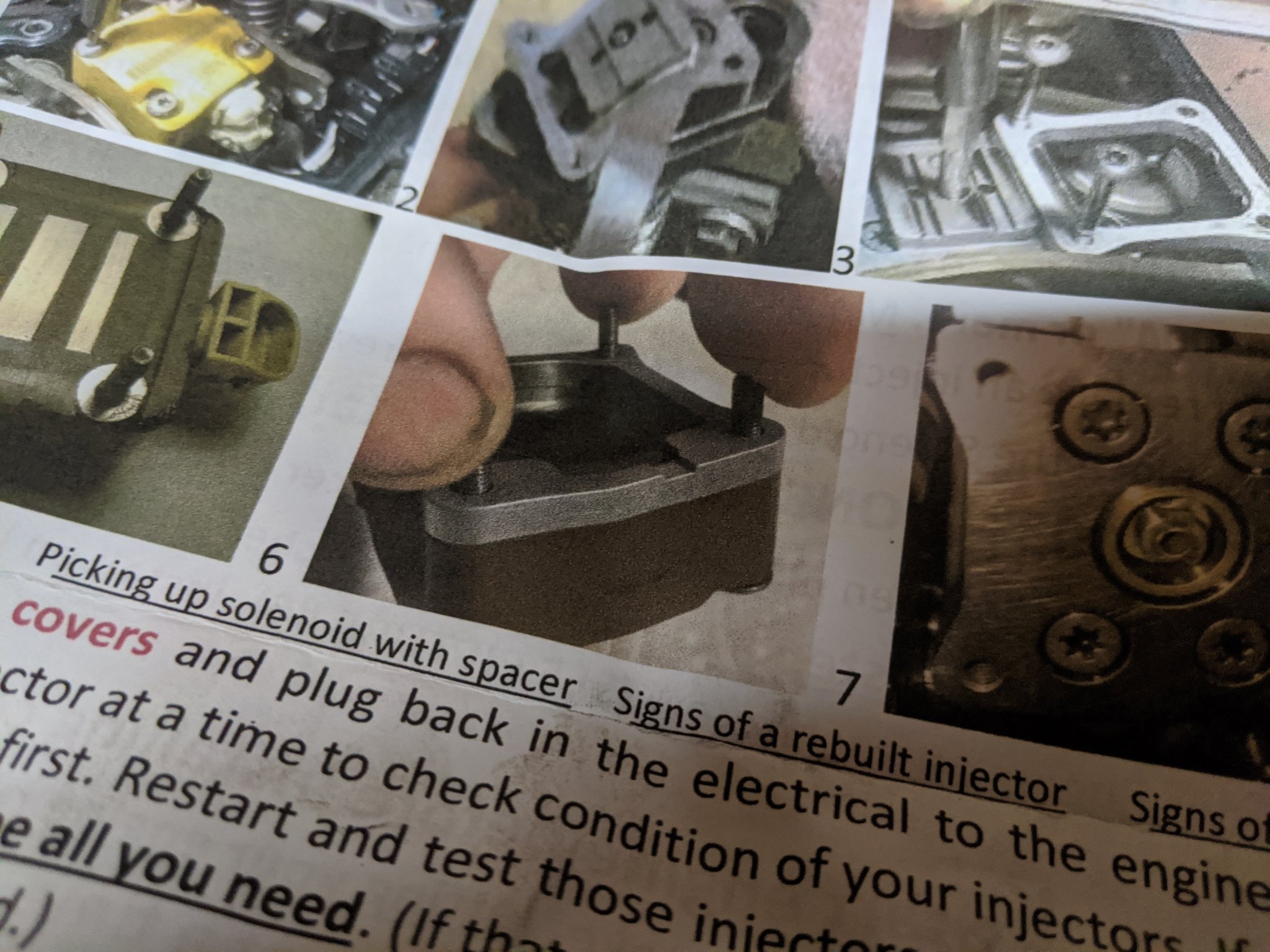

For my 7.3, it was a glow plug relay. It cracked and moisture got in and eventually corroded it What did the shim kit do? What problem did it fix? In case I have the same eventually.View attachment 7255812

I have had 3 different shops work on it because it won't start below 40 degrees unless it's plugged in.
Thanks to hours of research, several hours of work and an $85 shim kit from eBay. The truck started on the first cycle of the glo plugs.
I have 260K miles on mine. The glow plugs had been replaced, a couple different sets of gaskets, relays replaced and a bunch of bullshit from mechanics.

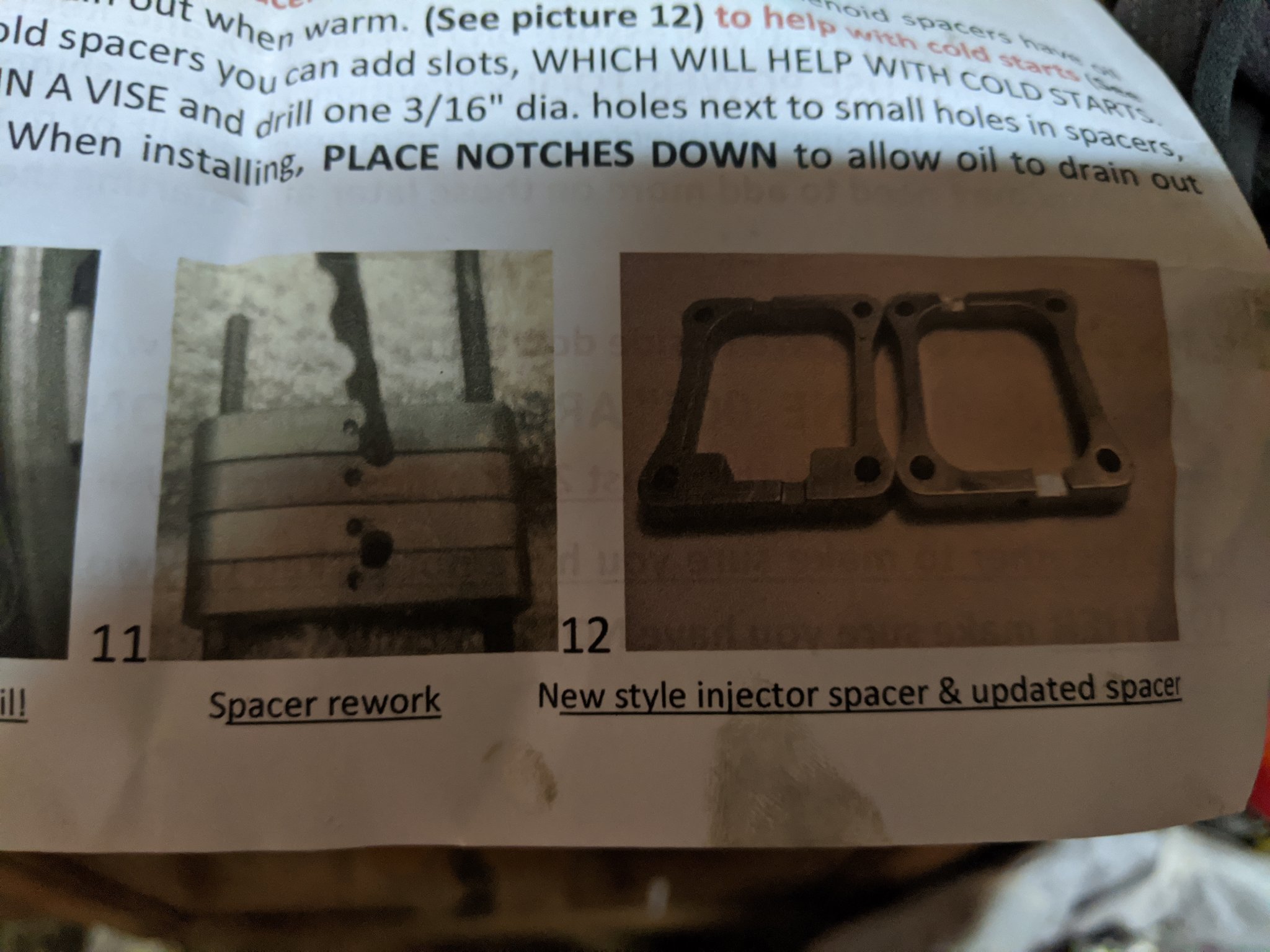

What I finally found was the injectors need to have a certain spacing between the coil and the armature. They need a minimum of four thousand under the armature. Also a small weep hole in the spacer will allow oil drain off and help in cold starting.
Here's a good video to explain. I don't think he covered the drain Gap in the spacer though. I will post a picture of it in a bit.
150,000 on mine and I'm second owner. Had it for 15 years. No leaks and no squeaks. The valve covers have never been removed, thank goodness. I watched the video. I have been a design engineer for the past 25 years for car parts and we have to do problem solving. Whoever figured this out is a person I have the highest respect for. Seriously, 0.002" on a unit injector on an engine with God knows how many parts.....and someone said," that's it right there". I will definitely keep this in the file. It will happen to me one day and I will remember this and it will save me a ton of money. thanks.
