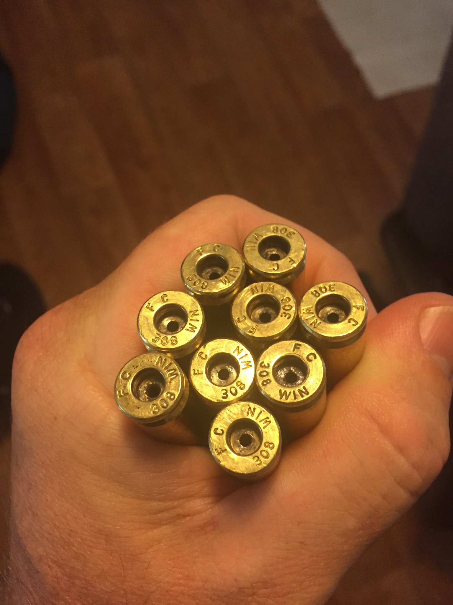

I loaded 150g- 3 rnds each of 41g, 41.5g, 42g. Started low bc of the brass, from what i researched. IM ONLY USING LC21 BRASS AT THIS MOMENT, but i did measure the water volume in the 3 diff brass cases i have (LC21, Aguila7.62, A.USA.308win). Difference from empty and full is...
1) 3.600g-Aguila
2) 3.600g-LC21
3) 3.641g-A.USA 308
Was just curious how diff the cases were with volume.

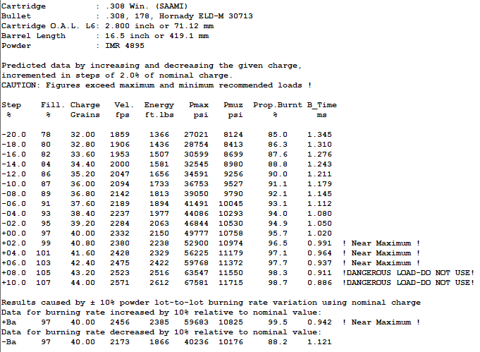

What load for 178g ELD MATCH do u guys think would be best for my setup, and with the supplies i have. IMR4895.
i looked evrywhere online and i dnt see anything for that powder and 178g.
thanks ahead of time!!
This is what Quickload predicts.
My guess is you could start around 39gr and move up towards 43gr, checking for pressure signs. In fact, it's smart to do a quick pressure test string on new combinations of components like this by just loading a single round of increasing charge weights and just looking for a safe window to do the actual load dev in. I bring a large cardboard box to the range with me to catch the brass so I can easily inspect each one for pressure signs.
thank you. appreciate it.
is QUICKLOAD a program u enter your numbers and it tells u? or does it just have all the diff combos listed??

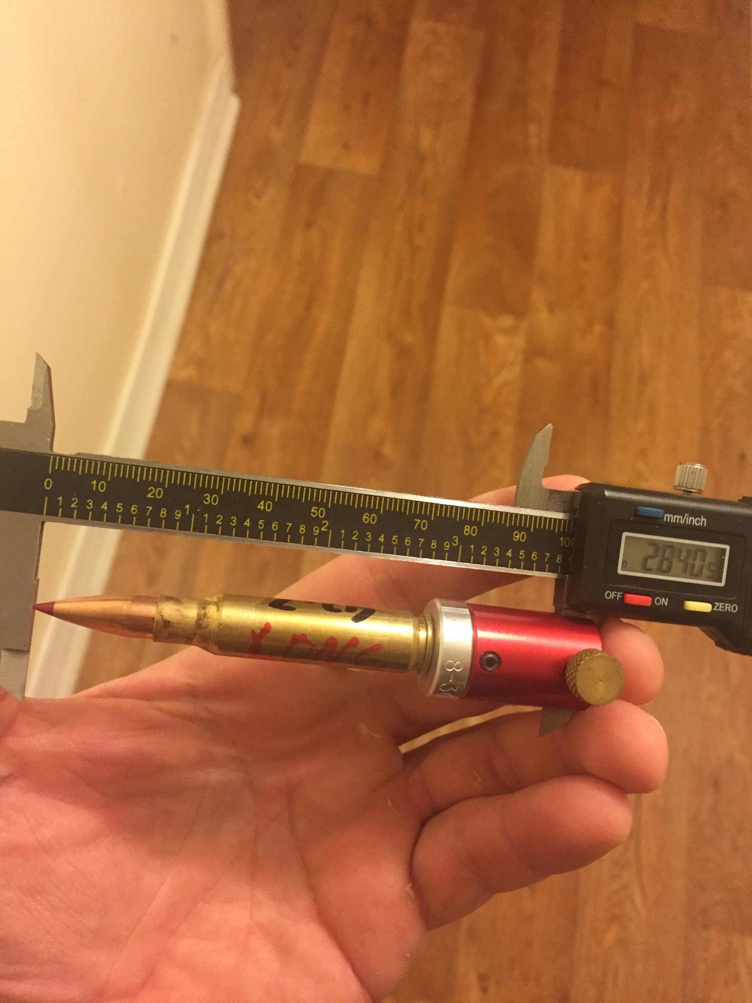

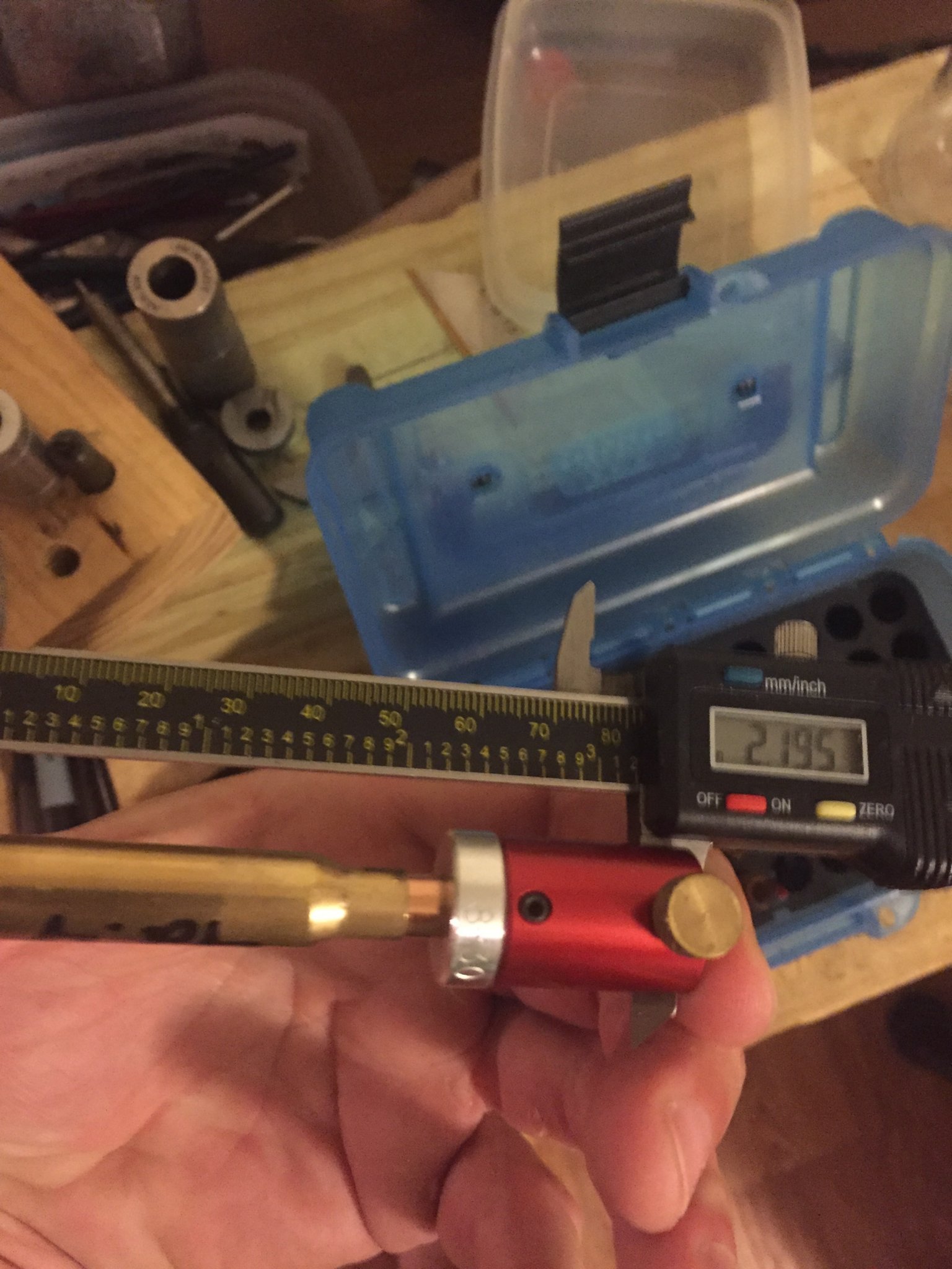

Currently working with 178ELDM’s using 4064 in FC15 and FC-308 brass seated around 2.830 or a 2.194BTO 41.8gr small base die trimed at 2.010. It is a mildly compressed load. Shot it Monday and was repeatedly hitting a 4 inch plate at 300yards with a 716I.
Brass below is on its 4th reloading, Primer pockets are still snug. Runs fine, doesn’t tear up the brass.
I have tried up to 42.7grain same brass prep and seating depth. the bullet seating gets inconsistent. The powder charge starts pushing the bullet back out. At 41.8 grains I can still seat to 2.800 so I can use high capacity mags.
It's an internal ballistics program, and an old one at that, but it gets regular data updates (new powders, bullets, etc). It's not a replacement for proper load development, but it's a very handy tool for testing out combinations to see what may work best long before actually loading any.
well, it worked well. i shot 10rnds with the 178g. 2@39g, 2@40g, [email protected], [email protected], 2@41. All were within 4in, but the 4 @40.5/40.8 wrked best. dead center 🎯 , eveything just felt, sounded n looked good with those.....with a shitty scope, and a blind man firing @ lol. But thanks for your help and the info.

You probably already know this... But when I have inconsistent seating depth issues with compressed loads I do an initial seating that's about .010 long. Then I go back and work them all down to the target depth... Takes a bit of time and can be a PITA. But it removes that bit of doubt as to whether your grouping is due to inconsistent seating depth.
Mike
Mike
I have done similar. Seat them, then measure and sort them, then bump the long ones down.
The one that I loaded at 42.7 that gave me the trouble, one of the 5 I could not get it shorter than 2.838 has grown .002”
Going to pull these 42.7gr down and not shoot them. Loaded them Out of curiosity. Seems a little too much for my components/process.
Btw- at 41.4 is when I noticed, I could shake them I didn’t hear much moving around inside. Again with my process and components.
Reactions: OkieMike
The one that I loaded at 42.7 that gave me the trouble, one of the 5 I could not get it shorter than 2.838 has grown .002” View attachment 7992329
Is that an attachment for your caliper? Just to allow the head to sit flat? Bc i have the same caliper, but i just use the tooth(or whatevr theyre called)
No, its for measuring the base to ogive. It is not necessarily designed to measure over all length. Pic below is how the tool is designed to be used.
But it works for measureing the Over all length too. Just flip the cartridge 180 degrees.
