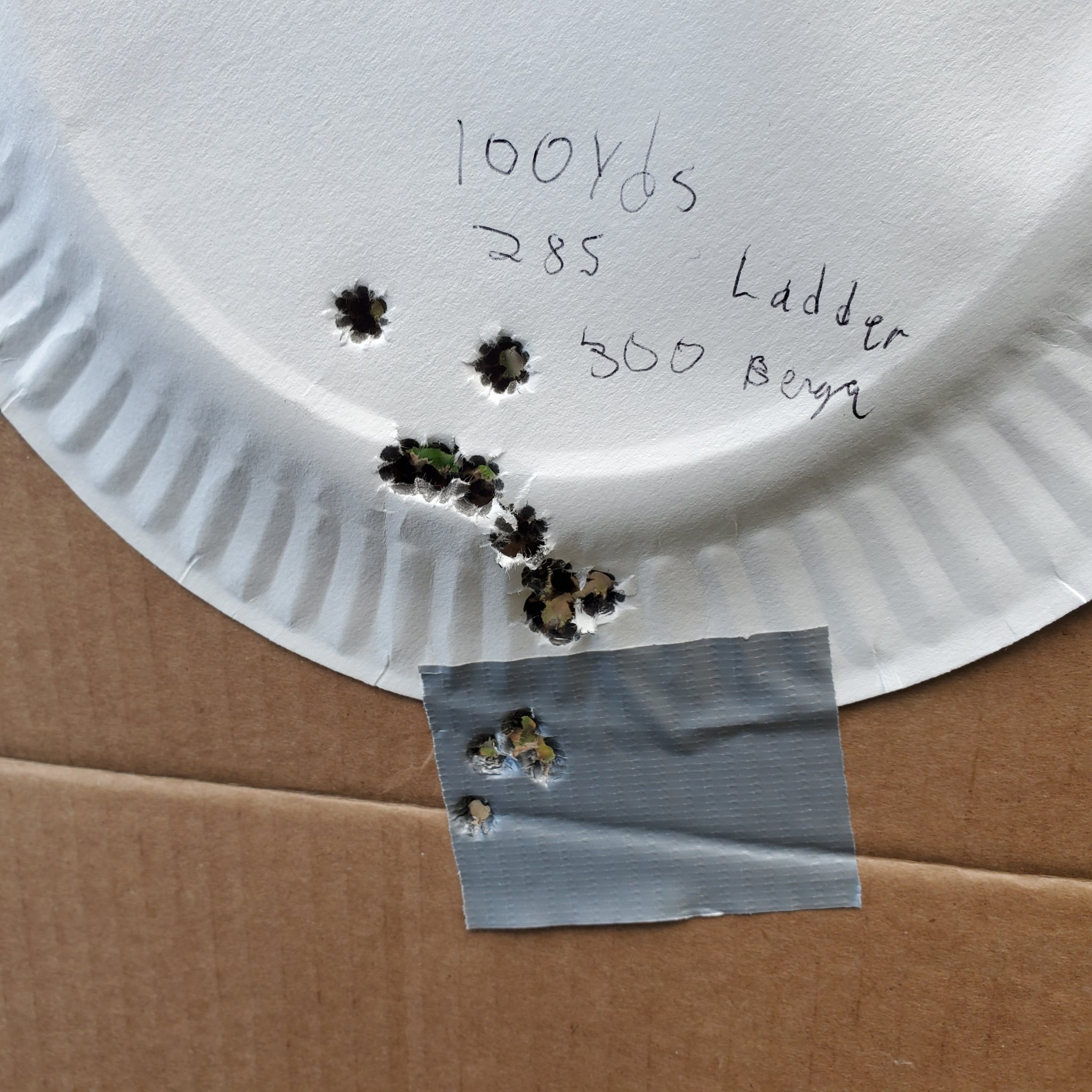

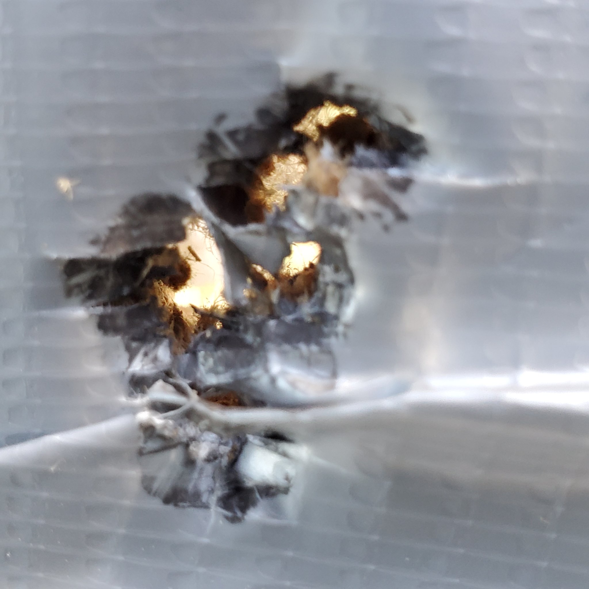

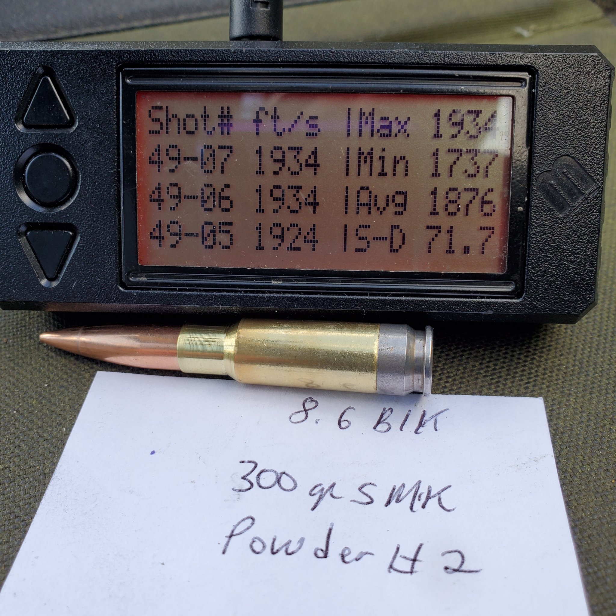

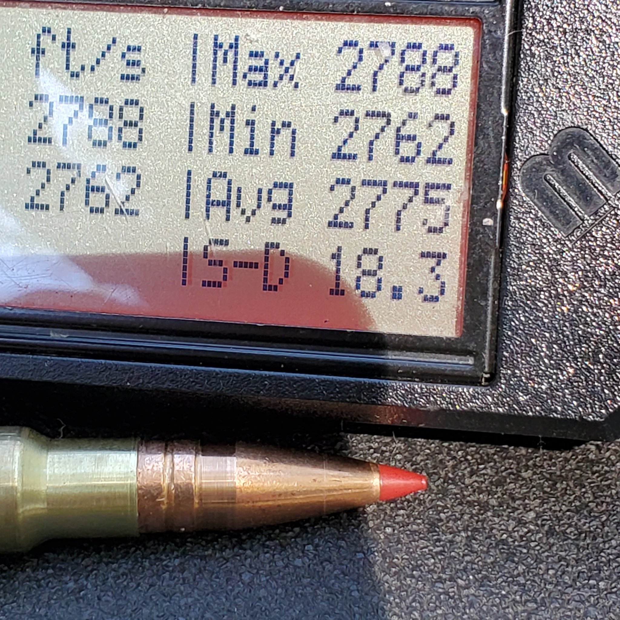

Finnally got out to try out some high velocity 8.6 Blackout loads...in the new 6.5 twist barrel. They weren't as high as predicted...but not too bad either. Much better than the three twist...none came apart in mid flight or damaged the muzzle brake. No primers were blown, either.
Used two powders in ladder tests.
The results were 2480 fps for 200 gr, 2250 fps for 225 gr, 230 gr eldx 2200 fps, 285 gr 1873 fps, 300 gr Berger & Sierra 1808 fps
Powder #2 300 gr Berger 1943 fps, 300 gr Sierra MK , 1934 fps.
Ran the data for a 2480 fps 200 grain bullet (I assumed this was a Hornady SST) on a calculator. It’s comparable to a 20” .308 shooting 175 grain SMKs at around 2600 fps.

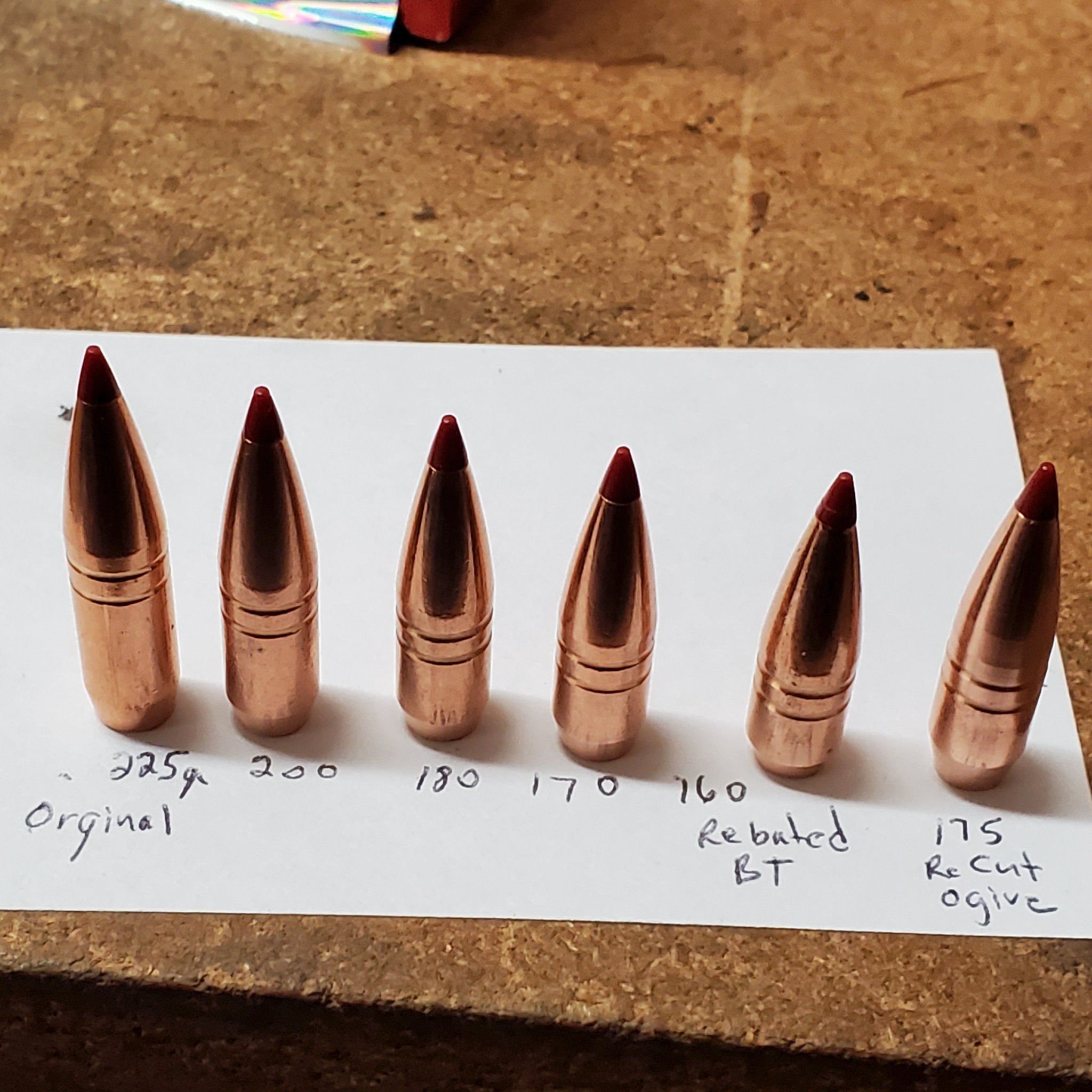

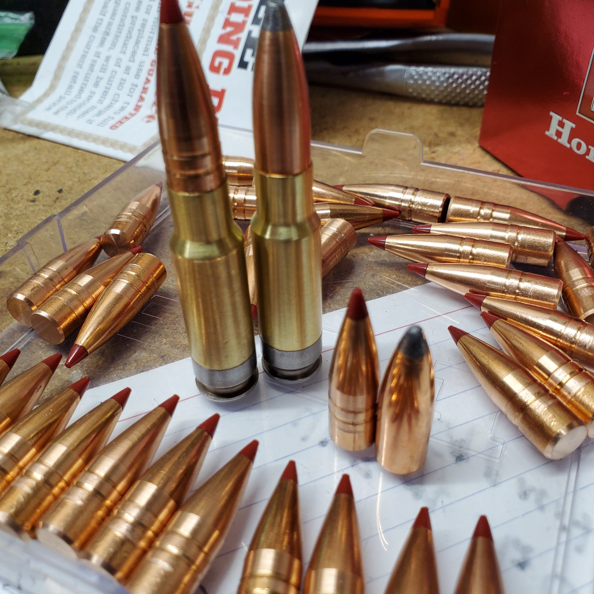

Can not find the bullet ya want ...make your own, or modify existing bullets to fit your chamber. The all copper bullets are easy, to modify from weight to boattail, even the ogive for putting the bullet down the bore farther so you can add more powder.
It could be possible to reach 3000 fps in a 8.6 blackout...inquiring minds want to know...or...it gives retired machinist something to do.
I got 3760 fps in an AR 10 16" barrel with 50 gr copper 9mm hollow points, they grouped good but fade shed velocity very fast...a fun but ridiculous experiment of little value.
This will be more practical...and improve the 8.6 blk ...maybe?

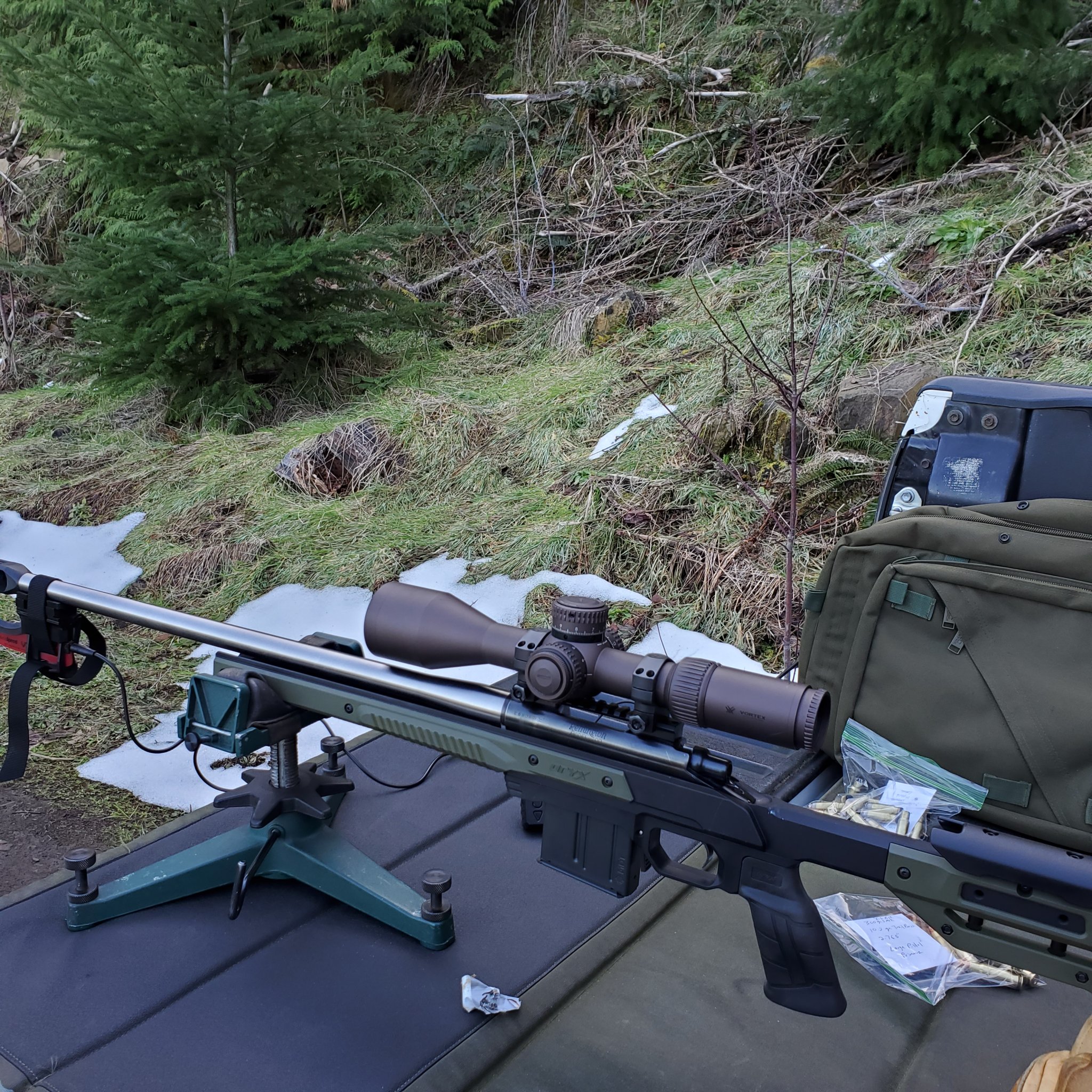

Just finished chambering a bolt gun on a 6.5 twist for the 8.6 Blk, with a nice barrel blank.
I also machine AR barrels from barrel blanks, that are not readily available from quality barrel suppliers.

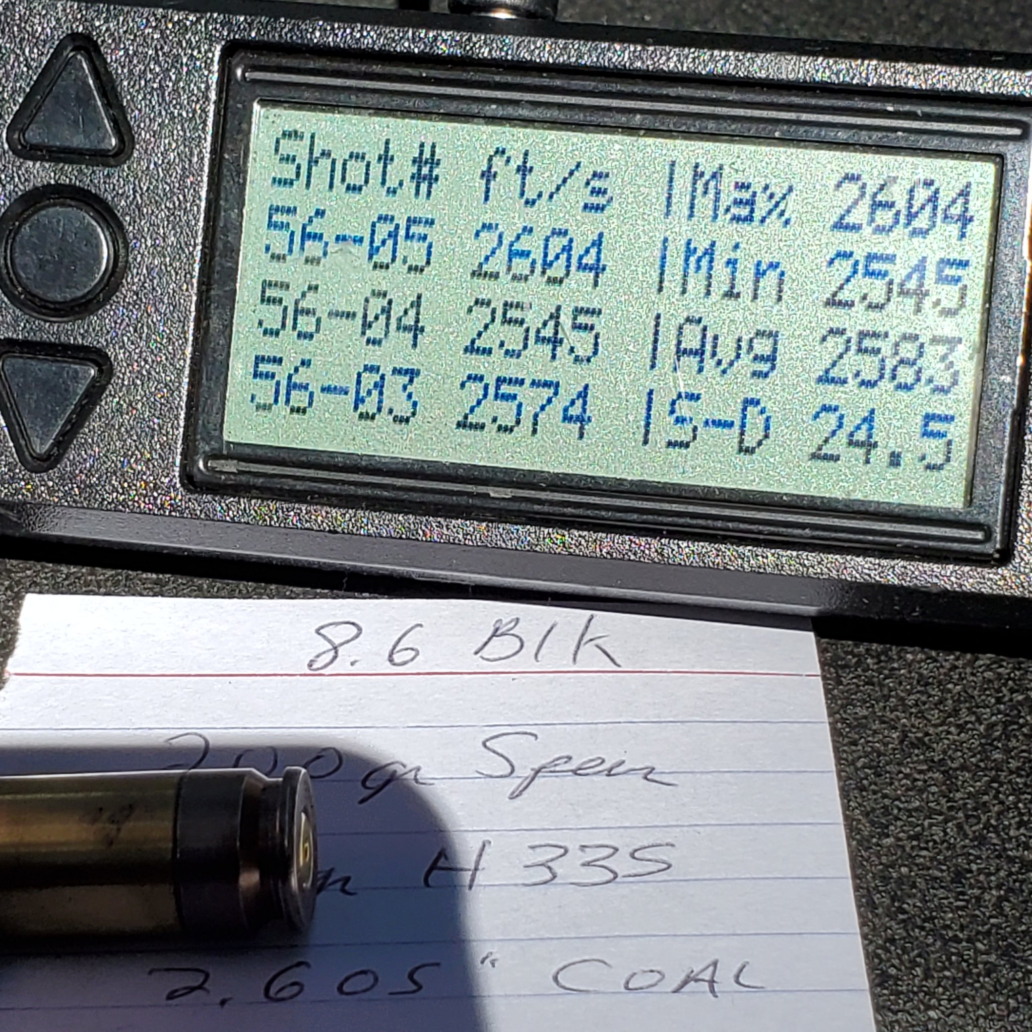

I did a "fine powder" test today. as expected, 20.7gr ruined the bottom of the three cases that I shot. I can take a photo if anyone wants to see what ruined means. Targets, load data, velocities, etc are in the attached PDF. I almost got under 1MOA. Group 1 and Group 6 but 6 is unusable because it destroys the brass. Group 2 had better stats than Group 1.
I changed the seating depth. I don't recall the exact number I measured on the magazine, it was something like 2.839. I loaded everything at 2.825. The previous load test was in .2gr increments and 2.800. Having less bullet in the case seemed to help a little. 10 degree warmer temps might helped a little with that as well.
I have one more little thing to try before I call 20.1 or 20.5 good enough.

Also maching some hornady GMX copper bullets to 152 gr to see what they will do, they are machined to fit my chamber with .050" jump.
Yeah, a bit extreme...but in the end I will know what the 8.6 Blackout is capable of... even if its not available from manufacturers, I will make it myself...to find out.

I used 19.7 gr 1680 2.570" OAL 200 gr lead jacketed Speer hot core...really cheap. And they didn't explode, plus fairly accurate. Fired in AR 10 3 twist.
I shoot this bullet to 2480 fps in the 6.5 twist bolt gun, hybrid cases and a different powder.
This might be the best bullet for this cartridge in supersonic endeavors, especially the 6.5 twist where you can go all out. I have machined some copper bullets about 153 grs, expecting some good velocities on these, as they are machined to fit my chamber giving maximum powder capacity. I can make them very light incase I want to go to 3000 fps in the 8.6 bolt gun... more fun than serious. Stay tunned...been sickly and the weather is nasty.
Here is a picture of the two bullets seated the machined 153 gr copper longer then 2500 fps 200 gr Speer, for 6.5 twist barrels. There is 45.9 grs of powder under the copper 153 hybrid case. That is about max for that powder... load more and chronograph in a few days. Kind of a mad scientist on this high velocity tour for the 8. 6 Blackout.

Shot some 300 Bergers at 2 liter jugs...they were very unimpressive as to killing power.
Even at 1943 fps they just punched a .33" hole on the 2 liter...like shooting it with a Bow using a point target arrow...the liquid slowly drained out.
200 gr lead at 2480 fps exploded the 2 liter in the 6.5 twist.

Well got the super sonic test done today for the 8.6 Blackout with a 6.5 twist.
Top velocity for the cheap Speer 200 gr lead bullets was 2604 fps with H335.
AA 2495 =2451 fps
CFE223= 2572 fps
IMR 4198 =2433 fps
2000 MR =2494 fps 4.3 S/D
Machined copper Hornady 225 gr GMX cut down in lathe collet to 154 gr were fired with H335 and reached 2788 fps.
Caught one in water jugs it mushroomed up very nicely.
Shot a few 300 gr Subs in both Sierra with 1680 and 300 gr Berger with imr 4198 in the 6.5 twist the Sierra strung out vertically...the Berger was round 5 into 1.1"
All in all a successful day. The 6.5 twist is totally versatile as I suspected it would be. And the 8.6 Blackout comes close to the 338 Fredral, with supers, for some real killing power.
There was snow still heavy on the road and fallen trees across the road. Had to turn back to a bit lower elevation.

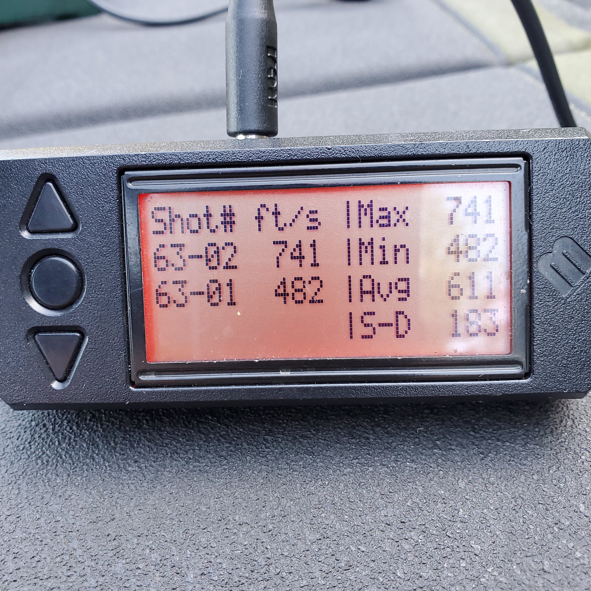

Installed a more expensive scope on the 8.6 to help me see the target.
Shot the subs today to see how they do in the 6.5 Twist McGowen barrel, I chambered and installed on a trued Remington 700 which I also did in my shop.
Snow still on the ground and fallen trees everywhere, but I made it out to shoot .
Tried some Trail Boss and Red Dot, with LR and LP primers, to see the result.
With Red Dot there was little difference in velocity, but better accuracy and better S/D with the LR primers.
But Trail Boss was shocking... about 250 fos difference, 741fps to 482 fps LR vs LP primer...had to stop the test to make sure the bullet exited the barrel, it did but that velocity is too low to continue with the pistol primers.
The remaining 4 Trail Boss loads st 700 fps went into about .8" low off the plate into the cardboard backer, but this is not the powder, S/D too high, even though the load density is great. The 6.5 twist stabilized the 300 SMK at 700 fps. Plus cheap 200 gr Speer lead bullets to 2600 fps.
Much more versatile than my inaccurate Faxon 3 twist, which would limit lead bullets to about 1200 fps as they came apart if shot much faster.
Red Dot had a good showing lower S/D and 5 shot groups hit .4"
Had AR 10 loads, already loaded 300 gr Sierra MK with AA1680 15.8 gr. S/ D was a bit high but it put 8 shots into .5" with the 6.5 twist bolt gun, the AR 10 Faxon 3 twist was about 2" plus for 5 shots, and this was its best load for the 300 gr SMK.
A good day out shooting.

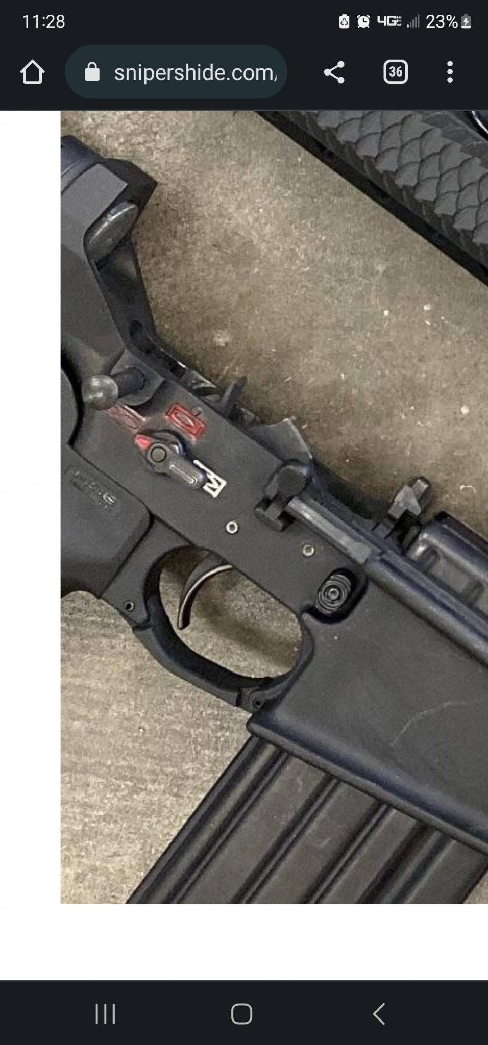

Just finished building my 8.6. 12" Faxon 1-3 twist barrel. Porq chop suppressor . Gorilla case, Remington large rifle primer, 14.7 gr Accurate 1680, bullets are 300 grain seconds that came from Midway. Pretty sure they are Sierra Match King. 934 ft sec average. Bolt cycles and locks on last open on last round. Going to go up a few grains and see if I can get between 1025 - 1050 ft sec.
