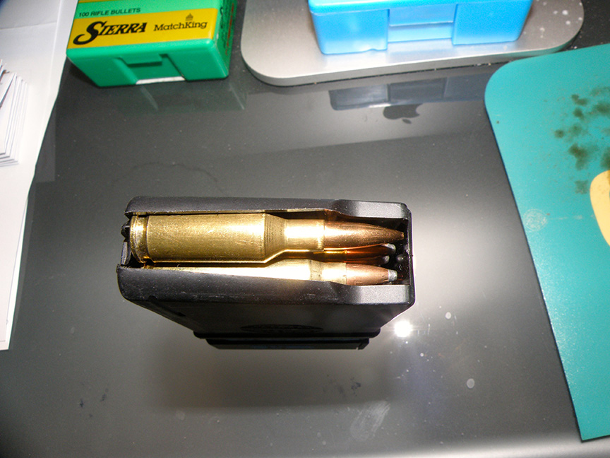

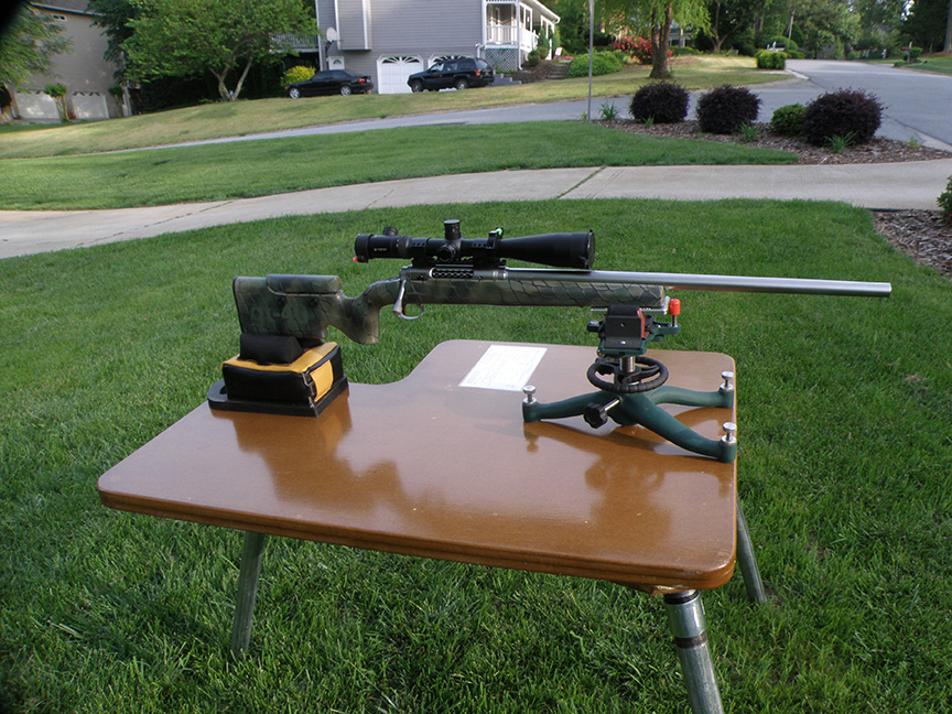

I am really considering this for a local club match or long range yote toy. I was shooting a 6.5cm surgeon which was a unbelievable rifle but at the end of the day I didn't have the time or extra funds to compete with the pros. The best part about this round is that it can be competitive enough to fill my needs and it will only cost my the amount it takes to build the upper since I already have a very nice long range lower built with my current 5.56.
The 12 LRP is a nice rifle and you will enjoy it.

Can't be to long as you can see under the 6mm Norma BR. is a .223 with a 62 grain bullet in the magazine. Here is a picture of a 6mm Norma BR. with a 90 grain Berger VLD with a .223 with a 65 grain Sierra Game King.
I do understand "now" that the bolt would be to thin for an AR15. I told you I wasn't an engineer. I guess in an AR10 you could use the 105 VLDs. By the way I don't think you lose much velocity compared to a .243, but you do get a more accurate round.

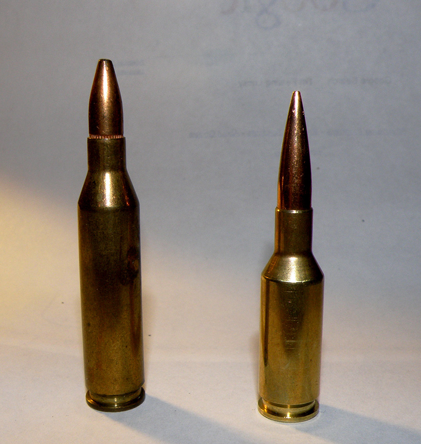

Well I was talking about shooting the 105 berger vld. Otherwise I cant see you gaining much over this with lower BC lighter bullets, bolt problem aside. The 105 would be over the 2.3ish mag length available for the ar15 platform.
The 6CM is a 6.5 creedmoor necked down to 6mm. Shoots 105s very close to most match limita of 3200 while still having decent barrel life. Basically just another 6mm cartridge to add to the mix but ita shoulder geometry lends well to being in an autoloader.
