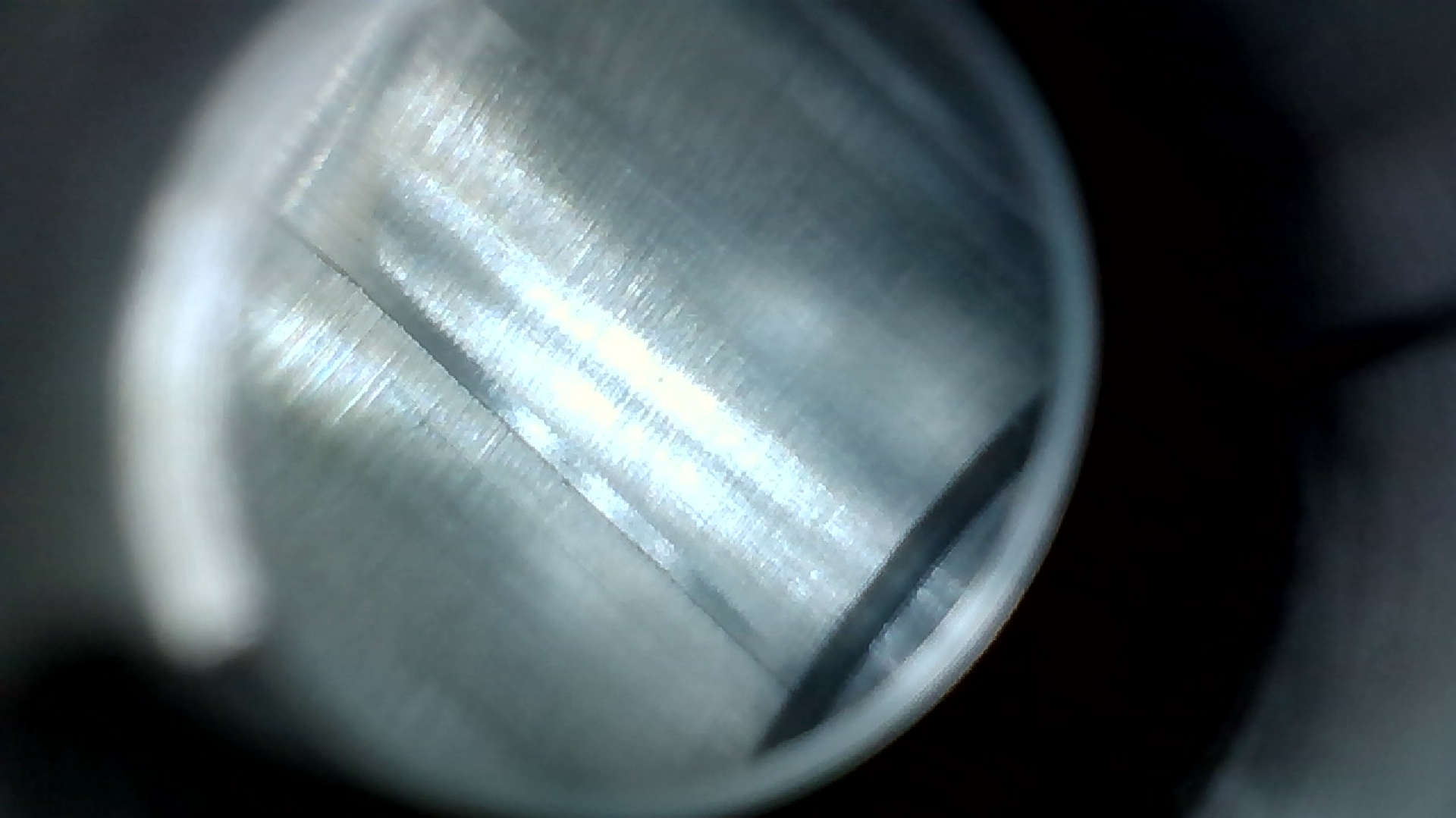

He doesn't need evidence. That Is a horrible chamber job and that's that. The gunsmith should pay shipping to get it back to inspect his fuck up and make it right. You have to have confidence in your equipment to win matchs. If you show up with that black cloud of a barrel looming over your head you will do poorly, even if it "shoots"
the bigger issue is, if this is the standard for that particular gunsmith, imagine how many others he's ripping off with that sloppy work..

If the chamber appears to be rough, that's damage beyond what a reasonable person would expect for a chamber job on an expensive premium barrel.
With visual damage to the chamber, placing the burden on the buyer to show that it doesn't work isn't the right play here.

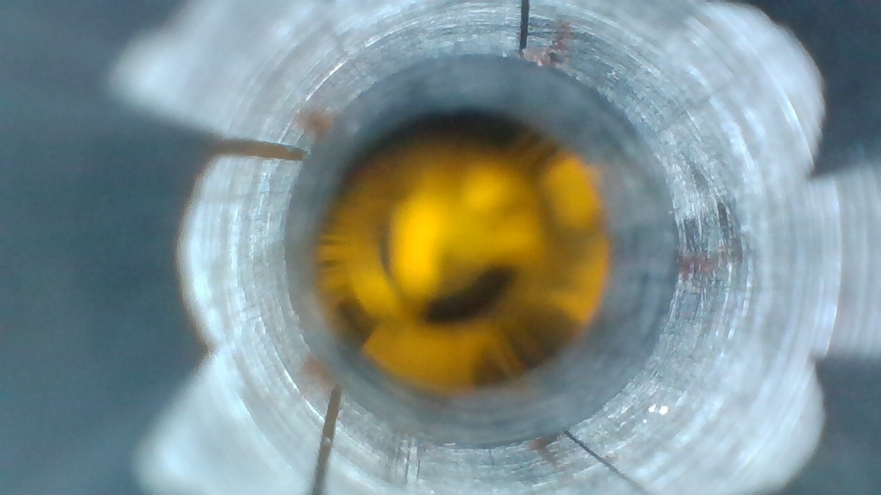

If all this internet "inspection" is visual ONLY........are all the naysayers OK with a freebore/throat that looks concentric (fully cleaned up rifling) ONLY because the reamer was spec'd with a freebore diameter of bore+.003" instead of the typical match bore+.0005"??? This will most likely make the rifle shoot poorly also.
I am not choosing a side, just trying to dig a little deeper into the visual pass/fail scenario above.

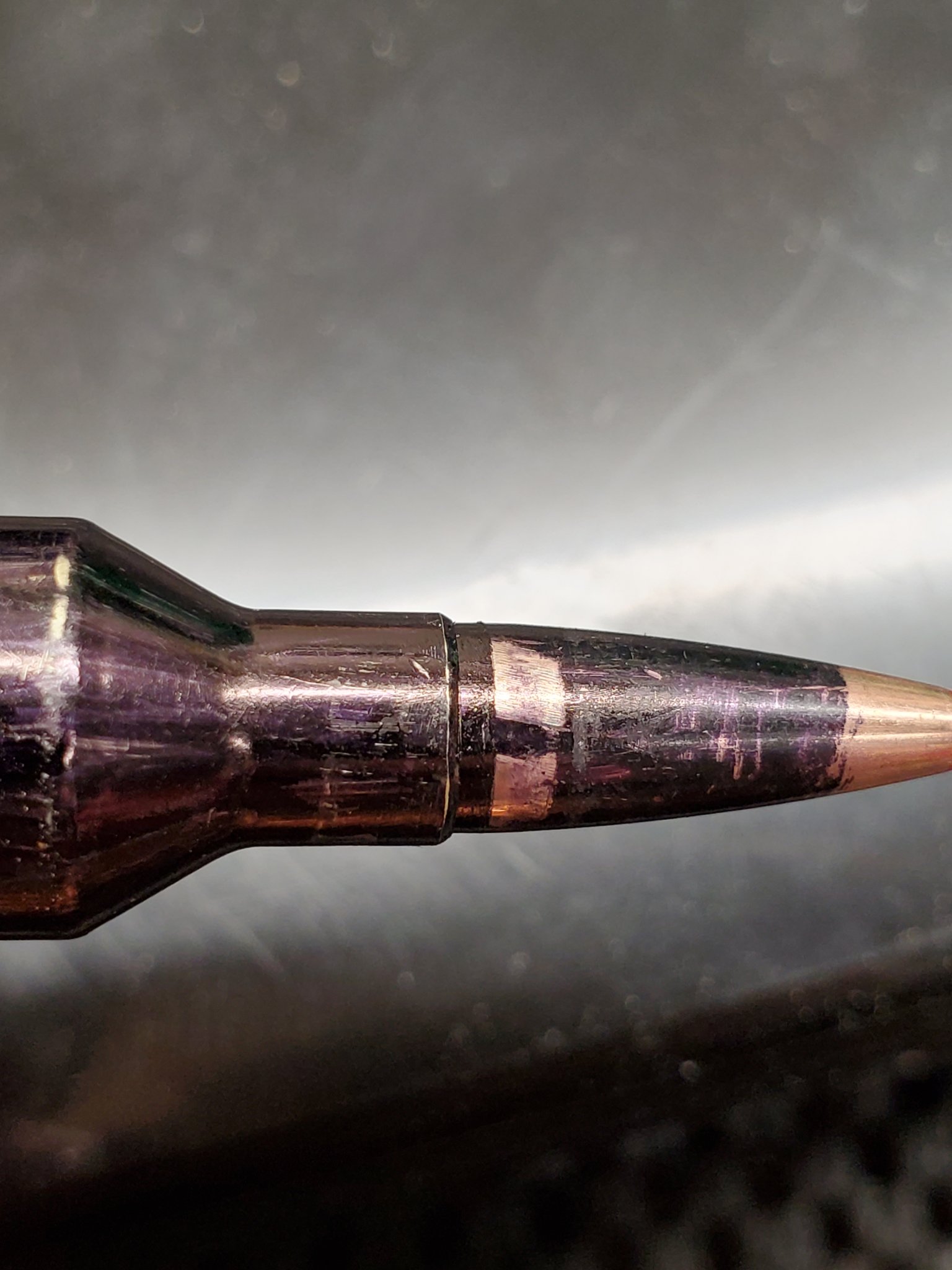

I bet if he can even chamber a round it it leaves marks on the bullet where the lands go to the chamber. Ask me how I know.. Heres the 6.5 PRC barrel that I sent back upon request from the mfg. They recut the freebore. You can see copper rubbing where the freebore area is supposed to be.

This is more than likely going to be his problem as well. People aren’t even considering the poor ballistics it will probably have. The bullet will “slug” up in the bore/throat uneven and unbalanced.
It might shoot a .3” at 100 yards, but .3” moa is not needed at 100 yards. 3/4-1 moa is needed at 1000 yards. Highly doubt any offset chamber will hold even 2 moa at 1000.

So many of the top manufactured barrels look exactly like that Shilen, Bartlein you name it.
Borescopes do not tell this story.
