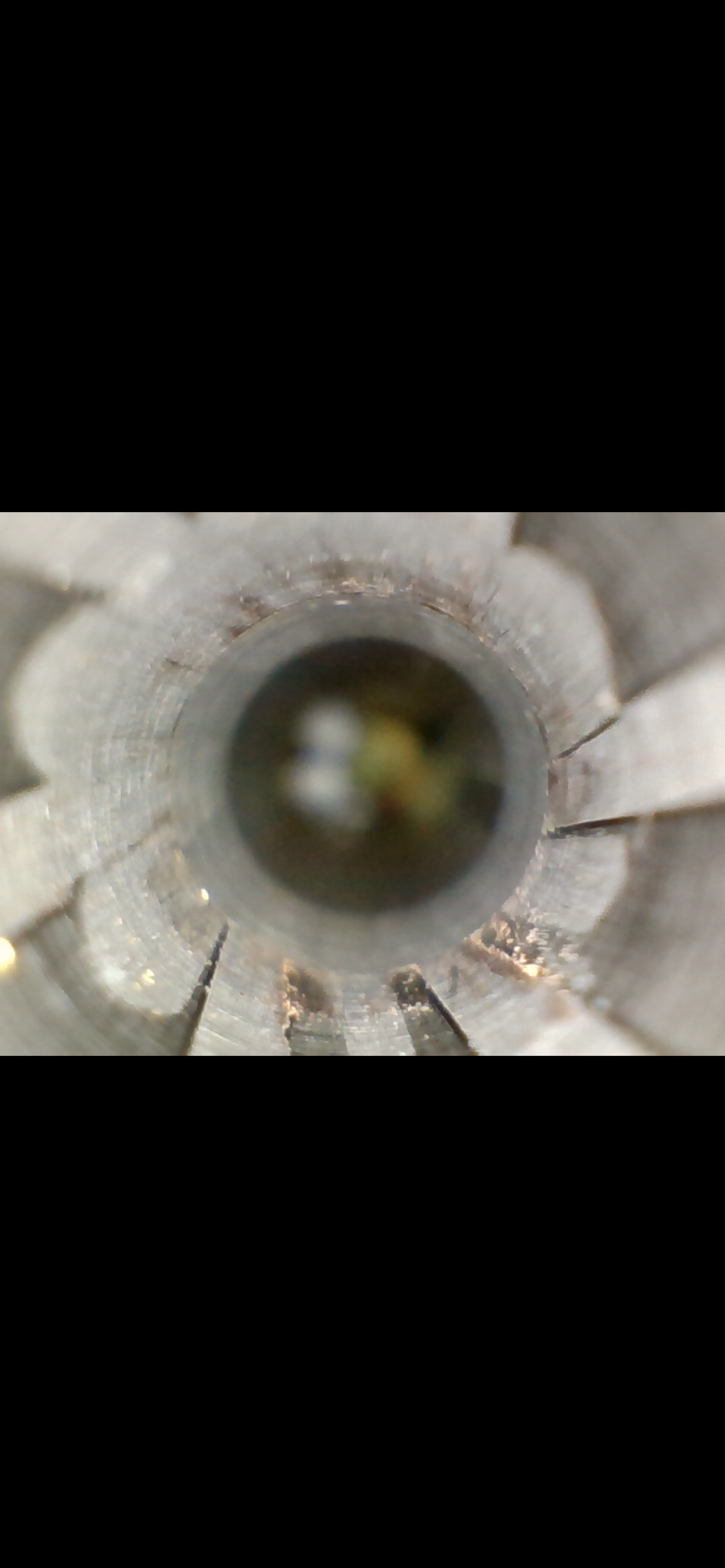

Bad Throat/Barrel?
Tell me why it wouldn’t.
Muzzle exit pressures can affect BC and transonic transition ranges, so why wouldn’t a off set bullet engraving do the same?
If we’re not supposed to worry about a offset chamber, then why do we worry about .005” run out?
If a gun shoots in the 1s or 0s at 100, you think it’s going to shoot worse at 600 or 800 than a gun that can only manage 1moa at 100? You’re talking about magic bullets going to sleep again now.

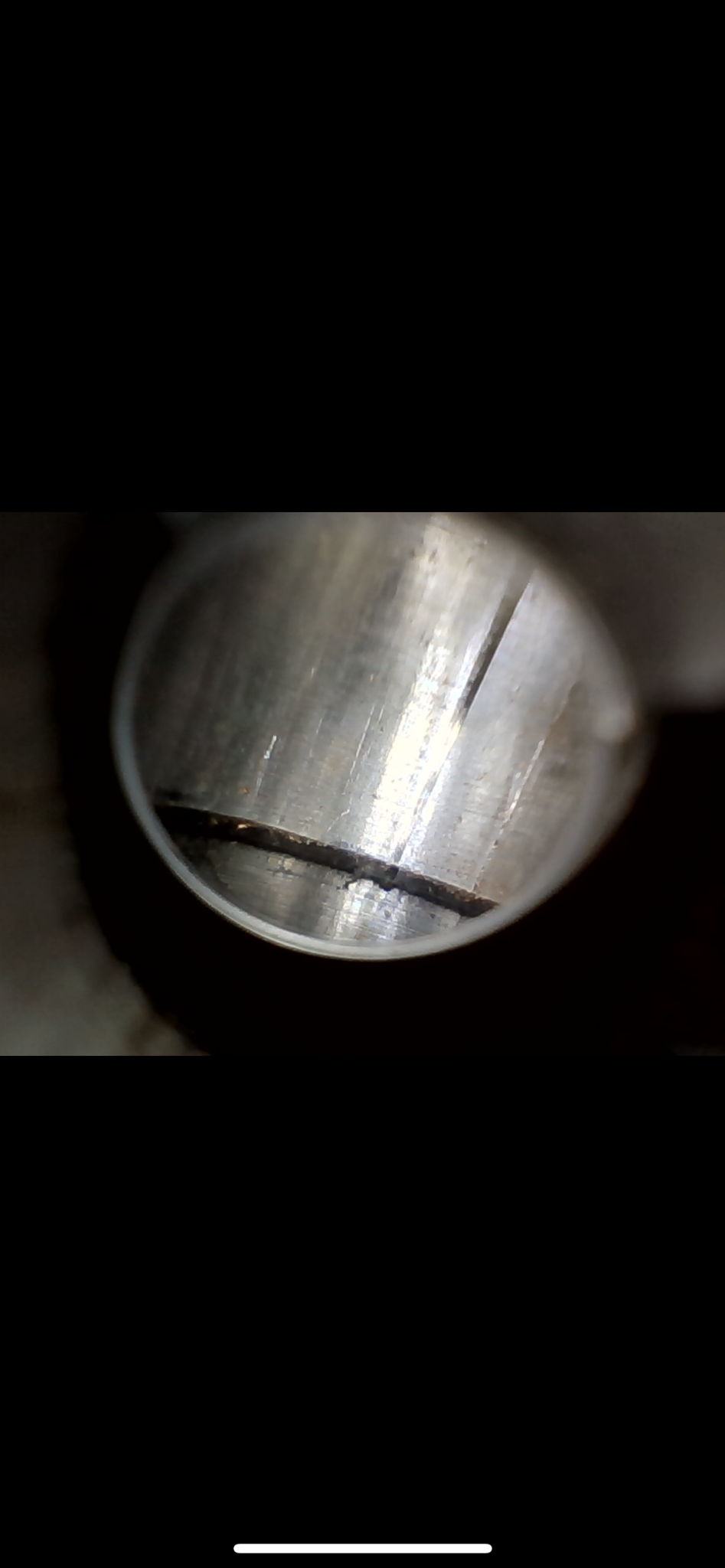

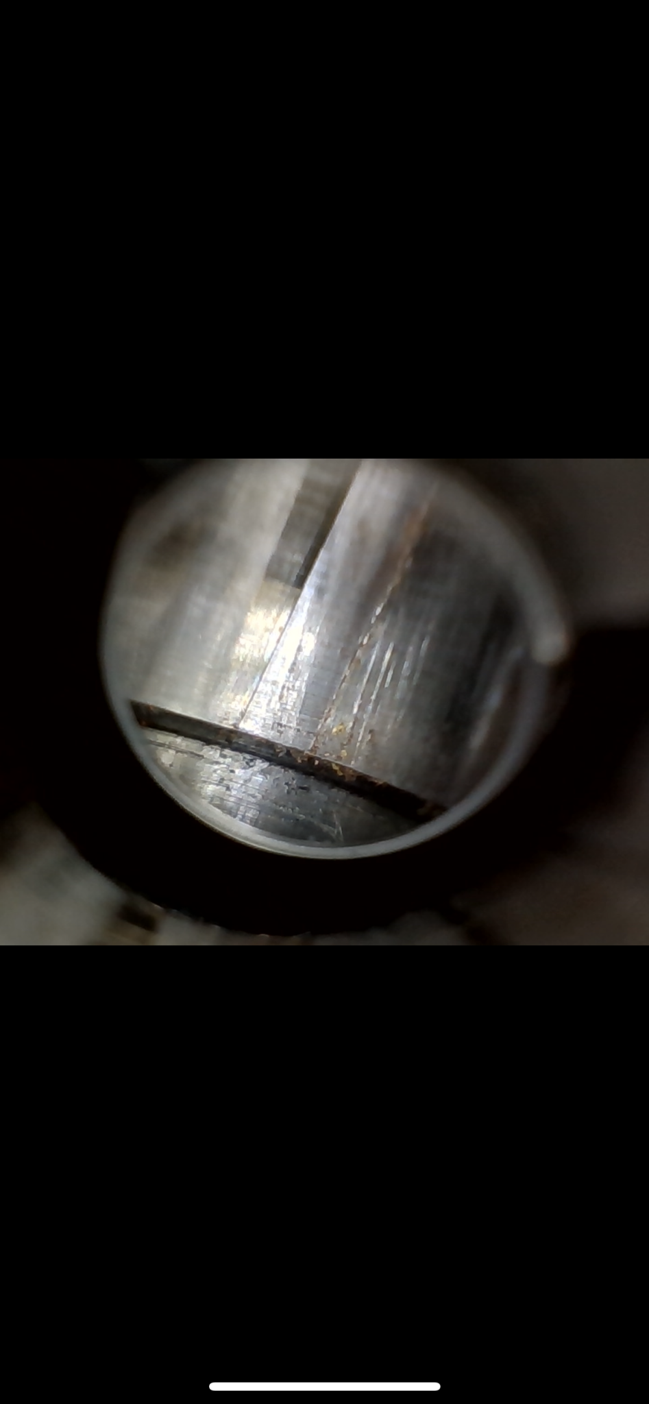

I have a teslong camera, you gotta screw the mirror in and out to get the focus just right and then you will be able to take excellent video and pictures. When u get a chance do that, wipe the mirror odd real good and take more detailed videos of this chamber. From the first video, from what I saw that looked horrible and should be addressed. Let's see another video that more focused
It's a Miculek chamber, you should time it at about 1:00. Would there be a way to push a lead bullet in to get a throat impression?
I have known people to chop the case off at the shoulder then chamber it. Then they would fill it full of lead shot. Then slowly drop more lead shot down the bore and use a rod to pound the shot. It will slowly fill up and expand into the throat and give a decent impression of the chamber without having to use cerrosafe or something like it.
Call them and have it replaced. I had the same issue with my brand new barrel from a good company with carbon wrapped prefits. My freebore/throat was wayyyy off center. They told me that cut the chamber minus the throat and come back after and add the freebore. That’s their issue. They are replacing my barrel but it’s been over a month now and haven’t gotten my replacement barrel yet. I got a Uni-throater and tried to fix it but it was too bad to fix.

Borescopes are a great asset for both the builder/gunsmith and the consumer. With that said, I think consumers also need to put this back into perspective. Is the freebore "off-center"???.......when compared to the bore/rifling.......YES. Are the grooves/lands in the barrel EXACTLY EQUAL???.......maybe....maybe not. Perhaps some others can chime in here.........Ever indicate in a bore (on grooves) perfectly and 1of4 or 1of5 lands was a little different??? I know I have.
Regarding on target accuracy........most reamers have a freebore diameter of .0005" (or smaller) over bore diameter........that's .00025" per side..............so does YOUR reloaded ammo or FACTORY ammo have runout of .0005" or less??? Can you shoot the difference........maybe...maybe not.
I don't have a dog in the fight......but I would contact the manufacturer and confirm with them its OK to test-fire and go from there provided you can take a factory round of ammunition and drop it into the chamber (barrel off the action) and it seats fully without forcing it in/out. This "drop test" at least proves the round is not being torqued/twisted out of alignment when the bolt is closed.
I am here to tell you this issue has been happening for a LONG TIME and most shops (big and small) don't even know it is happening or blame it on "bad reamers". You will continue to see more and more posts like this with the availability of cheap borescopes coupled with 5R barrels with 6 flute reamers. There are a few work arounds that help but are not 100% guaranteed.
I don't know if this is a value add to the conversation or not........just felt like it needed to be said........thanks for listening/reading.

If you bought a brand new car and it leaked oil would you just drive it and see if it got worse? NO you would take it back and it get fixed. But a new barrel your just suppose to accept the gun Smith hack jobbed your barrel and say o well
Some of the standards here is revealing.
You guys would have a custom or trued action, 1200$ stock, 3000$ scope, and a bad chambered barrel and tell the smith to head space that bitch, it’s good enough.??
Im guessing your bullet will be touching lands on one side.
Many on here see borescopes as the bane of devices and the only thing that matters is "How does it shoot" which is kinda true.
Truth is also unless it shoots absolute bug holes you will never know if it is the barrel, the ammo, the shooter, the weather, the bipod, the whatever.
Me personally, im not testing, not taking chances, not settling for shoddy craftsmanship in hopes it works out in the end.
I have sent a barrel back because it had NO freebore. And they fixed it. Send it back, get it fixed. Dont wonder.

I never in my 25 years of messing with rifles, ever heard a smith or barrel maker say offset chambers don’t matter and it’s within their standards.

I think they're all trying to say (in different ways), if you spent extra money for something expensive, you would similarly be unhappy if the quality of work (or craftsmanship) wasnt up to your expectations.
If this was an off the shelf savage $400 bolt action, it could be excusable, but for a gunsmith to deliver this, it really is shoddy work.

We're not debating whether it will send a round down range or not. There's a lot of things that will just "shoot". I almost assembled a C02 powered spud launcher to rain candy on kids during halloween this year. That will "shoot" too, but I wont expect it to be nailing bullseyes at 200 yards.
We're debating whether the barrel was built to the quality standard expected for a $700 barrel. Two very different things.
Except he has no evidence that it doesn't shoot.
He doesn't need evidence. That Is a horrible chamber job and that's that. The gunsmith should pay shipping to get it back to inspect his fuck up and make it right. You have to have confidence in your equipment to win matchs. If you show up with that black cloud of a barrel looming over your head you will do poorly, even if it "shoots"
