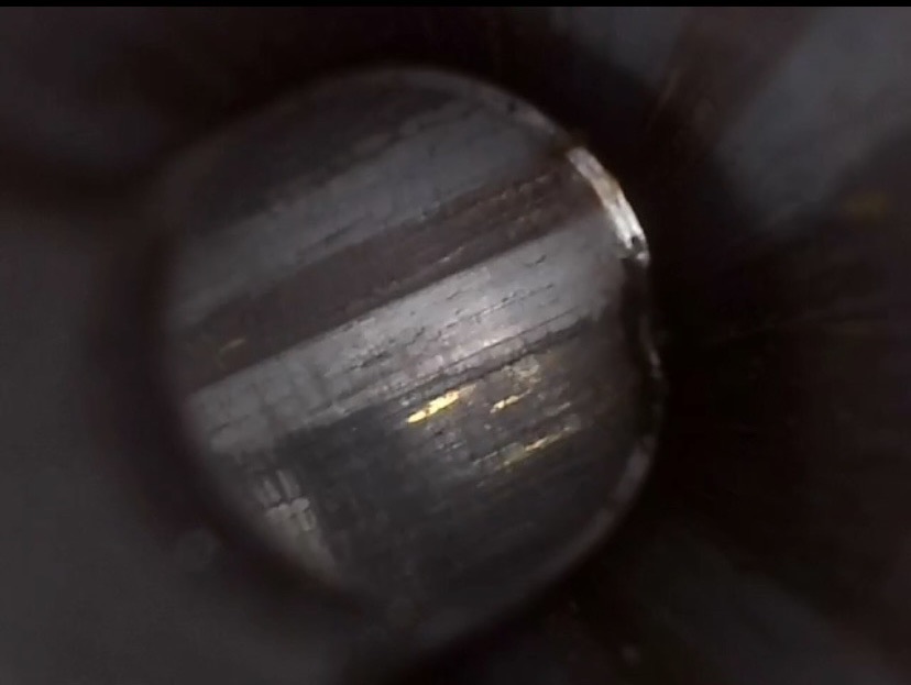

Honest question here, has anybody caused damage by using an undersized nylon brush (6 mm in a 6.5 for example) wrapped completely in a patch with JB and Kroil?
I asked because I have tried it in a few barrels I didn’t care about just to see if I could do any damage and I haven’t been able to (at least that I can see with a Teslong) I have a high round count 22-250 that wasn’t shooting like it had and figured it was probably at the end of its life and I JB’d that thing till my arms were tired and not only was it the cleanest barrel I have ever seen but I can’t find any damage whatsoever and it’s back to shooting great.

Even with the rod rotating....your still not going to stop or minimize the damage with a brush and abrasive.

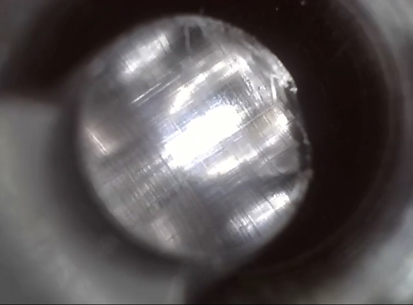

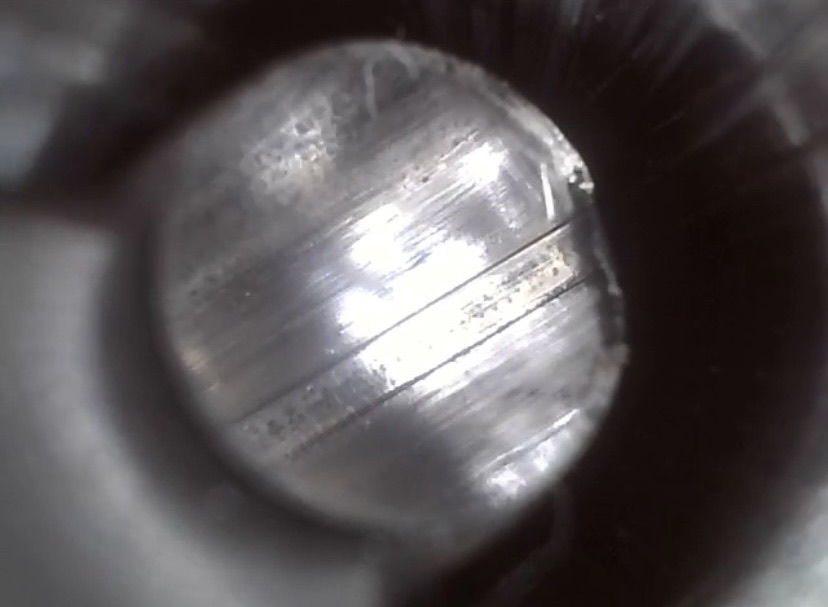

Had a 6.5 twist 22GT barrel start shedding jackets this past weekend with around 1250 rounds on it. No issues prior. Haven’t had a chance to look at it but I have to think the throat is looking pretty grizzly right about now… it saw a steady diet of 3180fps for most of its life.
I had a pretty gnarly carbon ring start to develop around 800 rounds or so - got that cleaned out and it went back to shooting very well for another 200ish rounds. Same deal at 1k, starting getting some nice pressure and whacky consistency, gave it another good cleaning and it went back to shooting well until this weekend.
I’m thinking this barrel is more than likely torched anyway, but my leftover ammo and unwavering curiosity will probably get the best of me and I’ll end up giving it the ol’ razzle dazzle one last time.
Iosso or JB bore paste? If I effectively kill this barrel then so be it, but wondering if an abrasive might clean it up enough to get another couple hundred out of it. Will try to report back once I’ve done some testing.

Just don't use a brush with an abrasive!!!!!!!!!!!!!!!!! You will wreck the barrel.

read my post #83....
Don't use the abrasive with a brush.

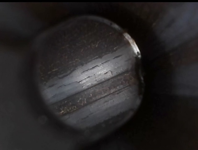

Not so worried about another carbon ring as I am the throat feeling like 100 grit sandpaper… feel like an abrasive may take some of the roughness out of it and at least allow bullets to pass through the bore without blowing up.
I’m positive ~350k RPMs is not helping matters either but I digress… not super concerned about this barrel’s longevity.

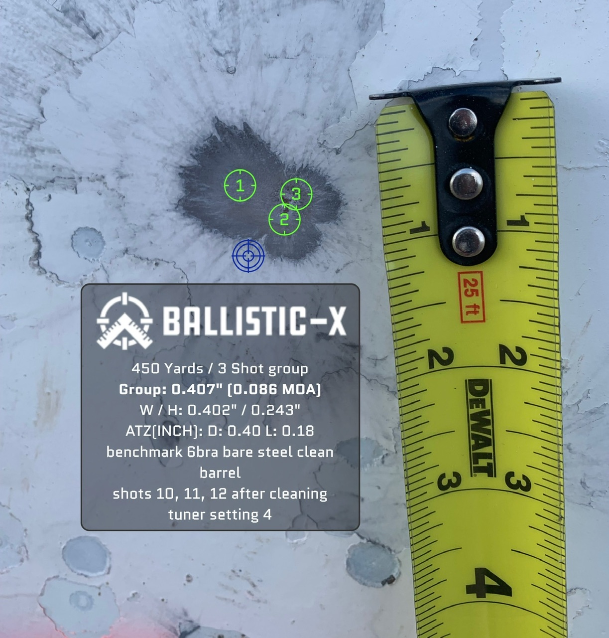

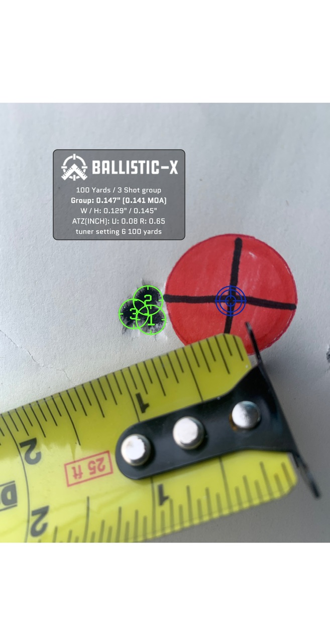

Frank - apologize if you've already mentioned it somewhere, but when you use JB with the PH jag, do you use the next smaller bore size jag, e.g., .223 PH jag for a 6mm bore?
Thanks.
Thanks.
per convo's with Frank, he does not. He uses a slightly oversized patch wrapped around a Parker Hale jag.
@Matt_3479 was this using the method from thorroclean or @Frank Green ?
It was a kind of a mix of a few people’s recommendations.

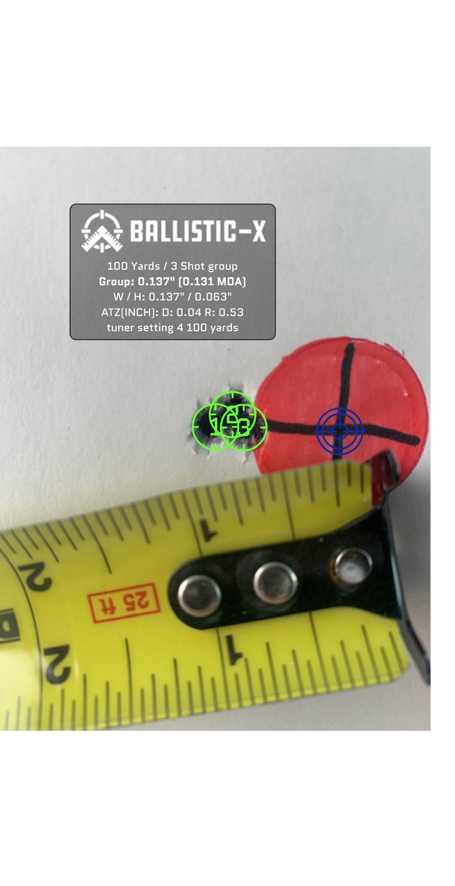

I cleaned the barrel first with boretech products like frank recommended and then dry patches it till it was dry. Used Iosso bore paste for 10 full strokes followed by dry patches and bore scope, then a second patch for 10 short strokes. Pushed a few patches to remove excess followed by bore scope. Then pushed a patch’s of boretech back down to remove anything left, and finally an alcohol patch and 2 dry patches. Looked at the bore scope for every stage.
Before anyone tries this please know, my barrel I was ready to throw out. I’ve never used abrasives before. This is exactly 1 example and that’s it. Please follow steps by the people that have significantly more experience with it and be careful. While I had success I could of easily made it worse according to much more experienced individuals.
