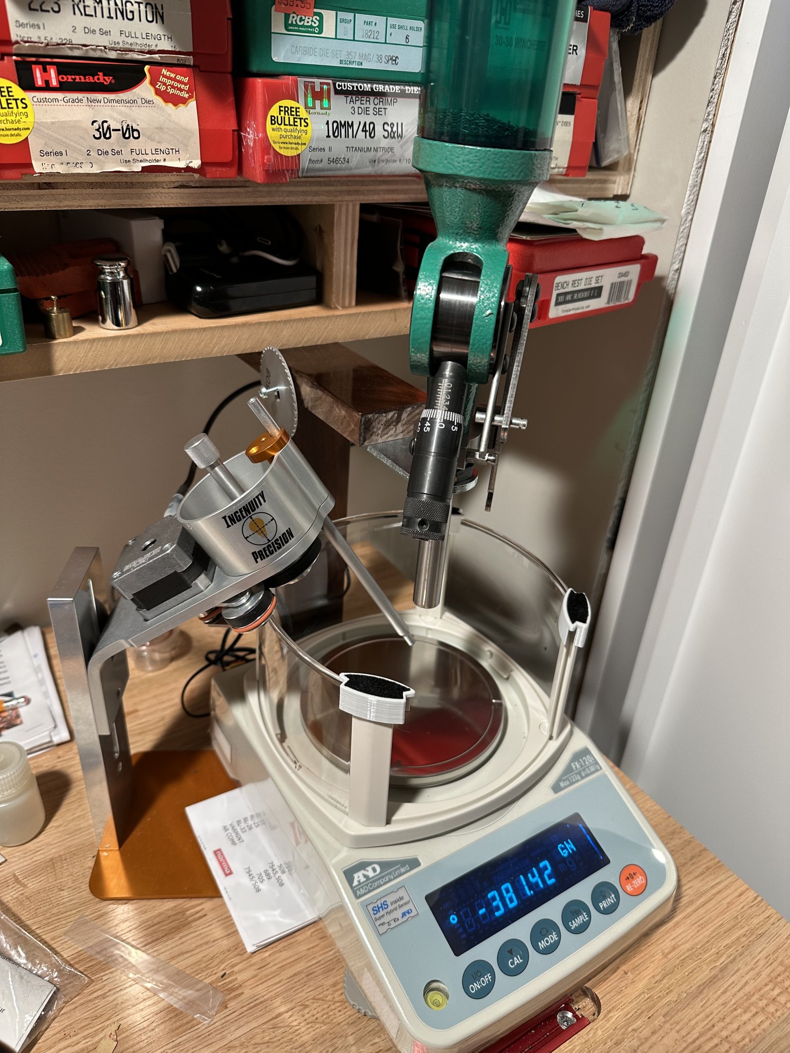

I got tired of waiting and used some scrap walnut to mount my 40 year old RCBS thrower over my scale. Works great! Now if I could just figure out how to motorize it 🤔. The contraption on the right side of the thrower is a Hornady case activated powder drop; fits on the RCBS thrower perfectly and I use it to load ball powders into 5.56 and pistol rounds on my T7 press. I have a silicone cup that I use to drop the powder in with no splash. I rubbed the inside of the cup with graphite to keep powder from sticking.
Have you figured out how to motorize your powder drop since you first made this post? Or enhanced your process with it at all?

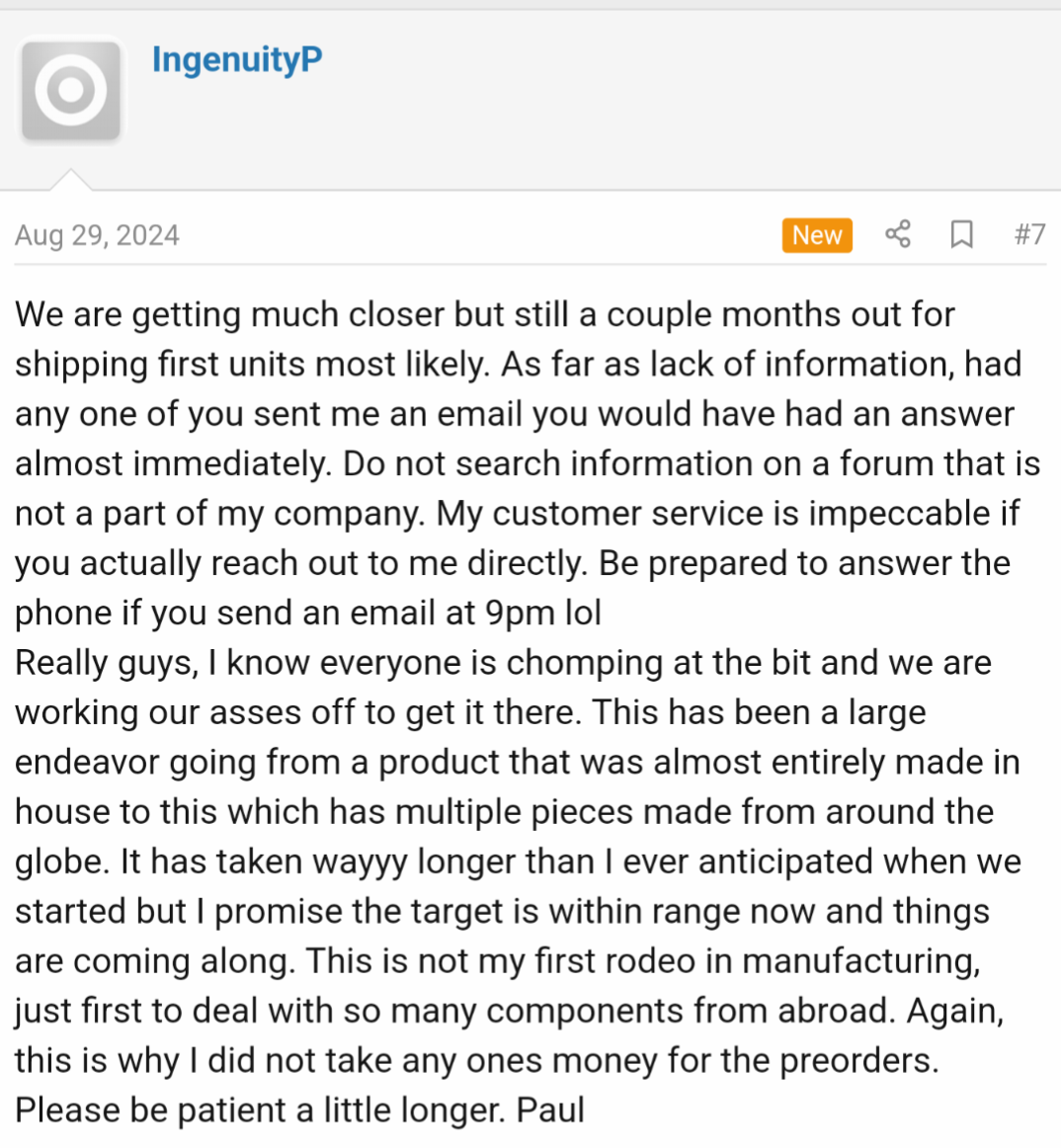

My December 2024 might be off... I have now moved my predicted ETA to February 2025 😬
I know a few of you guys will be disappointed by the delayed news, but it's not the first time in the gun industry, or even the scale/autoloader industry.
I'm not in on this product as I bought something to scratch that itch already, but it looks sweet and we need more options, especially if it's priced right.
