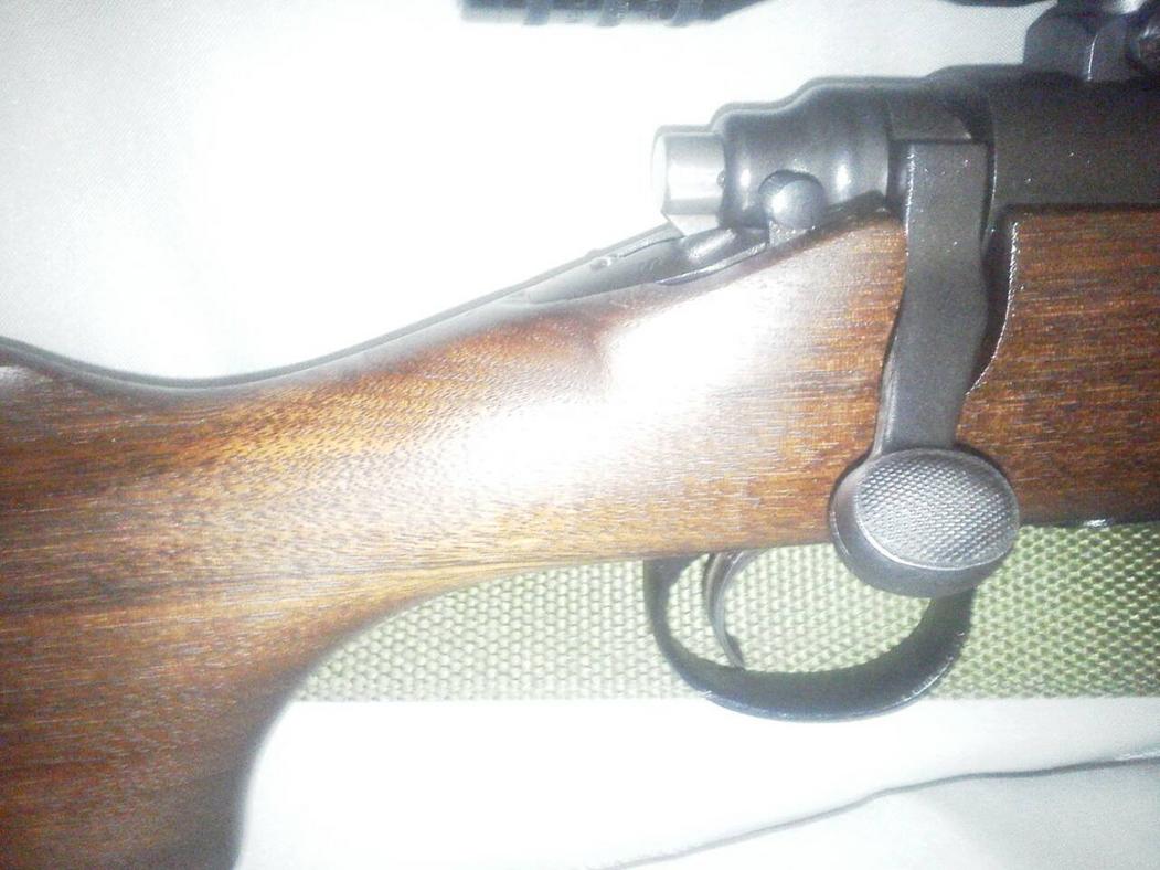

Here's my addition. I hope to get my M40 finished this year. I have all original stock, barrel, scope and mounting hardware.
Great photo. There's definitely some great information fueling discussion, on this forum, of late.
Would definitely like to see some detailed photos of your original stock and barrel/stamps.

The 'Short' Bolt Shroud...
Bolt shroud on mine is .885"
Sent from my C771 using Tapatalk 2
Culpeper,
Thanks for the reply, and I have to ask, is this on your SSA model?
I'm pretty sure the SSA models retained the standard length bolt shroud and the rounded knob safety, though I may be in error.
Regardless, it's very useful information.
Sorry, it is .850"
Edit: See post #1072 and 1076
