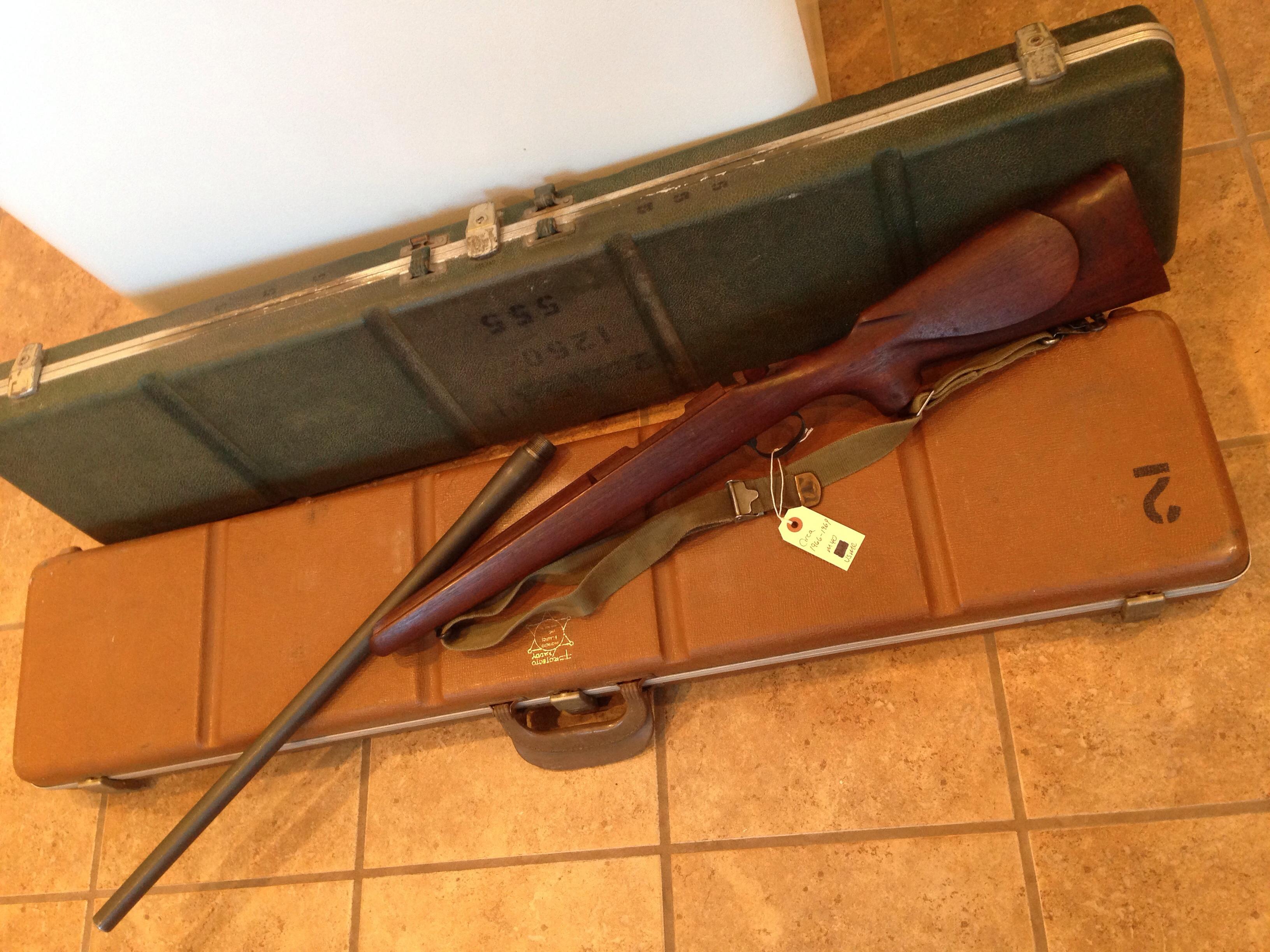

A little patience and persistance paid off. Much appreciation to the individual opened the door for me.
All original take off parts from a well know individual within the Vietnam era sniper community whom asked to remain anonymous.
40X base was also included but I forgot to include in the picture.
Mescabug.....regarding the barrels....I would assume so. I by no means would consider my self an expert by any means but from what research I have done and the people I have spoken to, that is the assumption I have come to.
Also the Varmint Specials like you have listed in the pic are 22" vs. the USMC 24".

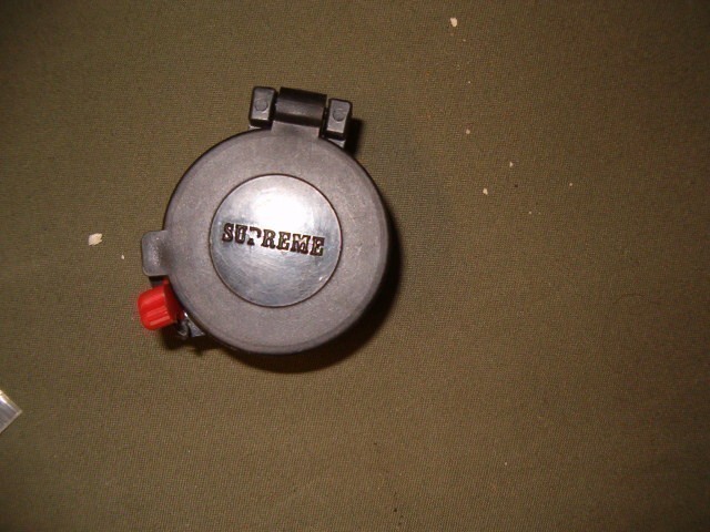

M40 scope covers
Anybody knows what type/brand of scope covers was used on the M40? I've seen rubber bikini-style caps (from Redfield) but according to Chandlers @ IBA, they're no good...
  • info_scopecaps.pdf
Out of the box they came with cheap plastic covers that connect with a rubber band supplied along with the scope. Storm King, Storm Queen, and Ka-ram-ba covers were additional offerings from the catalog. What Mescabug posted above are the stock covers. Butler Creek came after the M40. IBA tends to look at the whole M40 project as one. I have the Badger repro base and rings. They were copied from a late model M40 set up. EDV made the flip up caps that were used on the M40. Not Butler Creek. Butler Creek merely bought the operation and rebranded the flip up lens. Didn't Toki post images of an EDV set he got off a scope on Ebay?
EDIT: Oops missed the question. I've seen that page from IBA before and SUPREME was something Butler Creek put on their lens covers. They are no different than the current BC covers without SUPREME on them.
I got the Redfield covers with a scope I bought. Now Part of an XM21 /AR TEL build I put together. There are also the Vissing marked flip caps documented in Senich's book. Someone has vintage storm queen caps on EBay. At $175.
Storm Queen covers for the REDFIELD Gen.-1 ONLY
STORM-QUEEN Photos and description, courtesy of eBay... (separation of content by me)
"Offered is a pair of original, Scarce as hen lips USMC M40 Fit Redfield Sniper 3x9 Storm Queen lens covers . As you can see in the pics they are not out of the box perfect. A few nicks & dings. As found from an estate of a well know Texas USMC reserve sniper school CO in the 60s.
I need to make this clear to anyone considering bidding. These covers will not fit a commercial Redfield accutrac 3x9. Only the original green & early F series blued scopes. The same rear eye piece 7X dia as the USMC 4X Kollmorgen. The original mid 60s green M40 redfield has a 2 piece eye bell. Exactly the same dia as the 2X7 accutrac. Look at Senichs book closely the rear eye piece is in 2 parts. A hermetically sealed glass capsule to prevent fogging.
The commercial 3x9 accutrac eyepiece has an extruded bell formed into one solid piece & the glass is held in by a snap ring or a threaded ring. Later used in the late 60s & 70s as replacements. Those later scopes used flip caps. The front is the same 40MM on all m40 scopes,
If your scope is not the 2 pieces eye bell the rear storm queen cover will not fit. Just wanted to point that factoid out. Email me for clarifacation. The covers are super rare & were meant to protect the tombstone range finder from melting & becoming un bonded. As you can guess they were the first thing to get discarded. (Emphasis is mine)
Pictured is a 3x9 green M40 scope for comparison. Not for sale. It shows the covers on a original US issue M40 Green Scope .
It may be years before you see another set for sale. Ask questions. Scarce. No reserve ... Someone will own them. Again I don`t want the high bidder to call me saying the rear cover does not fit. to make it clear these covers only fit the green & blue EARLY F ,E. & P series m40 scopes. Not the later third issue scopes. If you have a greenie or two piece blue. This is your auction.

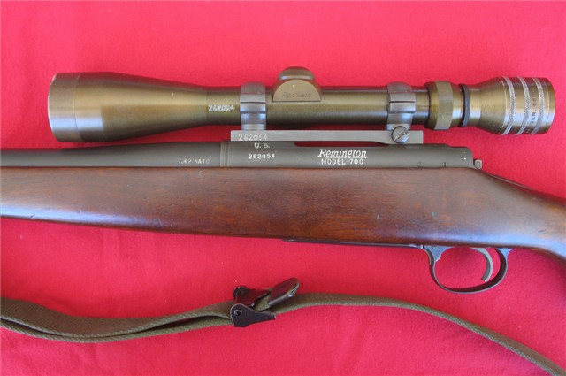

Q. Re: The screws for the m40 redfield mount(s)
We know that the early Redfield 4 screw rings sets, identified on the bottom with a '64,' use standard slotted-head screws.
Q. At what point, if ever, are the Redfield mounts, on the M40, secured by TORX and/or Allen head screws?
Note the early style tall/flat sided safety (barrel appears to be stamped 7.62 NATO, on left side):
CORRECTION:Mount identified as a BADGER reproduction with Torx screws.
Just a piece of M40 gun porn:
CORRECTION: Scope is Gen.-1 with hybrid ocular piece and power ring.
Bolt_trash....in regards to the Torx screws. They werent used on the Vietnam era rifles. I have a complete folder of pics of the rifle you posted pics of with the red back ground.
I bid on that exact rifle about two years ago when it was posted on GunB. This was back before I had really studied the M700 in depth. This rifle went for well over 10K. Im glad I didnt win it. I wont get into the details but one thing I can tell you is that it had a Gen2 Acu Range that was Anno's Green. The rifle its self looked really nice but the Torx screws and the Green Anno'd G2 are extremely suspect.
I would post more pics but Im a little challenged when it comes to posting in full screen.
My comments in 'Dark Green.'
I was pretty sure of that, but still wanted to run it through the SH_M40_ Fact Checkers. Thanks!!
The green Gen.2, like the Torx screws is a dead giveaway. Absent all of the other details, the rifle and scope mount do look pretty straight-up, even with the white chalk (?) highlighting the stamps and lettering . If you can mentally get past the green Gen.-2 while looking at the side profile photo, the rifle does have really nice lines. Maybe it is just really good photography.
Send me a PM and I'll see if I can help you.
Torx or Allen head screws werent very popular in those years. Flat heads were supplied with all Redfield products. I've got an original Redfield 700SA base, box is dated 1973 and it comes with flat heads. Another one (for a Ruger M77) dated 1977 with Allen heads. I guess they made the switch somewhere mid 70's when Allen heads become more popular.
As for that M40, first time I see a green 2nd Gen. There is no real explanation as to why it was anodized green instead of satin black.... Something smells fishy. Not saying it didnt happen, but extremely remote IMO.
I saw those Storm Queen rubber covers on eBay. Didnt thought about posting it here, at 175$ it seemed like a joke. I didnt bother.
That's not a Gen 2. Turret caps are flat, bell is a separate piece (you can tell because it's a different color, therefore a different alloy), BUT the zoom ring is a later version.
Just a piece of M40 gun porn (ignore the green Gen.-2 [HERETIC- BURN THEM!!]):
That is not a generation 2 scope. Flat turret caps, separate objective bell (you can tell because it's a different color, therefore a different alloy, therefore a separate part), but the actual zoom ring is suspect, along with a later eyepiece.
The Badger base/rings is the one that doesn’t use flat head screws.
EDIT: I installed a Leupold Rifleman 3-9x40 using the Badger base and rings. The base came with flat head screws. The rings have allen head screws.
BTW, the Leupold Rifleman appears to be the best "new scope" alternative IMO. The RBR reticle (magnification [MENTION=97659]6.5[/MENTION]x) is spot on at 200 300 400 500 600 holdover with 600 being just below the heavy picket. This scope has friction adjustments like the original Redfields. The holdovers can be tuned for any load with a 200 yard zero by changing the magnification.
