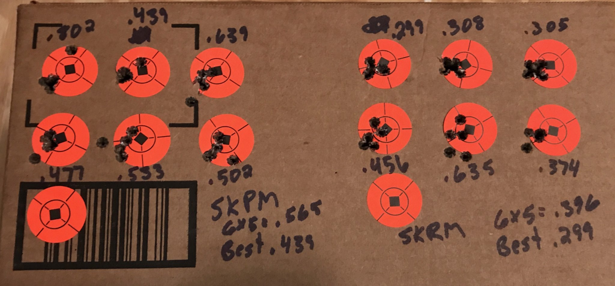

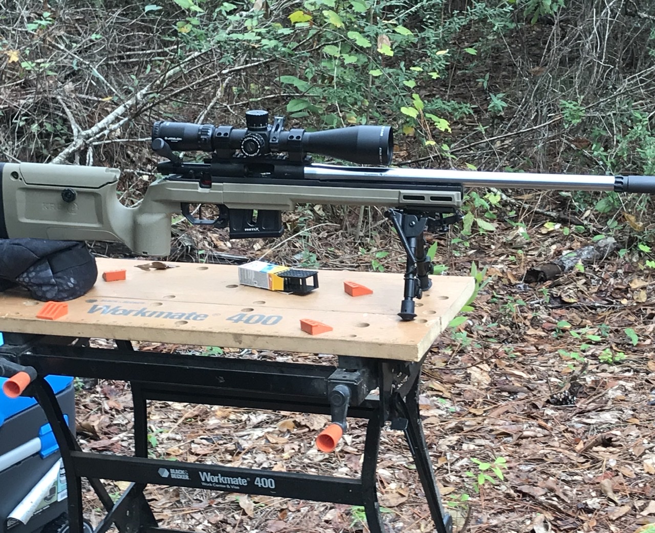

My RimX/Green Mountain barreled action came in today. Put a TT Diamond on it and put it in a Bravo. With the storm coming to the west of us conditions were not great but shooting at the house I’m blocked enough to wait out the bad stuff.
The good
1. Machining looks great
2. Shows potential with Eley Action that I have a pile of.
3. Action is smooth and feeds great
The bad
1. About half the rounds in every mag have lite strikes. Recock and fires every time.
2. The Eley Action that it likes you have to bump the bolt forward to chamber. I know this chamber is set up for SK/Lapua. If
it shoots it good it doesn’t bother me.
3. Tried two SK made ammo and it shot like shit. Over an inch with both after running two rounds down the barrel.
B83F7328-9952-4BB5-98C9-CC814A4D8DBF.jpeg9C4E95B3-2060-477B-861F-DFADDB2C3D7C.jpeg C517DC96-6450-4ACA-8688-A11A01D3FE69.jpeg
The two ten shot groups are actually 11 because I aimed at bullet holes. Top left in the bottom and bottom left on top. Included the aiming holes in the group size. Wind got worse before I shot the 6x5 so I don’t think is bad with a hurricane currently hitting my state. I think it will do mid to low .3s in good conditions with that ammo. 52 yards

I'm running a .223 suppressor on mine rather than my rimfire cans. It adds weight and more resembles my match rifle. I'll have to take it off and see what happens other than my neighbors will now know how often I'm shooting.

View attachment 7442311View attachment 7442314 View attachment 7442326

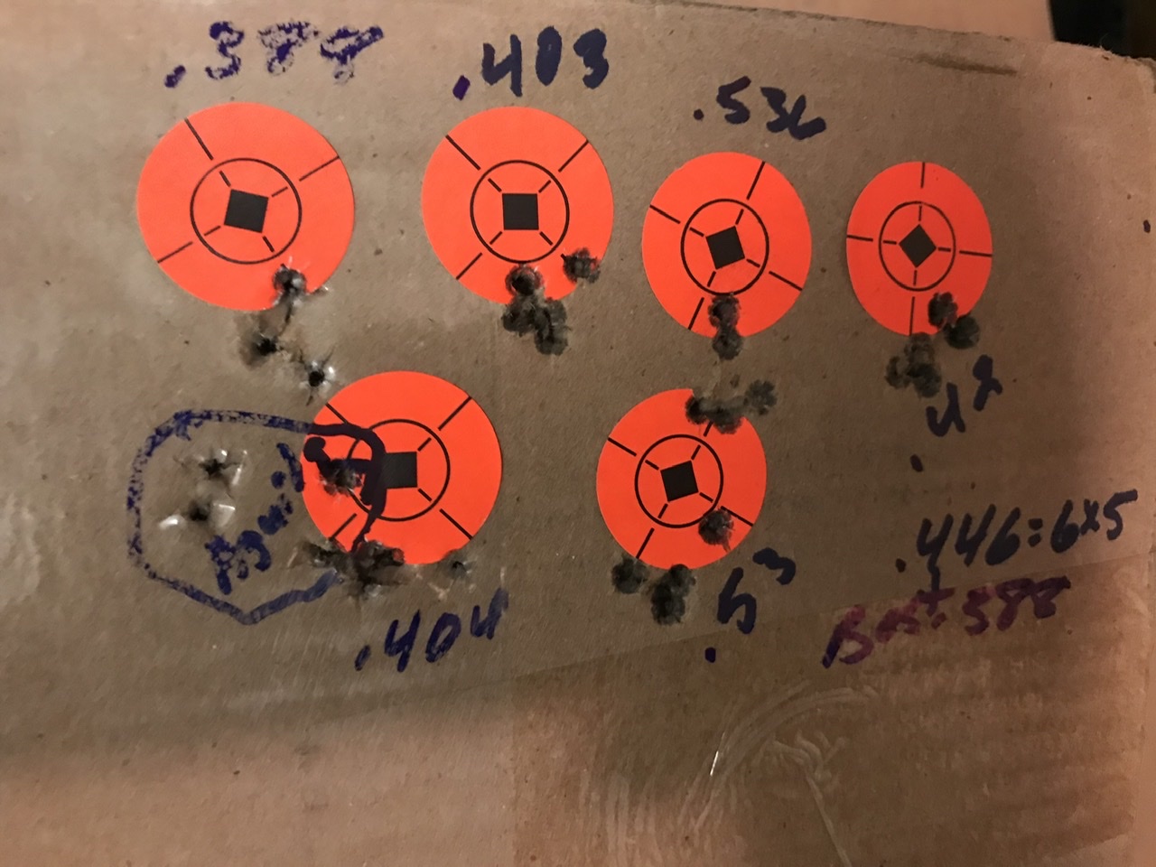

The lots I tried shoot good in all my other rifles. Same lots I posted my 6x5 targets with. Was very surprised to see inch plus groups with them. Went back to the Eley and shot some .2-.4 inch groups after that. I only have around 50-100 rounds through the barrel so I’m sure it will get better.
I have a bunch of ammo/lots that shoot great in one barrel and doesn't in the other. I have $5000+ in ammo ive tested and shot since March/April in my RimX. Countless lots of SK+, SK RM and CX. Ammo is the single biggest factor in 22lr. You need to test lots of CX, SK RM and SK+ till you find some of each that the barrel likes.
I had some SK that shot mediocre in some of my RimX test barrels and shot in the .1's in another barrel. Welcome to 22lr
I have lots of ammo/lots that shoots great in one barrel and doesn't in the other. I have $5000+ in ammo ive tested and shot since March/April in my RimX. Ammo is the single biggest factor in 22lr. You need to test lots of CX, SK RM and SK+ till you find some of each that the barrel likes.

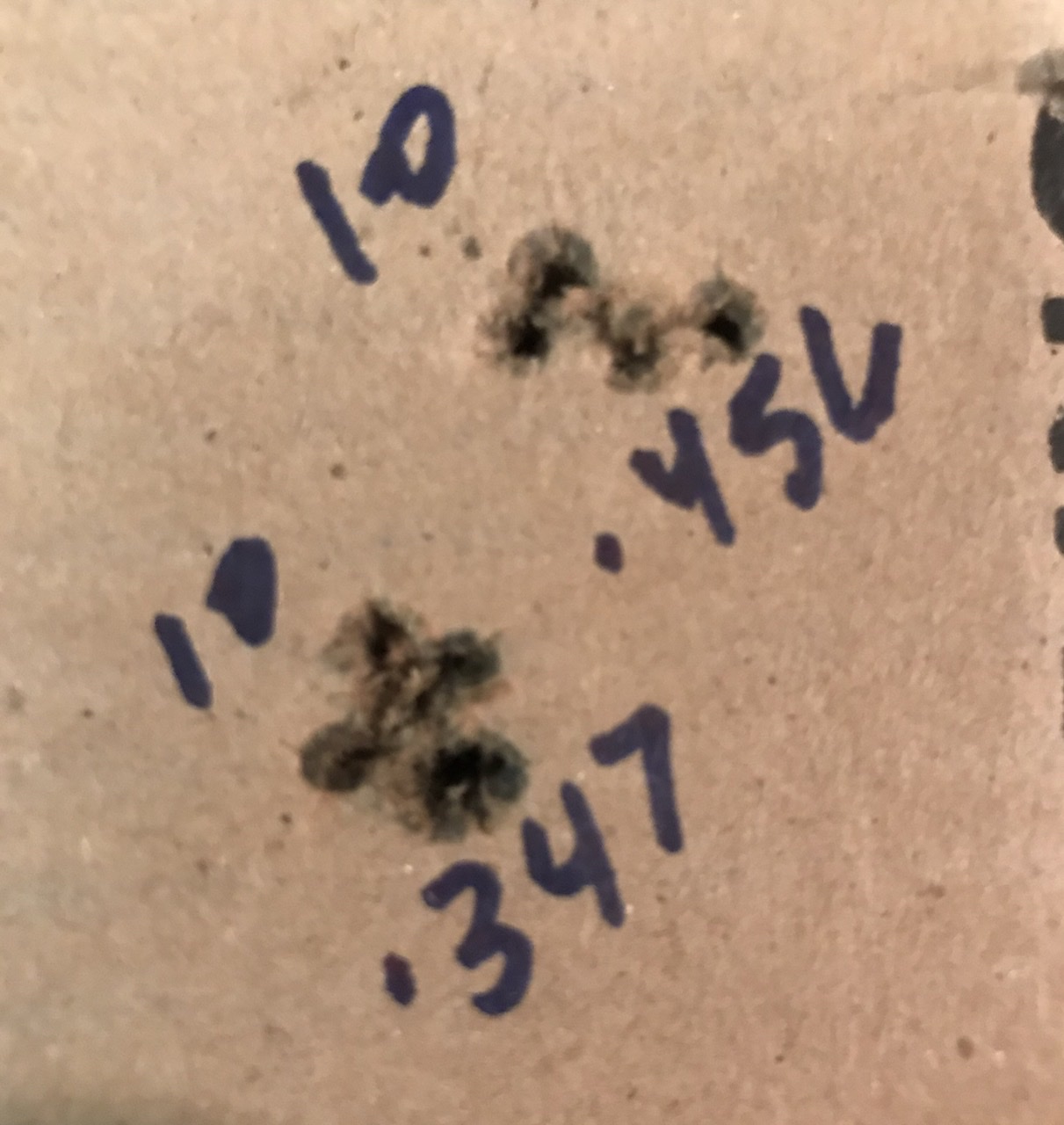

Ran a 100 or so more rounds through it then shots some groups. This gun will definitely tell you what ammo it doesn’t like but I have not found ITS ammo. Still having a lot of lite strikes don’t know if it’s gun or trigger and some hard to chamber rounds. Seems to not be a problem with SK or I’m just not noticing it as much. Maybe it needs a little mag tweaking even though the rounds I watched are going straight into the chamber. Did better today with SKRM but not what I will call good by any means.
Those groups are not bad to me. You just got the one shot curse.

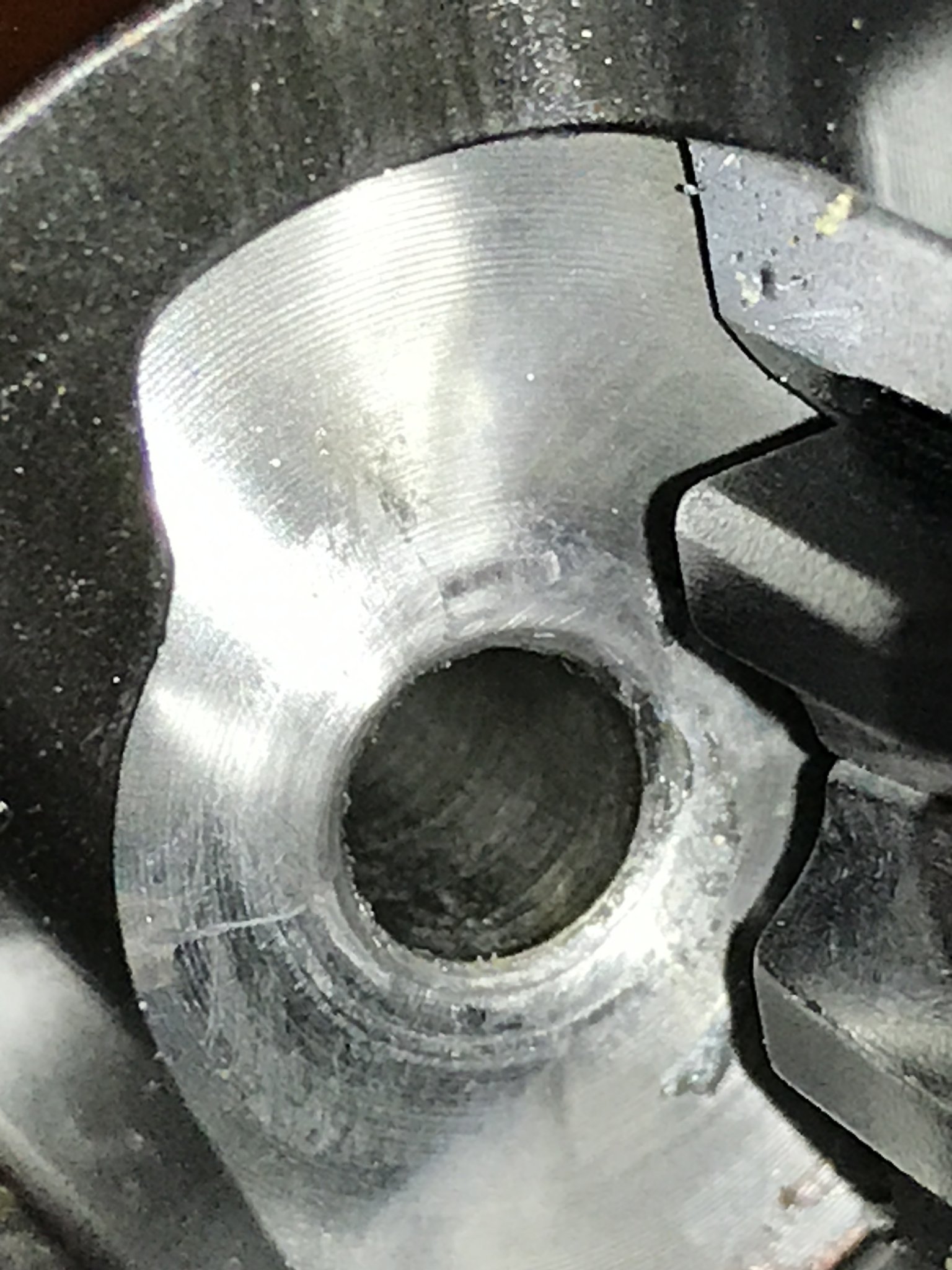

This is what I was talking about earlier when I referenced a tuning relationship between the tensioner and a chamfer on the breech of the chamber. I would try taking your tensioner out and beveling the 90* corner on the bottom of the hook. Where the rim pushes the tensioner out of the way. It might also be worth looking to see if the tip of the tensioner is making contact with the case wall like flat flatland was talking about. Just shortening the tip of hook.
And then there's the chamfer. The sharp edge on the back of the chamber can also bind up the cases and keep them from sliding up the bolt face. If you can pull your barrel you can bevel the that sharp edge on the back of the chamber.
Are the case walls of those rounds you ran through the gun dented?
Chamber has a radius. Enough so it leaves a small round belt on the case. No dent that I can see.
