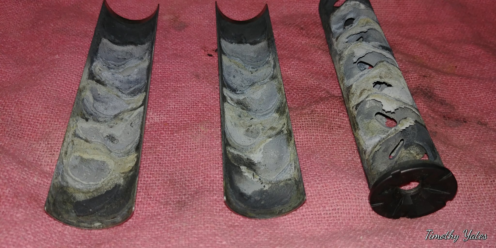

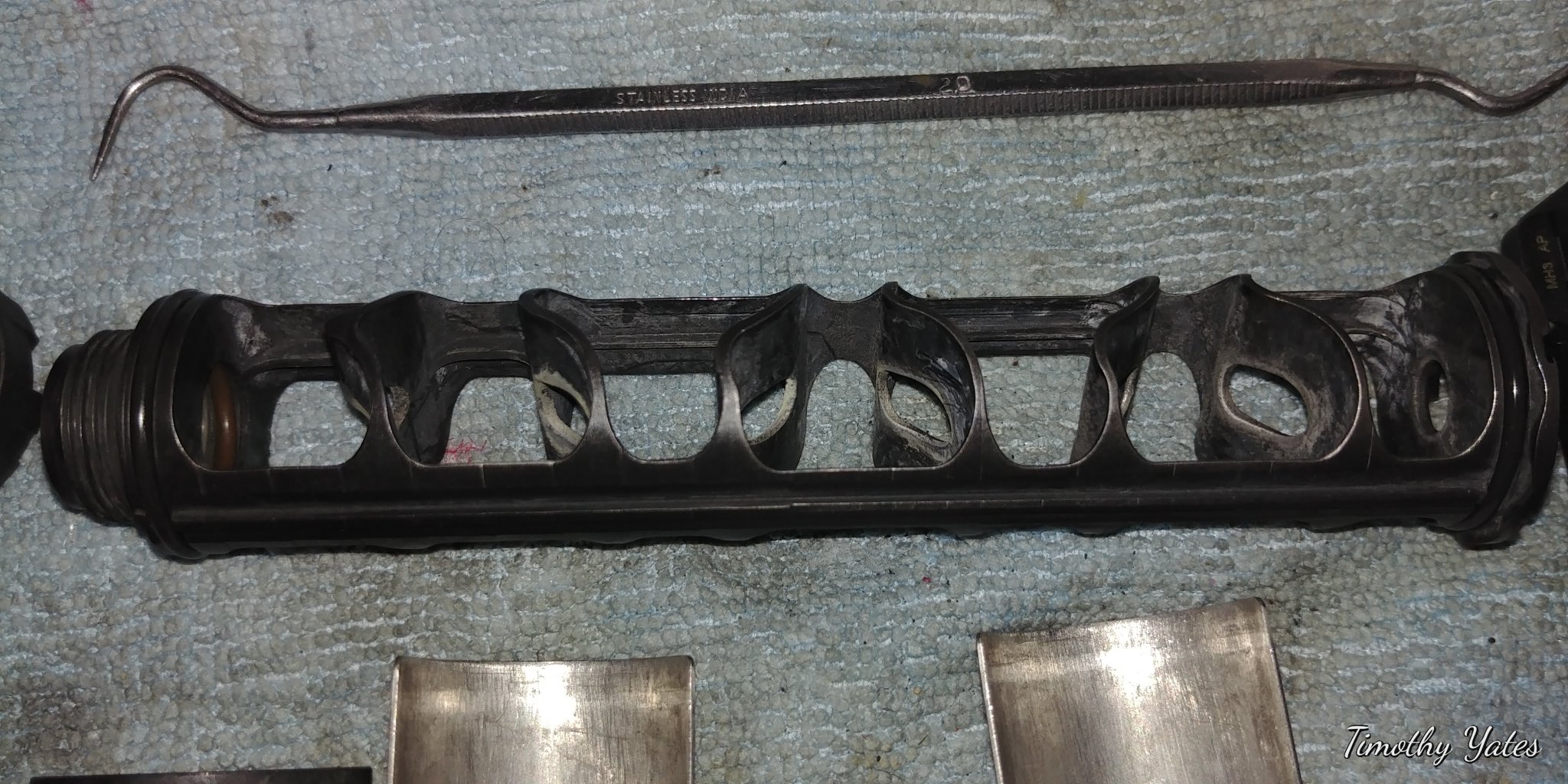

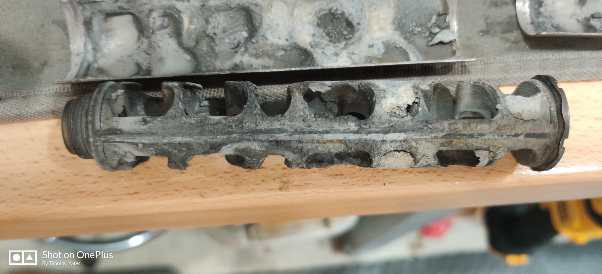

You know you should have cleaned sooner when it takes a full day with different methods just to get your suppressor apart and discover it looks like this inside. When a suppressor gets build up like this it has to have an affect on accuracy either good or bad.
But with the right cleaning solution it can be made new again.

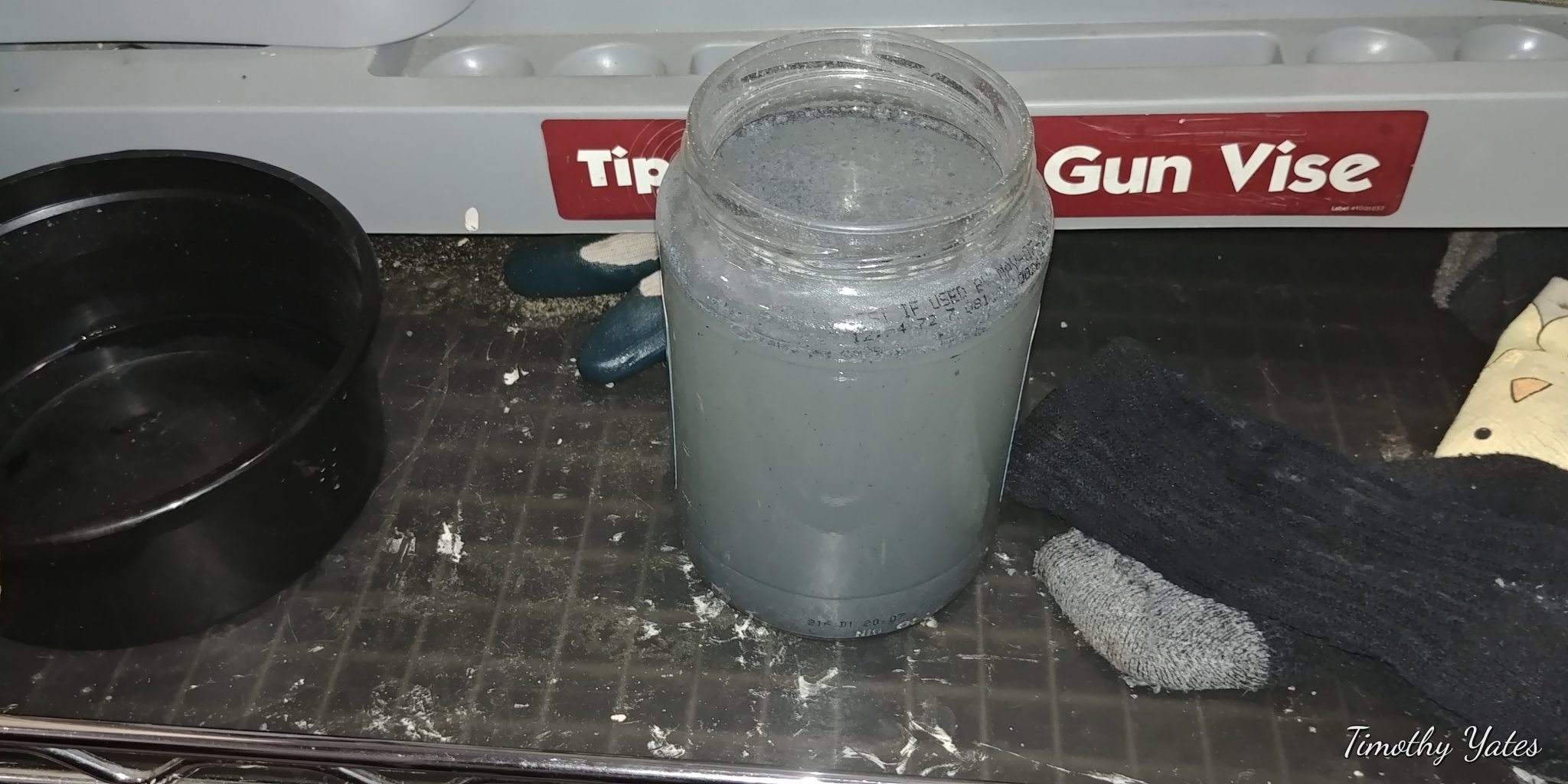

I just stripped my Oculus, baffles are soaking in CLR. What are you guys using to clean the tube and cap? Just a brush, pick and vinegar or something else? Always looking for a better/easier cleaning option, I never put my tube in CLR or UltraSonic because of cerakote.

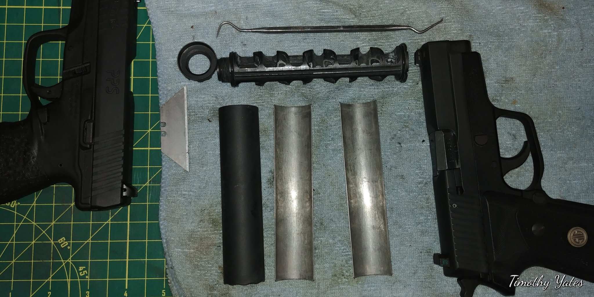

Here's a little extra candy for your viewing pleasure. Had those two laying out, I said ahh why not include them too.

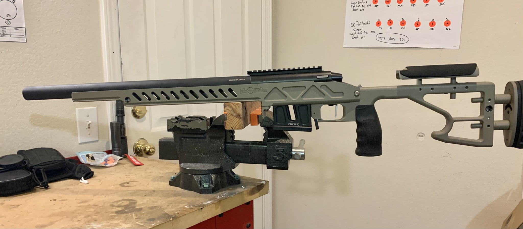

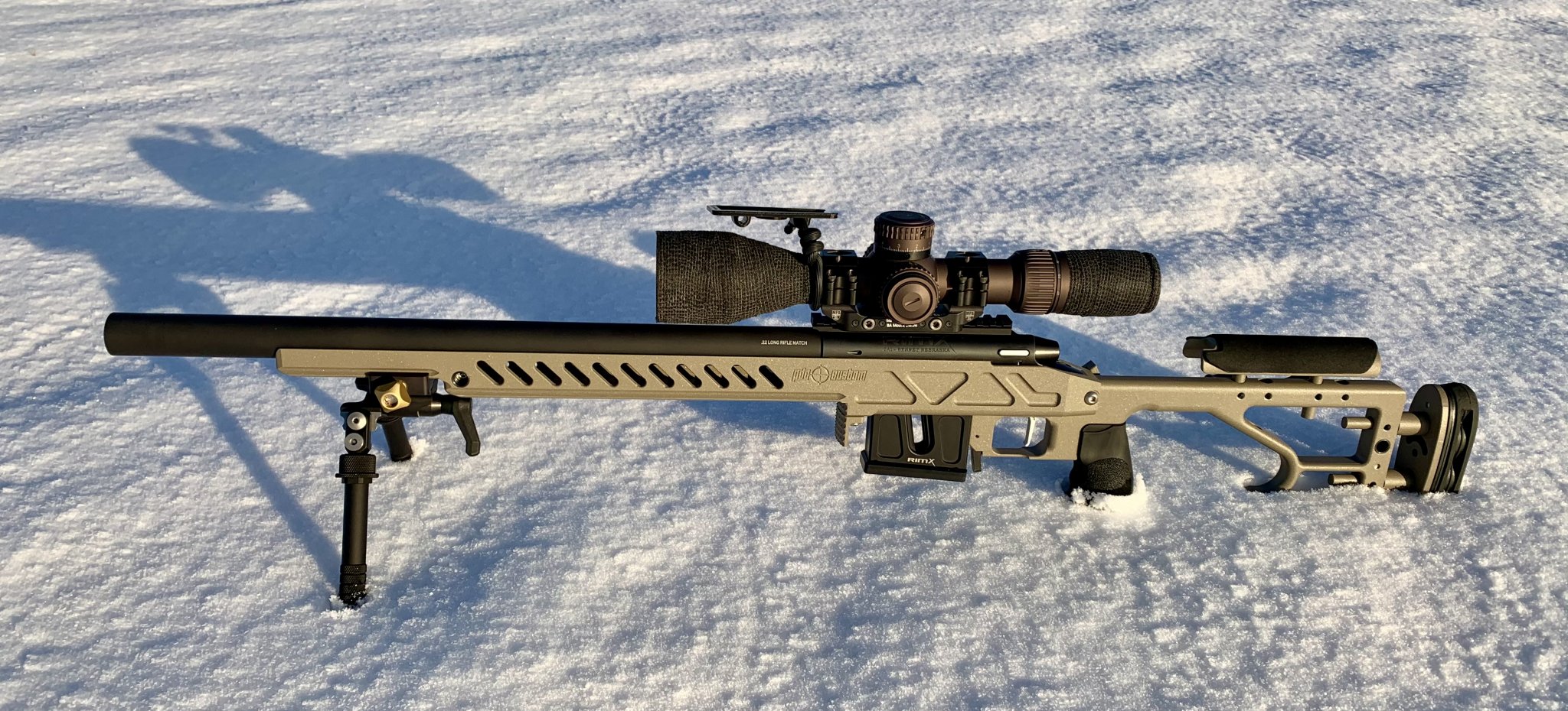

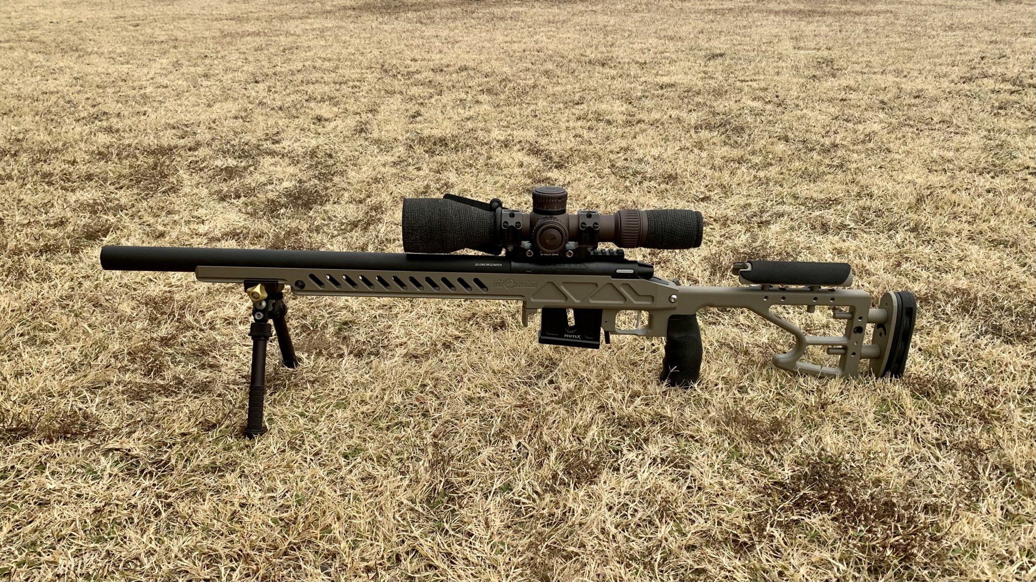

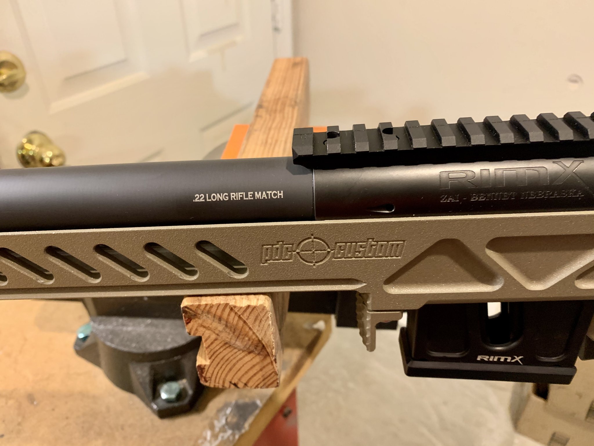

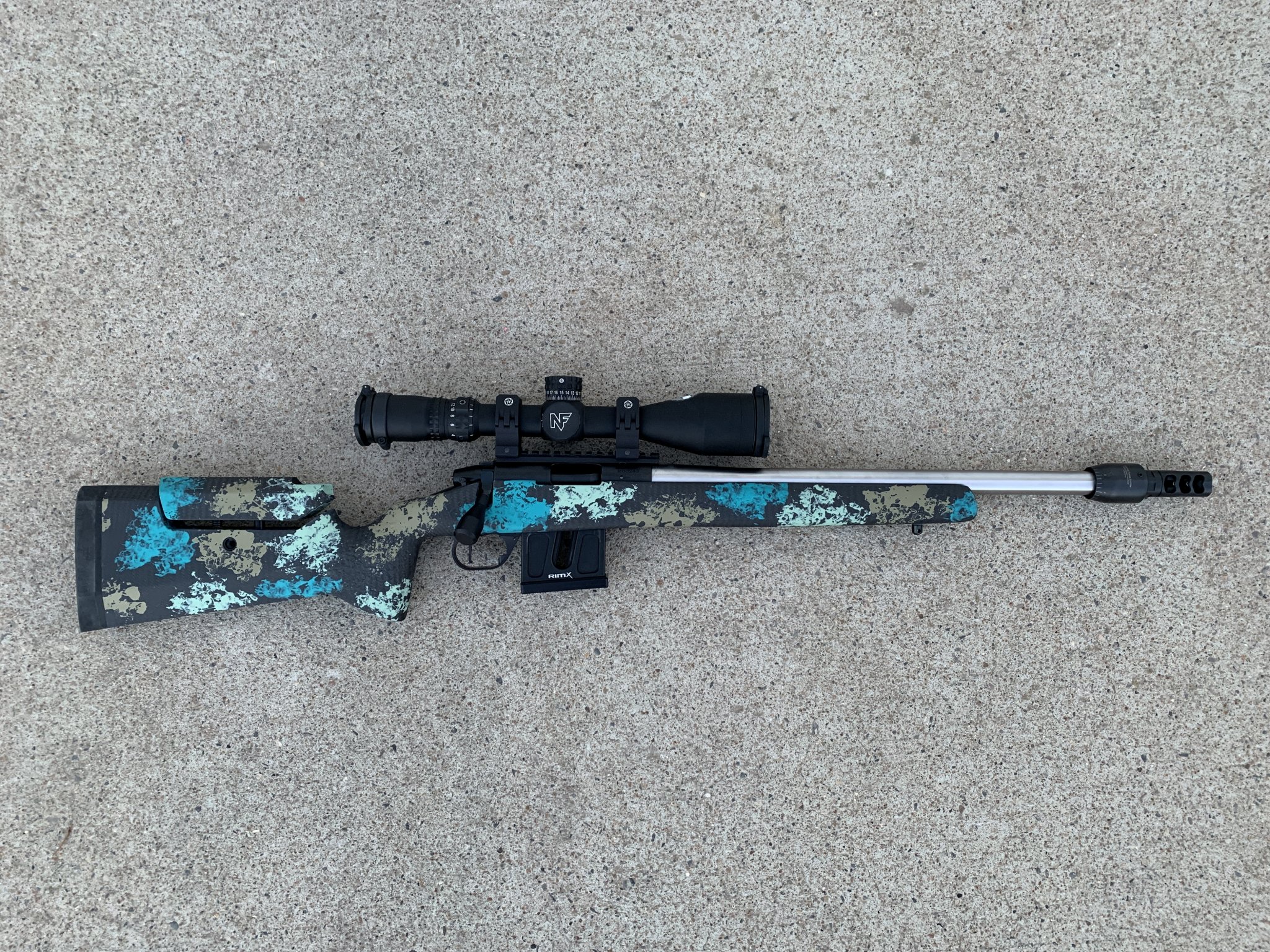

Just a few quick picks. Once I get the scope on I’ll take a few better ones.
RimX
Green Mountain 1.2 straight @ 21.5”
PDC chassis
Nevius chamber
15.4lbs with scope and bipod
When I had the 18” barrel on and the chassis weights it weighed 16.6lbs. So I’ve actually lightened it by 1.2lbs and now have a better balance point and a better overall feel.
Look's like you got your balance you were trying achieve ! (y)Reminds me of a small bore cannon LOL. I think you will really like that Nevius chamber. Mine chambers like butter, at first I thought that it wasn't chambering a round, looked and there it was! :) Looking forward to a range report.

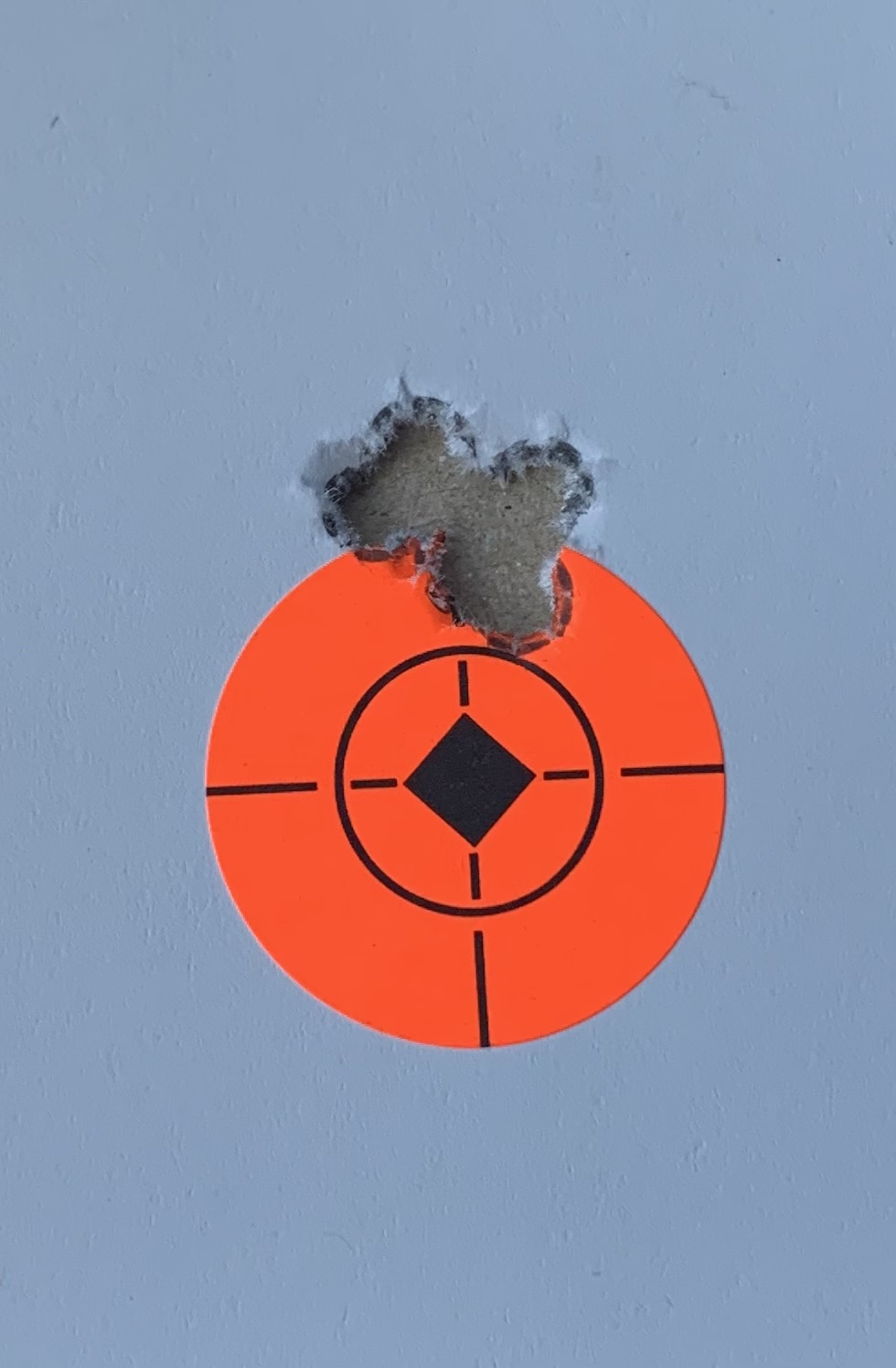

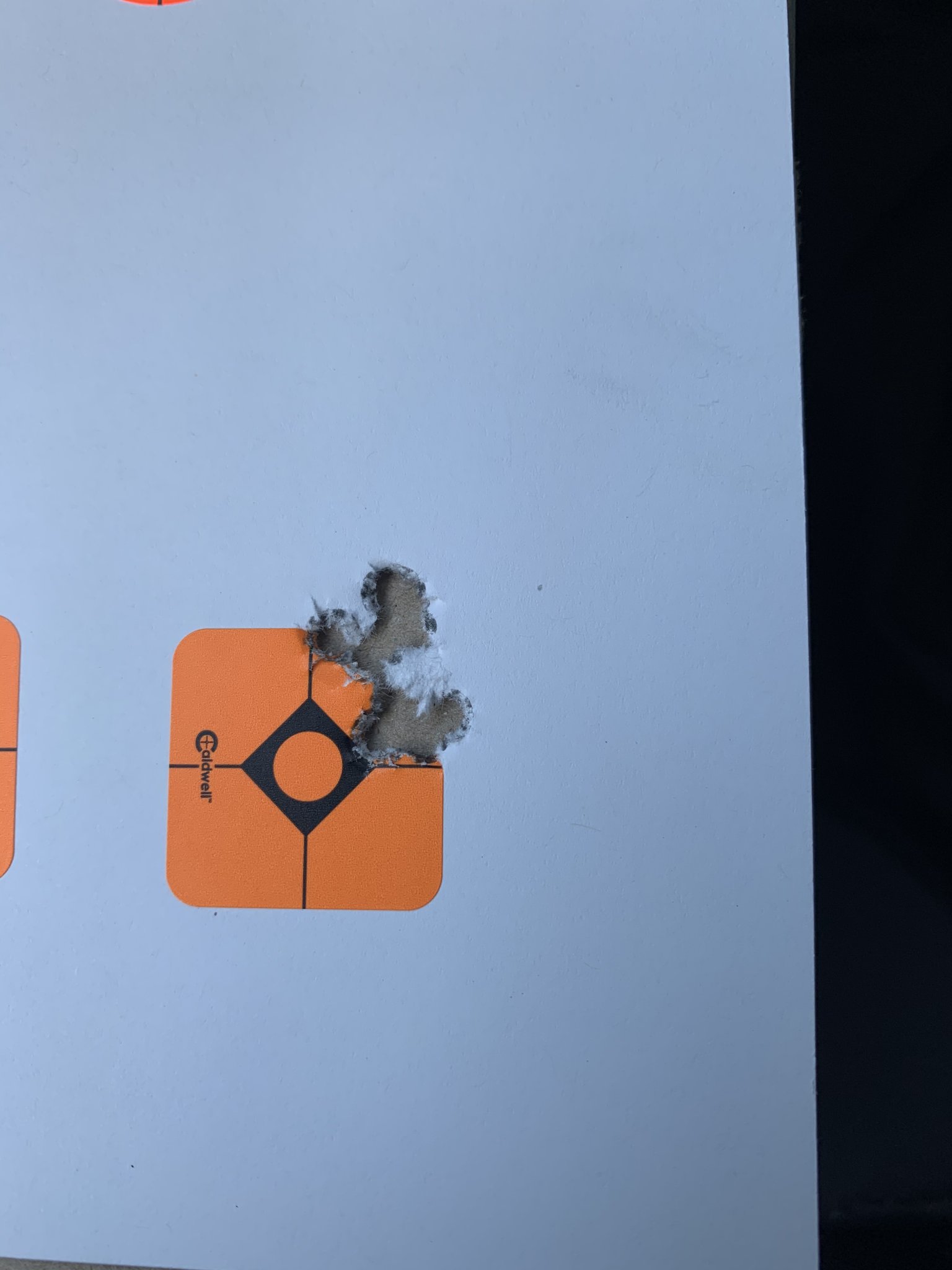

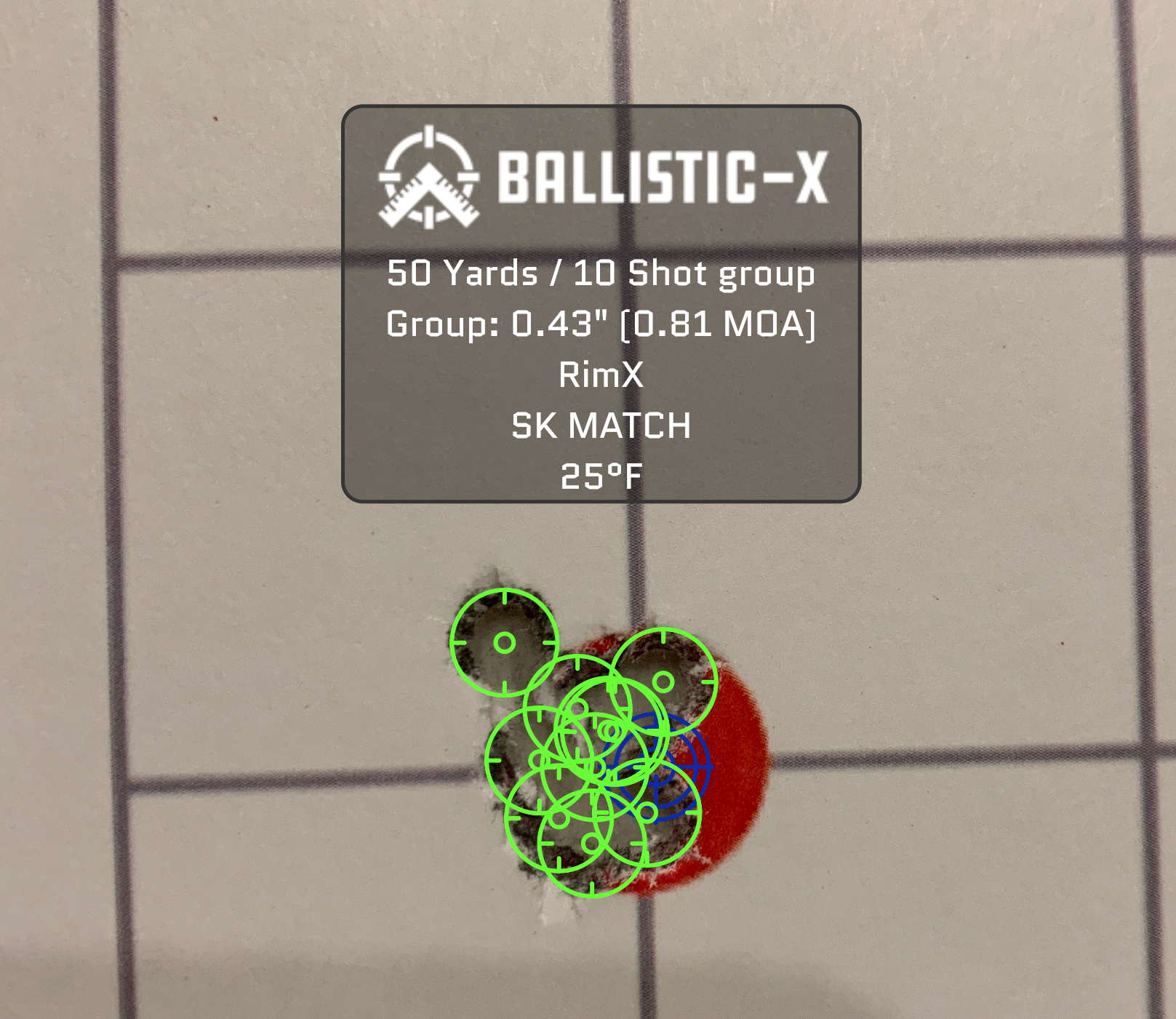

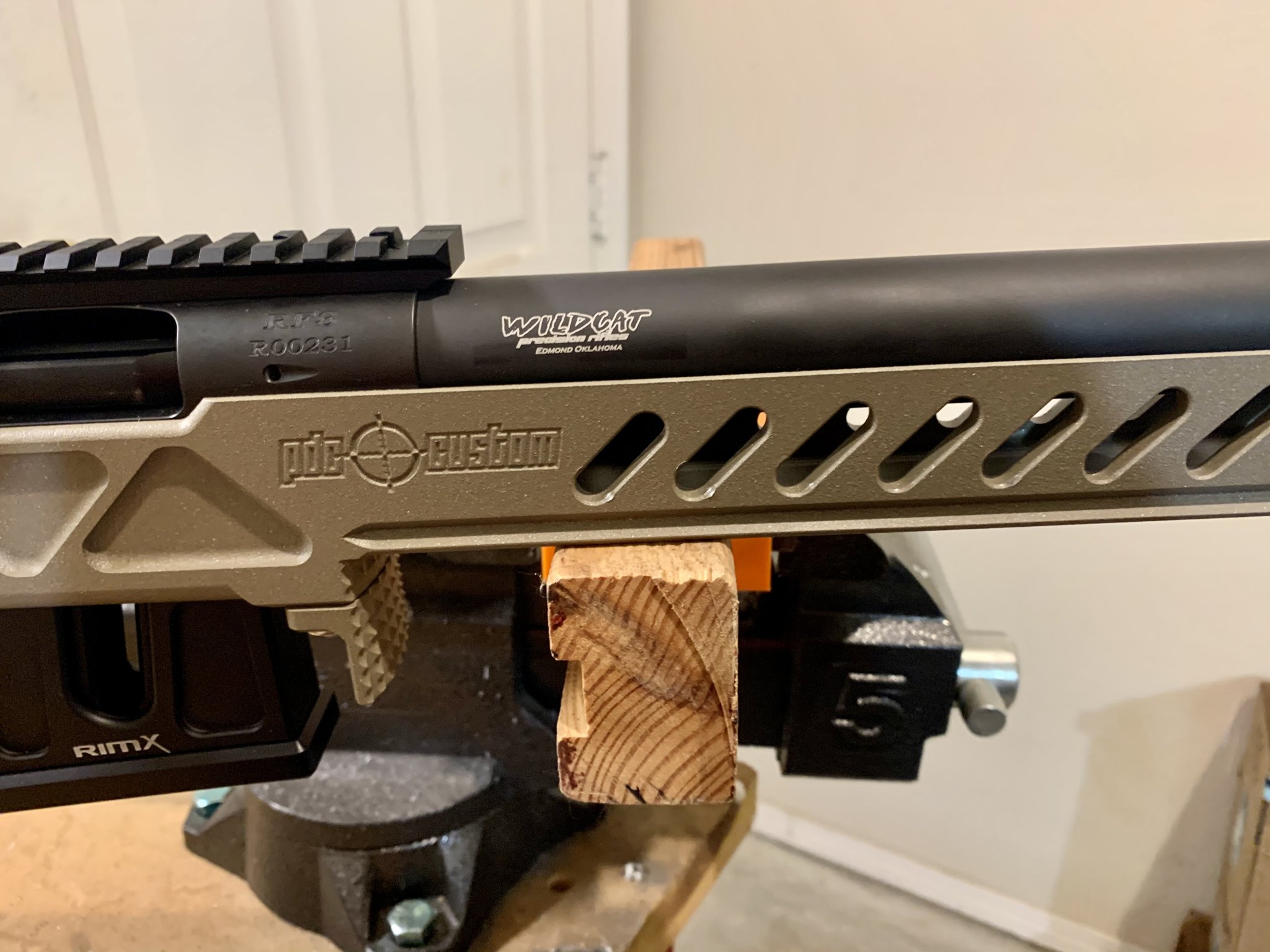

First outing with the new barrel installed. Winds today here were 20-26mph so I drove to the indoor range to shoot a few different kinds of ammo. Normally in the morning on there 100yd range it’s just one or two people but not today. Every lane had shooters, mostly AR guys and if you’ve ever shot indoors you know my pain lol. The biggest problem was targets going out and back constantly causing my target to sway side to side . Making it a challenge to shoot groups. It got so bad I only shot a few groups with my Center X.
all groups shot off bench with rear bag and bipod at 50yds. This was the first rounds through the barrel. Hopefully after the holidays I can catch a calm day to see what it’ll really do.
Rimx
Green Mountain 1.2 straight at 21.5”
Nevius chamber
PDC chassis
Bix and Andy TacSport Pro
Gen II 4.5-27
Wildcat Precision did all the smithing.
5rds Center X
10rds Center X
Well, from the looks of your shooting results - especially given less than ideal 'enviromental' surroundings - I think perhaps it'd be worthwhile to contour one of my two 1.2" straight blanks down to a more usable contour and try it on my RimX. Thinking something like Vudoo's Kukri contour would be appropriate...
ETA - I used a Nevius reamer on the Shilen R5 I did for my V-22S, and polished it a bit with IOSSO bore paste after finishing it. It's a pretty snug chamber for a repeater - are you satisfied with the way your RimX feeds from the magazine?
No problems using this chamber with my RimX mags but I also polished the chamber face and the chamfer really well. To me it doesn’t feel any different chambering a round than my 18” barrel with Padom’s chamber which also is a really good chamber.

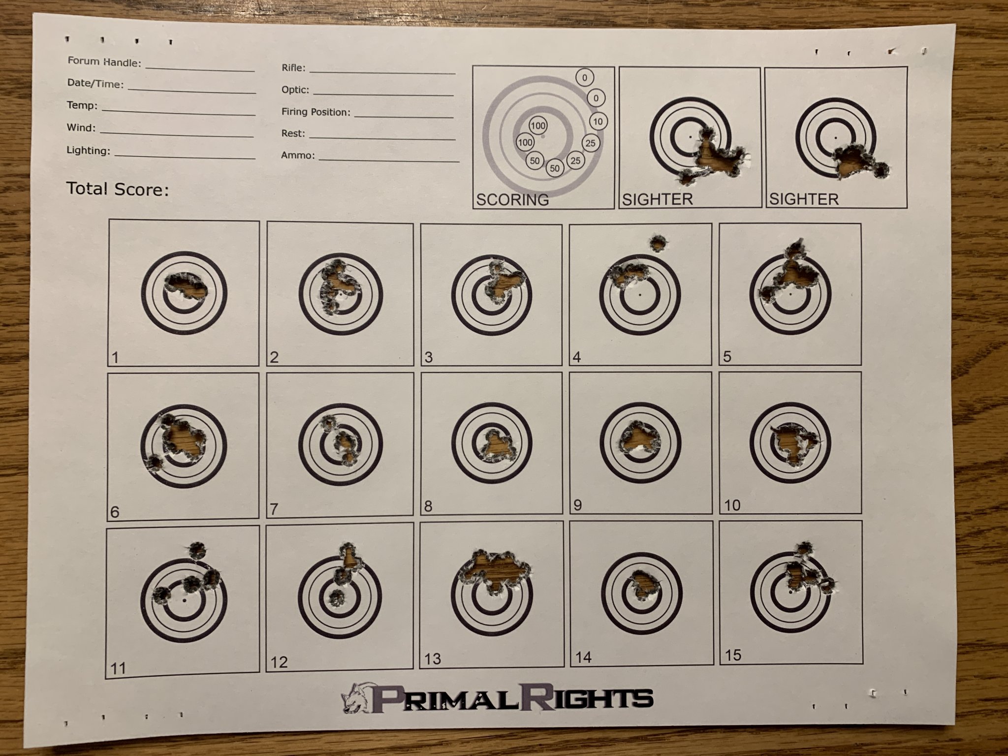

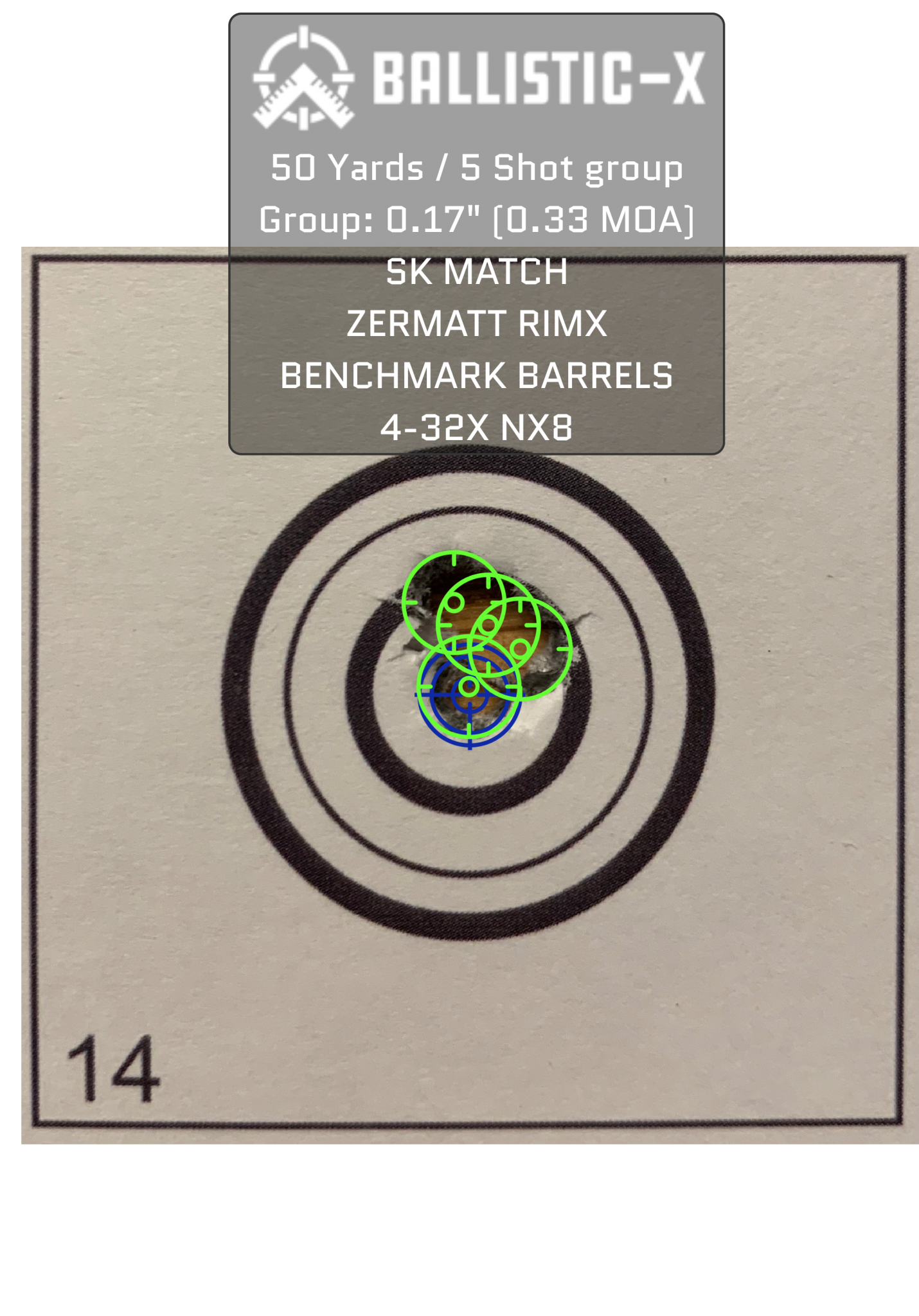

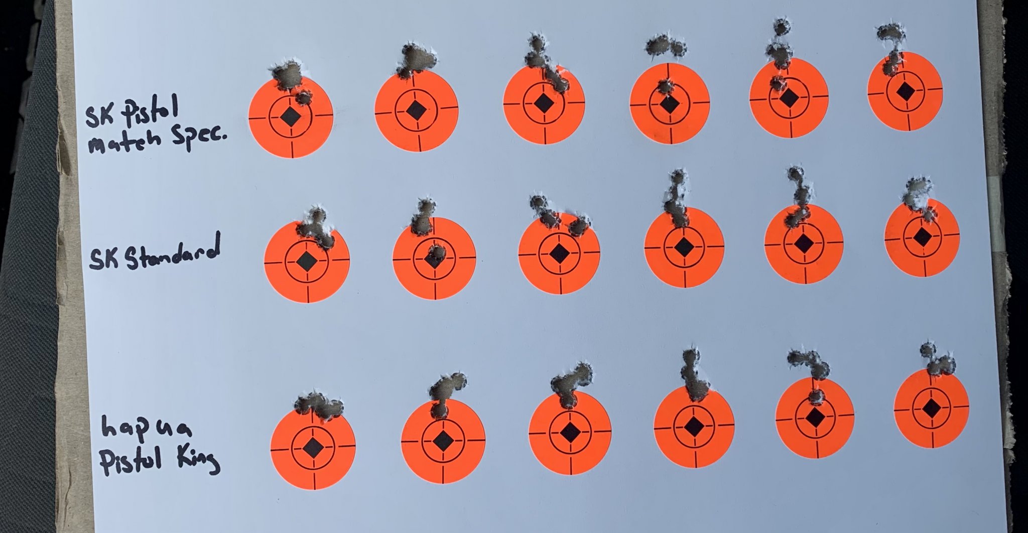

i threw mine on 20" heavy varmint kreiger
new case of SK Match, left the midas at home
tiny/one hole at 25 and 1/2"-3/4" give or take at 100 (shot on steel)
didnt adjust it at all
