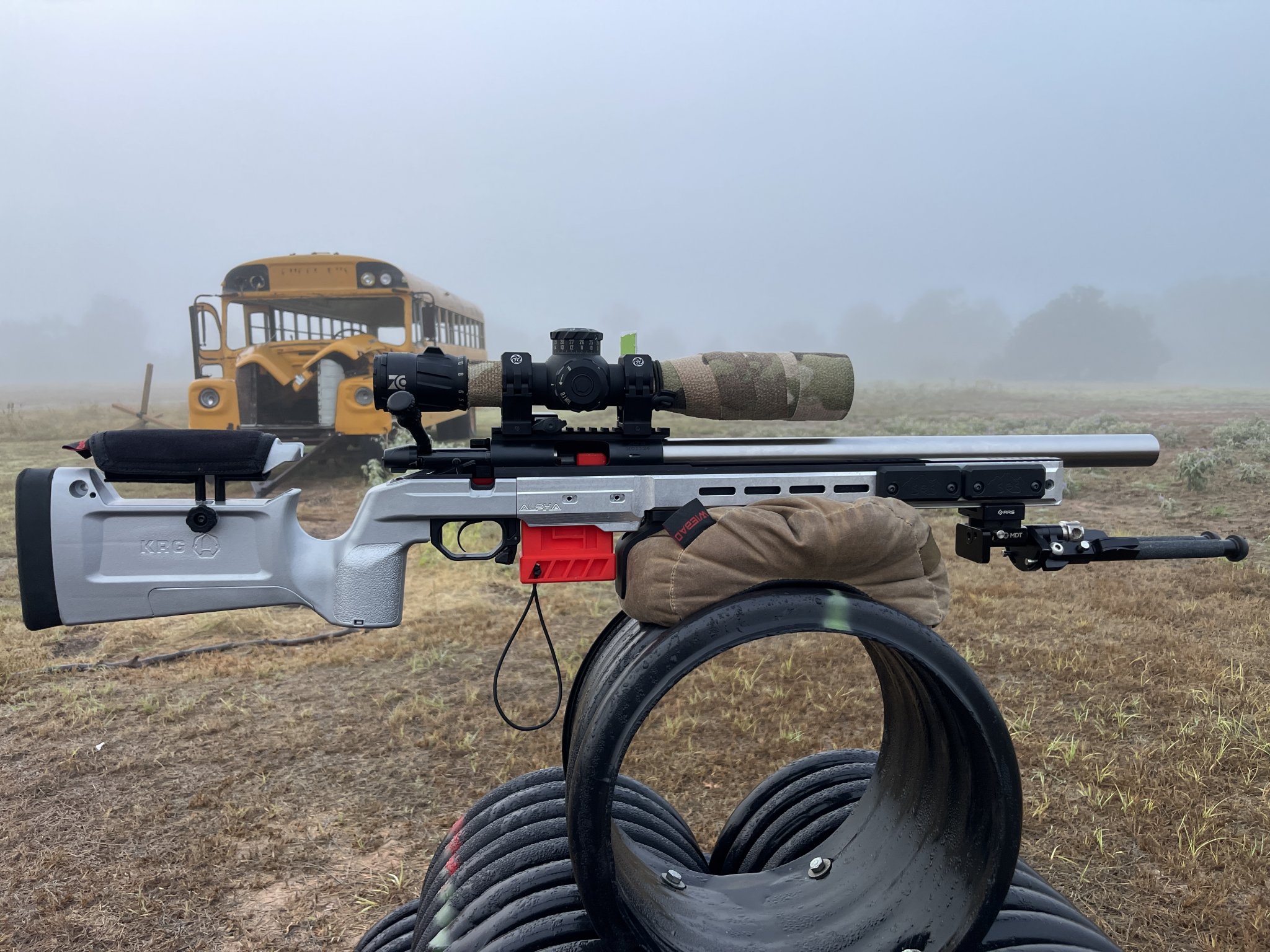

Shot the regional finale today with the Keystone barrel. She did not let me down per usual. The RimX ran like a sewing machine. There was a 3 way tie for 10th in Open but I cleaned the PRS barricade and got the second fastest time for the entire match on it (Open). I’m not mad at today’s performance. Walked out of there with a cert for a free SAC comparator kit.

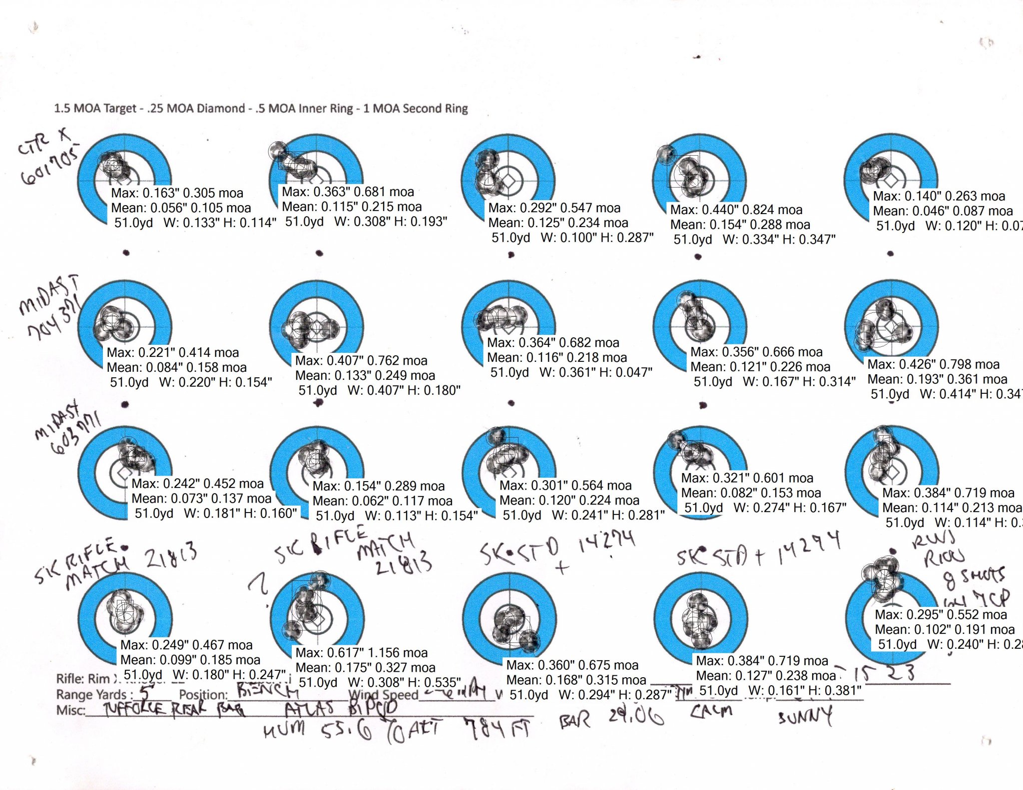

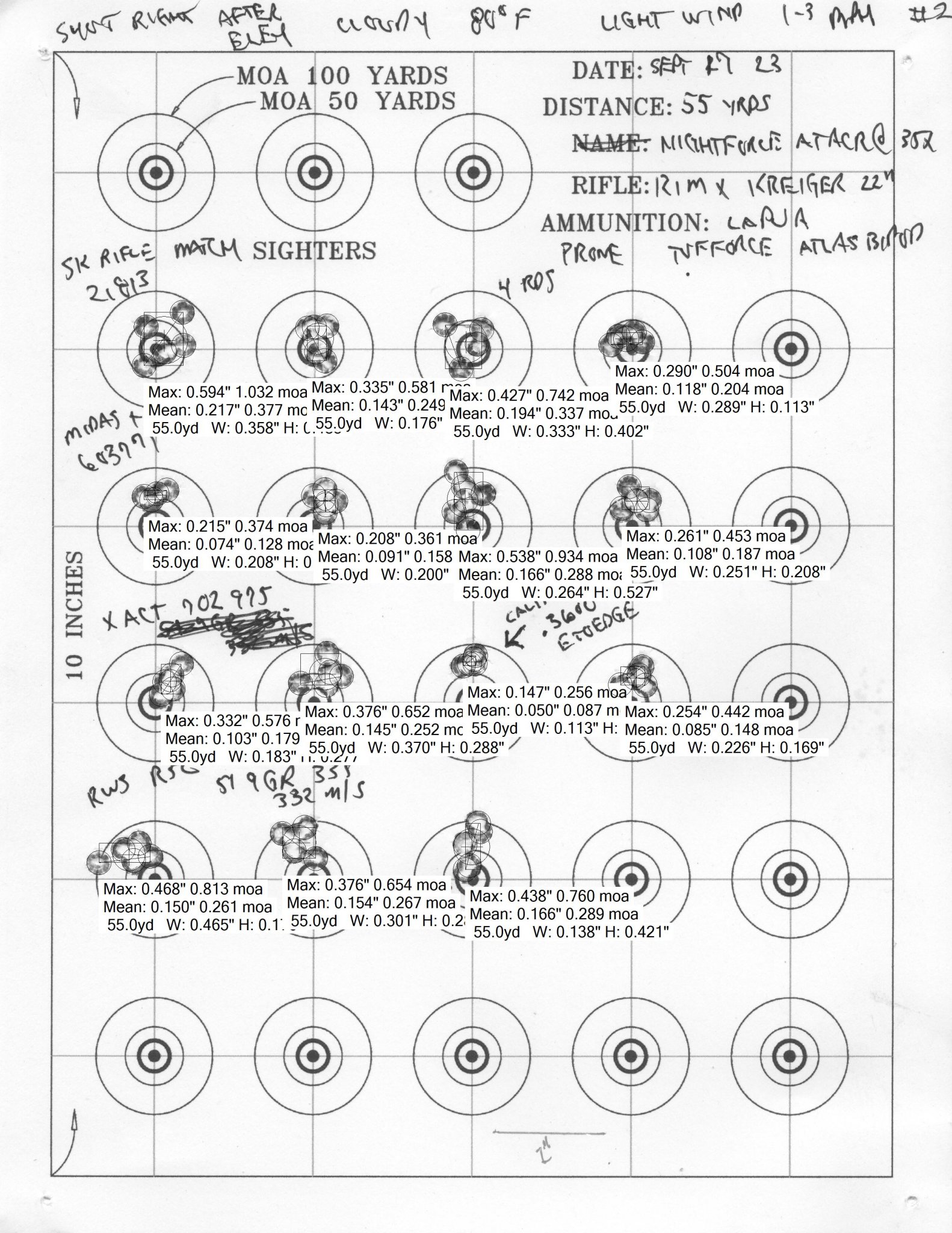

That would be great 😊 I have a Krieger with Mike now. I have a brick of eley match that my Lilja barreled CZ likes. I was going to order some more ammo . I have no problem using SK.
Thanks Dave

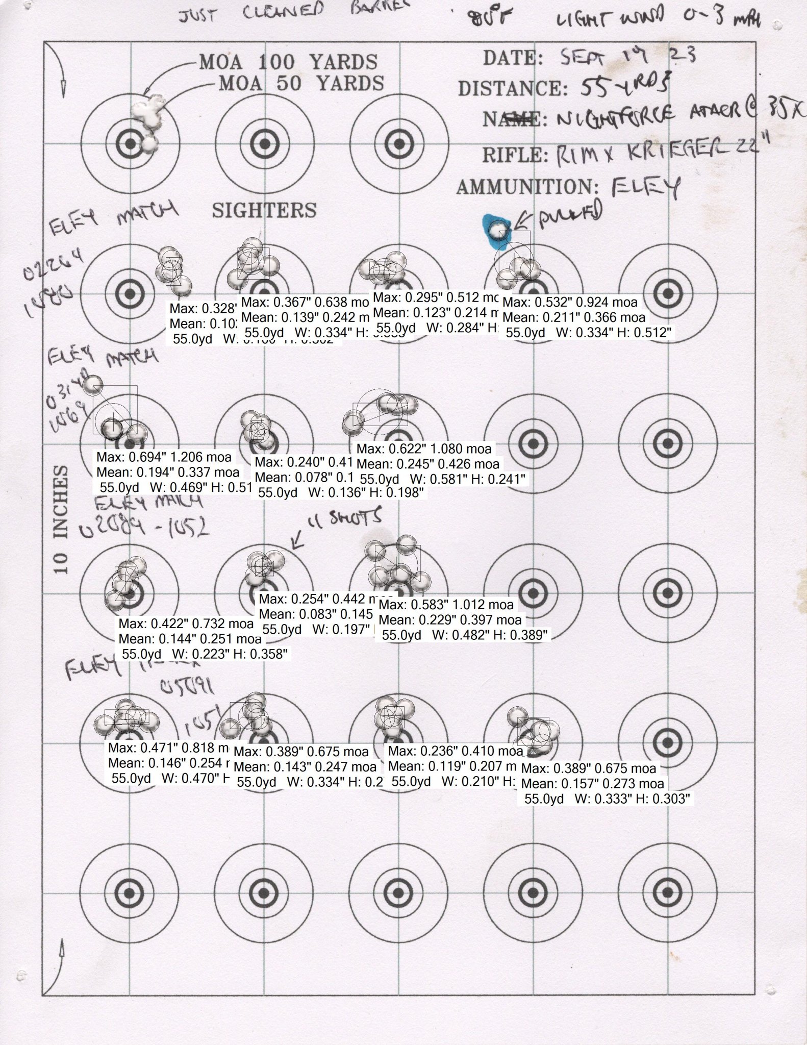

Here are the targets , it seems the Krieger likes the Midas + the best

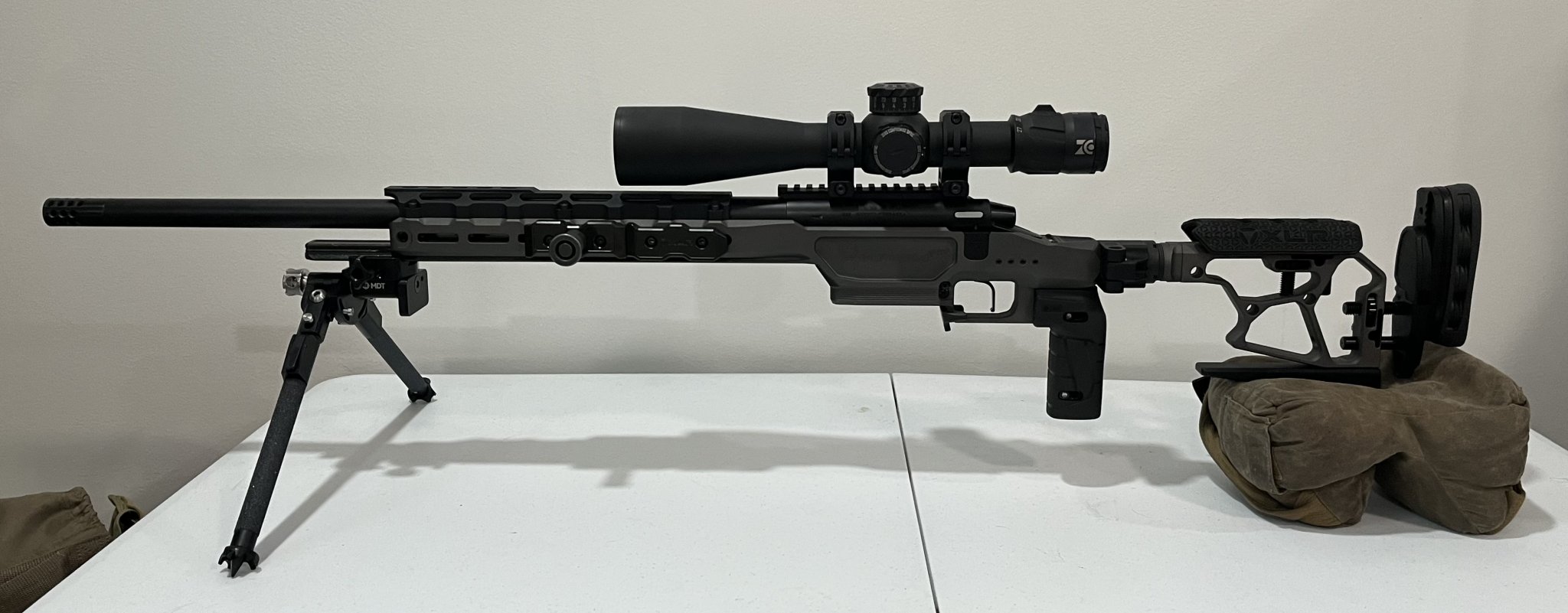

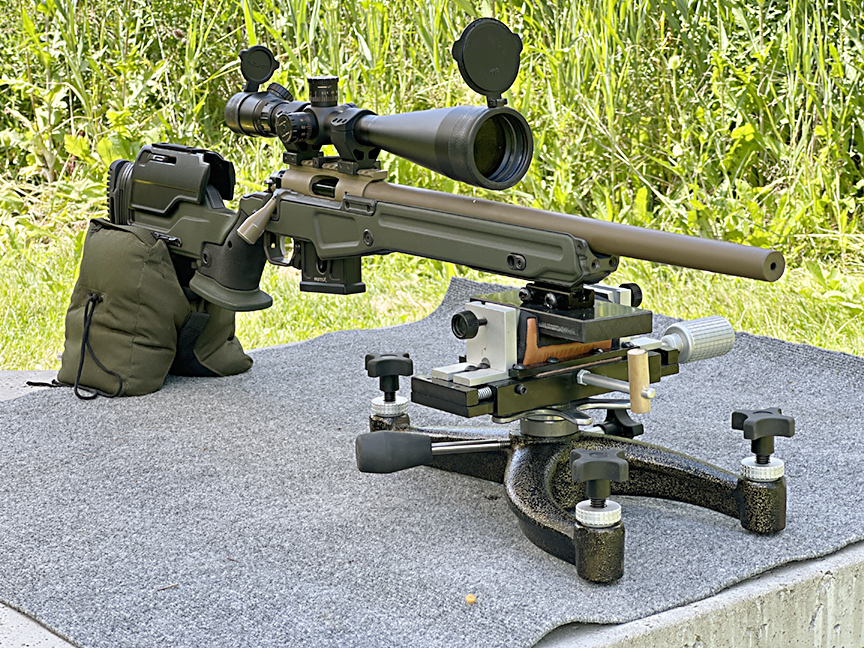

My new to me dream build that I pieced together from the Hide.
TS Custom/Primal Rights built RimX with 24” Benchmark MTU
XLR JV Envy Pro with C6 buttstock custom tungsten color
MDT Ckye Pod Standard Pull
ZCO 5x27x56 with ARC rings
This is the most accurate 22lr that I have ever shot and I have owned several of most every brand. Even with only trying one lot of SKLRM, the first trip to the range last night had me giggling like a little kid.

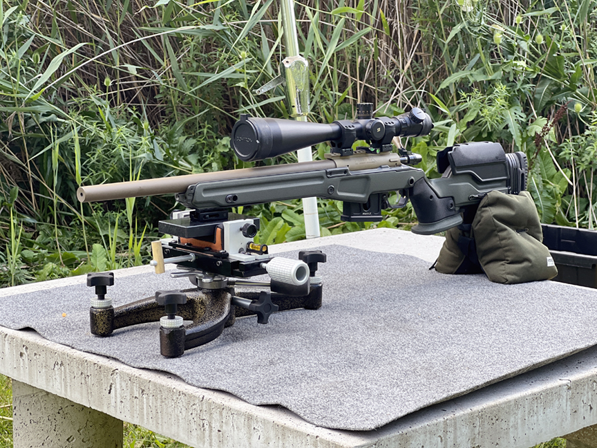

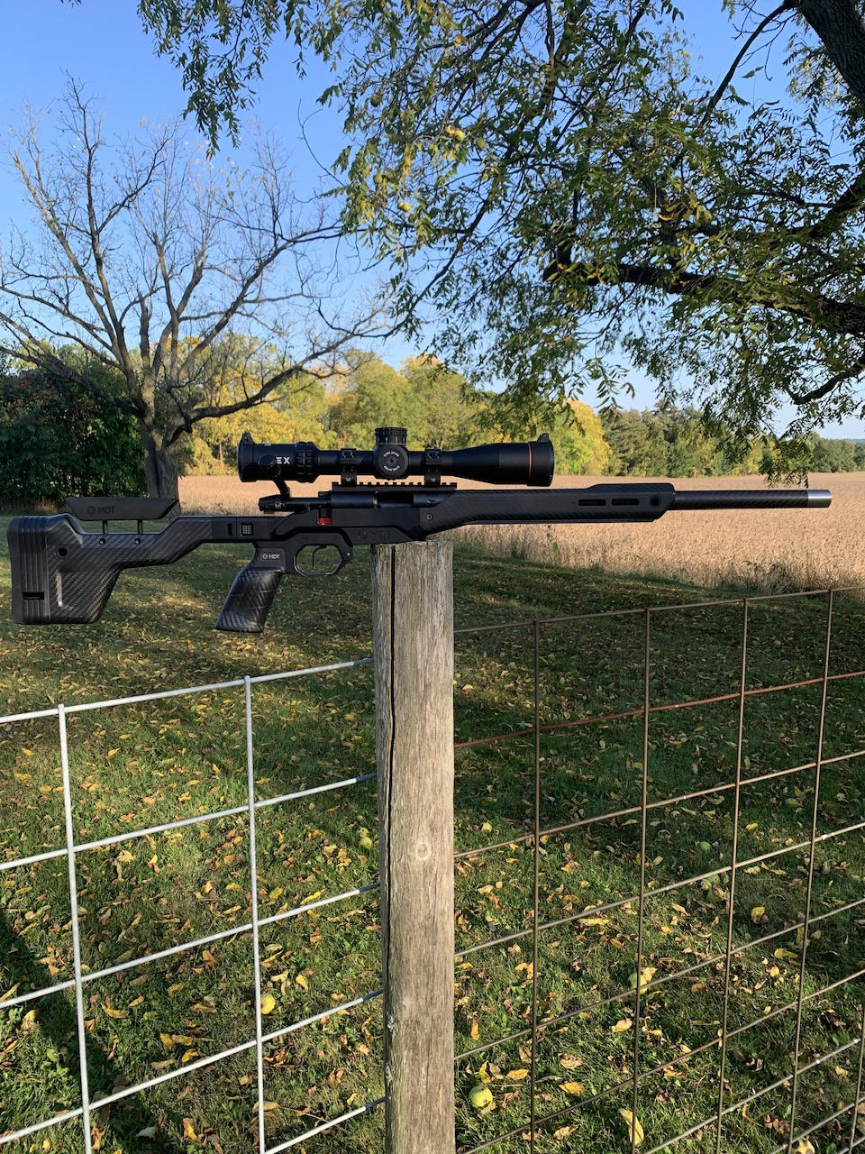

Greg Dykstra put this Primal Rights/TS Customs Rim X together for me and it shipped in September, 2022.
I've only had it for a short time but have over 2,000 rounds through it - Simply faultless in operation and accurate!
A big "Thank-You" to Greg & Kristen for supplying this package and helping me get it into Australia's Top End.

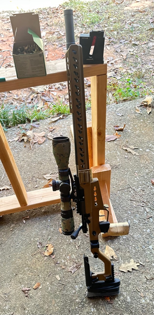

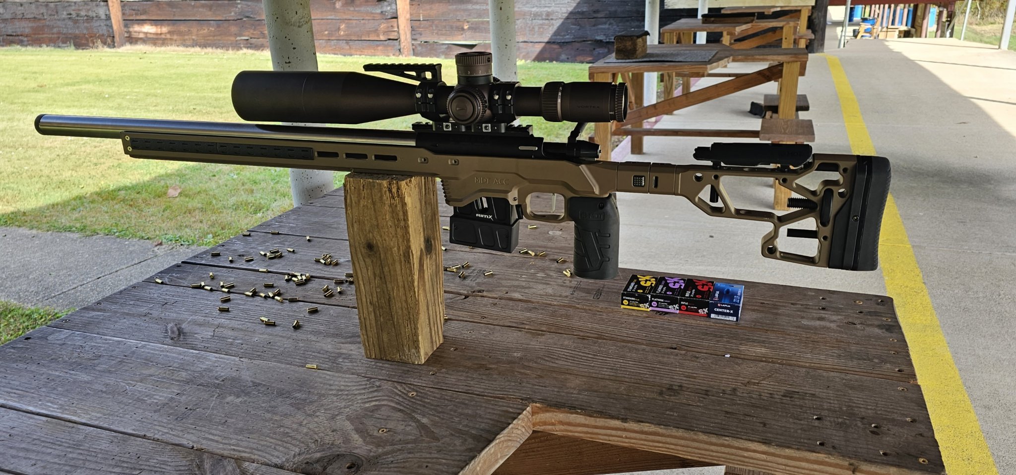

Threw this together to play around with. Need to find a better scope with 25yrd parallax.
AI ATX AICS
RimX
Proof 22LR CF Prefit 16.5”
KGM R22

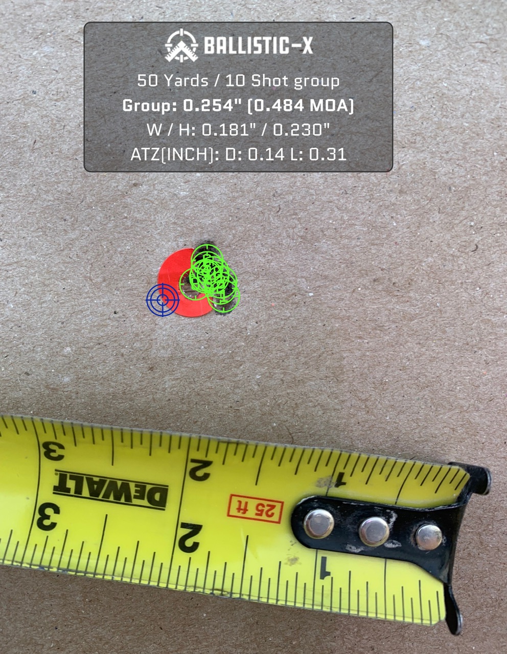

I snuck out to the range after work and finished the session with my RimX chambered by Manzella Precision. After 20 warmup shots with SK Standard I started on a fresh target and shot 2 mags worth. Average group of 0.34” was making me smile. Tough to beat that with yellow box ammo!
Side note, the Garmin Xero picked up every shot and this box of ammo averaged 1052 fps with an ES of 51 fps and an SD of 12.8.
